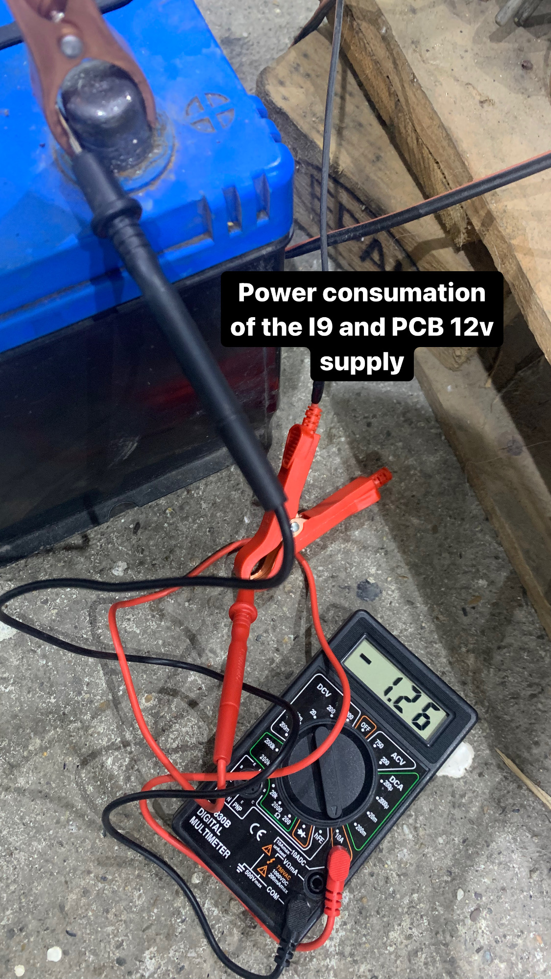

The motor is on a bench PMSM Bosch SMG 180/120 with resolver with Toyota Prius Gen 2 and Openinverter PCB of course!!
3 times watch the Video tutorial for FOC
I do everything as a Johannes and D. Maguire said in video, but when try to Test the motor NOTHING, i make a couple of photos how i connect the Motor+Inverter+Controller!
