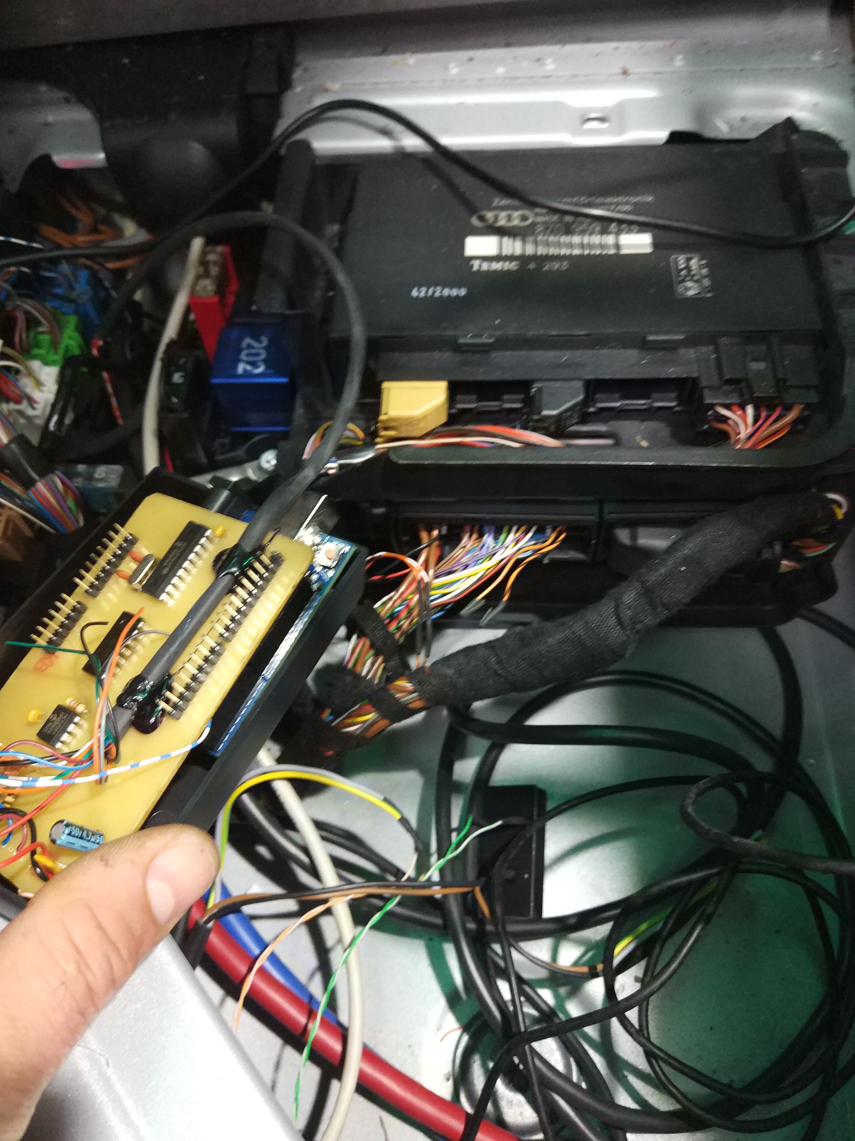

Re: Audi A2 /w Twizy Motor and Prius Inverter
Hi Johannes
My friend with A2 EV came by today and we went to the car and inspected its CAN bus under the seat.
I noticed they just cut the ECU lines and they put one Arduino to this task. I noticed 6 wires going from arduino MCP CAN chip.
We have recorded CAN traffic with key OFF and ON. I got the signal in off state by powering Arduino from my PC.
First two files are taken from the working car. It is a log file made with CANalyst II.
Third file was recorded in OFF state with only Arduino powered. Strange thing here is that i got only x480 signal there. But if i turn ON ignition then this msg is not present.
We couldnt dig too much or disconnect too many wires, because he would need to return home still :). We did make a mistake though. We soldered some 30cm twisted wires to the chip and used that to probe CAN. When we removed my equipment his steering wouldnt work! Of course, cable impedance was screening CAN bus since i didnt put 120R resistor terminator in.
I attach some pics so you can see where the CAN lines are cut.

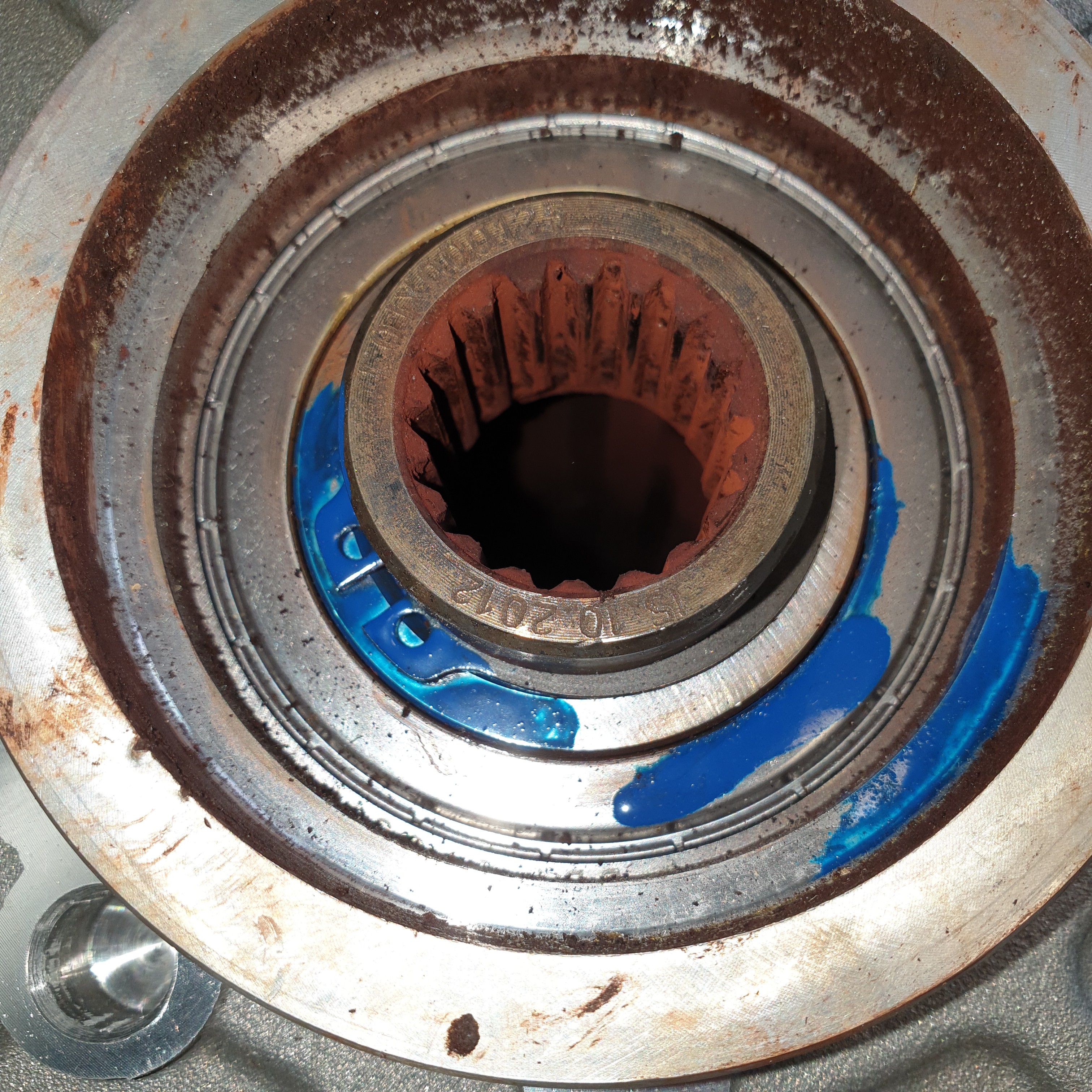

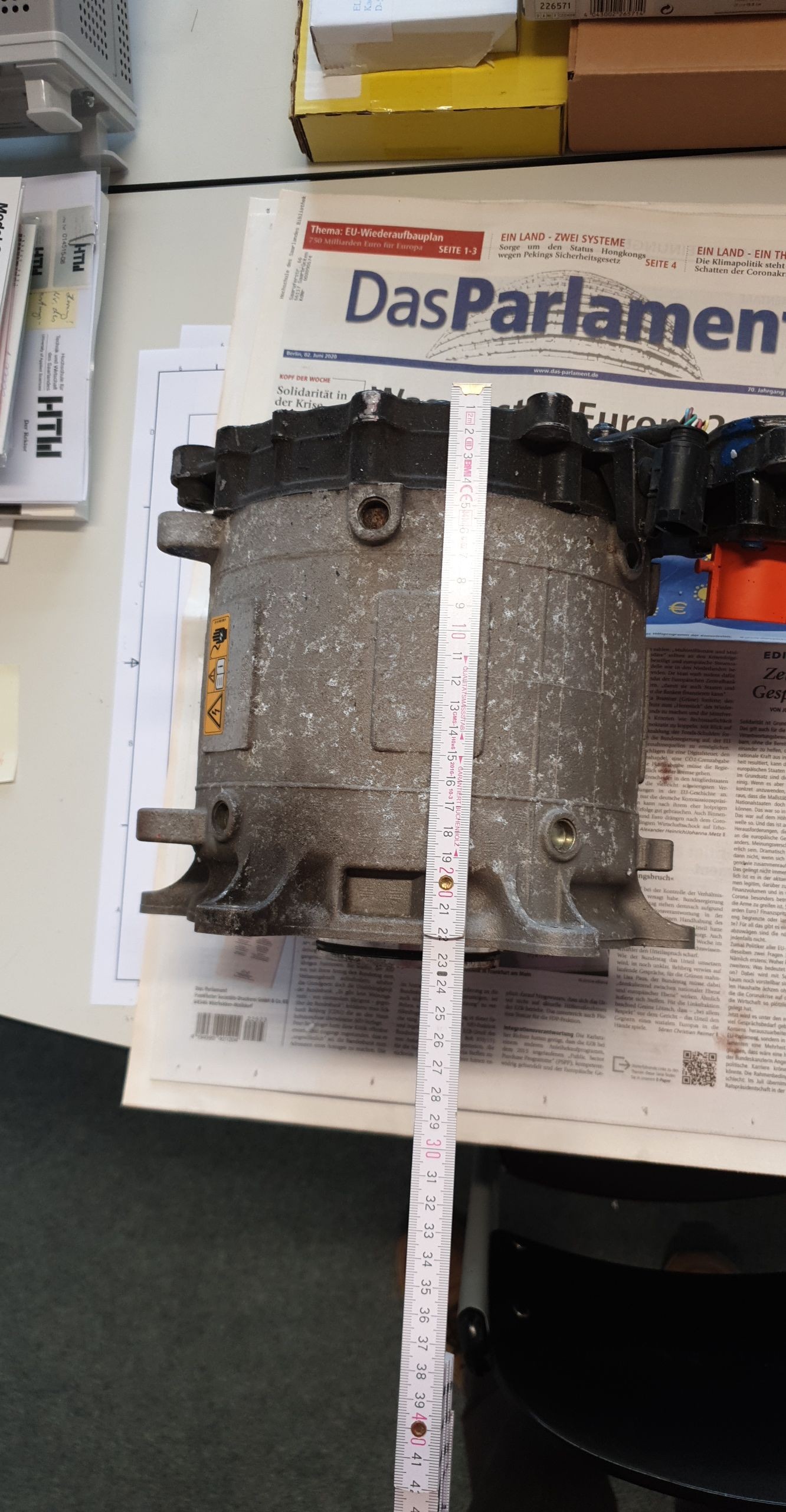

The smart motor has arrived. It is so tiny! About 200mm diameter and 230mm long :)
It has inward splines, I'm looking forward to seeing Thomas' solution to that.
