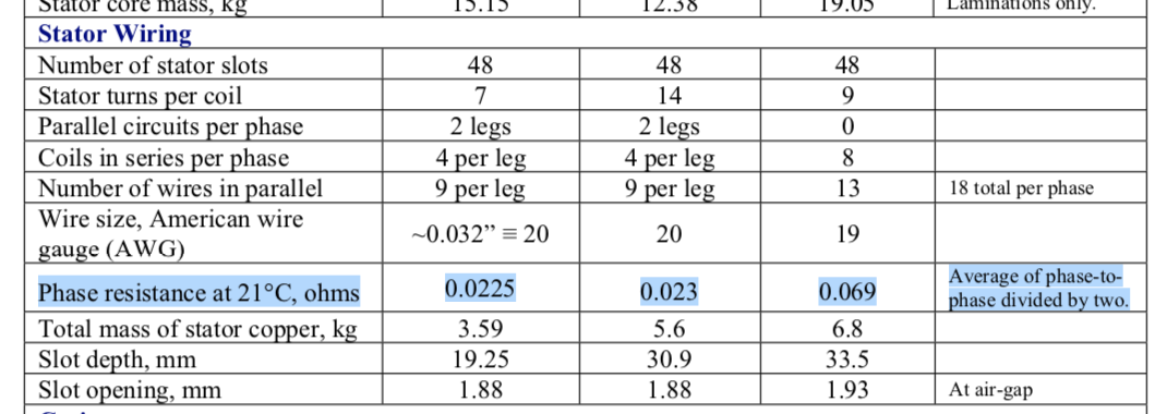

Having just checked stator windings of MG1 and MG2 in my salvaged L110 transmission it appears they are not good, very low and wildly varying values ranging from 16 to 66 milliohms in both motors. Two questions:
1. Does anyone have info on what these windings should read in milliohms, either factory specs or by testing your 'good' stators?
2. Are new stators available as spare parts?

Is anyone out there in a position to measure the stator winding resistances of a good L110 transmission?
The only reference I could find is to the L110F 'Phase Resistance' (below) and I don't understand how they actually get to the figure of 0.0225Ω quoted in this table that compares it with Camry & Prius stators. 'Average of Phase-to-Phase Divided By Two' makes no sense to duffers like me. Why would you divide the average of three measurements by two?
Suffice to say it would be helpful to have DC resistance measurements available for checking stator windings are good when hunting for another transmission.

Because when you measure the resistance between two phase leads on a "Y' wound stator you are measuring the resistance of two phases.PacEmaker wrote: ↑Sat May 02, 2020 12:27 am Is anyone out there in a position to measure the stator winding resistances of a good L110 transmission?

Duh of course, I should have drawn it for myself and that would have made sense!
Thanks for that. Do you know what the tolerance between windings should be? I'm guessing similar to the Prius tolerances John Kelly quotes in his milliohm meter video e.g. no more than 2 milliohms difference between the highest and lowest readings in a stator - as per this video (at approx. 25min mark)

If the tolerance for the Prius is 2 milliohms, and it looks like 105 milliohms, that's a 2% tolerance. So for your 22.5 milliohm transaxle you should hope to be within 0.5 milliohms or so. Realistically, if the windings aren't drastically different (dead shorted) then it should still work fine. Also there will likely be some measurement error.

If you watch the video he was talking about 2 milliohms lattitude with 34 milliohm windings. Not 105 milliohm windings. But I take your point about the percentage tolerance, which is what I'd like to apply once I know what the L110 windings are supposed to read if anyone out there has a good GS450h transmission they can measure for me.
