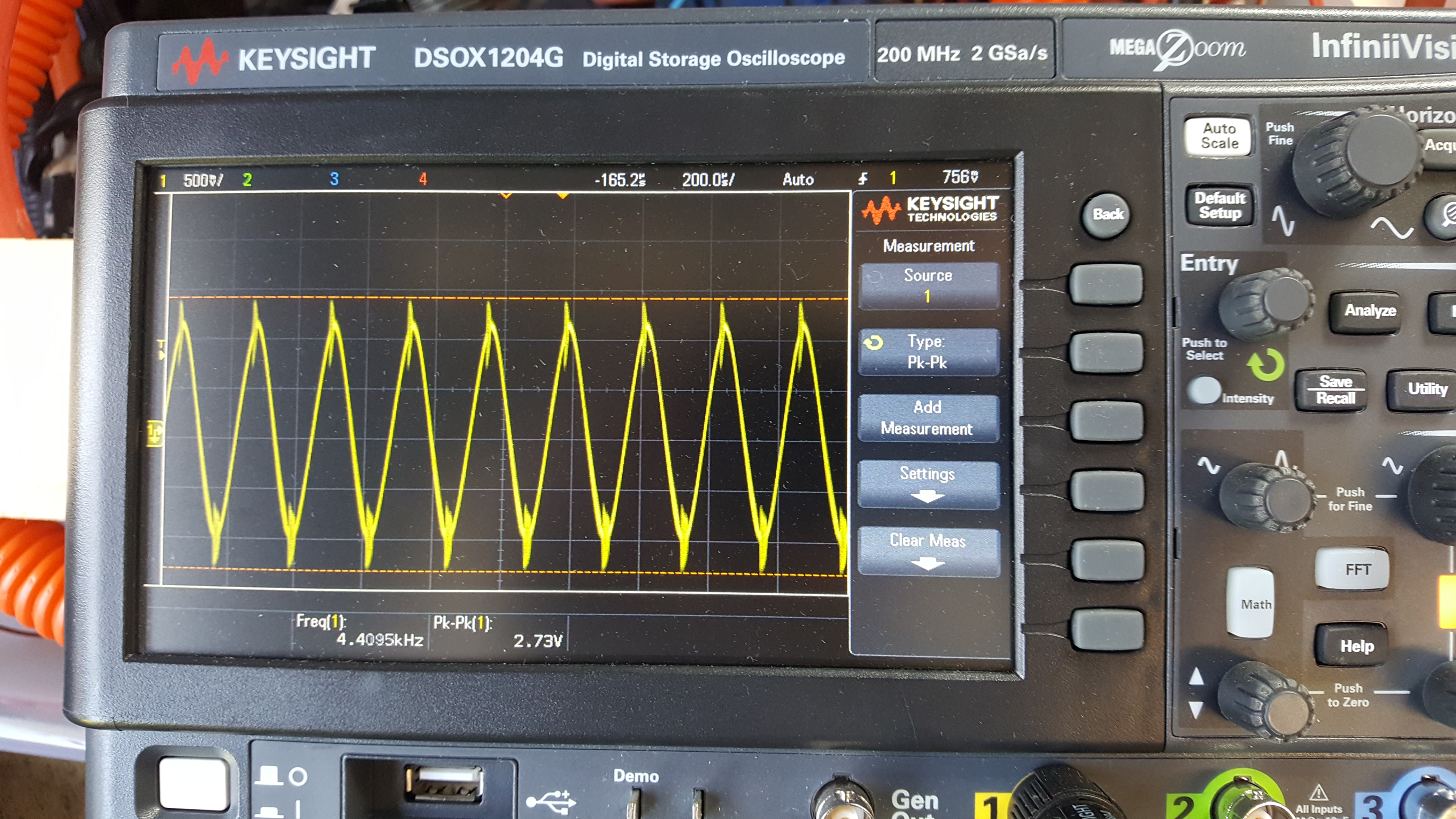

Some info on the M3 rear du temp sensor and resolver wiring.
Posts: 3831
Has thanked: 75 times
Been thanked: 696 times
First attempt running the drive unit using FOC firmware in the prius inverter today. No luck as I think I have my current sensors mixed up. Going to do some investigation on this over in the Gen 3 prius thread then back here to see what happens:)
