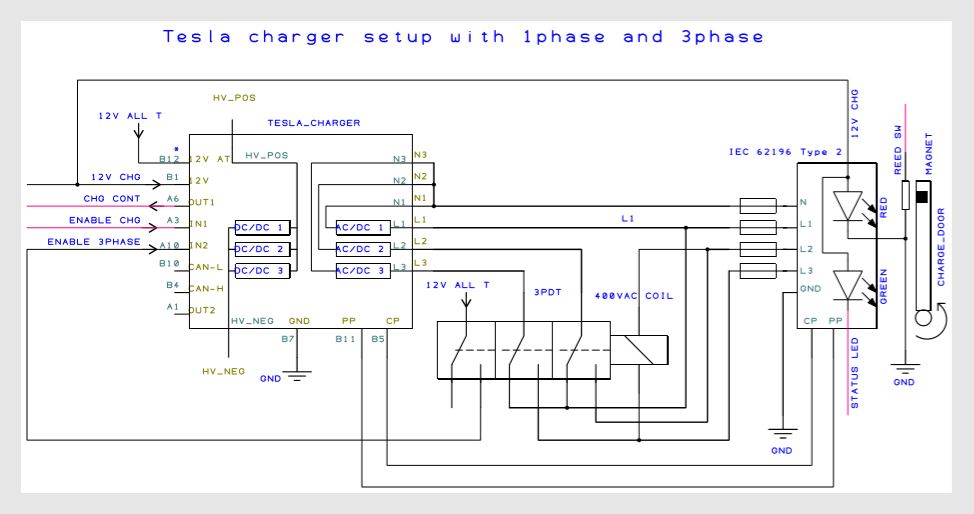

I think I found a simpler way to do this. Do you think it will work?
At least, this way it will not go boom, if contactor fails or get welded!!
The charger will be in 1Phase mode all time, N-L1 connected to all modules.
When there is 400VAC on L2-L3, contactor will close and connect phase123 to module 123, and set IN2 high.
It will still need some program changes, to tell the charger to switch to 3phase mode, when IN2 is high. Can not find a contactor/relay with 3PDT and 400VAC coil, but it should be possible to use something like this from RS:
https://uk.rs-online.com/web/p/contactors/7447184/

Here is the code that need to be changed:
You could also edit the setup description: pinMode(DIG_IN_2, INPUT); // High in 3phase mode.
You will not be able to change between 1ph and 3ph in the menu, so you might as well remove it.
// Find this: (line 390 or something, depending on version)
evseread();
autoShutdown();
watchdogReset();
manualMode();
// Add the following:
if (digitalRead(DIG_IN_2) == HIGH)
parameters.phaseconfig = Threephase;
else
parameters.phaseconfig = Singlephase;

The safest implementation of this is by hooking 2 extra 230VAC relais (small ones) parallel on each incomeing phase.
The contacts of them are then in series. And those are in the A1 or A2 side of your switch over relais.
Then the software detects there are missing phases and command the change over relais to bundle the phases and if the hardware detects otherwise it won't happen.... (You do need to make up your mind if you are willing to power the socket back to the charger with extra phases)...
I think this would be a Safe, level one, solution. In order to get into higher safety levels you need to read back contacts of the relais and use 'safety relais'. But i don't think that would be needed in this situation since i suspect there are electronic fuses in the charger which will detect some anomalies.
