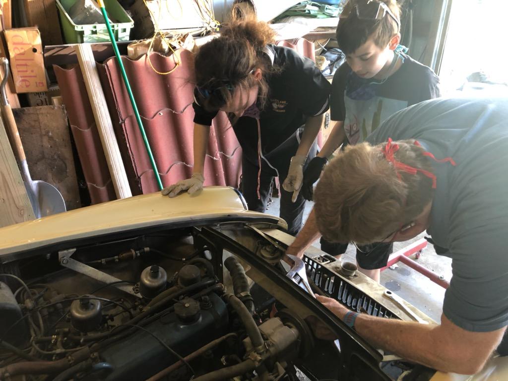

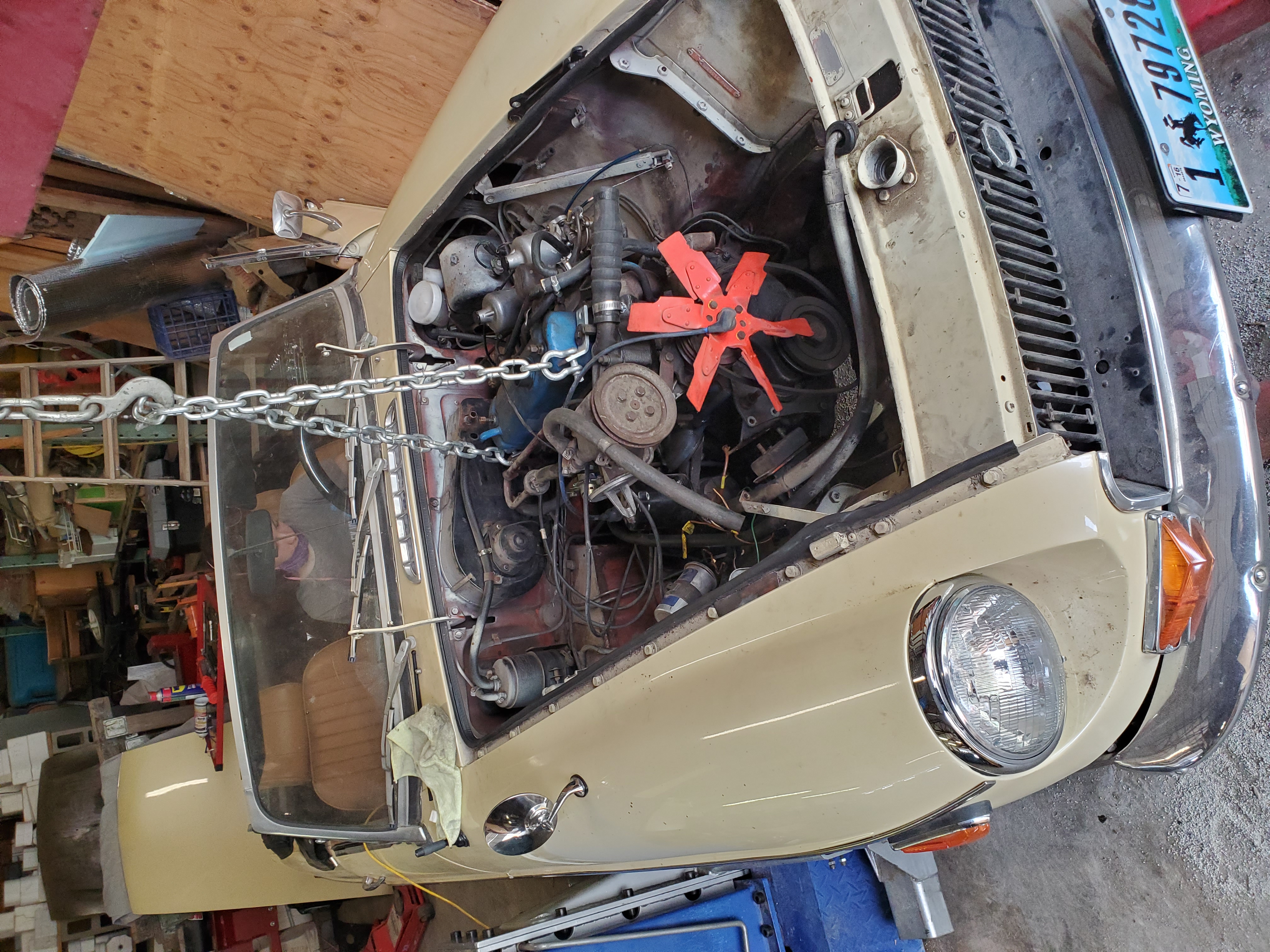

Started the the removal of the ICE in the MGB. My son and my grand kids helping.
Got all fluids drained.
Disconnected all the various electrical and mechanical connections to the engine.
Removed the the front motor mount bolts.
We are now ready to lift the car and start underneath with removing the exhaust etc before lifting the motor out.

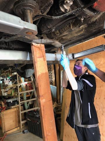

Day two on ICE removal. More progress. But no cigar yet. The Engine hoist needs more jack oil.
Great help again from my son Keith and my grand kids.
Regina removing the cross member under the transmission.
Christopher working on the Stick Shift removal.
Houston, we he have a stalled lift off.

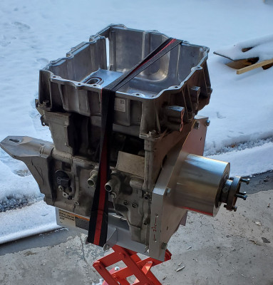

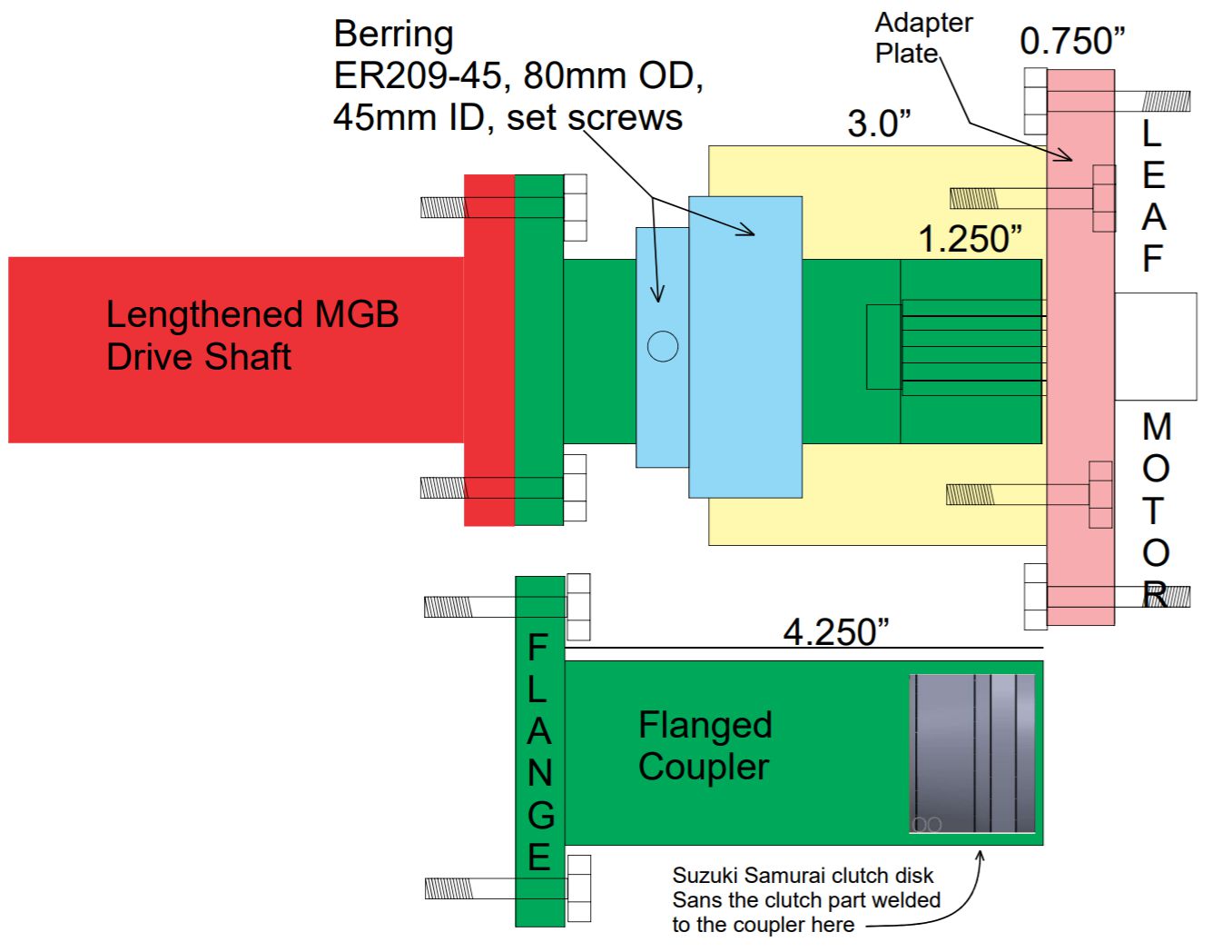

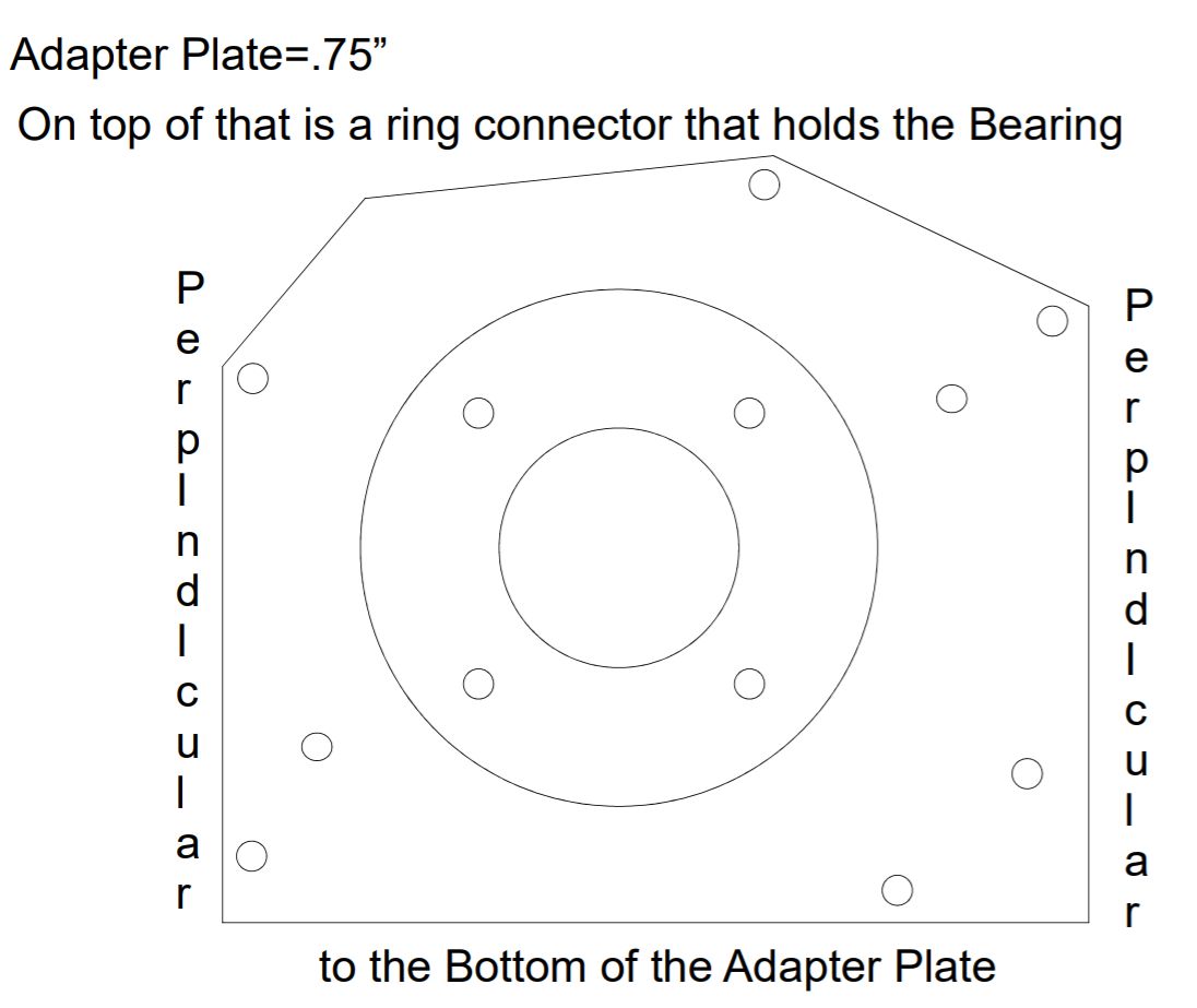

Have been slowed down on this project over the past year but I have made some progress and have some new things to report.
After the ICE removal, next was designing connecting the motor to the rear end.
First step: Adapter Plate. I started with Jeff Black's adapter plate and redesigned it to eliminate the transmission, mount to the motor and connect to the drive shaft. Working with Horizon Machining in Berthoud, CO this changed a little and I am working with them to get an updated drawing.
Suffice to say we decided to add a second bearing next to the motor so the drive shaft cant add aide forces against the motors shaft.

Next we made changes to the Adapter plate to have a ring connector (yellow above) that hold both bearings:

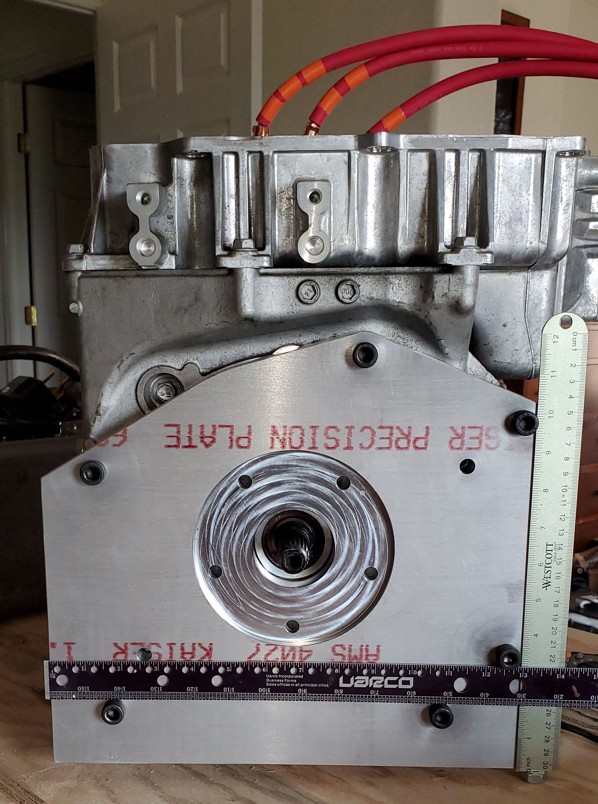

Test fit of the Adapter Plate on the Leaf Motor
Jerry Kauffman
jerryk48 at gmail dot com
- jerrykco
- Posts: 156
- Joined: Thu Dec 12, 2019 5:32 pm
- Location: United States, Colorado
- Has thanked: 119 times
- Been thanked: 28 times
Re: '70 MGB Roadster - 2015 Leaf EM57 powered
And next the complete adapter on the Motor, ready to put in the MGB to start the motor mount install.

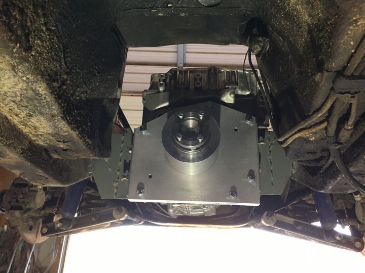

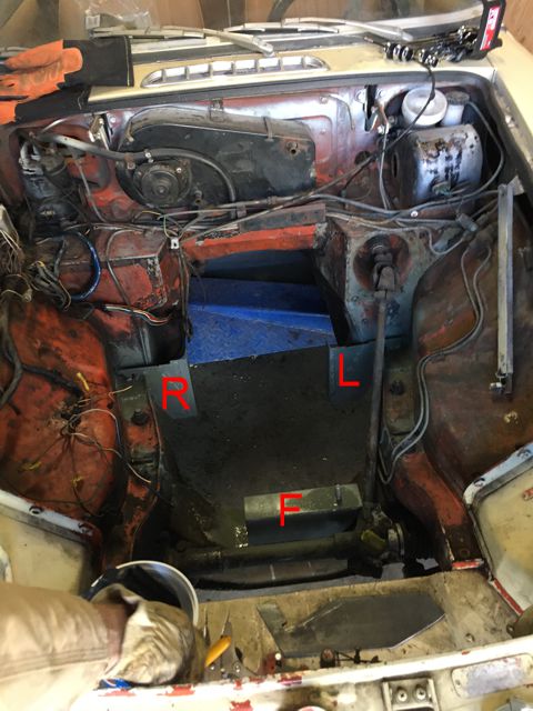

Here you can see the two added side motor mounts (Right and Left side of the motor) and the front motor mount With a welded Bolt.

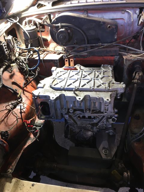

And ta da. It's in.
Front View Rear View (And more detail on the rear mounts)

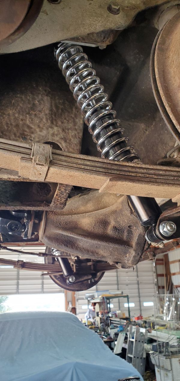

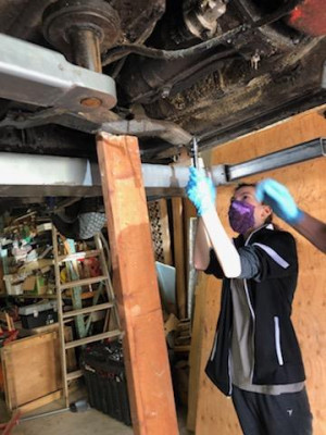

Next I added Rear Coil Over Shock Kit. The original Hydraulic Shocks had long since failed I assume because This car had standard shocks with top and bottom mounts added when I picked it up. But I did have to remove the bottom mounts and flip and reverse them to get enough length to fit the Baha VW Coil Over shocks. In this picture you can also see the custom extended Drive Shaft attached to the rear end.
To get the length, I installed brand new hangers that prevent the rear axel from dropping too far. then measured the distance to the motor shaft.

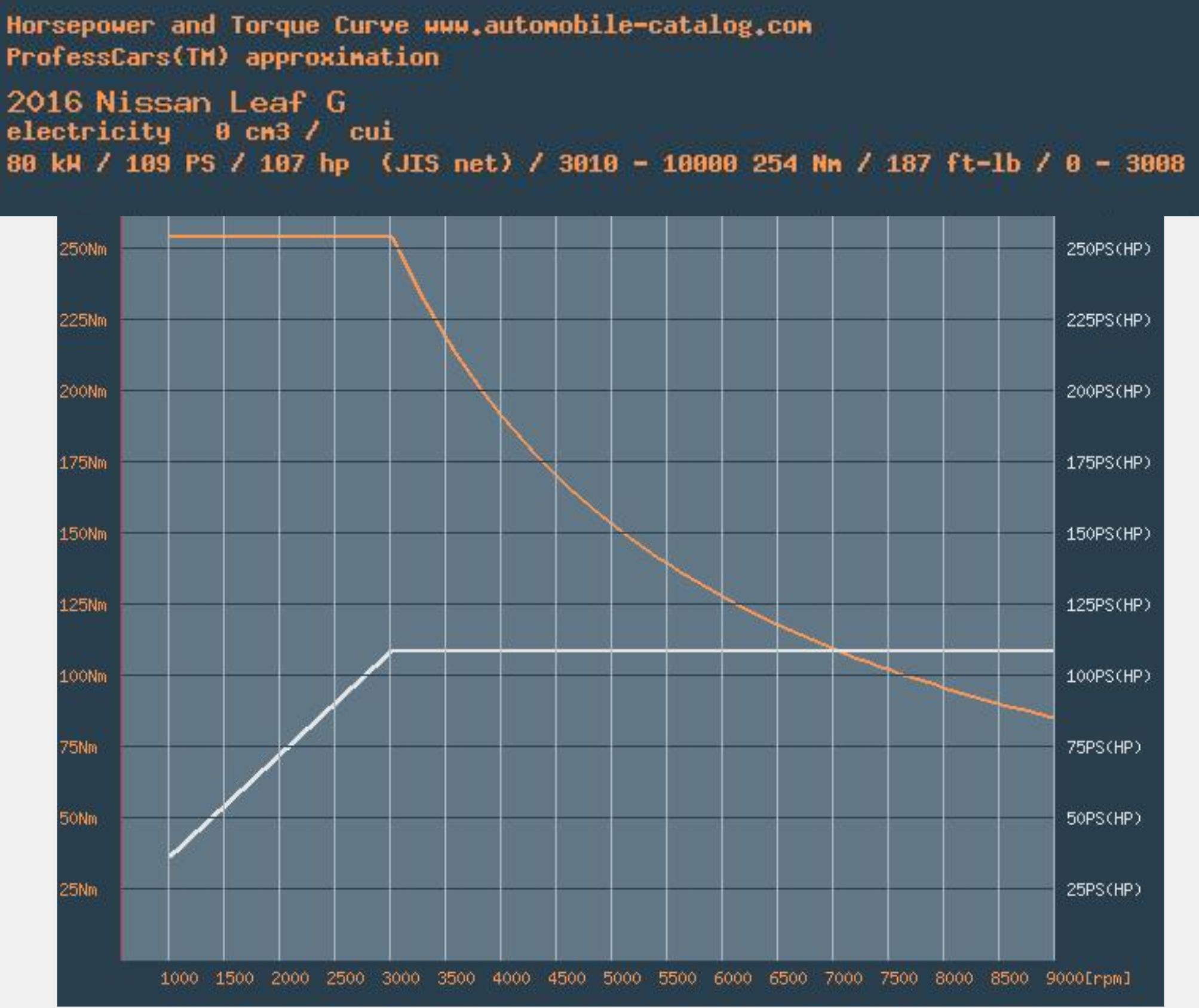

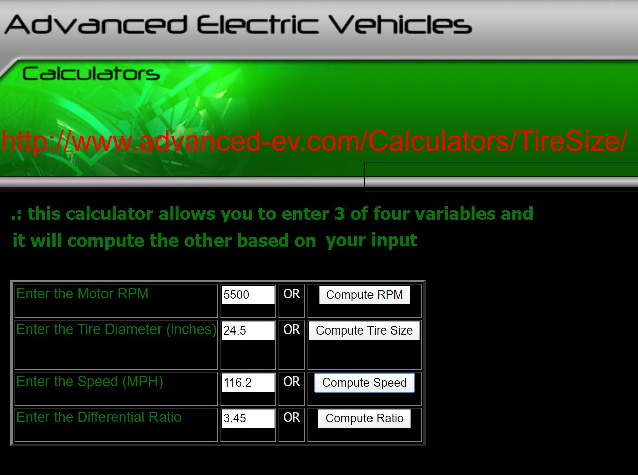

This is a nice project but I noticed it looks like you are intending to directly drive the rear axle from the Leaf motor.
All BEV motors have a gear reduction, in the 2012 Leaf's case 7.93 to 1.
What is your rear differential ratio? I think most MGB's rear axle's were somewhere like 3.xx:1 and as this will be your only gear reduction you may find this setup has something like 1/2 the wheel torque compared to a Leaf, unless your tyres are substantially smaller?
Obviously you will be lighter than the leaf, so maybe this and with a smaller tyre dia this might work?
Tom.

Hi Tom, Thanks. Yes there is no transmission.
Here is what I used to calculate the rpm vs speed
And this for the Torque for the Leaf EM57
Looks like 0-3000 RPM full torque. at 3000 RPM car will be doing 55mph. At 5000 RPM 116mph. Not that I want to go that fast.....

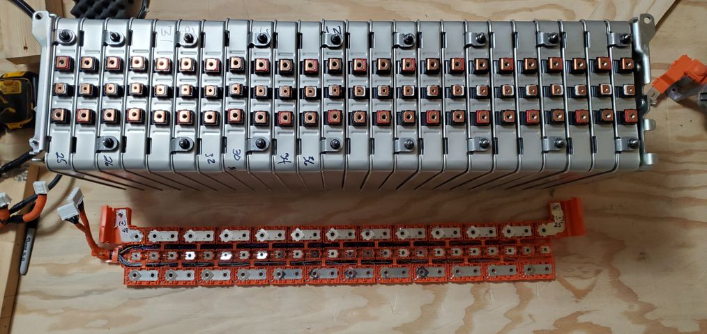

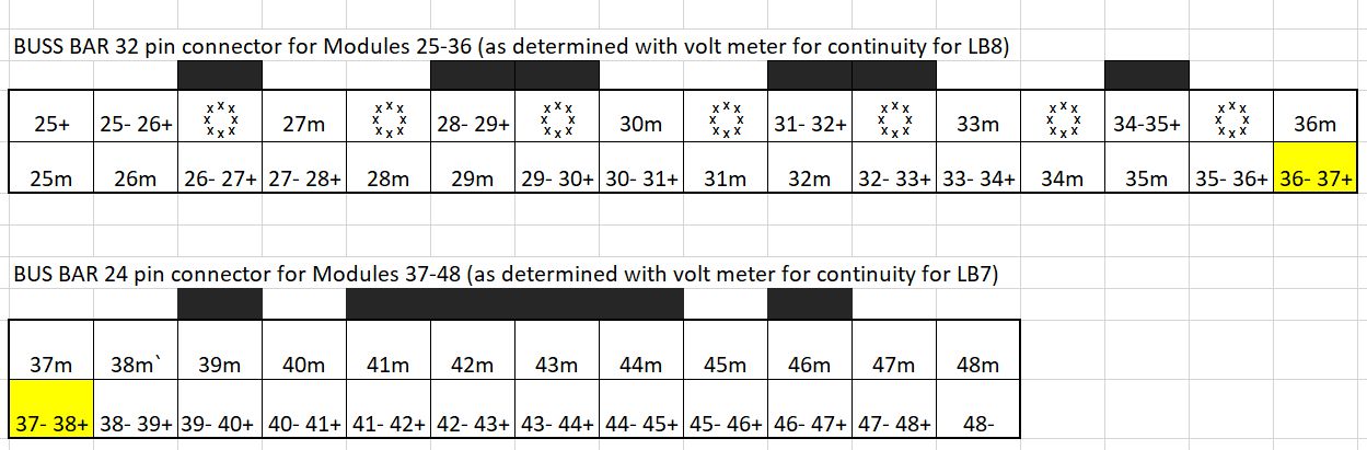

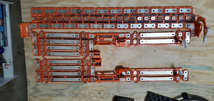

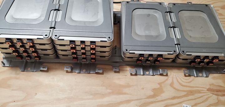

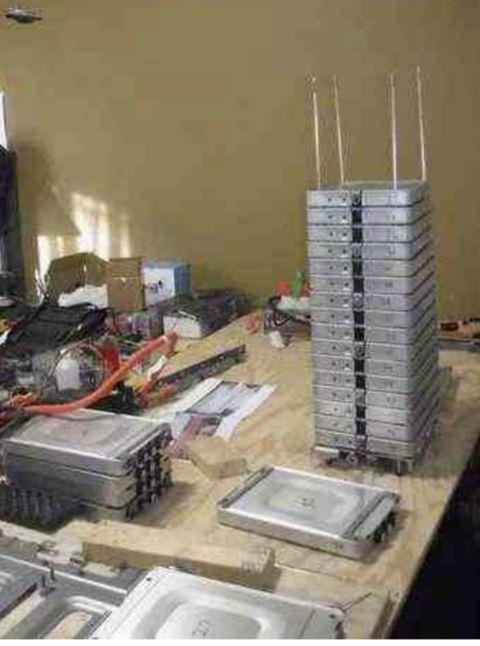

Continuing the progress report.
My next step was to build a second 24 module pack from the two 12 module battery packs. I plan to mount them cross ways to the frame. One in the trunk and one behind the seats. I located a buss bar from someone that just sells the modules online. And using info from Wolftronix.com rewired the pins from the Buss bar BMS connections to match the 12 module bus bars.
1. Remove the buss bar and disassemble the 12 Module packs. 2. Stack the modules onto the 24pack frame rods. NOTE Pay attention to polarity. I made a mistake and smoked the BMS! 3. Layout the bus bars 4. Disassemble the connectors from the 12 pack and from the 24 pack buss bar. Map out the BMS Connections for the 12 packs. One has a 32 pin connector the other a 24 pin connector. Using a tine flat head screwdriver you can remove the face of the connector and pop the keeper up (see pictures. pop open the connector keeper 5. After that you can map the pins coming from the 12 module packs. Here is my map. But as I said I smoked my BMS. I think it was how I stacked the modules. I should have started in the opposite polarity. Anyway you should always validate your work before connecting your BMS. 6. To pull the pins from the 24 pack you will need a safety pin (large Diaper pin). Look at the face of the 32 pin connector. Each hole for a pin has a lock at the top of the hole above the pin. Using the Diaper pin you can stick it into the hole from the face, above the pin at an angle (down towards the pin) catch the lock and lift it. Then pull the pin out the back. Once you have them all out you can reinsert the pins into the proper holes. 7. Now attach the modified (for the BMS) busbar back to the newly constructed 24 module pack 20211217_081805-Copy-Rotated.jpg
I purchased my replacement BMS and am waiting for it to arrive. While I wait I am going to disassemble the new 24 module pack and try to see where I screwed up.

The Nissan Leaf gear reduction of 7.94:1 would give you a wheel torque of 2223Nm! which is what makes it feel 'sprightly' off the line.
One of the many benefits of electric motors is much higher RPM's - 10,300max for the Leaf motor - which means you can use gear reduction to increase torque available at the wheels and acceleration.
From this paper you can see the leaf motor efficiency suffers when at high torque and low rpm:
https://www.energy.gov/sites/prod/files ... 2013_o.pdf
I hope you don't mind me commenting, it might work fine - what do I know, I haven't yet built an EV! only in my head
There are lots of people using the Leaf motor attached to a gearbox - so having no reduction gear would be effectively like driving all the time in 4th (normally 1:1. Maybe this work's ok? maybe someone can comment how it is in the 'real world'! sure it would be fine cruising along, but might struggle with hills?

I usually drive that heavy Touran around in 3rd which I consider quite agile. In 2nd gear it is a real blast and traction control still kicks in around 60 km/h. In 4th gear it is well drivable, goes up steep inclines and just feels a bit sluggish off the line. So if you don't feel the need to show everyone that EVs are faster off the stop light but rather enjoy cruising, you should be fine with only the diff ratio.
Interesting real world feedback!johu wrote: ↑Thu Jan 13, 2022 10:45 am I usually drive that heavy Touran around in 3rd which I consider quite agile. In 2nd gear it is a real blast and traction control still kicks in around 60 km/h. In 4th gear it is well drivable, goes up steep inclines and just feels a bit sluggish off the line. So if you don't feel the need to show everyone that EVs are faster off the stop light but rather enjoy cruising, you should be fine with only the diff ratio.
So should be fine as is - if you want to go chasing MGBV8's consider a gear reduction
