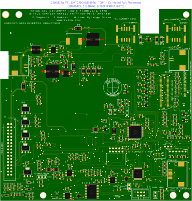

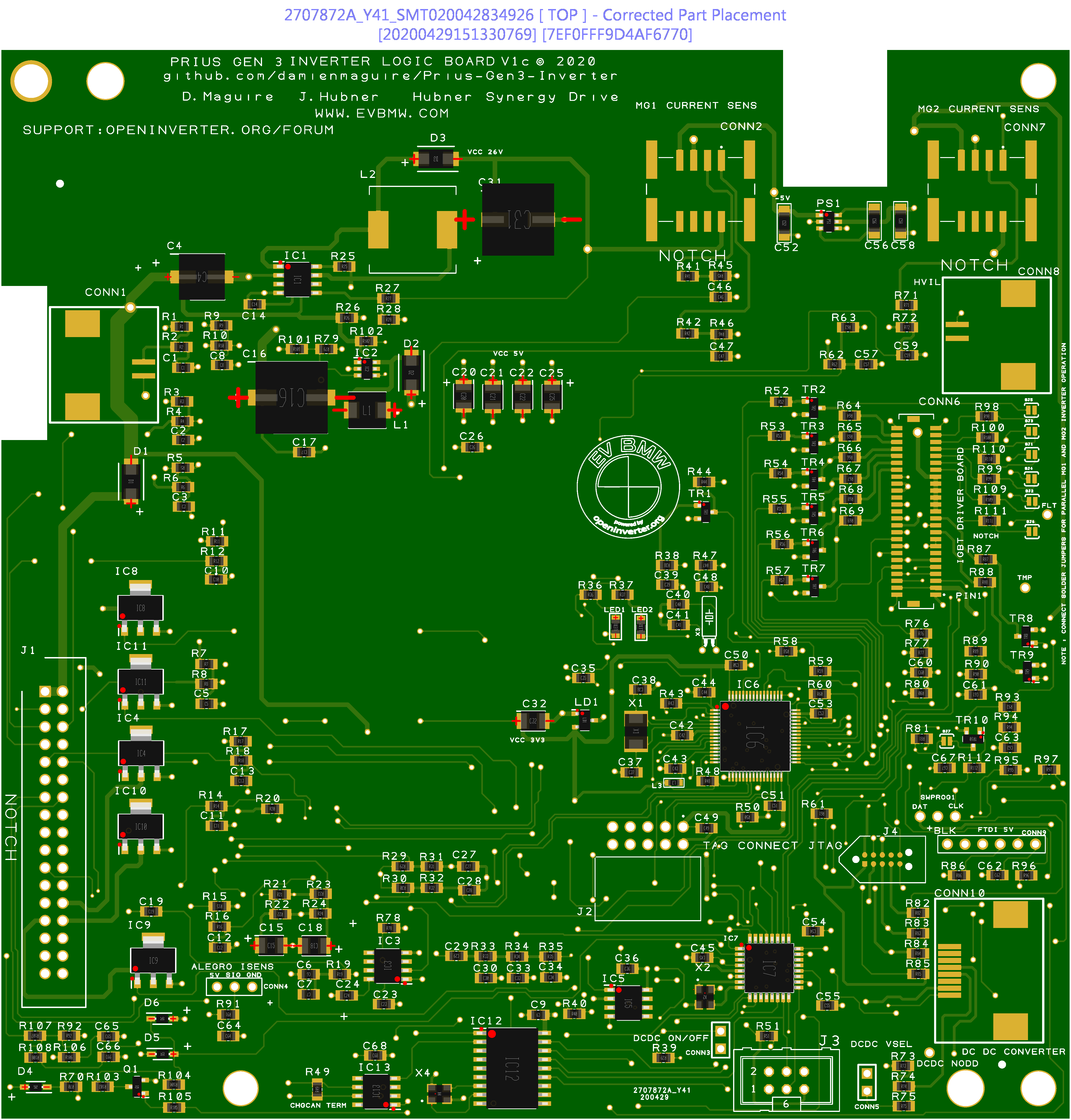

Please see attached schematic for new rev of prius gen 3 logic board.
Changes :
1- Boost converter based charger atmega328 pinout now as requested by celeron55. Includes evse control and can bus connections.
2- added optional resistors to allow parallel drive of MG1 and MG2 power stages for experiments with dual motor and / or increased current output.
3 -Changed resolver exciter to TDA2822 (ripped of Johannes design yet again)
4 - added resistors to allow setting of dcdc converter 12v output voltage
5 - i/o pins via 34 way idc header. A separate board to be mounted on the case connects via a short ribbon cable to an Ampseal 35 way header.
So hopefully this puts us a step nearer an integrated inverter / charger / dcdc converter module. I will leave this schematic out there for a week to allow for comments before starting pcb layout and prototype order. The same design will then be applied to the Yaris / Auris board design.

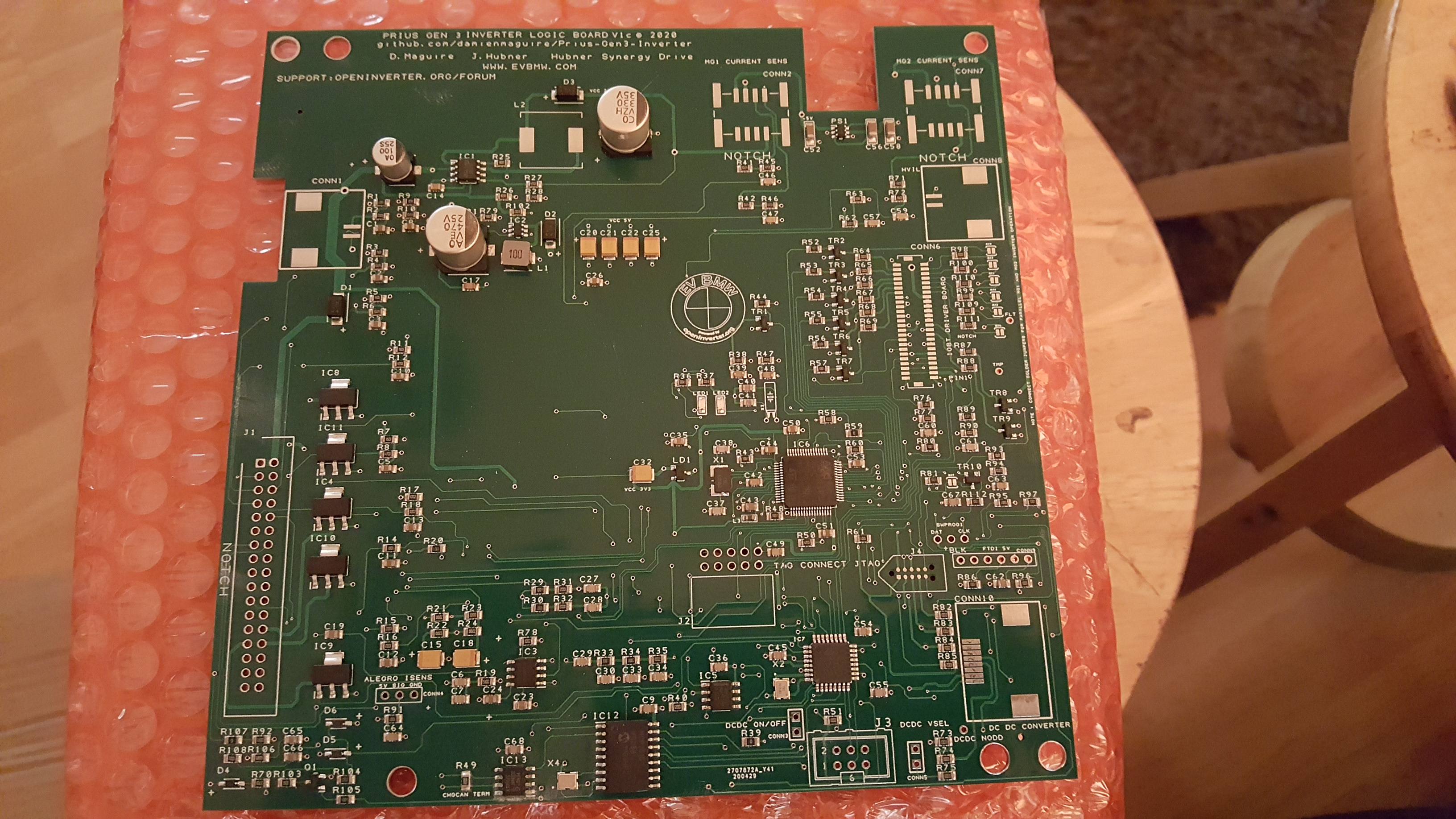

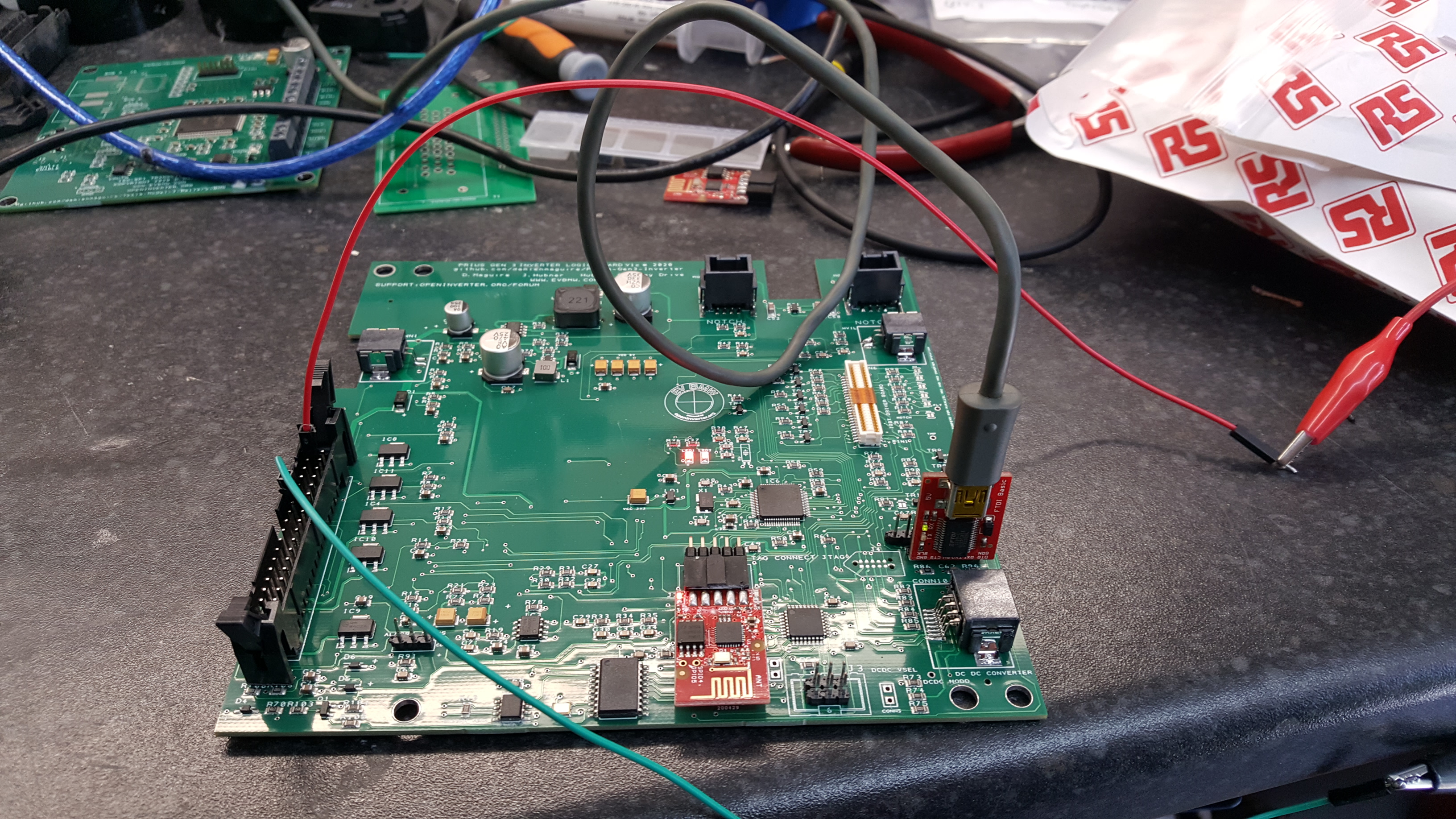

New boards arrived from JLCPCB. Once I get back working I'll test and update the webshop.

Hah! Wicked looking connection plate there.Jack Bauer wrote: ↑Tue May 12, 2020 11:23 am New boards arrived from JLCPCB. Once I get back working I'll test and update the webshop.

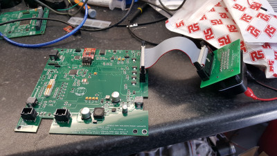

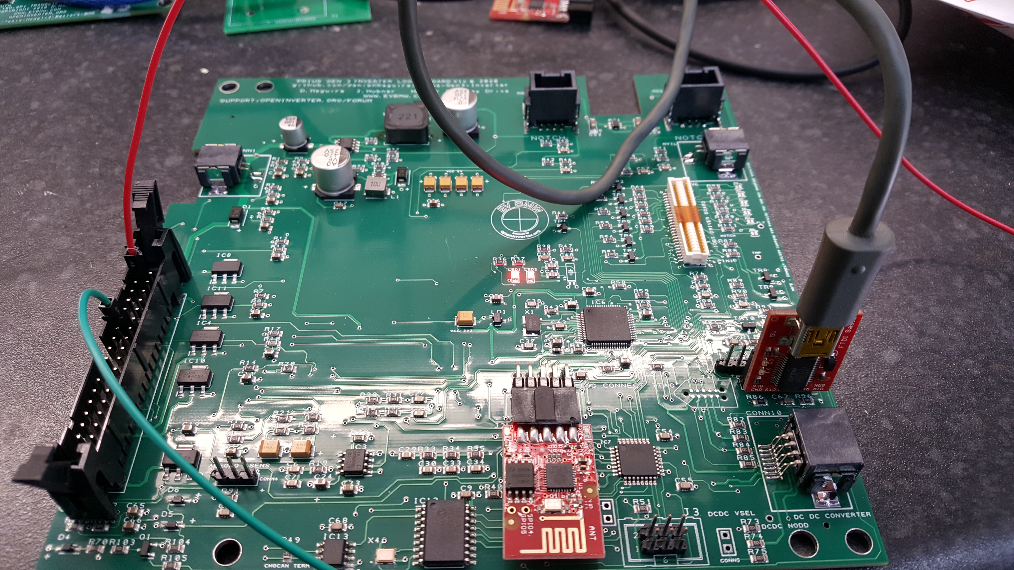

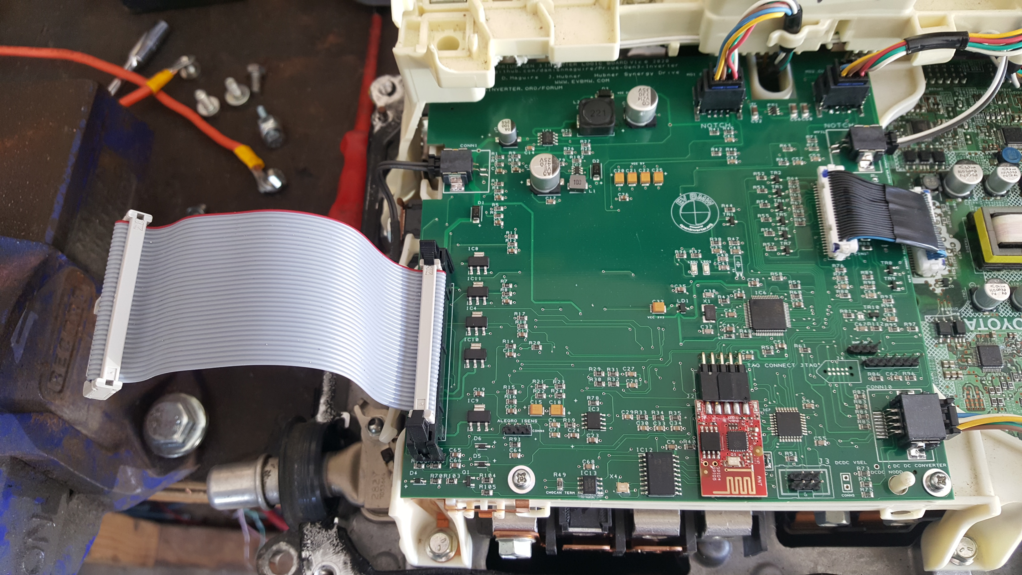

Getting some relief from the back pain so did a little work on the prius board. Powered up and tested the inverter section. Also tested the atmega328 and the mcp2515 can. All working perfectly. Will see if I can get it in the inverter tomorrow.

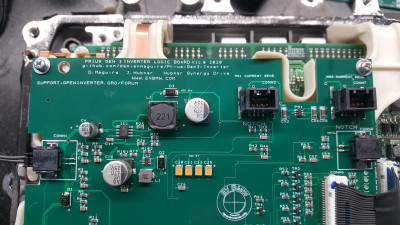

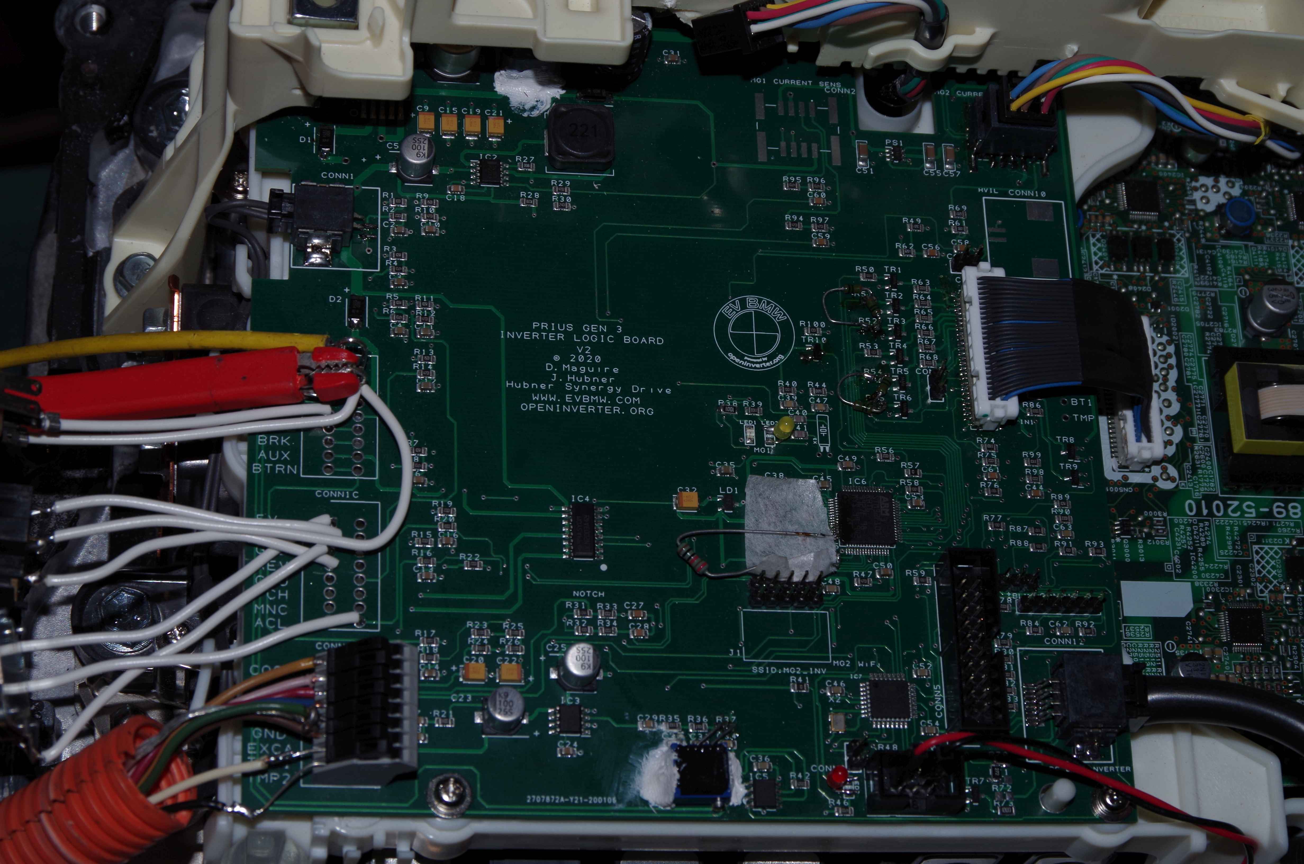

Today I got the Yaris Inverter running with Damian's board and I can turn the engine.
I have Damian's partially populated board and had some difficulty getting it to work with the FOC software and a Lexus MGR. Not perfect yet, but it works.
There are a few points that almost drove me crazy and will definitely help others.
PIN 15 on the STM32 is open and mostly, but not always, caused me an error as soon as I started the inverter. The error did not appear in the error list, it was only displayed in the parameter list in run mode. After pull up to VCC with 10kOhm, it's OK.
Now I could let the engine spin, but not as it should in the syncofs calibration script. Tested with a 36 V battery, the engine jumps at start-up and turns, or stops at 120 A current. After playing with Pinswap, the motor turns quickly with about 50 A current consumption.
Yesterday I had the idea to change the phases between the STM32 and the connector, since the Prius has its current sensors in phases 1 and 3 and not as in Johannes circuit diagram in 1 and 2. I crossed the resistors R51 and R52 as well as R54 and R55 and now the engine is running.
I try to create a description for the WIKI with the other bugs I found, but it can take a few more days.
The picture shows the current provisional status of the board.
Martin

Nice work Martin. Do please document this as I can incorporate the mods into the next build.

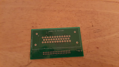

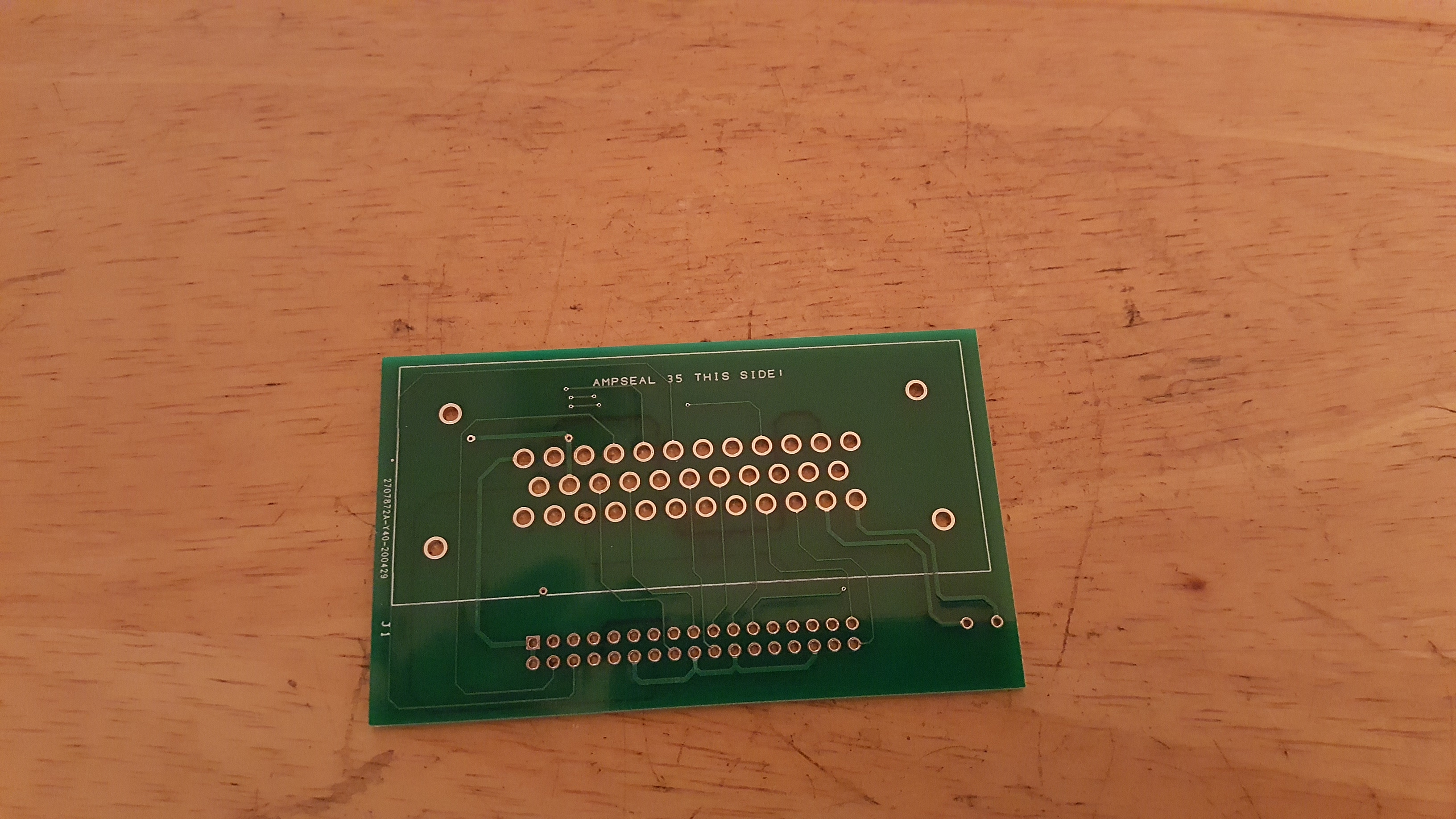

Draft pinout for the ampseal 35 way connector.
ampseal_pinout_v1c.pdf- (13.64 KiB) Downloaded 500 times

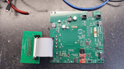

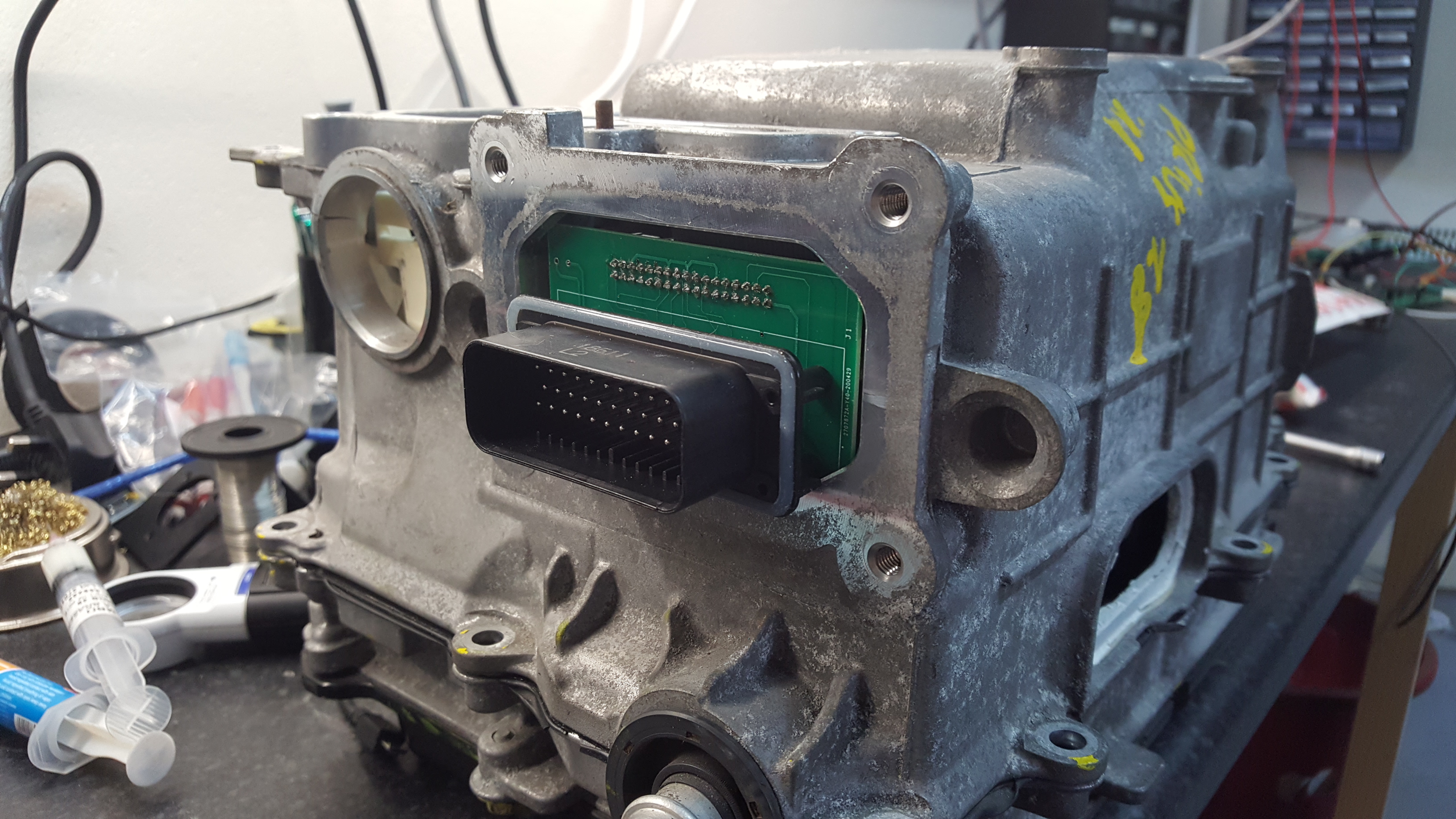

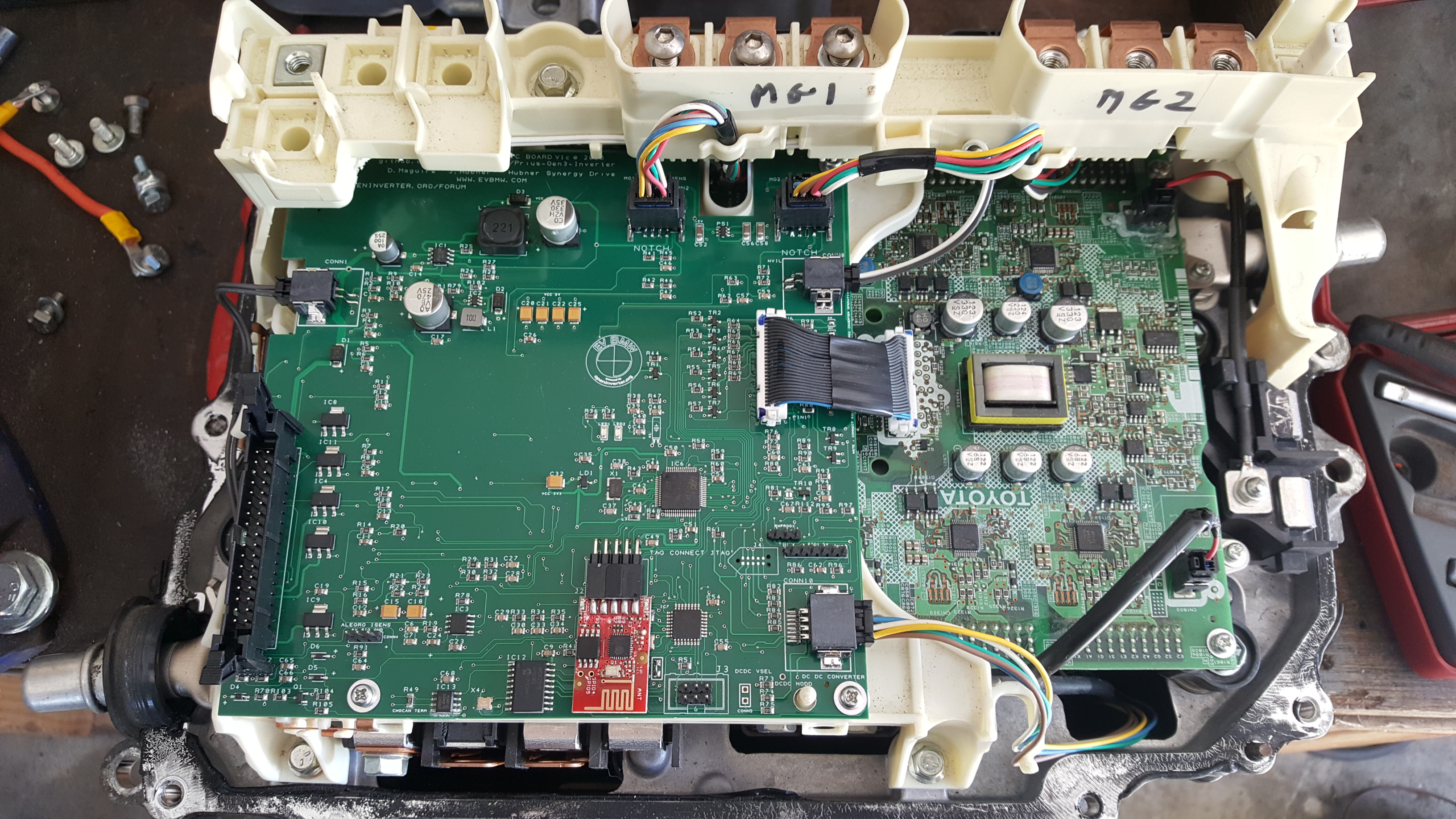

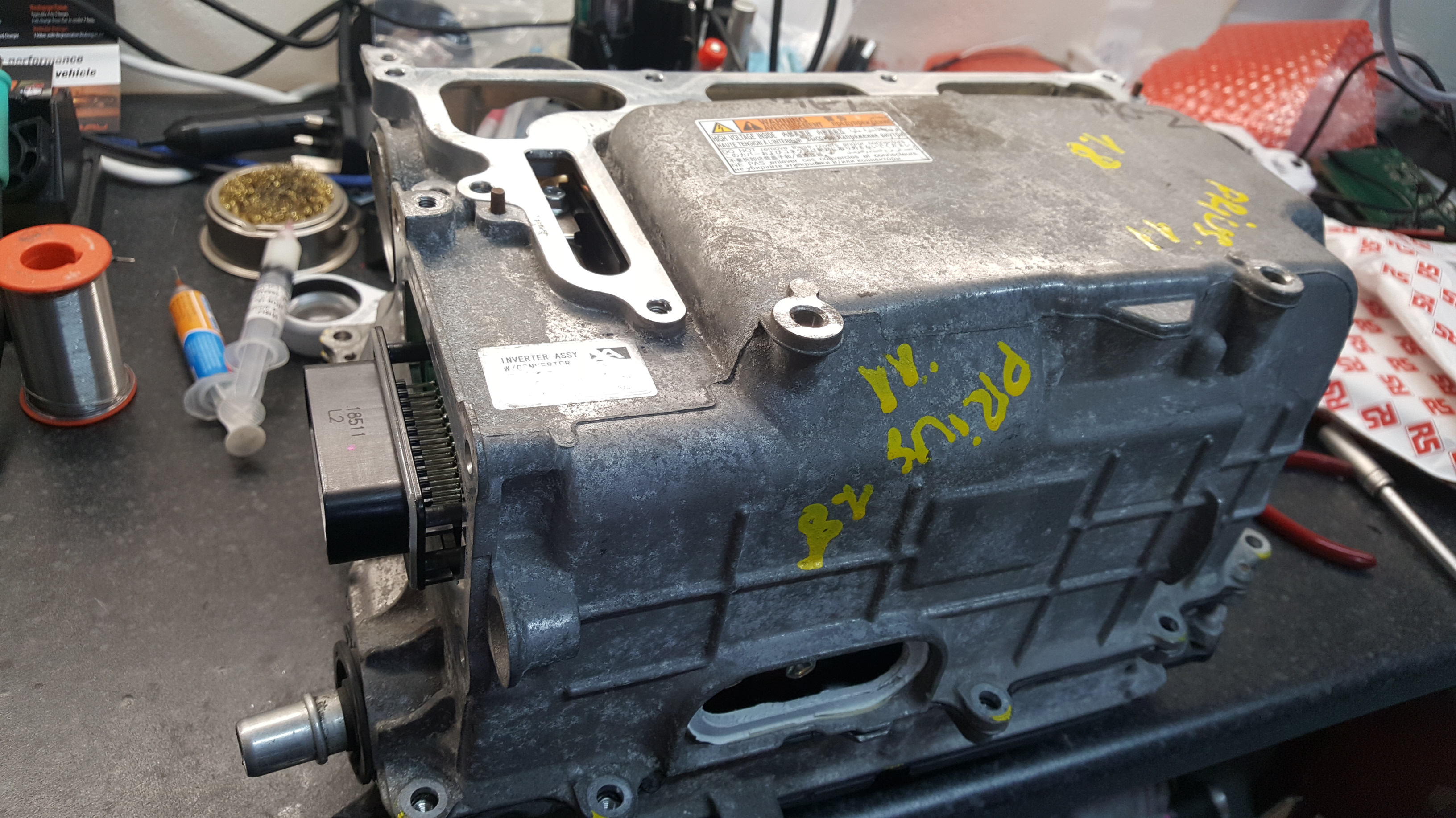

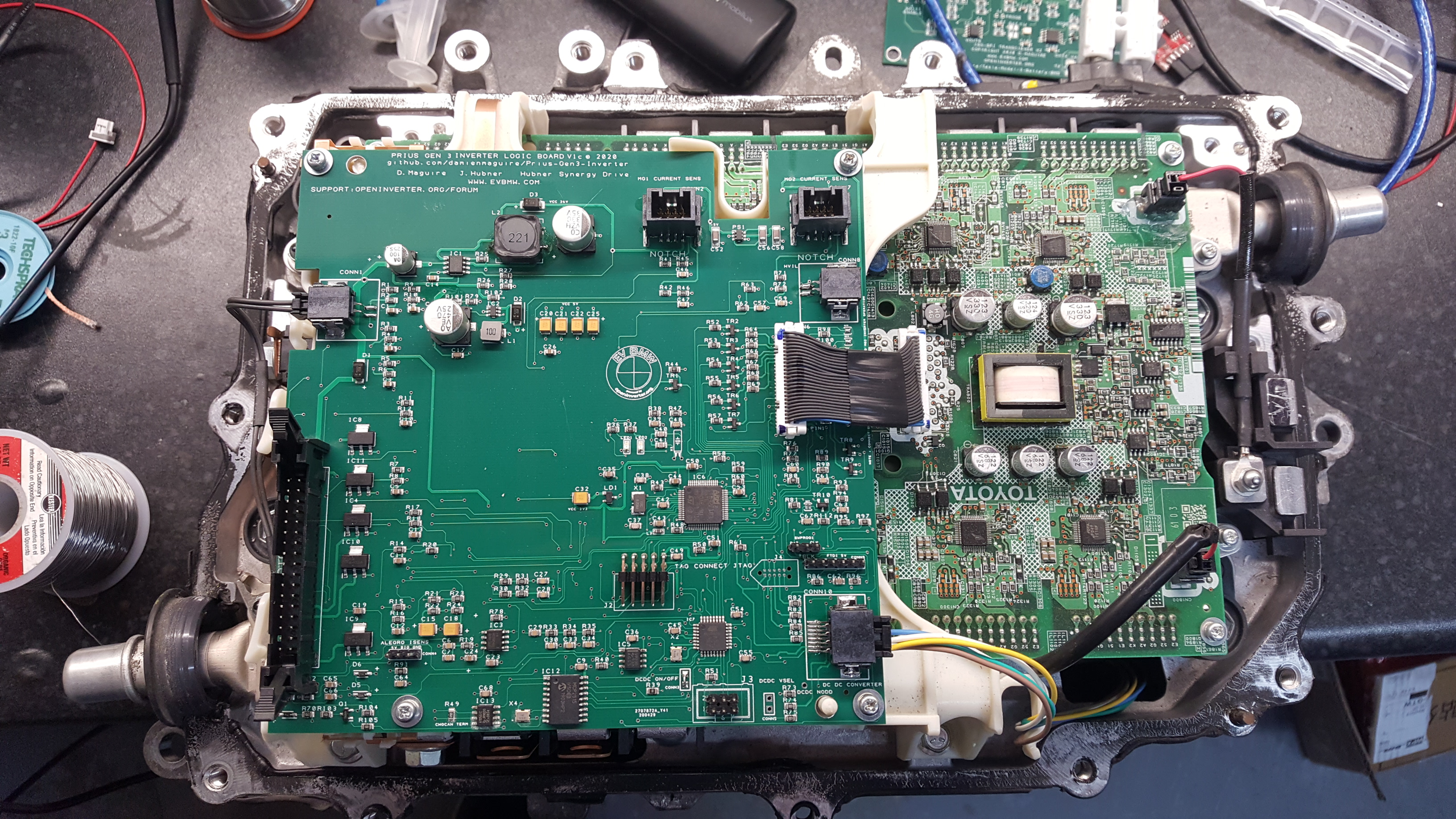

New board fitted to an inverter today. All seems to be working including parallel operation of MG1 and MG2 power stages. Will be fitting to the E39 soon for actual motor testing.
I have another unopened inverter here and my plan (back pain willing) over the weekend is to make a super long and boring video showing the board build up, programming and fitting to an inverter. This will serve as an installation manual. Board kits will then be for sale on the webshop.

In relation to the Pin 15 issue from a few posts back it worth noting that this just affects the DINOCUR flag not the actual status. If its high DINOCUR will read OK and if low will read ERROR but this will not stop the inverter from working.

For the PIN15 issue, is it possible that it is a spezific problem with the FOC software?
Each time when I press the start button I get PWM Signal for a few ms and then it stops, the inverter stayed in run mode, and got no error message, only in the parameter list it says ocurr error.
It make no difference it the powerstage had power and deliver current or not.
One time after flashing different software versions it runs, but then when testing the next day after power off from the board it was the same problem.
So I look for a reason, and after pull up PIN15 the board runs with ocurr OK and PWM Signals.
