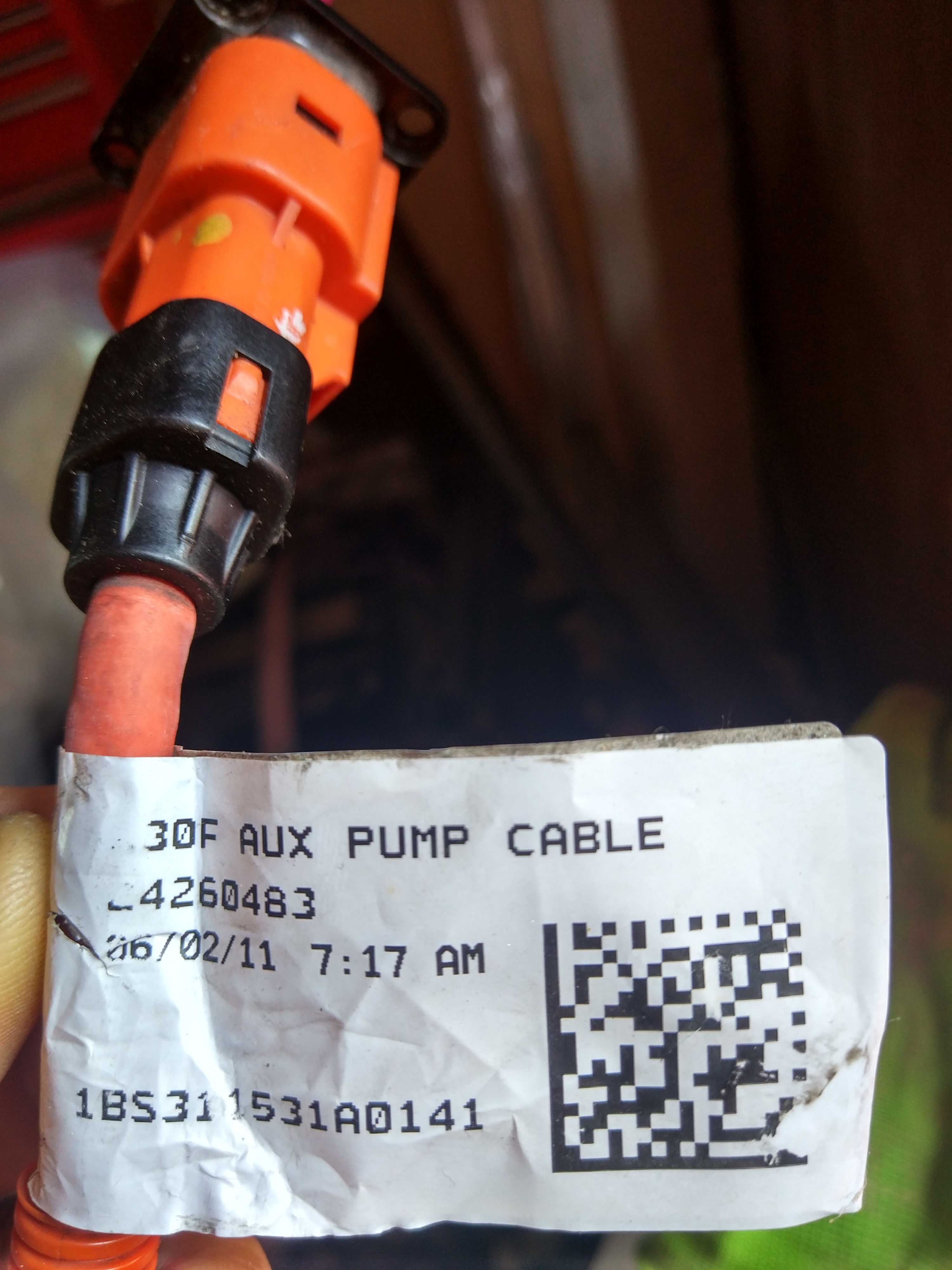

Yes, since I can't help with design circuits, I went hunting for connecter. Wasn't able to find connecter from inverter. Maybe 3D scan and remanufacture?
- Posts: 3580
- Has thanked: 134 times
- Been thanked: 344 times
Re: Toyota Prius Gen 2 Inverter Controller
I could use 3 fastons and epoxy resin and make myself a permanent bond.
On Volt inverter I also have 3p header with connector on transaxle. I can't find that part either. I was thinking of making a blank with grommet and took the cable out and coupe it directly to compressor. Less problems that way.
Anyone knows a good metal web-sock I could use to shield cables?
EDIT: It seems like it is YHVA280-3PXM connector and can be get at Mouser. Contacts are 2.8mm AMP MCP female. I may yet pull this off without sacrificing cables and plugs.

You could send a photo to connectorexperts.com They might be able to match it up.
- Kevin Sharpe
- Posts: 1339
- Location: Ireland and US
- Been thanked: 8 times
1587715-9 is a TE connector;
https://www.te.com/usa-en/product-1587715-9.html
1587727-1 is a TE connector;
https://www.te.com/usa-en/search.html?q=1587727
