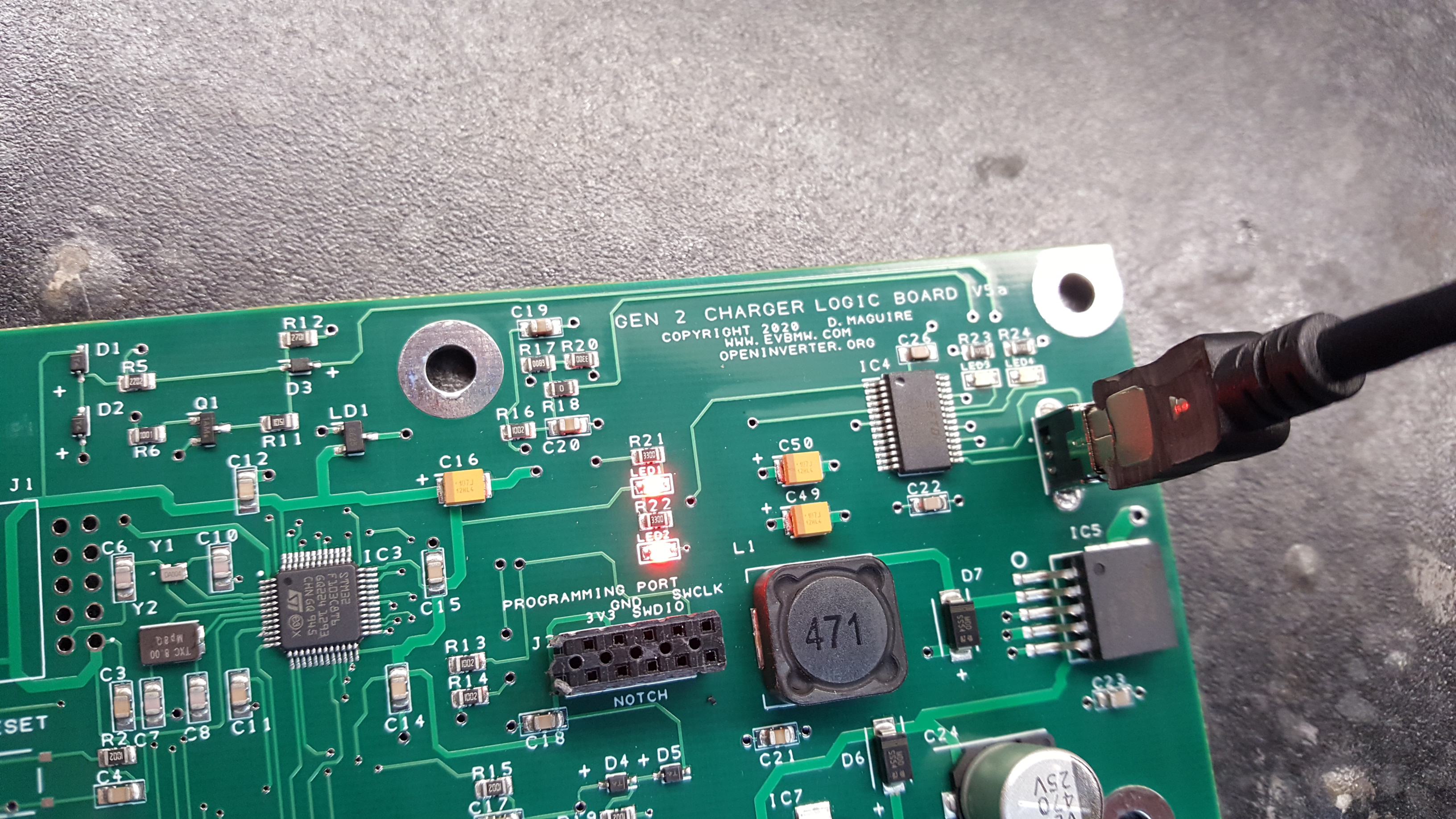

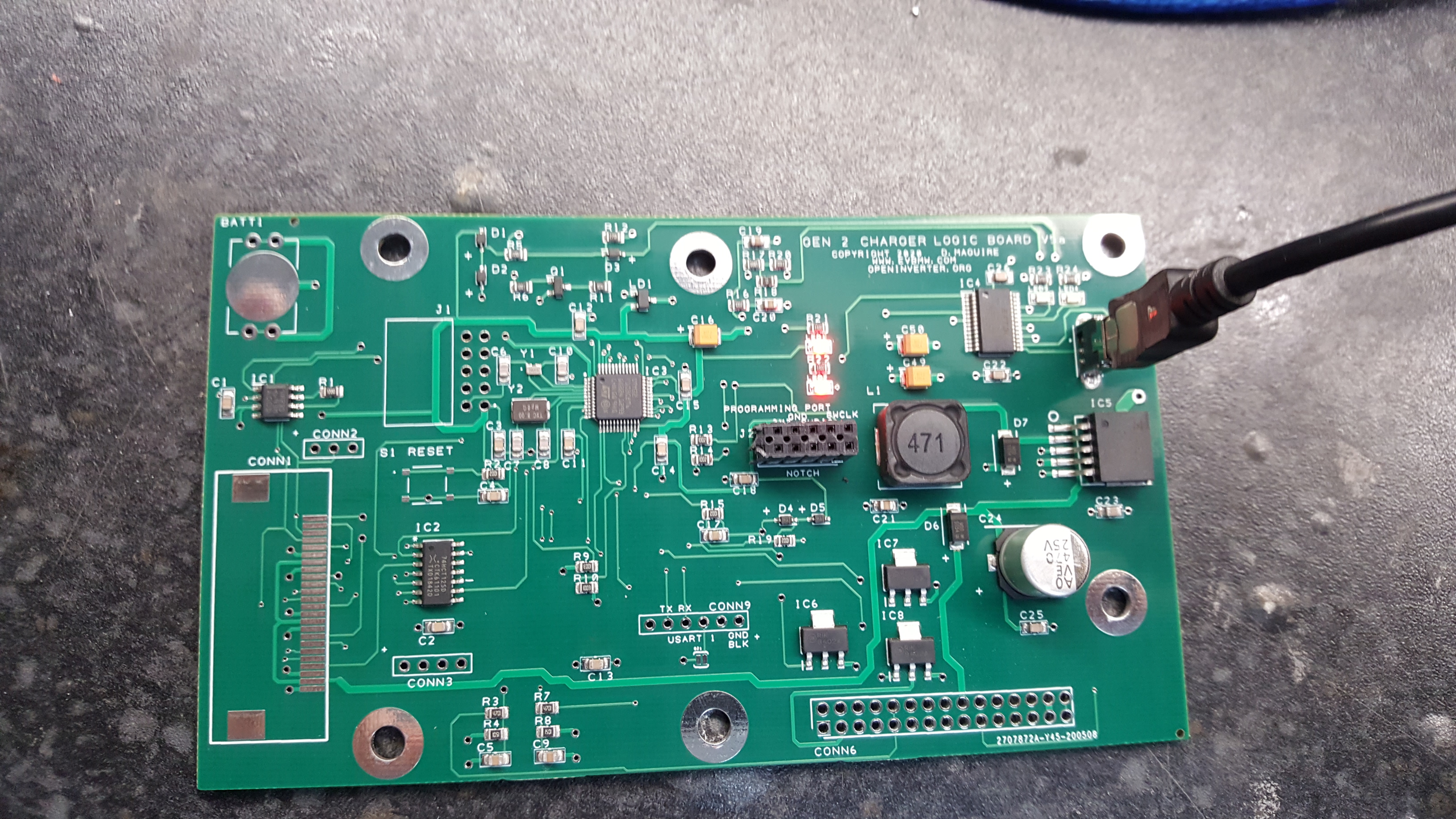

Posts: 3665
Has thanked: 11 times
Been thanked: 347 times
New rev of the V5 board now with usb onboard for configuration and monitoring.
Also ditched the ULN2003 in favor of the NCV8402 for contactor/relay driving so no more silly 12v feedback through the coils issue.

jon volk
Posts: 574
Location: Connecticut
Post by jon volk »
I like new programming port as well. Just shove the ST link on vs triple checking jumper polarity haha.
