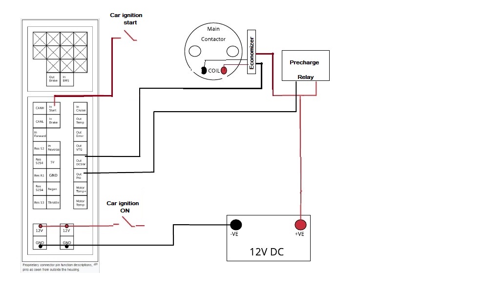

Is any one successfully running pre-charge and main contactor directly from the V3 board. I think this is the reason I fried my 1st board.
I have a second board now, I really want to be careful now, ( I dont want third time lucky).
So first time, I connected the a contactor to the pre charge out, the contactor which was just pulsing , although the current draw was within limit, so I connected the contactor via a small relay first. which worked ok for a couple of attempts. after that that's when the board shorted/overheated and does not work now. would the flyback voltage from the small mechanical relay cause this ?
So was that correct what I did ?
Is DCSW the output, for the main contactor ?
Is the process of pre/main a squence or timing only ?
Only other thought is make a Arduino setup to control the contactors independently from the V3 board and use the main contactor control signal to start the V3 board so there is no chance of trying to pull away on the pre charge and burn out the resistor.
I might do what Damian said on his video, and see if the small mobile repair shops can replace the smt parts on my first damaged board.

zippy500 wrote: Thu May 21, 2020 10:07 am I have a second board now, I really want to be careful now, ( I dont want third time lucky).
Can you show us a drawing of your wiring?
What contactors are you using?
What firmware version are you using?

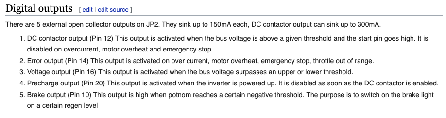

zippy500 wrote: Thu May 21, 2020 10:07 am Is DCSW the output, for the main contactor ?
Yes the DCSW is for main contactor, but does not have any economizer PWM function!
It's using the well known and reliable ULN2003, just remember to connect to 12V ALL time.
If not there is nowhere for the back EMF to go.
The main contactor is not closed before the UDCSW voltage is reached.

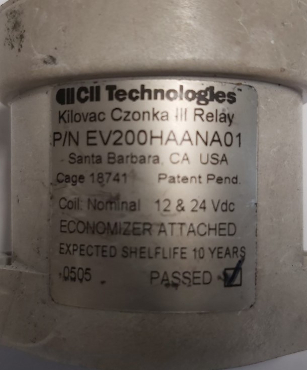

Please also supply a picture on the label on the contactor... the phrase "EV200" is not enough to determine which version of the contactor you are using.

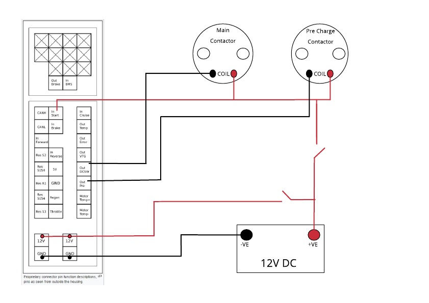

of course, ill make a drawing of circuit for the pre-charge and main contactors and take a pic of my contactors

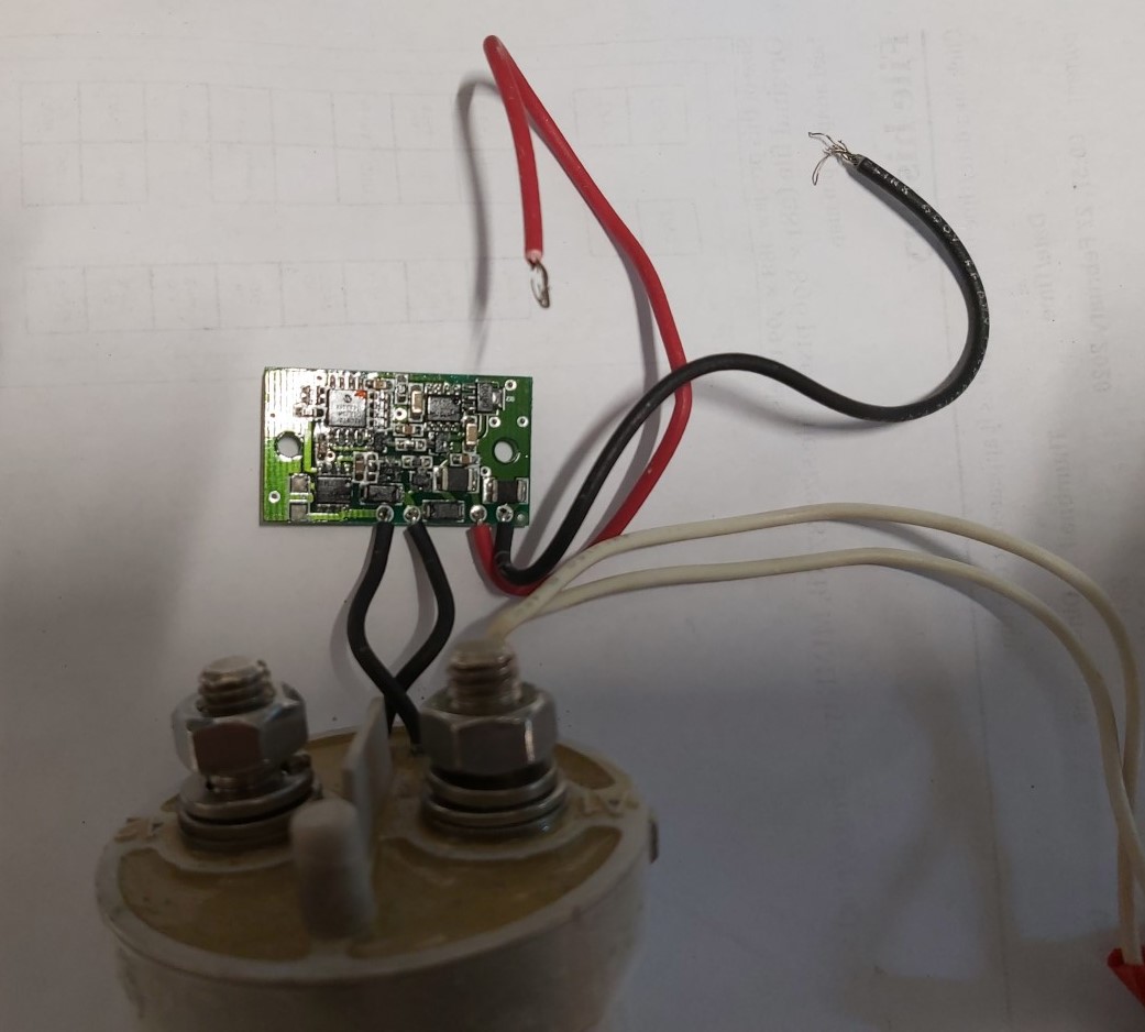

so here is the contactors I will be using.
The pic has the economiser pcb, can I just remove the pcb and use it without, I assume they are just the coil wires.
Are the white wires volt free contacts when the contactor is energized ?
This is how I intend to connect up to the leaf board.
Can someone tell me if this correct ?

zippy500 wrote: Thu May 21, 2020 7:52 pm so here is the contactors I will be using.
Wrong ;)
This is correct, the openinverter does not have PWM economizer output, as far as I know.
What is controlling your Negative contactor, normally the BMS

So the economizer style contactors are suitable then for this setup.I might try and get one of the leaf contactor packages

zippy500 wrote: Fri May 22, 2020 7:58 am So the economizer style contactors are suitable then for this setup.I might try and get one of the leaf contactor packages
IIRC the Leaf Contactors don't have economizer circuits built in.

I don't know how the Negative Contactor is driven in the OI Mainboard but as a rule we don't use external BMS to control this because of the risk it will destroy the inverter power stage if it drops out under power (a common failure mode when the Tesla boards are wired up incorrectly). We really need Johannes or someone with detailed knowledge to tells us what they have in mind.
A quick look at Main Board Rev 3 wiki (here) suggests that the negative contactor is not driven by the OI board. My guess is it's driven by the ignition switch but Johannes will need to confirm that.

I've attached the contactor datasheet. You can see the EV200HAANA01 part number tells you;
EV200 - 500A 900V contactor
H - Normally Open Contacts
A - 9-36V DV coil (requires external coil economizer)
A - 15.3 inch coil wire
N - no coil connector
A - bottom mount
01 - unknown
zippy500 wrote: Thu May 21, 2020 7:52 pm Are the white wires volt free contacts when the contactor is energized ?
yes
zippy500

zippy500 wrote: Thu May 21, 2020 7:52 pm This is how I intend to connect up to the leaf board.
I don't think you can drive the main contactor direct from the OI board. The contactor datasheet tells us the inrush current is 3.8A and holding current 130mA whereas the OI board is rated at 300mA max (150mA max for precharge output). A lot depends on the economiser circuit and whether it has a soft start feature. We really need Johannes thoughts on this and ideally a wiring schematic :)

I went with the Arduino relay board option in order to stay within the current limits of the board. The ones designed for use with things like the Raspberry Pi/Arduino/STM32 draw very little current themselves (around 20mA) or so, but can handle 10A on whatever they are switching.
I'm guessing you meant something like this:
https://www.amazon.co.uk/ELEGOO-Optocou ... 06XK6HCQC/
I found them pretty easy to get working pulling 5v from that output on the OI board to power them and then using them to switch 12v to the contactors. I have the OI board DCSW and Precharge signals as the inputs on the relay board.
It may be overkill, but it's been pretty stable and it means I don't have to be too concerned about the specs on the contactors.
