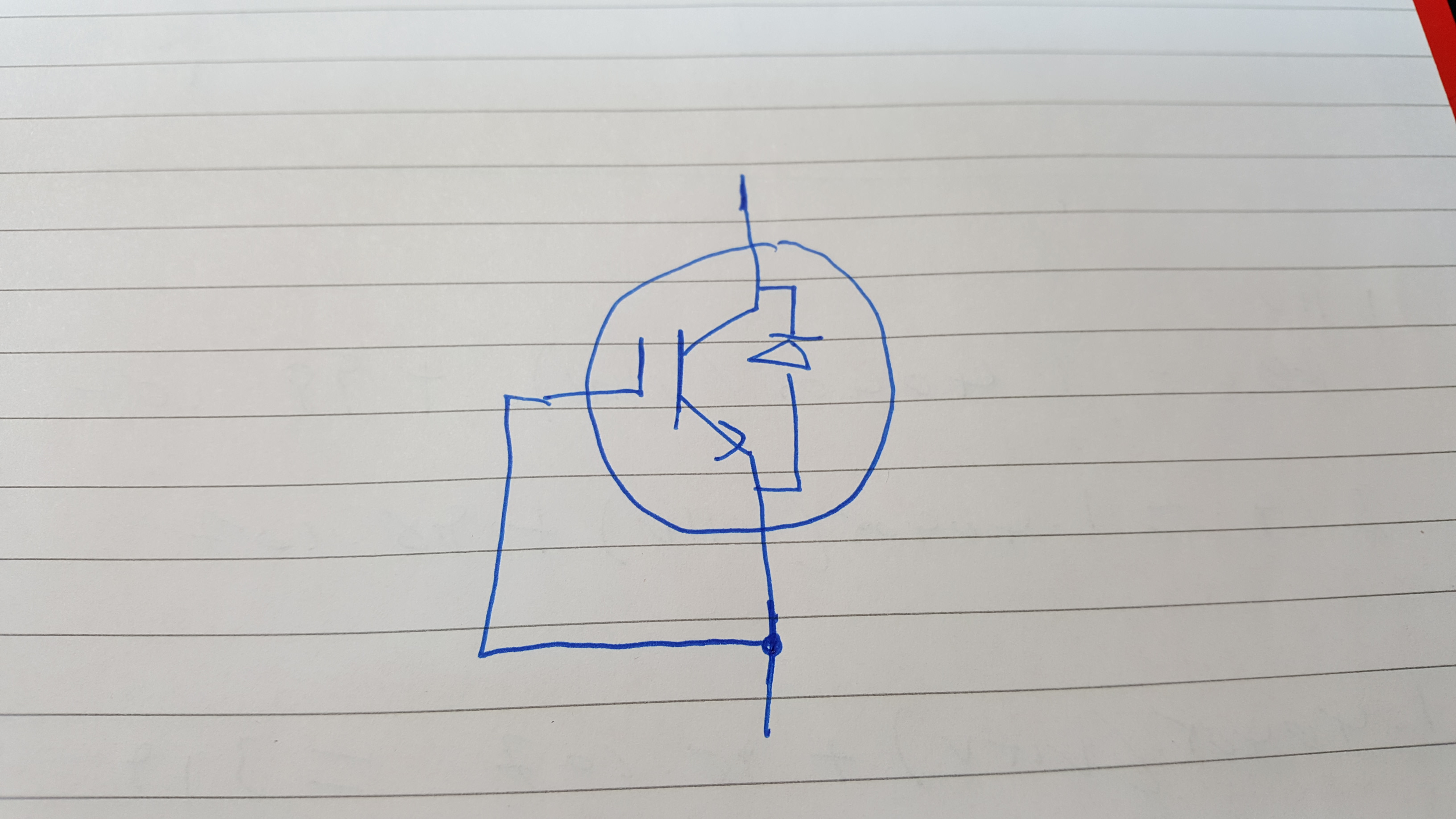

Much as I'd love to join in with a clickbait video of my own I'm too busy getting to grips with the new foc inverter firmware. In the meantime what do you think of my little sketch?

Re: Tesla Model 3 Charger
Post by clanger9 »
Brilliant!
Ah well, all clear. I see what you mean about the clickbait. Teslaworld is proper weird...

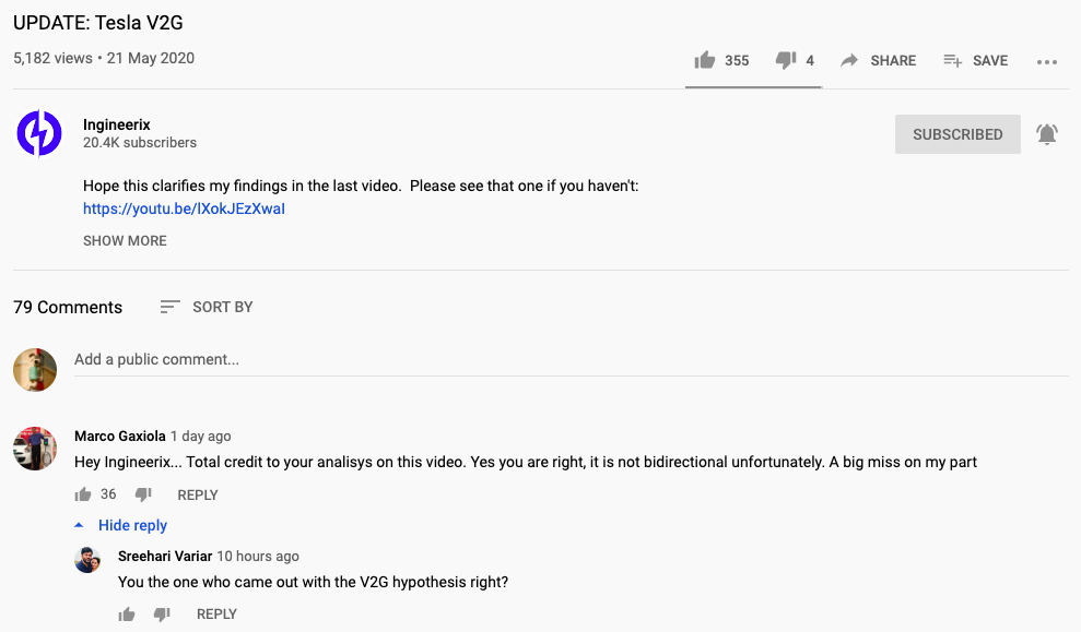

The guy who undertook the PCS analysis and hypothesised V2G capability has now said "it is not bidirectional unfortunately. A big miss on my part" :(
Ok. So how does any of this explain what I observed?

Post by Isaac96 »
Well of course you must have been hallucinating. No other explanation.
In all seriousness there must have been a hardware change between the parts that these guys have and the charger that you have. Living on the cutting edge :)

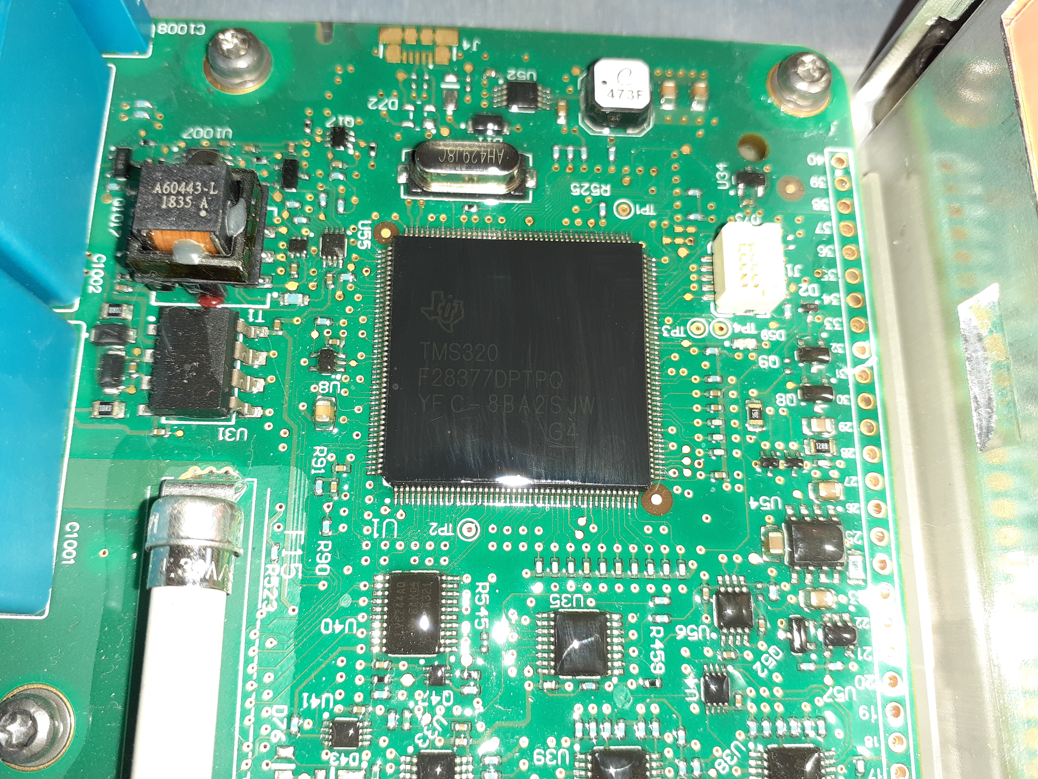

Can anyone take a hi-res picture of the PCS or otherwise tell me the part # of the TMS320 chip(s)? BTW, there should be two CPUs on the PCS. I assume one handles charging and the other DC/DC but I don't know that for sure. All I know is that it has two CPU cores, either both on one chip or there are two chips on there.

collin80 wrote: Mon Sep 07, 2020 1:47 am All I know is that it has two CPU cores, either both on one chip or there are two chips on there.
I think it's one chip (see video)... i'll try and take a photo when I'm next in the workshop :)

Post by muehlpower »
There is only one processor

Post by collin80 »
muehlpower wrote: Mon Sep 07, 2020 11:50 am There is only one processor
Awesome! Thank you. That indeed is dual core!
