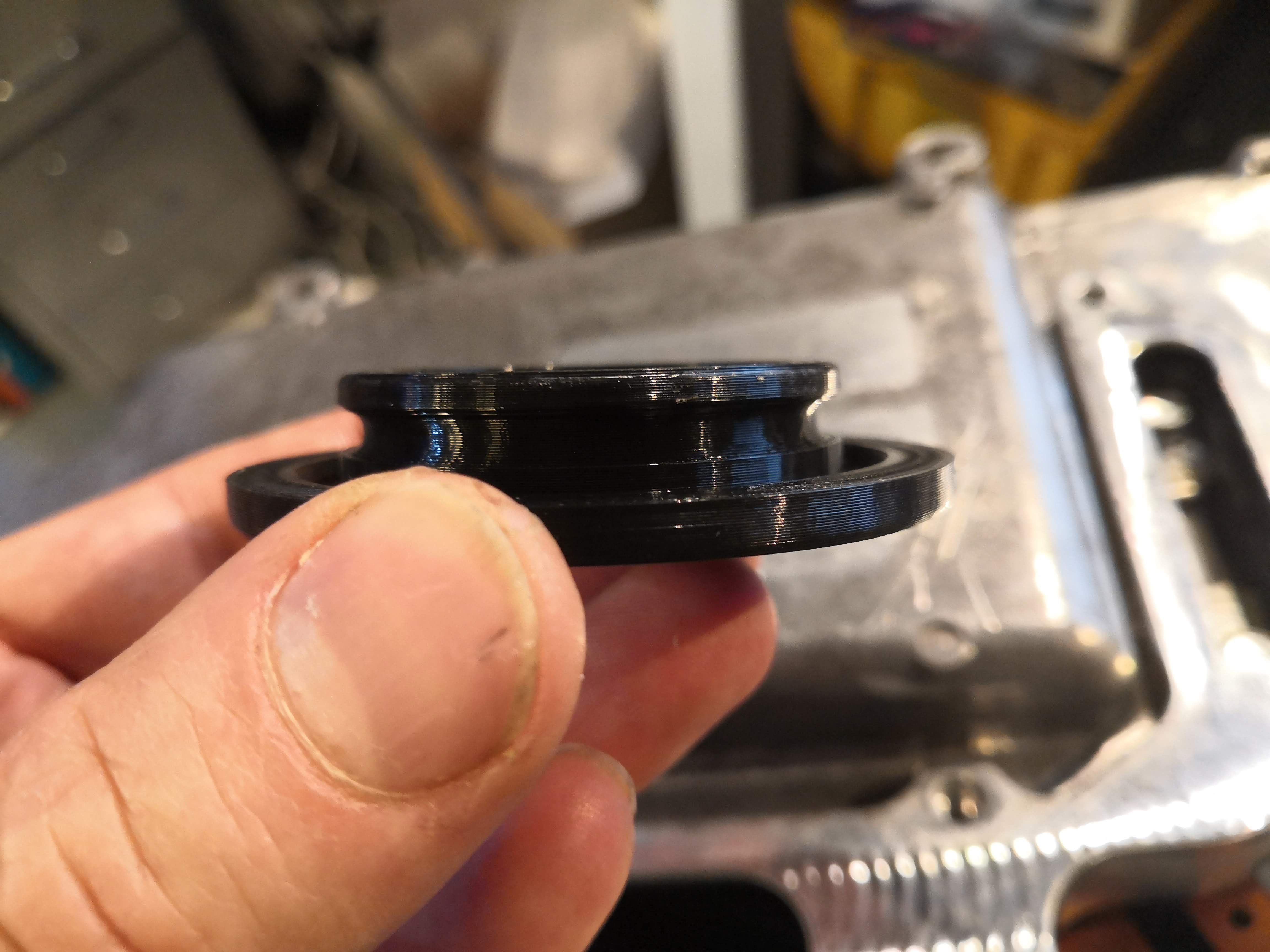

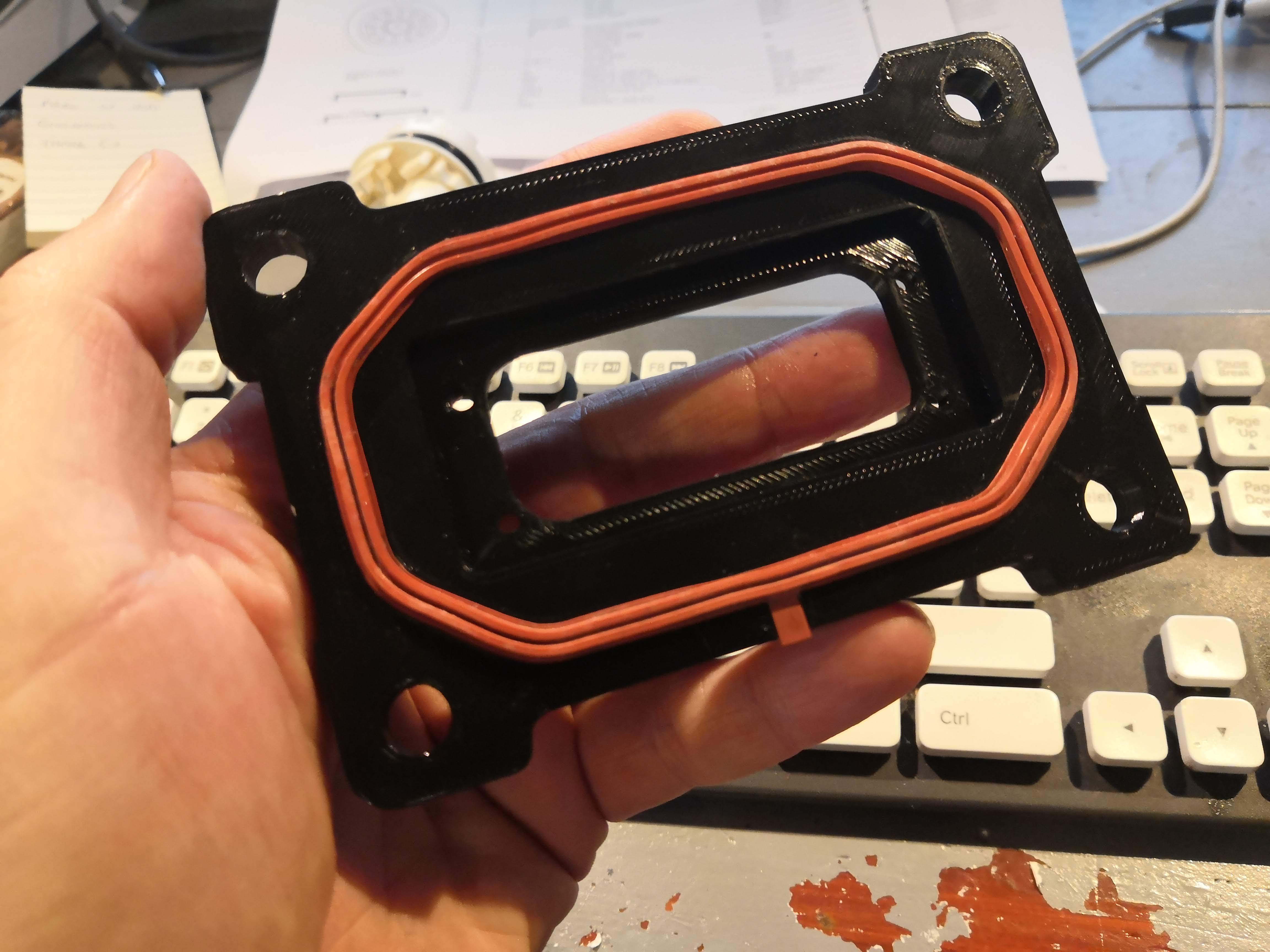

Wrong way=) groove must contain a red sealant and face towards inverter=)
Also socket must go thrue plate like this:

Aha! I did wonder. Reinstalled the right way around, with the seal.

So how it sits? Does it fall off or hangs in? It is pretty soft so I believe when you tighten all bolts there is no gap left between plate and casing?bobby_come_lately wrote: ↑Sat May 23, 2020 4:06 pm Aha! I did wonder. Reinstalled the right way around, with the seal.

Fits fairly well. But printed in PLA there's a bit of bowing around the middle from the pressure of the sealant ring - see picture. I wonder if it would be better in ABS/PETG? Or whether it's worth stretching the mounting holes out a fraction of a millimetre to provide some tension?konstantin8818 wrote: ↑Sat May 23, 2020 4:14 pmSo how it sits? Does it fall off or hangs in? It is pretty soft so I believe when you tighten all bolts there is no gap left between plate and casing?bobby_come_lately wrote: ↑Sat May 23, 2020 4:06 pm Aha! I did wonder. Reinstalled the right way around, with the seal.

Done a quick blanking plate for the old battery connector hole. Not fully tested yet - waiting on some 47mm o/d o-rings that should provide a snug fit.

Maybe when ampseal socket will be screwed to plate, it will straighten it. Or maybe oppositebobby_come_lately wrote: ↑Sat May 23, 2020 5:38 pm Fits fairly well. But printed in PLA there's a bit of bowing around the middle from the pressure of the sealant ring - see picture. I wonder if it would be better in ABS/PETG? Or whether it's worth stretching the mounting holes out a fraction of a millimetre to provide some tension?
Anyways, I've made second version: with 10mm offset to make it more sturdy. Looks almost OEM

It's on the printer now Konstantin - I'll let you know how it comes out tonight.

So, printed revised plate. See photos. Still a little bowing but much, much better. As you can see from the other pictures, that rubber gasket is both fairly thick and quite stiff. May need a stiffer plastic to get a really tight fit, or a deeper channel for it?konstantin8818 wrote: ↑Mon May 25, 2020 5:36 am Much appreciated! Will test it on johu's new board hopefully. I've bought gen3 inverter dirt cheap, 15 euro or so, and as I expected, boost IGBTs are blown(and I can't see deep inside to find out how's mg1 and mg2 IGBTs are feeling), so unfortunately no full efficiency from Damien's board for me, unless I'll use it as dual motor controller with separated charger.
Did anyone printed second version of the plate? Maybe improvements are needed?
Bigger issue is DFM now - I printed without support as I didn't want to dig material out of the channel for the gasket but that leaves a lot of spaghetti with the overhang.
What are you designing in? If it's Fusion360 would you be happy to share the raw design and I can do some iterations?

I'm working in Kompas 3D. Ain't Fusion360 capable of working with .stl? I have it but don't like to use it because it is heavy and it rely on internet connection, and my internet is prehistoric...bobby_come_lately wrote: ↑Wed May 27, 2020 5:55 pm What are you designing in? If it's Fusion360 would you be happy to share the raw design and I can do some iterations?
As for the part itself, I'll make groove a little bit deeper, but it would be great if you measure how far sealant is poking out, so I won't overkill

I can pull in STL but F360 allows cloud sharing of raw files - all the sketches and features - which means it's easier to make tweaks. But as you say, it is *very* dependent on internet connection.
My cheap calipers say the gasket is currently protruding 2mm from the face.

In original plate gasket pokes out like 1,5mm and from your photos I can't really tell if it fits perfectly inside the groove.bobby_come_lately wrote: ↑Wed May 27, 2020 7:34 pm My cheap calipers say the gasket is currently protruding 2mm from the face.
So I've widen the groove 0,3mm inside and made it 0,5mm deeper. I hope now it should fit like a glove
