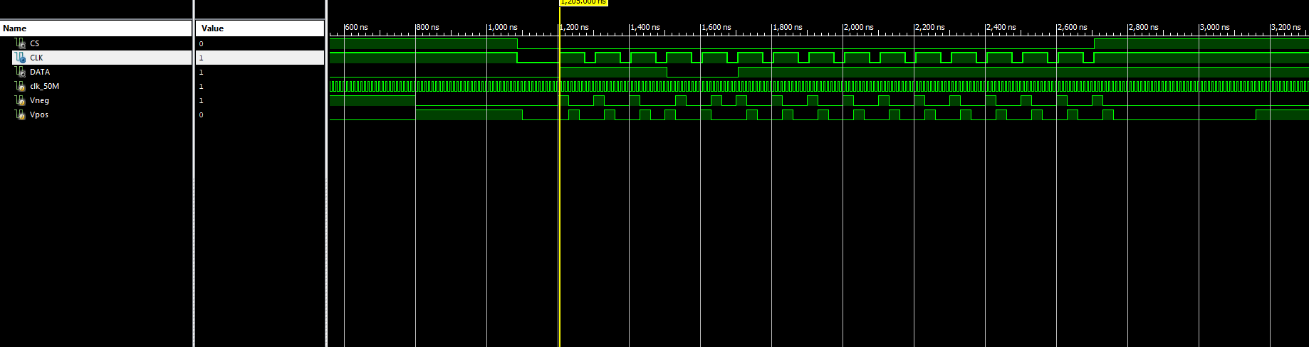

Nice, any way of grabbing SPI data logs? So we can start looking at doing some decoding.
These simulated or done on actual hardware?
- Posts: 4007
- Been thanked: 1138 times
Re: Tesla Model 3 Battery Hacking
Thats a simulation on Xilinx ISE. Hope to start actual hardware tests next week. Once proven any data logger like a Saleae or Analog discovery can connect to the spi or uart ports on the board and grab data. Initial release will be receive only. If it works out on the bench I'll pop one in the post to you Tom.

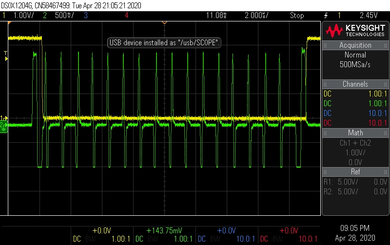

First tests with the Spartan 6 FPGA. Looks like we can detect the long pulses in order to decode CS. Now onto clk and data.

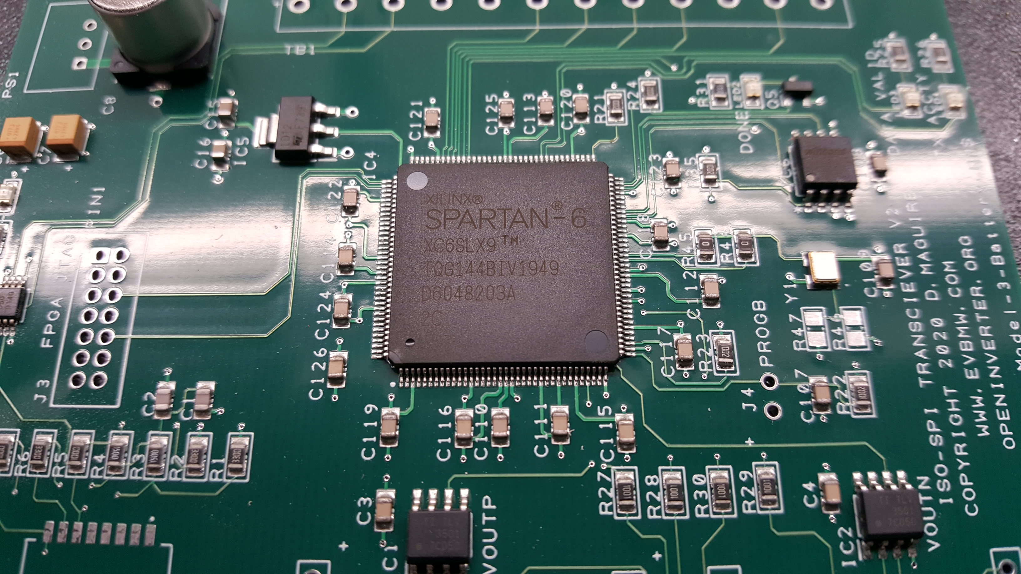

Good news is our new pcbs with the Xilinx FPGA onboard work a treat.
Damien's board generates the Tesla version of the isoSPI bus that connects the battery modules. It's possible this hardware will be enough to implement the BMS functionality but we just don't know today.
Time for a little update on the M3 BMS isospi board development.
As of today we have successful decode of the Tesla variant iso spi into normal spi that can be read by a (fast!) microcontroller. When connected to just one slave the data rate is very fast. There is just enough block ram in the fpga to buffer it so I'm leaning towards having to put some external fast ram on the board once we get talking to a full pack.
Work on transmission has now commenced so once we get something running on the bench I'll make a video.
New Keysight scope purchased with Patreon donations. Now I can get back to work on the Tesla Model 3 BMS. Lack of a 4 channel fast DSO with SPI decode meant this project has been on hold since I had to give back the demo unit. As I don't get any sponsorship, things like this need to be purchased at normal price so delays happen. Thanks to the kind assistance of those on Patreon (and elsewhere) we can get back to hacking and publish a beta design for the M3 bms decoder.

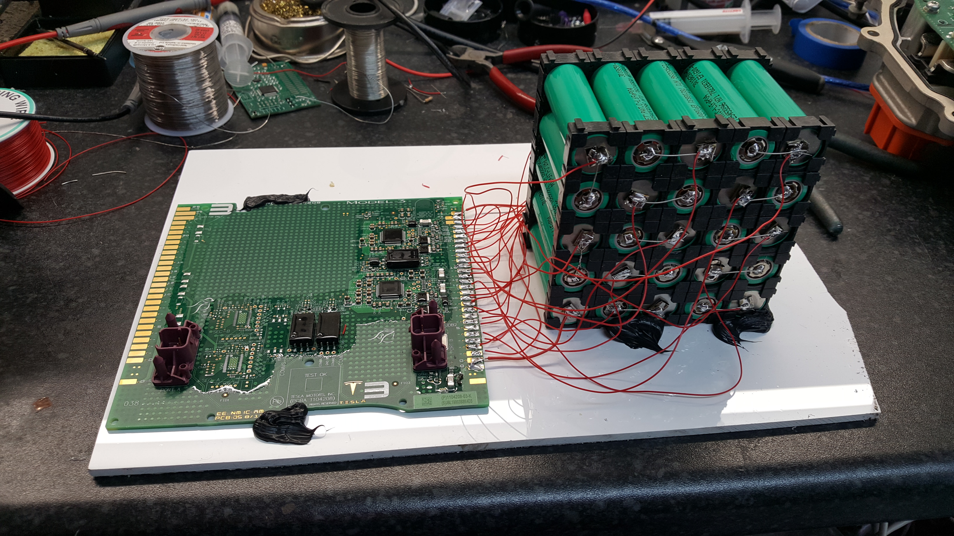

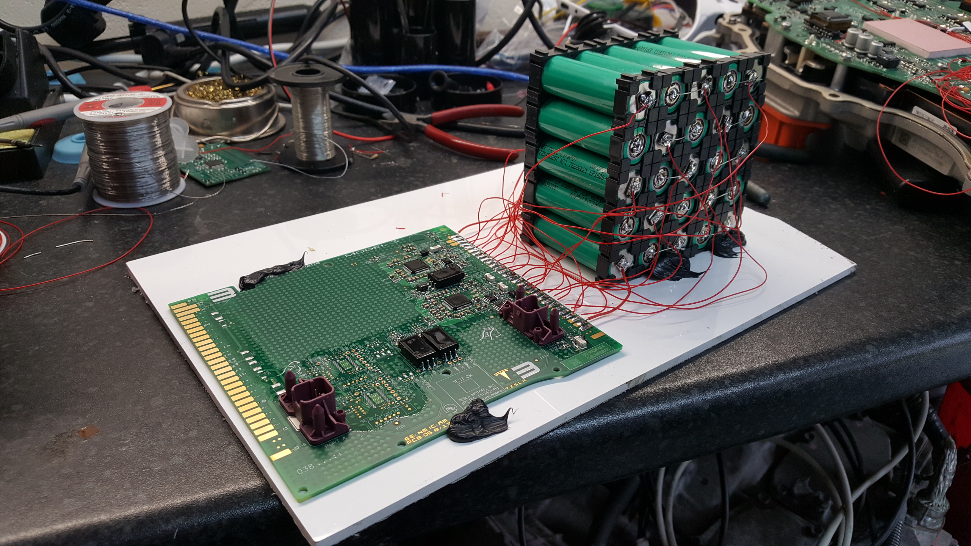

- Posts: 4007
Right, back to the hacking. The next phase of this op requires a battery and slave board. Fun though it would be to haul around a full size model 3 brick, I decided to make a bench version from 25 x 18650 cells. This has the added advantage of allowing individual cells to be connected and disconnected allowing us to observe the data changes.
