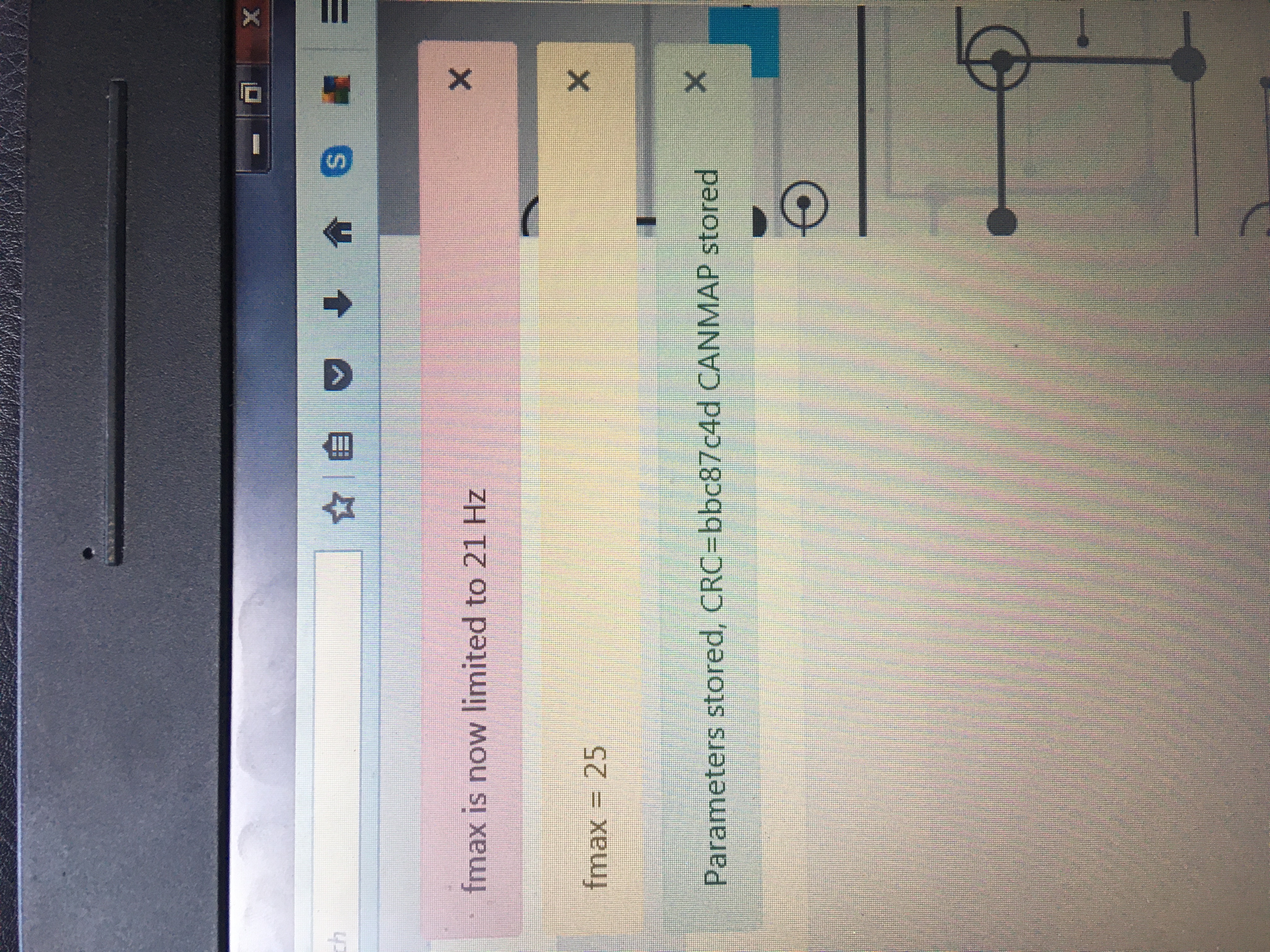

I’ve done some more testing this morning.
No matter what I do with parameters, whether I have the wheels off the floor or driving on the road, it always starts behaving strangely at approx 900rpm.
I now have my speedo working and the rpm graph and speedo match up. I haven’t seen any spikes on the rpm graph either.
It feels almost like a rev limit as it won’t accelerate past this speed. I can actually hold it at this speed and it runs ok but there are random knocks and bangs. If I try to accelerate more it becomes worse and trips.
I’m not sure if it could be related but I noticed something strange going on with the fmax parameter. I tried setting it really low (5Hz) and found it didn’t seem to make any difference. I could still spin up to 900rpm (approx 30Hz). The other thing that’s strange is that if I try to set it to anything above 21Hz it will let me do it but I get a message saying fmax is now limited to 21Hz. See image below. Any ideas what this is about?
The good news is that it’s the first time I’ve tried driving it with the new encoder and it feels really good apart from not being able to go above 20km/h.

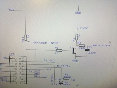

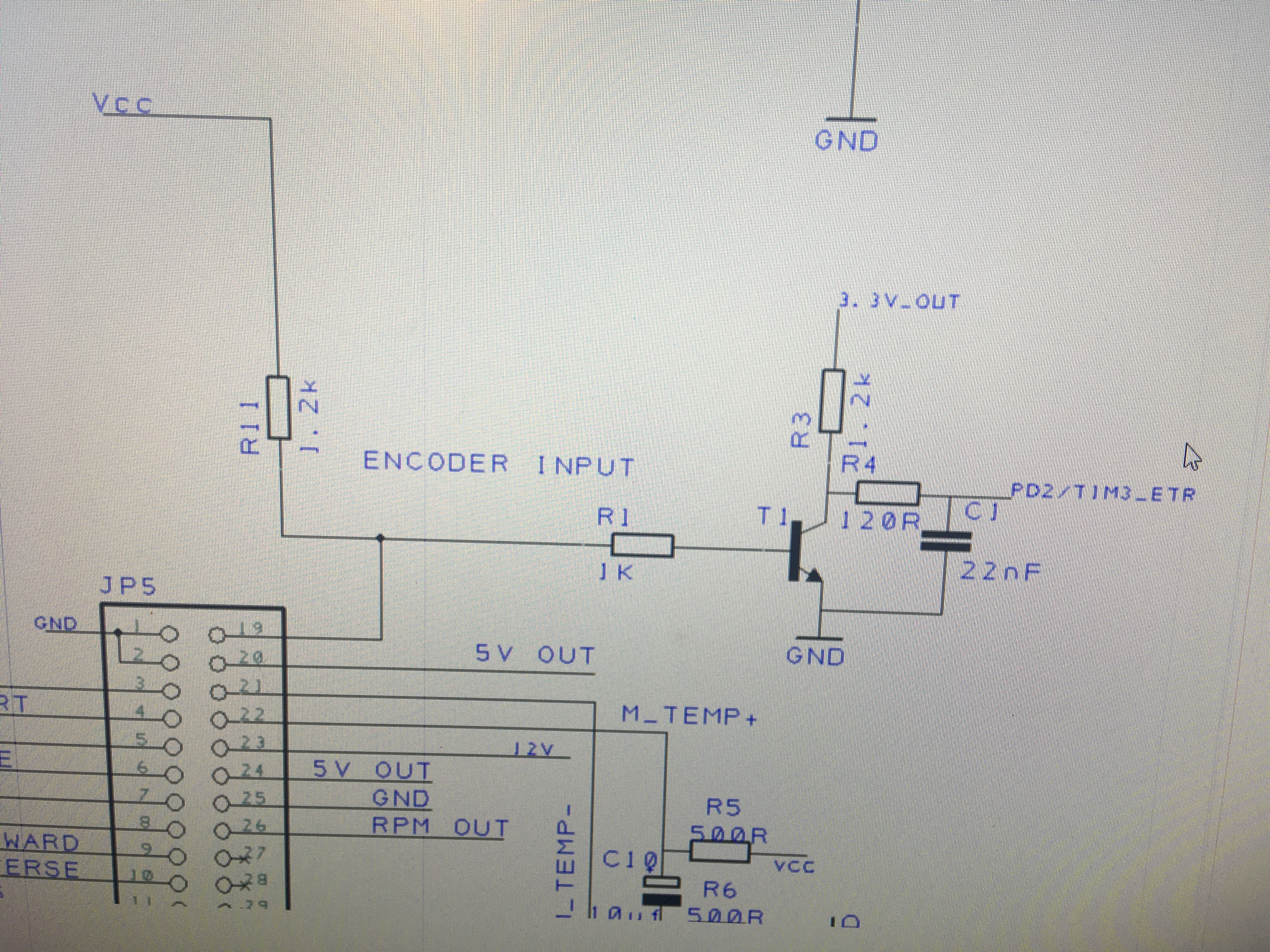

I’ve updated the firmware this afternoon (ended up having to swap back to an old Olimex as the one I was using which I tried to update on Saturday seems to be bricked).
The firmware update made no difference. I was able to limit fmax though and gradually increase it. The problem occurs at 35Hz.
I then removed the pull-up resistor, R11, on the schematic below. This also didn’t have any effect. Are there any other resistors in this encoder circuit that it would be worth removing/bypassing/altering?
If I’m gentle with the throttle it just feels a bit ‘lumpy’ at 35Hz and will sit at that speed as if it’s a frequency limit. It won’t accelerate past this speed whatever I do. If I increase throttle input the noises get louder and there will be an over current trip.
Any suggestions are welcome!

What is your push current rating? Maybe 1K R1 is too much and transistor is saturated?
I think i now use 1nf capacitor with 10K resistor inline connected directly to Olimex PD2 pin. True I use this with open collector only.
You can just eliminate R11 and replace R1 with 10K. Then remove T1 and R3 and connect R1 directly to C1, but replace C1 with 1nf cap.
What is the voltage output of your encoder? Is it 5Vdc? I think Olimex pins can survive 5V if protected by 10K.

Thanks Arber.
I’m not sure what the push current rating is, the encoder was just a cheap eBay one so I have very few specs.
If I do what you suggest, do I leave R4 unchanged?
If this doesn’t fix it then it seems like the only other option is that there’s some kind of frequency limit on the output of the encoder but it seems pretty low to me. The encoder signal will be about 1.3kHz at the point I’m having the problem.

No just connect from R1 to C1 directly without pull up or transistor. We'll see what happens.

I did the changes this morning, it now has a 10k resistor and a 1nf capacitor. T1, R11, R1, R3, and R4 have been removed.
It’s still doing exactly the same thing.
I’m going to try to borrow an oscilloscope this afternoon to have a look at the encoder signal.
