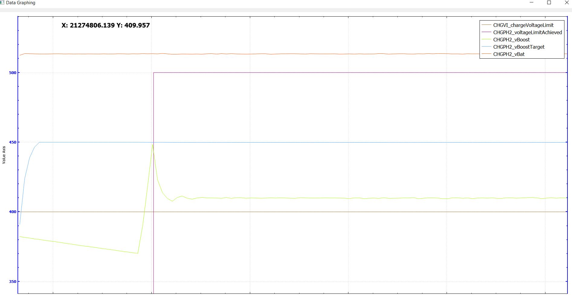

Ok. I've rerun logs using the higher voltage charger. The EVSE is a Juicebox brand with wifi reporting. Watching the related app I'm able to get what I consider to be more accurate charging stats, voltage, amps, etc. Update cycle for the app seems to be in the sub-second range since it reports the HZ of the AC line
Observed Amps: 0.8 amps stable
Initializes and moves directly to .8 amps and holds steady. I've rerun it several times, resetting the board, unplugging charger etc. and get the same results.
SavvyCan527.csvSettings527.rtfSerialLog527.rtf
Please report on accurately I see you mention AC read outs from the Juice box.
So the Juicebox tells you the AC current correct, and this is 0.8 Amps is it not?
Can you please see what it draws when you set the AC limit setting to 10 instead of 5. I might be the stupid command formatting is changed.
Please also do not speculate how values are calculated as all displayed feedback values are purely translated from canbus there is no other math happening. So this looks like an exercises of rescaling/checking all values reported AND sent.

Thank you, the feedback I am decoding from the canbus is not great, in the status it seems the charger phase says its at a voltage limit (possibly due to scaling issue), if you increase the charge voltage request this is the quickest way of figuring out if the request voltage scaling is incorrect for your charger.
Set it to 550V (If the commanded voltage should scale with the reported back voltage) and do not forget to increase the termination voltage too.
Did you manage a capture of it drawing/putting any current into the battery? (sorry if I missed this)
Please do not worry about code, it pumps out the right messages to make a charger work. I checked the content there and nothing appears wrong or missing.

I have not seen a can log showing me it is actually charging, no changes in Battery voltage. You mention a few posts back that you can get it to do a 5Amp charge at the beginning of a day got a can capture of that?
I would need to see the reported status transition during that charge session to understand if there is an issue in the setup (grounding ect.) or with canbus scaling.

So from capture 527, just module 2.
You can see the Vbatt is un scaled. However you can see the VboostTarget at 450V, which I believe is a firmware limit.
Due to something not working correctly, most likely there is no current starting to flow for some reason. You see the Vboost shoot up, spike and then a flag of voltage limit achieved being set. Thus most likely something is properly broken.
