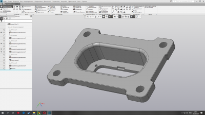

I've just realised that ampseal connector's lock disangages with a flat screwdriver from a wire side of connector, so it will be no issues to make an offset inside of the inverter, as it is on the original plate. So there will be no problems with fitment of straight socket and existing connection board.
Will make V3 plate design by the end of the day.

Cool - not tried the last one but width of the slot for the seal was fine before. Only depth that needed increasing slightly.
- konstantin8818
- Posts: 290
- Location: Minsk, Belarus
- Has thanked: 2 times
- Been thanked: 10 times
Left width as before, depth is -0,5mm.bobby_come_lately wrote: ↑Thu May 28, 2020 3:50 pm Cool - not tried the last one but width of the slot for the seal was fine before. Only depth that needed increasing slightly.
So now offset goes inside of inverter as it is on original one. No need of angled socket and plate must fit no problem. Calculated room for a plug and it's lock, but tests need to be performed

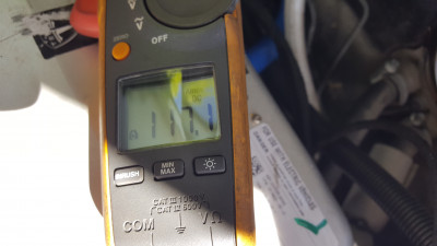

Well, The Prius DCDC just loves 360V:)

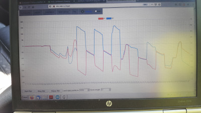

And one photo especially dedicated to those who said the MG2 power stage could only do 100amps.... The siemens motor would like to differ.

Jack Bauer wrote: ↑Sat May 30, 2020 3:07 pm And one photo especially dedicated to those who said the MG2 power stage could only do 100amps.... The siemens motor would like to differ.

How did you do that exactly? Did you correct the resistors on the DCDC to get 14V from 360Vdc?

Details of the dcdc mod in this video :
