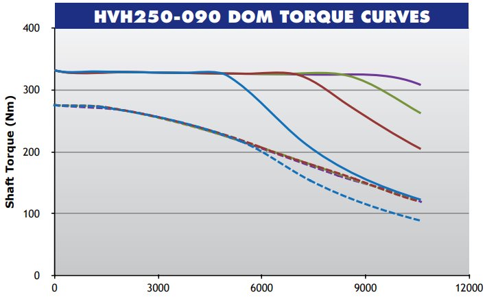

If they are Remy, and they are the parallel winding ones, yes, they can handle 600A at 700V...
Maybe based on the HVH250-090-DOM:
Edit: I had the 115 curve up here, oops. Fixed with the 90.
That sounds interesting.
That graph is for 600A, lines are voltages 350,500,600,700V.
-Matt

The cores are the 090S model, not the DOM, at least as far as anyone can tell.
