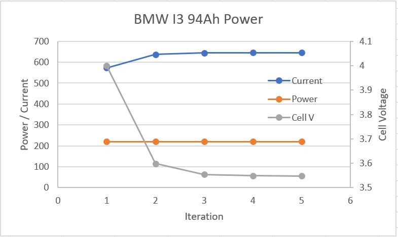

Has anyone tried using an i3 battery pack with a more powerful motor?
Spec sheet seems to indicate 417A for 5seconds (around 150kW for a full voltage pack) which matches well for the i3's maximum 137kw peak
What's likely to be the outcome of pushing further? Hoping to drive ~220kw into a tesla SDU for periods of around 5 seconds. This is around 30% over spec.

cloudy wrote: Mon Jun 01, 2020 3:43 pm What's likely to be the outcome of pushing further?
Voltage sag and heat are the most likely outcomes from short duration excessive current draw.

So lets theorise based on this info.
Lets take your arbitrary 220kw, the joke is this not drawn till you hit field weakening thus max power, but lets assume its a constant draw for the sake of making things easier.
This is a real crude graph of what happens, now the thing to keep in mind is that your whole system will have a voltage drop so the actual delivered current to achieve 220Kw at the motor input would be upto 20-30% higher due to the voltage sagging by the same amount across all other connections.
However looking at the cell specs you are well clear of their 2.7V limit over most of the voltage range.

Thankyou - that's super helpful, I guess the only real test is to try it and watch for sag/heat - not easy to get hold of single cells due to the construction of the busbars, but could test a single pack...
