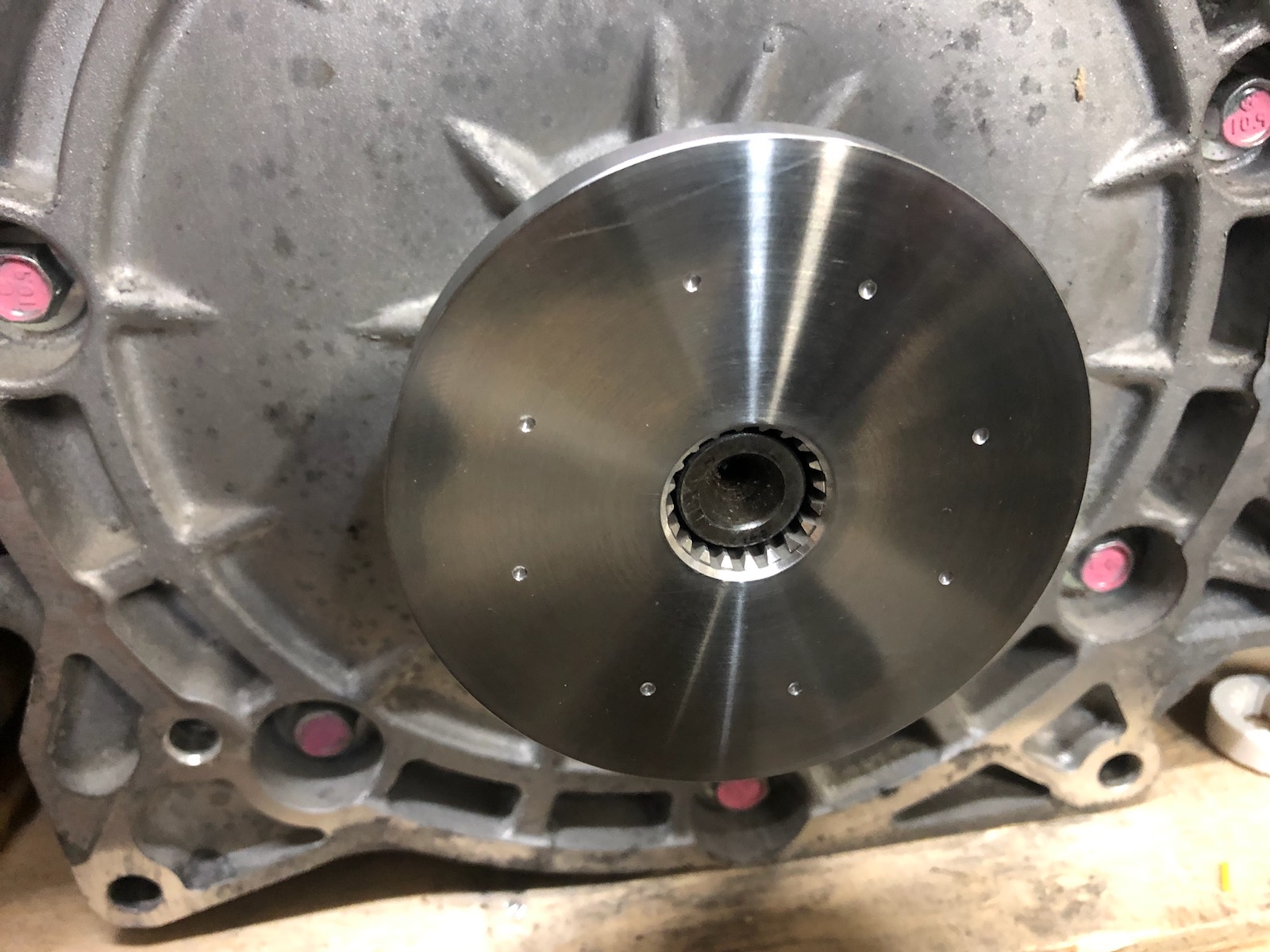

Here is how the 1.6l Fiat Multipla centre spline fits the Leaf output shaft

Bratitude wrote: ↑Sun May 10, 2020 3:01 amCurrently away, but couplers are on order.
Ill try to dig out the specs. Spent a good amount of time setting the coupler up to be fairly universal for most people’s needs
What I currently access to.
was ether a 3in or 2.75 di plate with centring marks that match the rotex gs38 bolt pattern.
couple will nest in an angler bearing, with renting clip. For those wishing to run a clutch or drive shaft.
You have another customer here in the UK! Need your solution to link to a Karmann Ghia gearbox....

Re: Leaf spline coupler
designed the coupler to be as universal as possible, so yes with the angular contact bearing you should be able to mount a flywheel.
few more days and I’ll start taking orders
Hi everyone. This is my first post. I accidentally came across a clutch from suzuki samurai. What do you think about this? 20x20,1x23,1
Multipla has 20x20,2x23,2
[youtube][/youtube]
[youtube][/youtube]
The marked bolt pattern (should) match a rotex gs38. but it’s really up to you.
I’m not using a rotex in my application. I’ve milled the transmission coupler with a tapperd angled extrusion(which matches the tapper on the leaf coupler) to centre / provide a friction connection. all clamped together with a 6 m8x1.25 bolts.
I can upload all the cad drawings of each part of the assembly when I’m back at my workspace(about a week or so)
