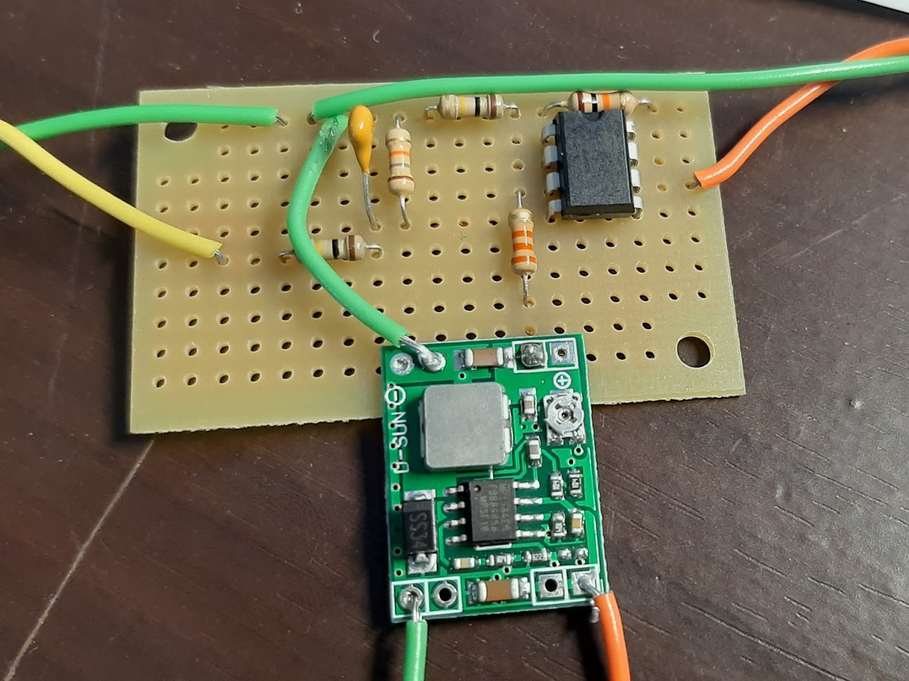

To make logic board happy about phases currents instead of using OP amp schemes people suggested, I've stole circuit from johu's gen 2 board, because it is simplier
I've tested it on circuit emulator After an hour of soldering misery this thing was born: And if nothing is attached to its inverting input, and little dc-dc stepdown board provides 5.5V, this is what we see at output: And the board is happy. Now after I've set all the parameters, but the board is not connected to anything yet, it is not happy about precharge. Are errors marked as [WARN] don't stop the inverter from operating?

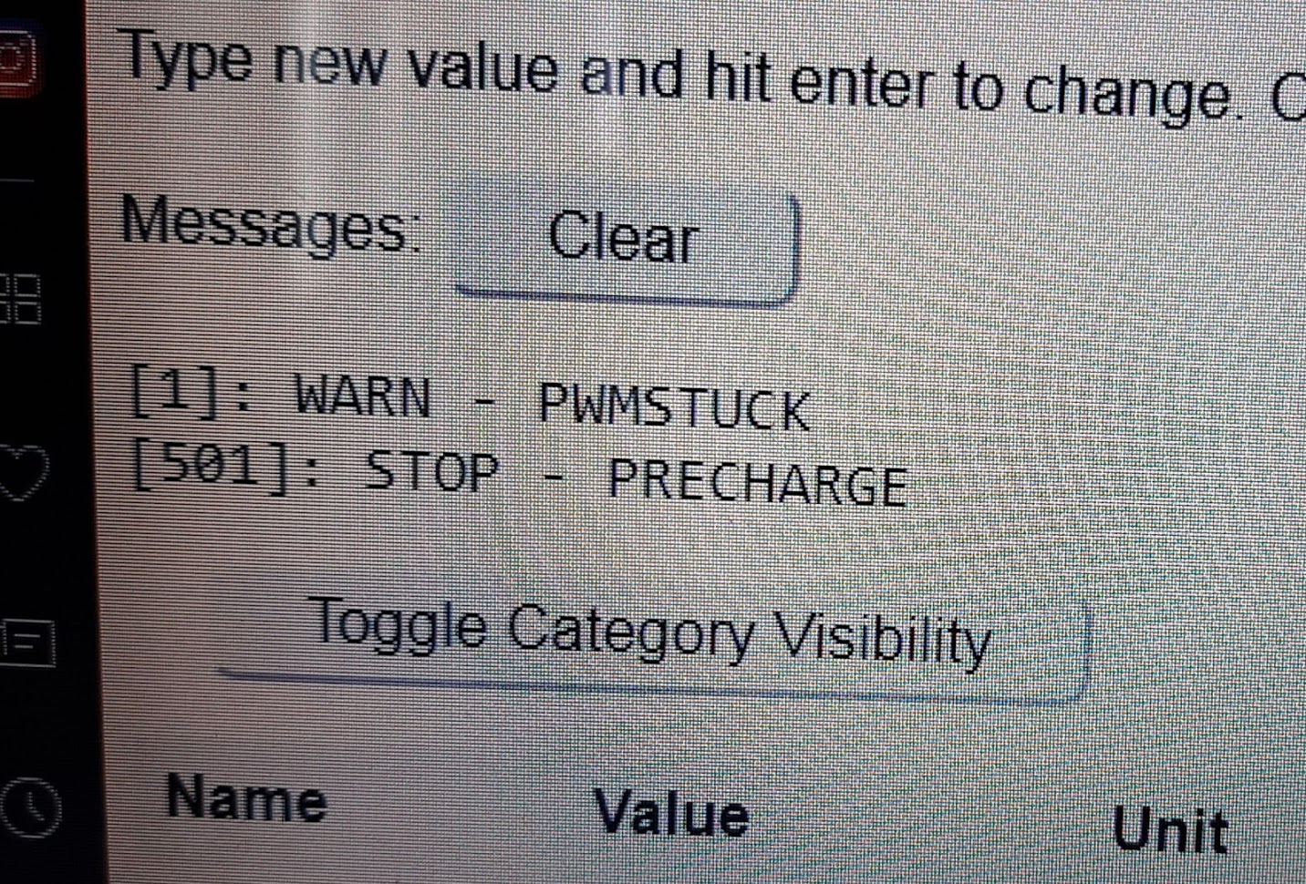

- Posts: 656
Re: Toyota Prius Gen 2 Inverter Controller
Correct.konstantin8818 wrote: ↑Sun May 24, 2020 2:22 pm Are errors marked as [WARN] don't stop the inverter from operating?
Adjust your udcsw parameter to get rid of the precharge error - see what udc is reading at and then set udcsw below that. I'm doing the same right now since I messed up my voltage sensor and I can't wait to run my motor
