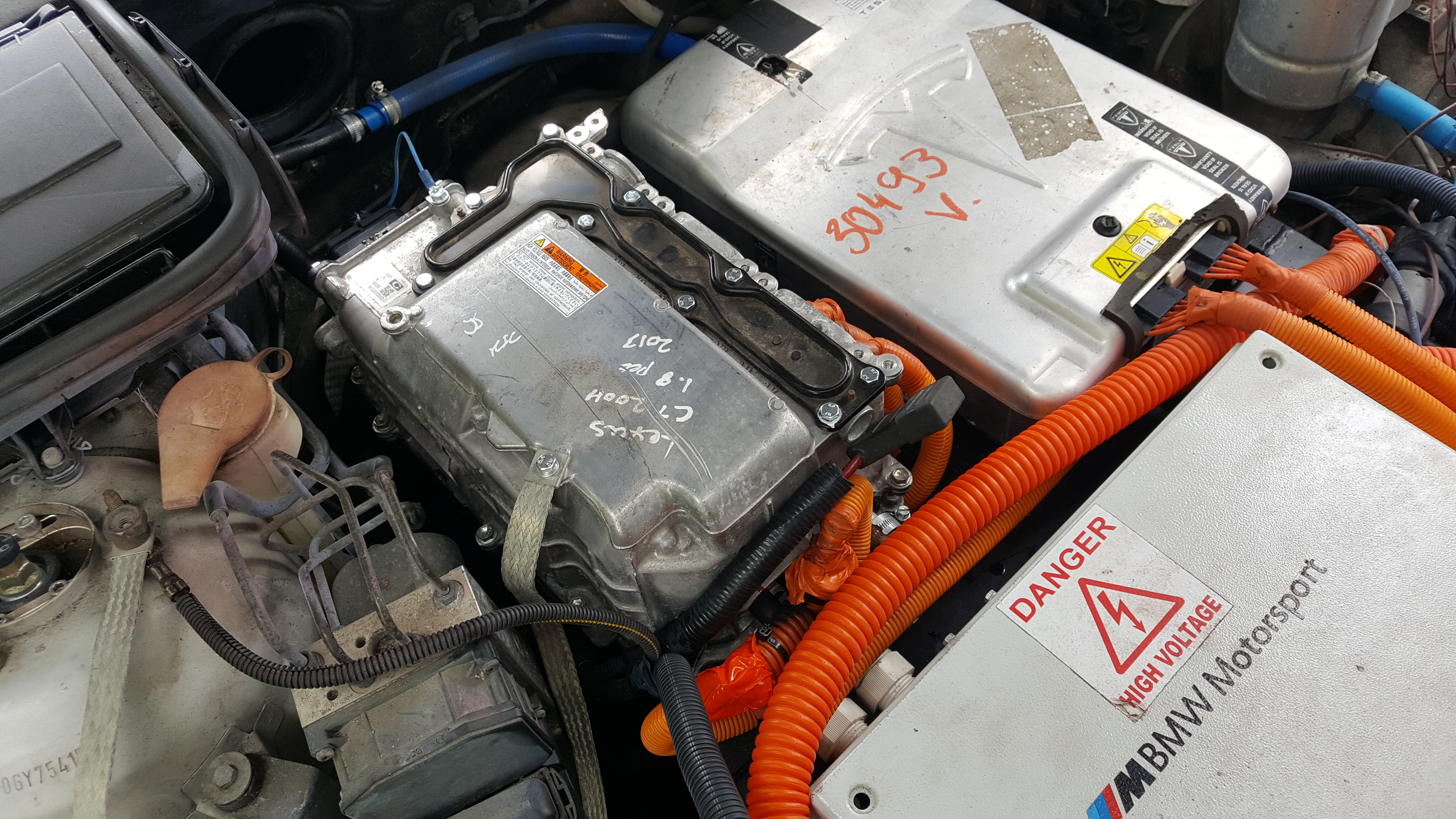

Update time. Got a CT200h inverter which is exactly the same as a Prius Gen3 inverter on the outside but actually uses the same logic board as the Auris/Yaris inverter. So fitted an Auris/Yaris board, made some simple code to buck the 360v down to 220v to run the dcdc converter, added some DEADTIME! to the settings, installed in the car annnddd....no bangs so far.
Observations : used the old connection points to see if it would explode. So far not. Will update on this.
I have the engine temp gauge in the E39 mapped over can to the heatsink temp in the inverter, now when revving the motor in neutral with the old setup it would jump up very fast. Now it hardly moves at all. I guess thats what 12 transistors in shoot through will do to you....

Might be a silly question what advantage does the old connection point have?
is it an ease of access thing or are the cables in the landyacht only fit in the old place?

Jack Bauer wrote: Wed Jun 17, 2020 2:20 pm Observations : used the old connection points to see if it would explode. So far not. Will update on this.
Has there been an update on this anywhere? In the recent videos of the E39 it seems you are still using the old connection points, so I guess there haven’t been any problems so far?
