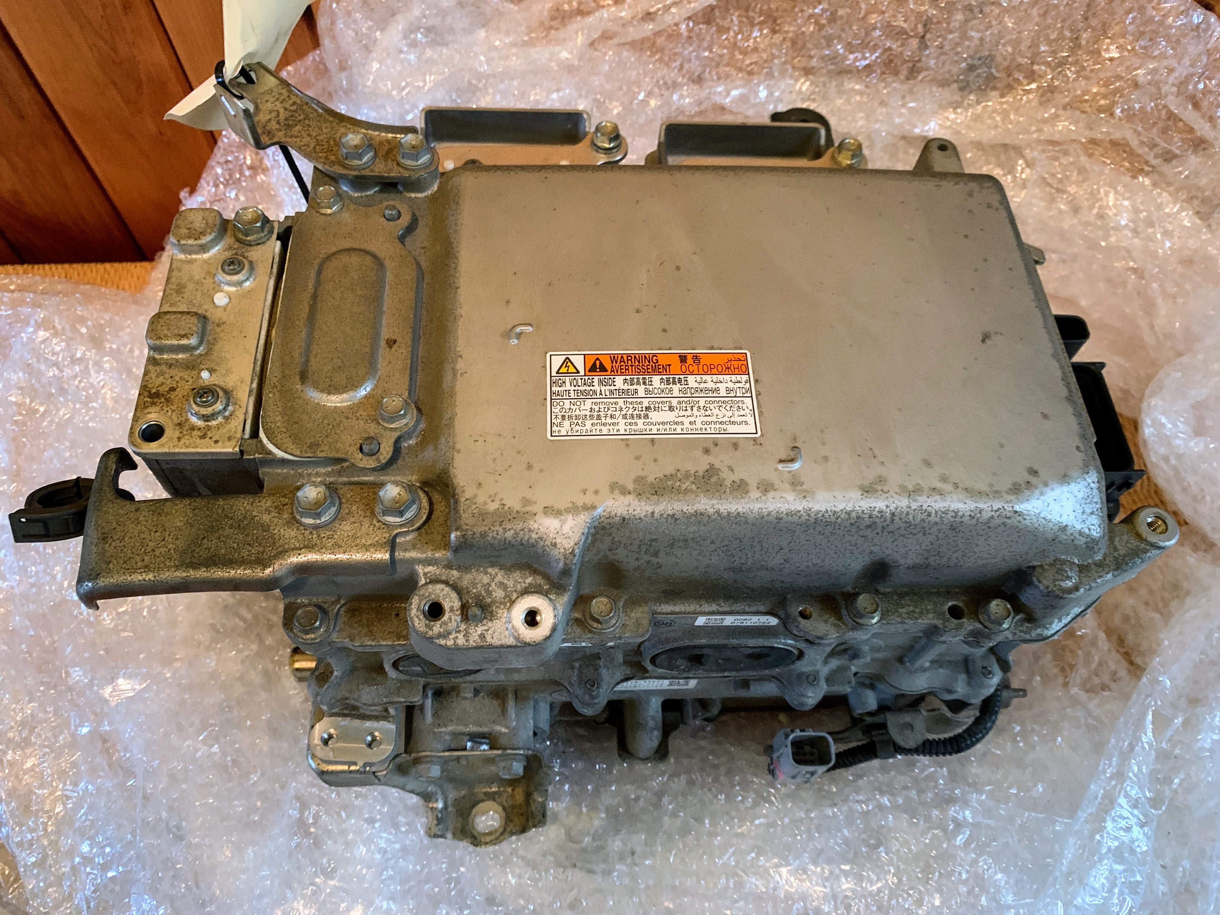

I've just bought myself a G9200-33171 inverter from a Toyota AVV50R Camry Hybrid (also used in the Lexus ES300h and Toyota Avalon Hybrid), as well as a G9200-52010 from a Prius C. I'll be taring these down in the coming weeks, and will be ordering at least one Auris/Yaris/Prius C control board. I'll eventually be testing these with Outlander PHEV rear motors.Bassmobile wrote: ↑Wed Jun 17, 2020 8:11 pmQuickest way to get answers to these question is to dig in and buy one of these drive units and experiment with it to find out what works.jalovick wrote: ↑Wed Jun 17, 2020 12:08 pm In regards to the transaxles, the AHV40 Camry's typically have a P311 trans and a 04A axle, and the AVV50R Camry's typically have a P314 trans and a 03A axle. I assume to use those transaxles standalone, you'd need to weld the planetary gears, or can the input shaft just be locked off? I'm assume that they'd need to be welded.
The Camry inverter looks like: View of unit. Am curious what the connector is towards the bottom. The cable runs around the corner and into the bottom of the unit through a grommet.

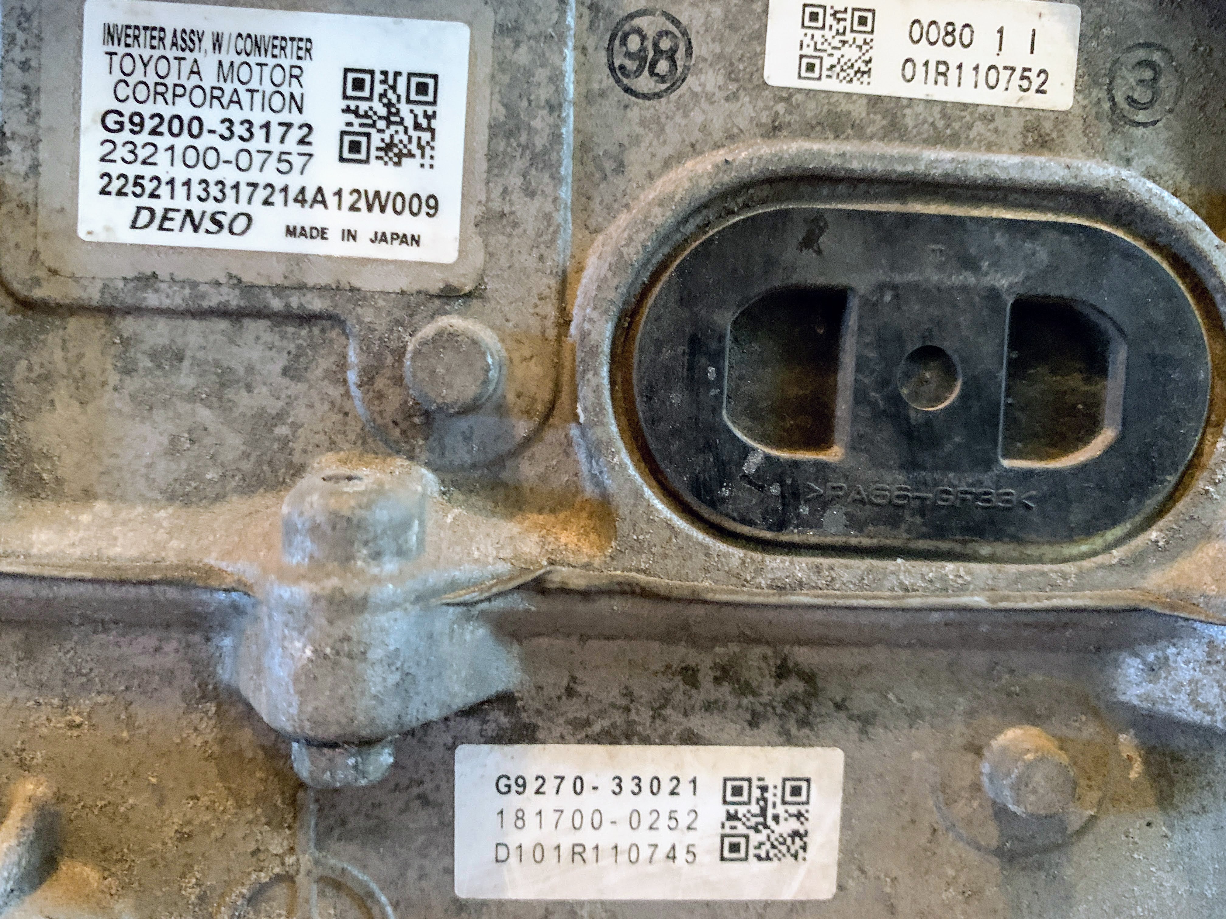

Part numbers

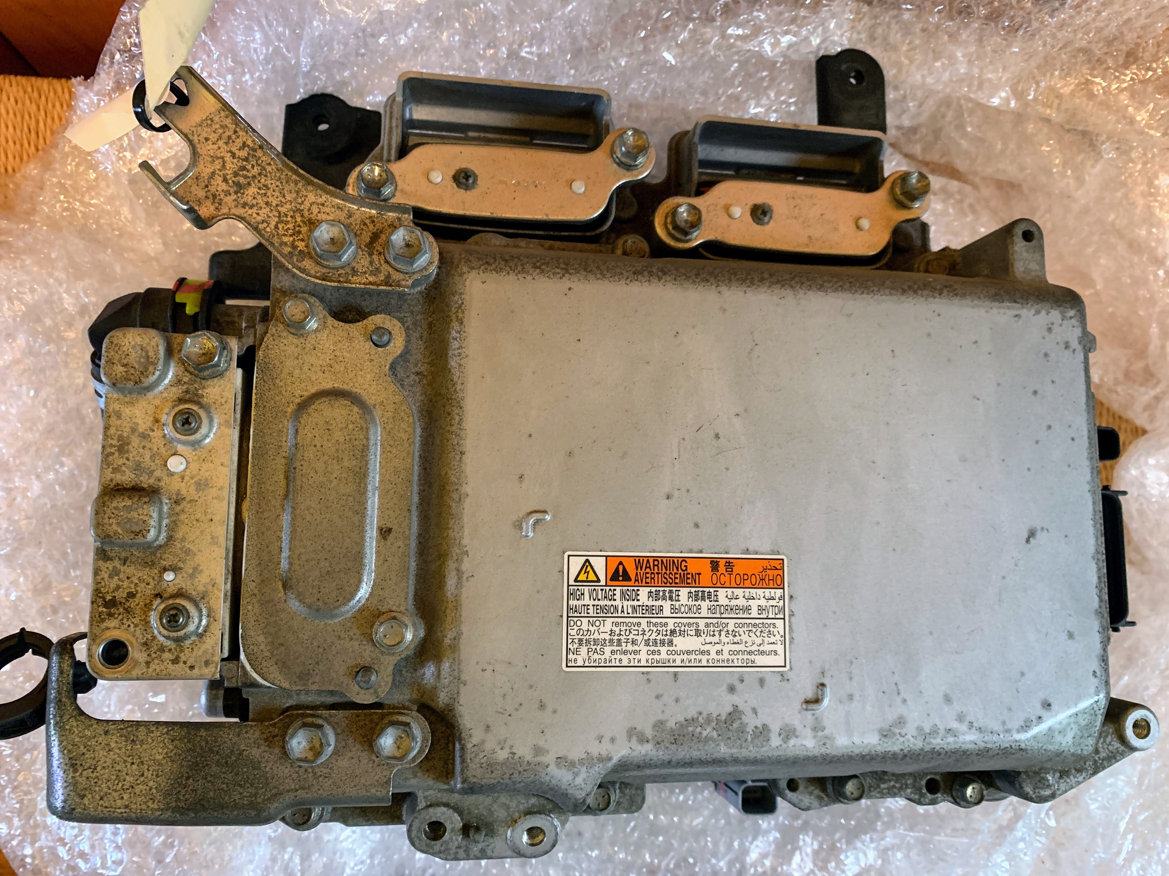

View of MG1 and MG2 connectors towards the top of the image.

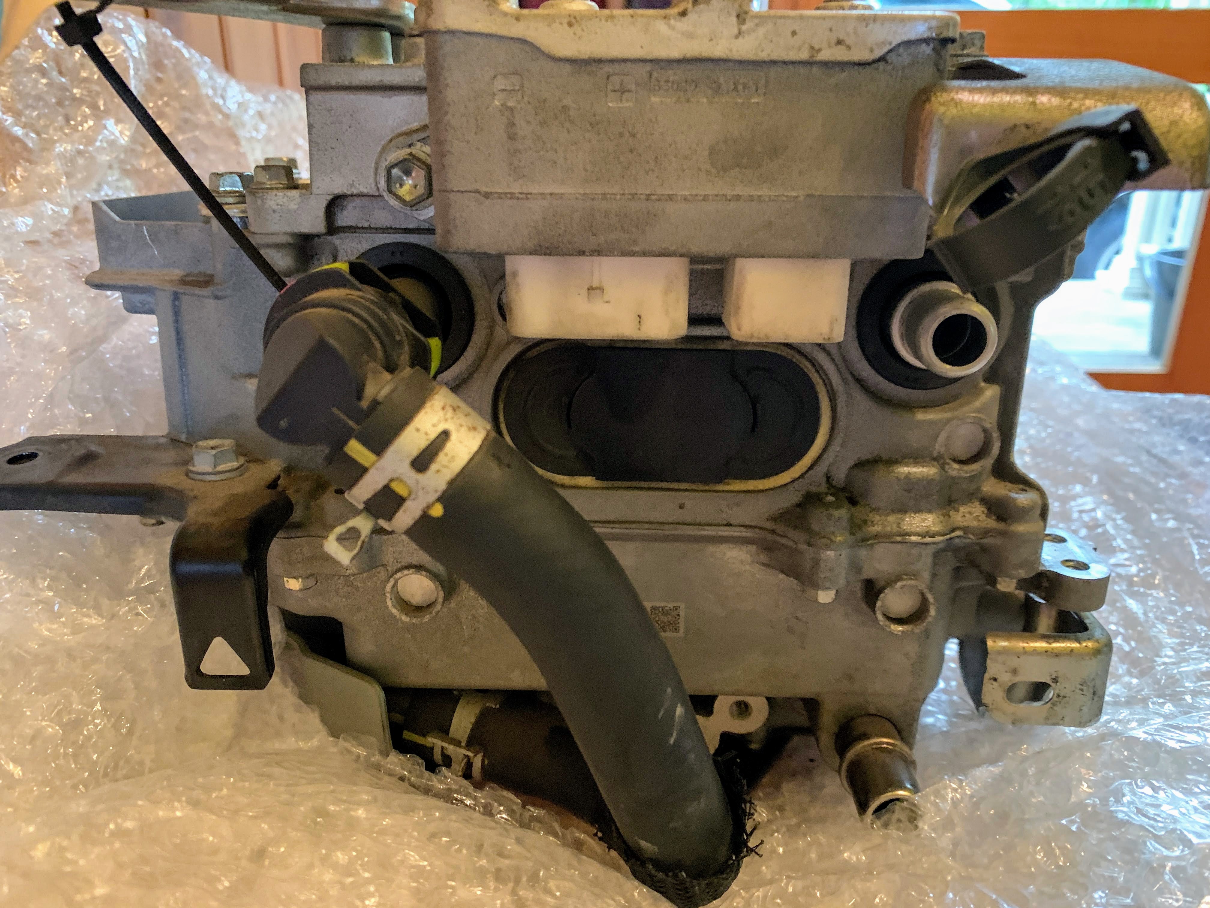

Cooling loop and what appears to be the A/C HV and control connections.

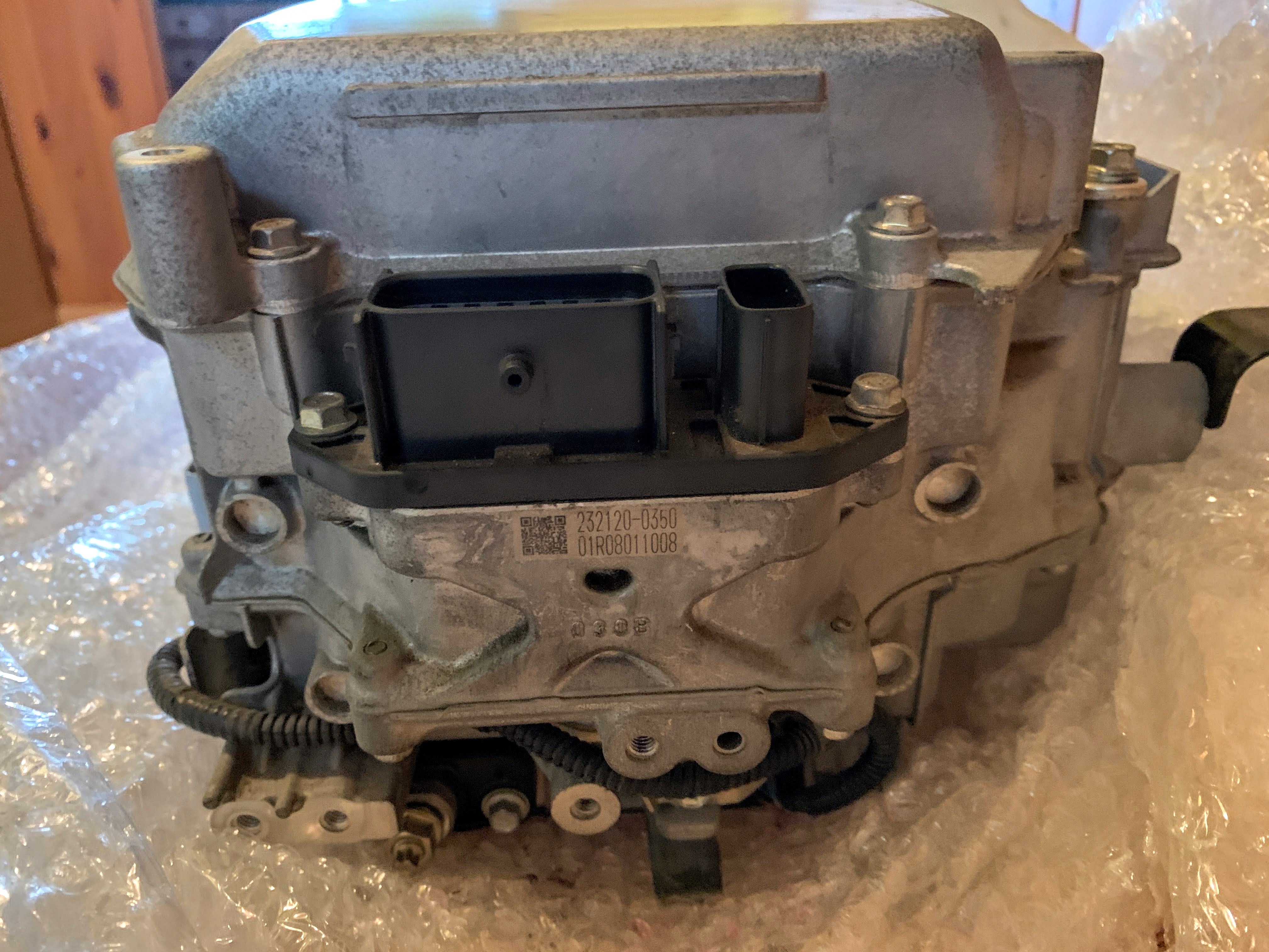

Loom connection

-33020 is from an 2007-2011 Camry -
-33171 is from 2012-2016 Camry, Avalon and Lexus ES300H
Neither are compatible.

I have a G9200-33172 from a Toyota AVV50R. Looks identical to yours.
