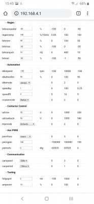

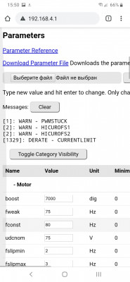

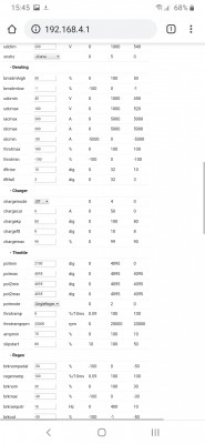

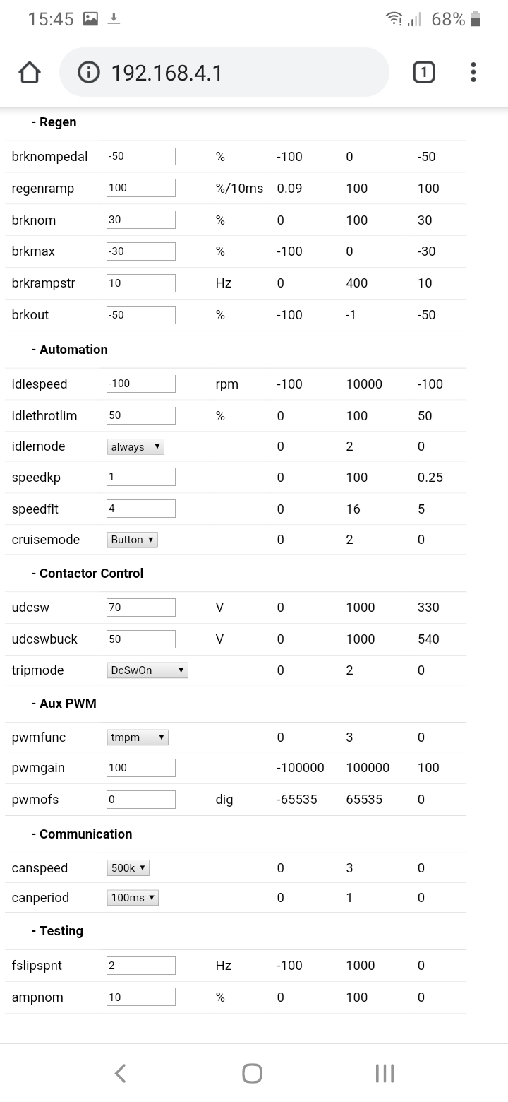

Interesting yet scary thing I've encountered today: if parameter "throtramp" contain a fractional number, there is an issue when vehicle accelerates on its own, but at the time throttle input is at 0% and pot value is lower then potmin parameter. If throtramp is integer, everything is OK.

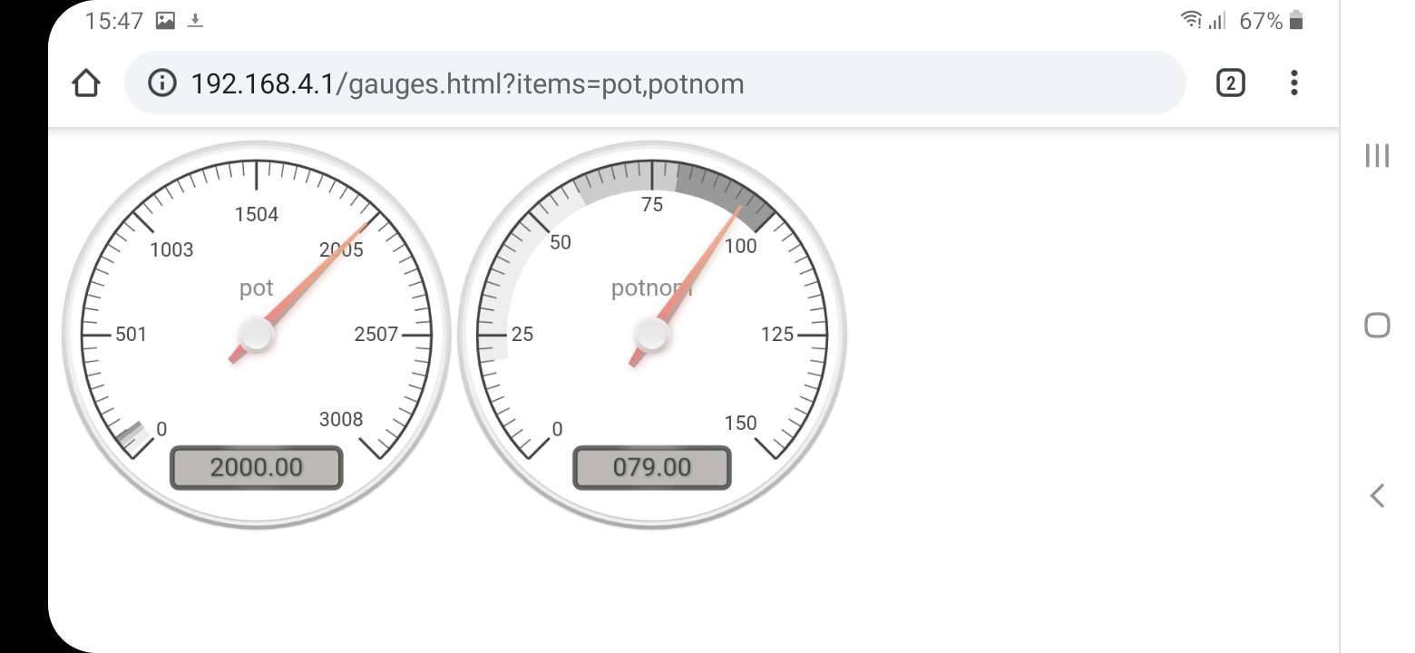

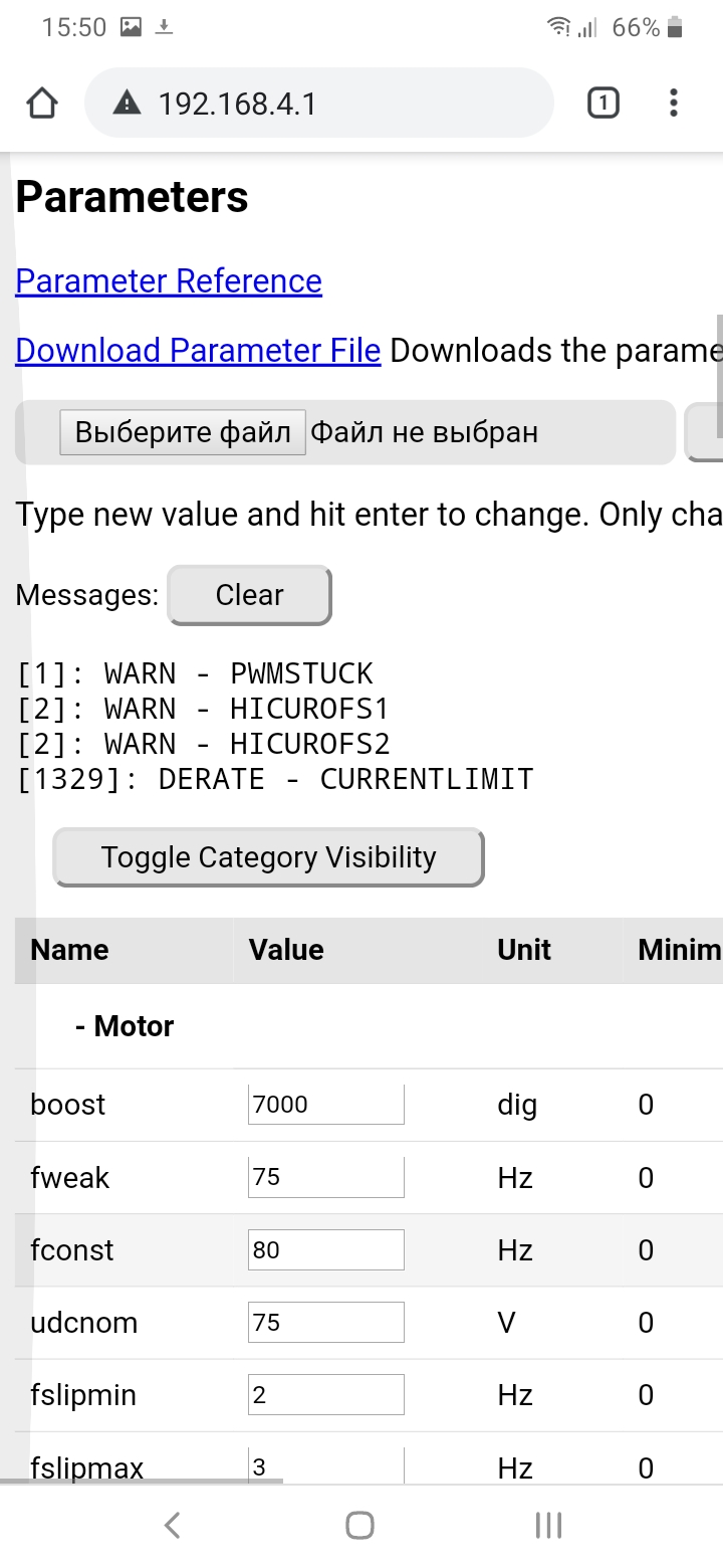

So I've tried to recreate this bug today, but it didn't showed up. May be this was a combination of parameters, and maybe it's because all my signal and HV wires are not screened and crossing. It might be just radio interference.
Update.
It showed up. It is not depending on fractional digits. This is what parameters look like when it appeared:
So pot value is below potmin. But at same time throttle input is 100 percent.
Only disabling the board resets this bug.
