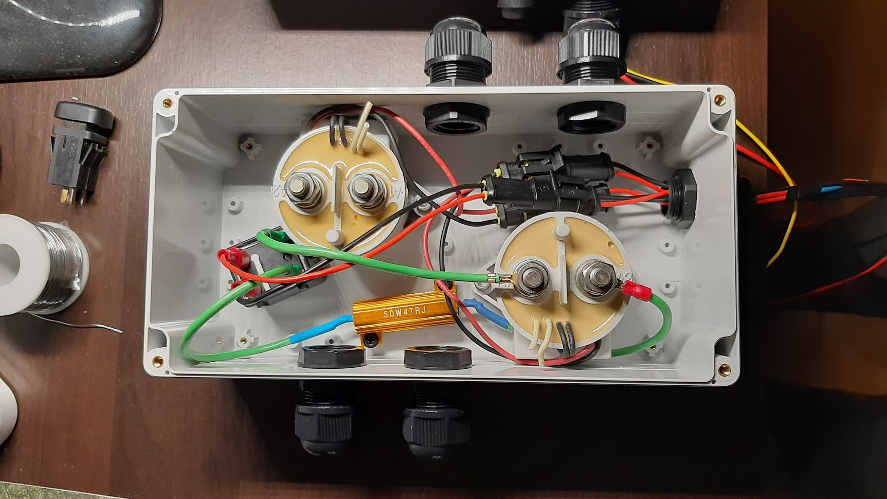

As I'm learning here, Konstantin, can you tell me what is going on in the second white project box? Are these the contactors? Assuming so, what voltages (DC?) are running on the green wires in and out? Is the Damien board controlling that box relay, which I assume is tells the contactors(?) to open/close? Looking at the video, I'm assuming the DC voltage is coming in on the right hand side from a power source or battery next to the motor, through the contactors, and then to the inverter, is that correct?
Whats the difference between a contactor and a relay? Or is it just application nomenclature? Like an automotive starter solenoid is basically a big relay.

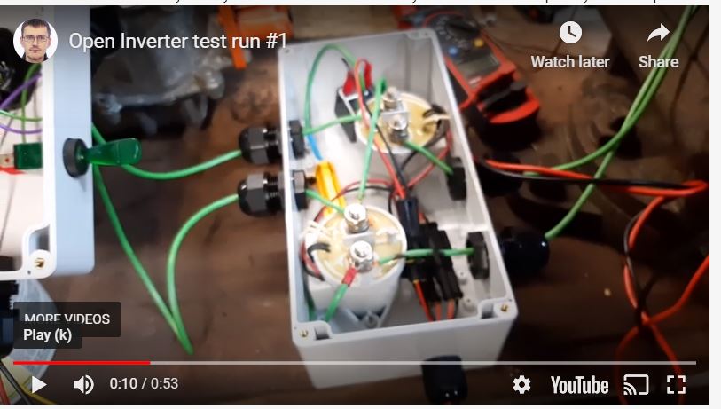

I'm currently sitting on two boards. One Damien's, shown in video, and one is Johu's gen3 board, which basically can do the same things as Damien's board. So I can sell you this board from video for the same price as I've purchased it (30 euro), if you really in need of one, and can't built it.
In junction box there are two Kilovac EV200 contactors, wich are basically are big heavy duty relays, one high voltage relay from toyota prius junction box and 47kOm 50W resistor. One contactor is separated and it is for positive line, second one is for negative line and in parallel with is there is a line consisting of prius precharge relay and resistor.
In this video there is 30 Volts going thrue green wires. For now I'm under quarantine so I can't go to electronics shop to buy terminals and HV cables to run high current tests, so only low current test for now :?
Damien's board can run both precharge and main contactors, but as far as I know, main contactor should be equipped with economizer. Precharge relay only work for short period so it doesn't need economizer. And second main contactor for a safety reasons I suggest to control thrue a manual switch, so in any case you can turn it off manually.

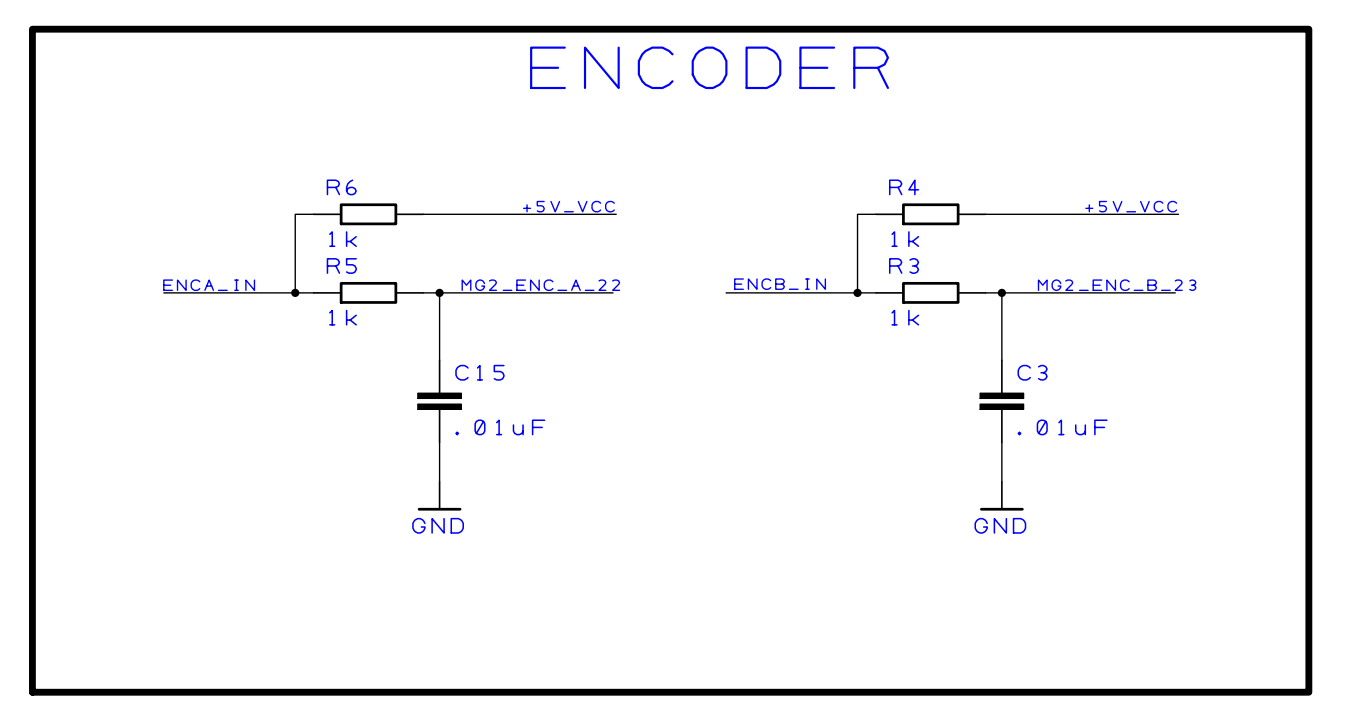

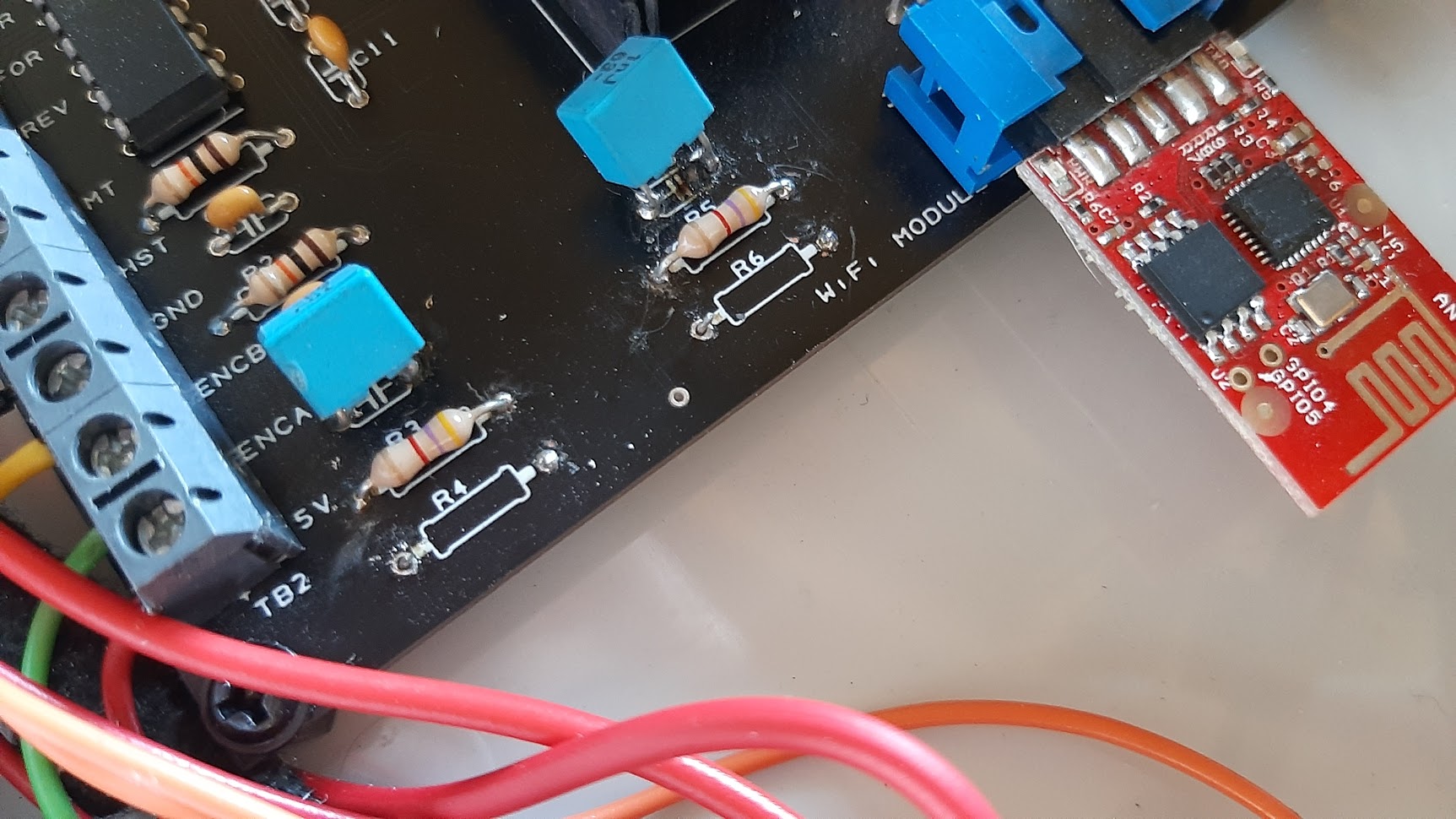

Anyway, Damien, can you please tell me why R6 and R4 resistors are missing on the board you've sent me? Because one of issues I'm facing now is board can't see signal from AB encoder. Encoder works perfectly fine, it was working with Curtis no problem. And I read voltage from 0 to 5 volts on both A and B channels when I spin wheel by hand. I've set AB encoder in soft .

They are pullup resistors and required if the encoder does not push pull its output.

Encoder is simple cheap AMT 102-V. Datasheet says it has TTL output, so I need to set those resistors in place.

konstantin8818 wrote: Fri Jun 26, 2020 2:54 pmR6 and R4 resistors are missing
They're 1000 ohm resistors. Shouldn't be too hard to find and rip out of some other equipment if you don't have access to ordering.
