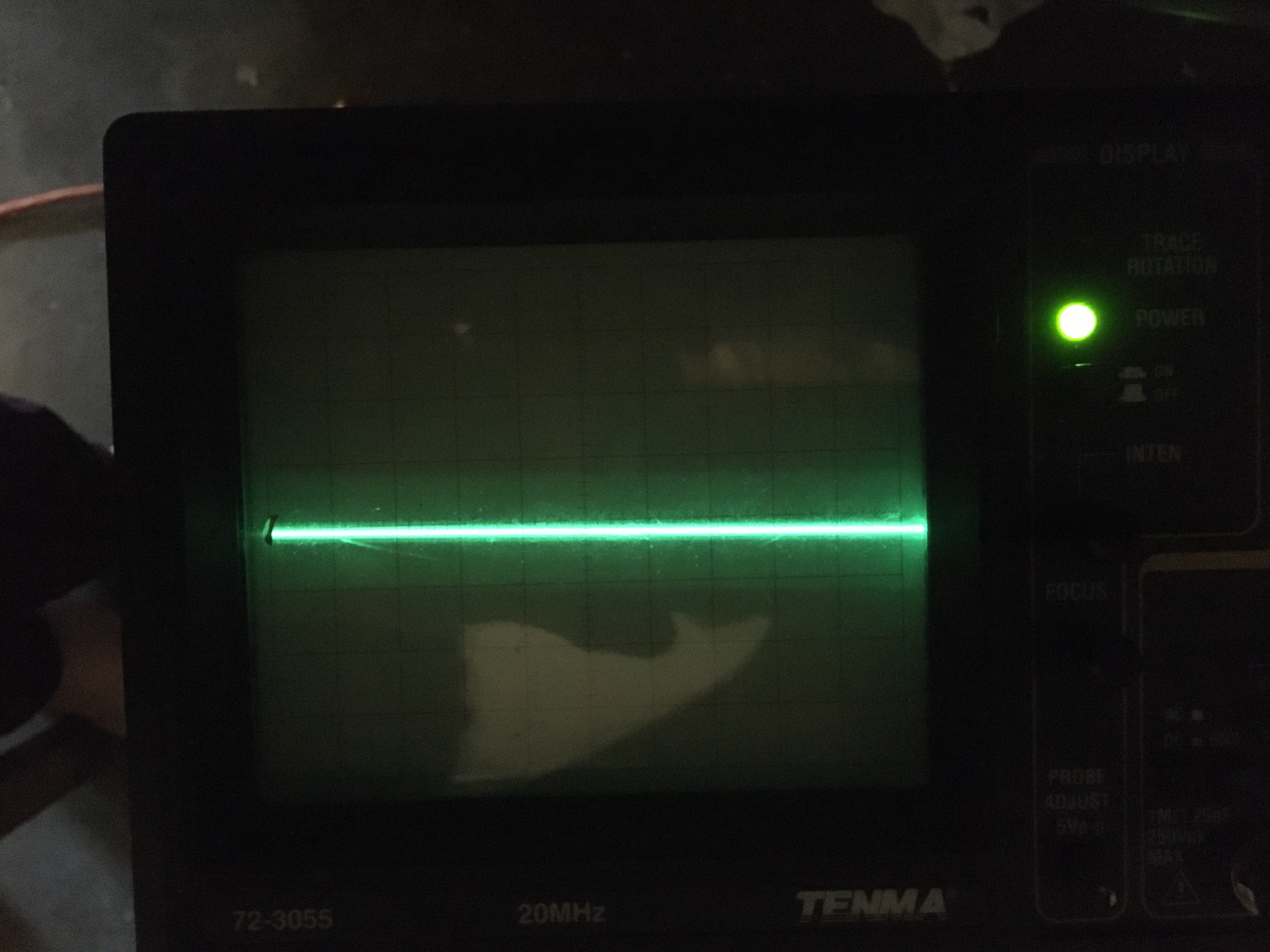

Here's the signal when the motor is not moving and motor current is 0:
Stays at a steady 5V from the board pullup.

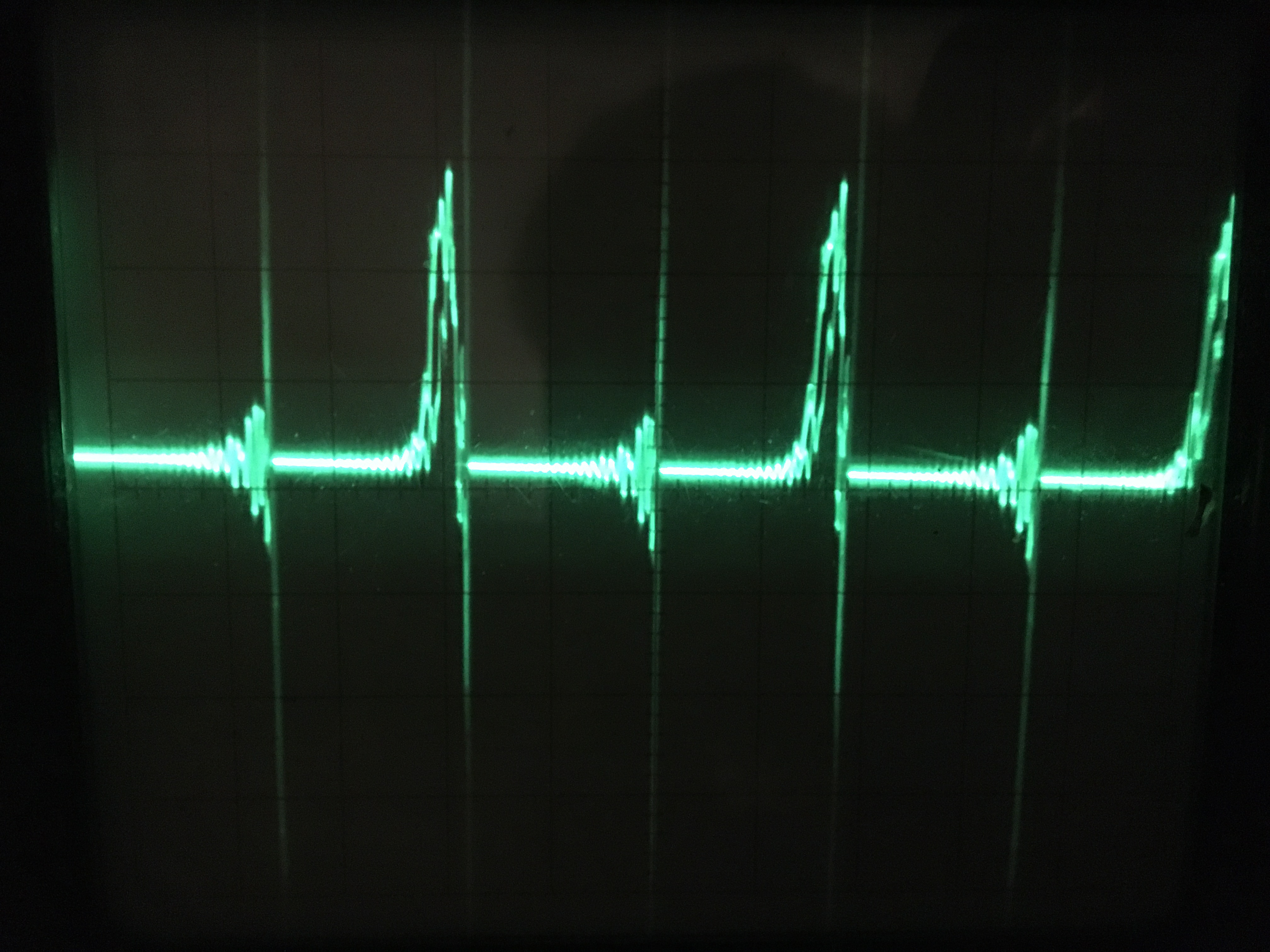

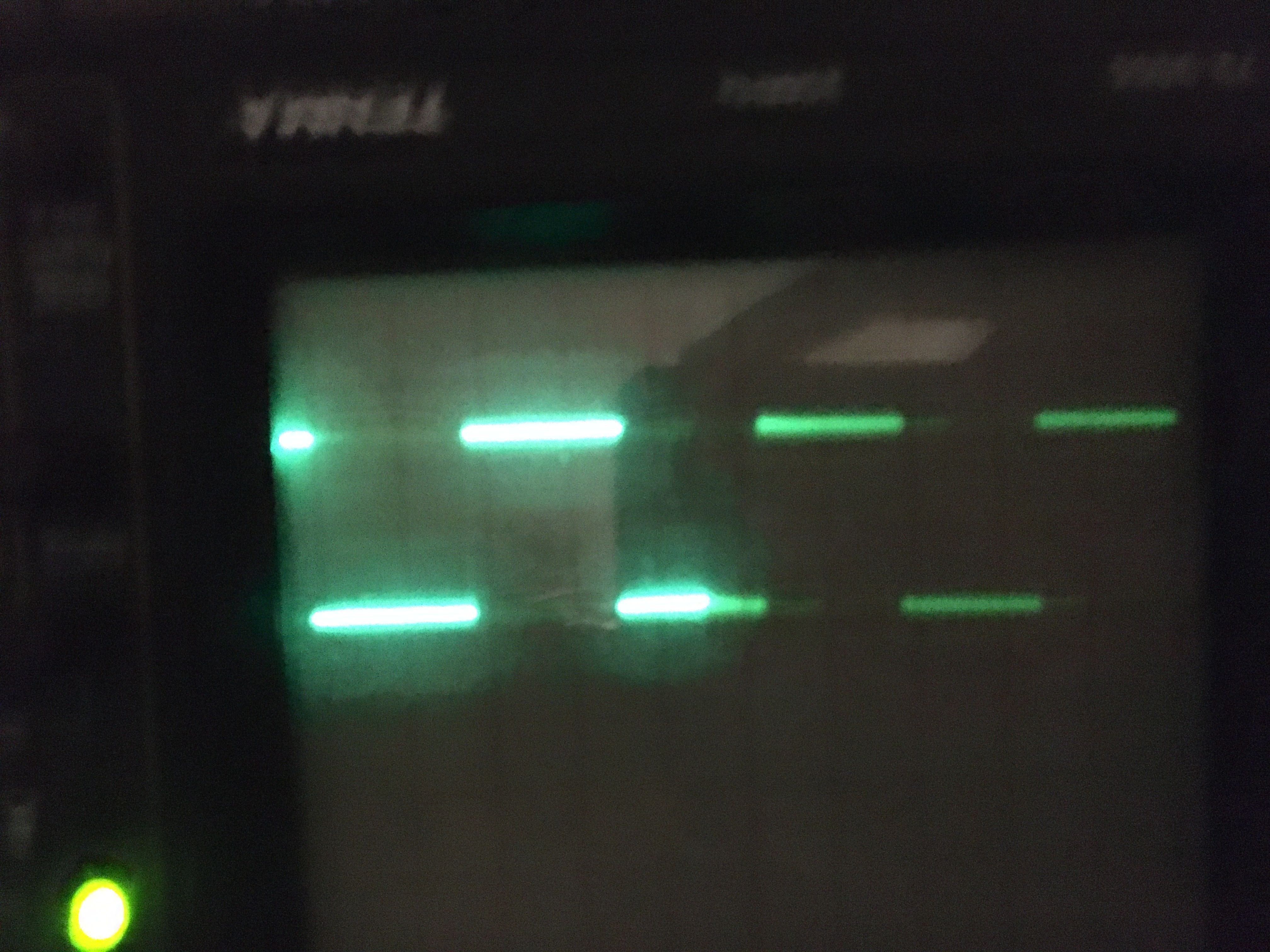

And when spinning the motor by hand:
(sorry about the image quality, I don't have tons of light in the garage, also it went upside down somehow)
A good swing from 0-5V.

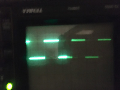

Now here's what it looks like when fslipspnt = 10 and ampnom = 1:
(also upside down... silly smartphone. So those spikes are towards negative.)
Not only is there noise that spikes below 0V (i'm scared to damage yet another STM32) but the encoder does not respond to the motor being spun!
The supply voltage remains at 4.98v throughout.
I changed the PWM frequency and the space between the spikes increased.
Of course this is some sort of noise from the motor.
But why won't the encoder send the output low when the motor moves? I've tried both 12v and 5v, same results; the encoder outputs stay at 5v with noise around that point.

Okay I've just got ungodly amounts of noise in the 5V line, of course right in line with the PWM output. I've got a rather long wire run for the pedal 5v; maybe I should just split that off and use a different power supply, I'm not even using the pedal for now.

Did you actually connect motor and inverter with another strap? This has characteristics of a capacitive buildup. It needs to be discharged ot level the potential.
Did you measure voltage from motor and inverter case to GND? I got 200V and a good jolt last time...

Yeah I got my jolts already (I think it was ~100v) so motor and inverter are both grounded. They are not directly connected though, I will do that.
Do I need a big strap? I might have a piece of 2/0 around, if not maybe 8ga will do.
The 5v power supply has noise in it. With encoder disconnected there is still the noise in the 5v supply (only with power going to motor). So I'm thinking that the encoder is not liking the noise and so it won't pull the outputs low. I'm also thinking about using a different 5v power supply or even a battery?

I think you should use a stable 12V supply for encoder. Is it open collector type? Then it may be in the brownout with 5V. Give it more voltage and it may assert signals better.
If you have push pull outputs however that is not the case.

SUCCESS!!!
I grounded the inverter with a giant strap and it works great now!

Isaac96 wrote: Tue Jul 07, 2020 6:15 am Any idea about the deadtime limits? The datasheet dictates at least 1.5uS from tdOFF and tdON. Should I just keep lowering it and trust to the desat to protect the IGBT?
I wouldnt trust desat with this more than a couple of times. Its stress on the IGBTs. I managed to kill both sides of Volt inverter by simply resetting the Olimex with 360Vdc. Bootloader took all of the PWM channels ON and they were toast before i realised the springy sound was not a normal event. Dont forget we only have datasheet for the IGBTs, drivers are proprietary data as far as i have seen. Fuji Electric Fi009.
https://www.fujielectric.com/company/te ... 6-2009.pdf
So if you have a diff probe you can observe what PWM channels are doing when you stress them. In any case you should avoid the tail of closing IGBT gate connecting the rising edge of opening gate IGBT.
I think higher boost causes the tail to elongate (complete switchoff time is longer) and top and bottom IGBTs meet = desat event.
I got this in my tuning sessions with old drivers. Then this would show as a very loud whine on startup. And with short deadtime IGBTs were toast before the year was over. Every time. I suggest 180pt or 185pt because it works without damages. You maybe can get away with 160pt. I wouldnt try less than 2.5us... My assumption was a bit on the lean side. I would take at least 800ns for one driver response time now. With some safety i would add a 1us then. It is just a blank time, it doesnt hurt anyone, whereas with tailstrike you can kill IGBT overtime...
https://endless-sphere.com/forums/viewt ... 5#p1461257
https://www.diyelectriccar.com/threads/ ... 922/page-5
Gradually i found out my car drives off best with 3Hz minimal slip, which seemed too much at first. But if i used 1.8Hz car would jump and then loose power like rubber band and i had to advance throttle to get it rolling further. Not a good way to drive in slow traffic.
Ampmin also plays a role here, because when boost is over and motor is rolling this value is powering this rotation with whatever voltage it reaches by then. If it is too much i noticed excessive drain when driving on straight road with motor overheating.
When i tuned out my new Skyper 32R drivers i got desat with too small a boost as well as too high. So i tried to use boost between 5000 and 7000. Smoothest start was with boost 7000 and 3Hz slip. Ampmin is at 21%. Also there is more regen energy with those settings...

Still haven't updated firmware, didn't have a lot of time today. I did spend some time trying lower deadtime levels and even using 180 instead of 185 gave OC either at start or at ~12mph (with full throttle). So I messed with ampmin and fslipmin and have improved low speed performance :)
But my start switch sorta died on me (or maybe the diode attached to it died). So the car is around the block and I will go fix it in the morning. Such is life....
