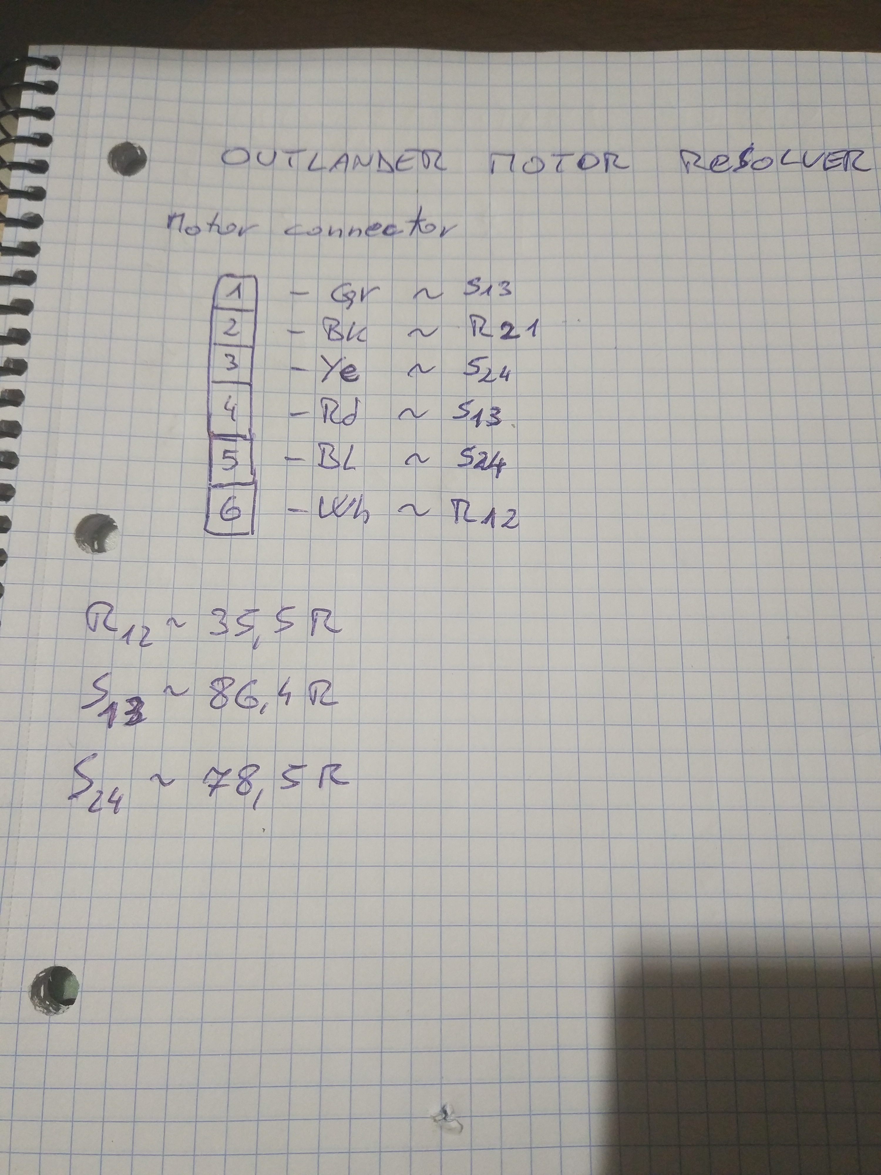

I got this resolver setup in my harness
R12 - 35,5R Black, White
S13 - 86,4R Green, Red
S24 - 78,5R Yelow, Blue

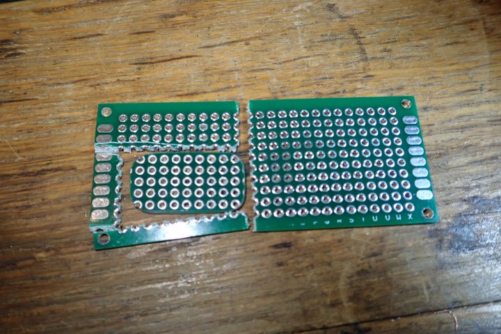

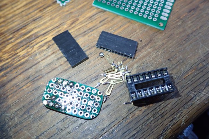

I'll add my resolver to the list,
35.7R Black, White
85.0R Green, Red
77.2R Yelow, Blue

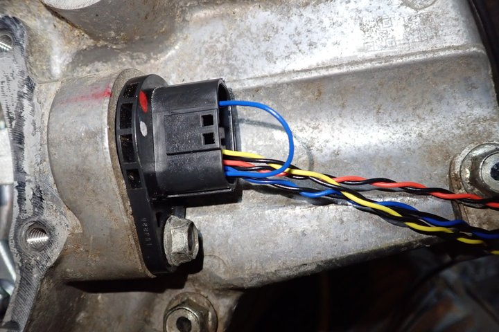

Sadly I spotted moisture damage on the resolver connector so I'll be abandoning it for some other solution.
The photo does not show up the tell-tale blue/green powder indicating corrosion of the crimp connector. This might explain why the motor was for sale on ebay without a gearbox attached.
Although I didn't spot that until after I bodged up a connector for testing and is not intended for any serious use.
I noticed the connector pitch was 2.54mm x 5.02mm which matches the holes in prototyping board and plenty of PCB connectors.
the pins are flat plate rather than a square pin so rather fragile when bodging anything to them.
An IC socket grips the pins whereas the other connector of the sort you have around the edge of an Arduino did not because the pins are flat plate rather than a square section pin.
I'll reinforce this is not a long term or serious solution and just for testing.
I thought I'd share this as no one has found a replacement connector yet.

How to determine the + and - so to say (or the right phasing) about the resolver?
for example did you tight green and yellow together on pin 2 or red and blue together on pin 2?
I'll take a look tomorrow when I am there and get back to you on that. I can't remember off the top of my head.
I found that on throttle my motor is a bit more unsteady, it will also sometimes not move and draw a bit of current. But I am not sure how much of that is to do with the PWM wires on the control board being wired wrong at the moment.
