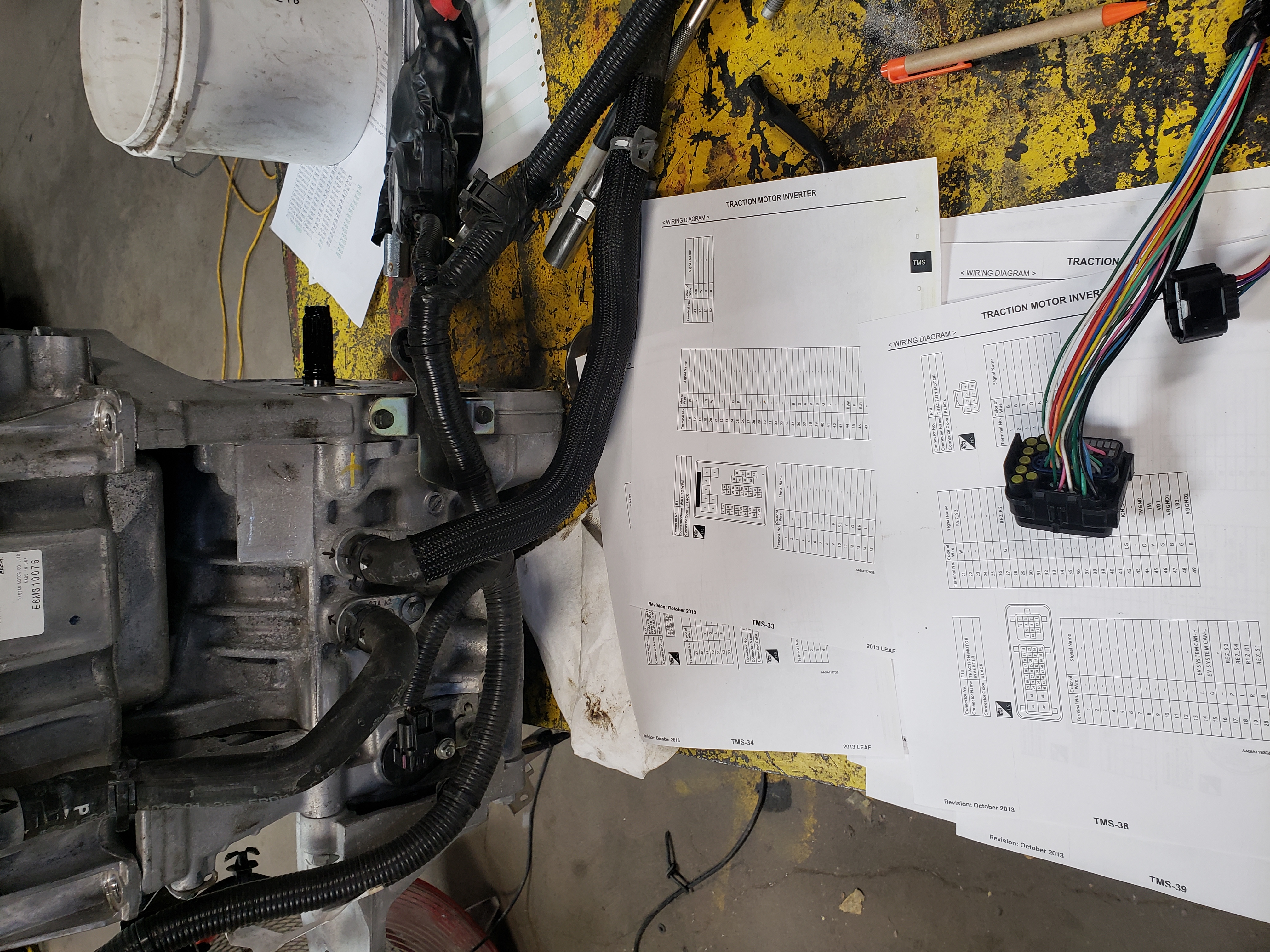

I've been googling and reading this forum and am reaching out.
I am looking for a place to download the 2015 nissan leaf schematics.
I purchased some weeks ago, but when I view them they seem to be wrong for my car and i dont want to waste money on a pig in a poke.
my goal is to use the oem engine harness with the new openinverter board I've received.
seems like an easy thing, but knowing the colors and locations eludes me.

You only need the loom part that goes from the invertor to resolver plug to use openinverter board
Jerryko has did a nice write up with pictures.
viewtopic.php?f=11&t=600&p=7643#p7643
