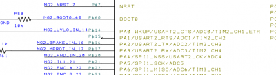

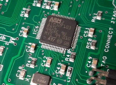

OK, finally got time to find schematics - this socket is not connected anywhere, so no need of it.konstantin8818 wrote: ↑Wed Jul 22, 2020 12:15 pm Board is equipped with socket for interlocks(two of them on the inverter). Is it mondatory those interlocks to be engaged for inverter operation?
Also a little question: this is a photo of STM on that famous smoked board: Two pins are bridged, is it OK, or I need to risk it with soldering iron to remove bridge?
- Posts: 656
If my pin1 reading is correct then you have bridged PA0 and PA1.
On the Rev2 board (Johannes' hardware) PA0 is the UVLO (or DESAT, can't tell which) and PA1 is the OC detect.
This board may or may not be the same. In any case bridges should usually come off anyways.
-Isaac
-Isaac
- Posts: 116
- Location: Kentucky, USA
The same two pins on mine is bridged to, should I remove it before something happens? Remove the solder and see if that fixes any of my problems

On Damien's board PA1 is not used, and PA0 is MG2_UVLO_IN. And we all know that Damien's board is operational, so I guess it is not a problem.
