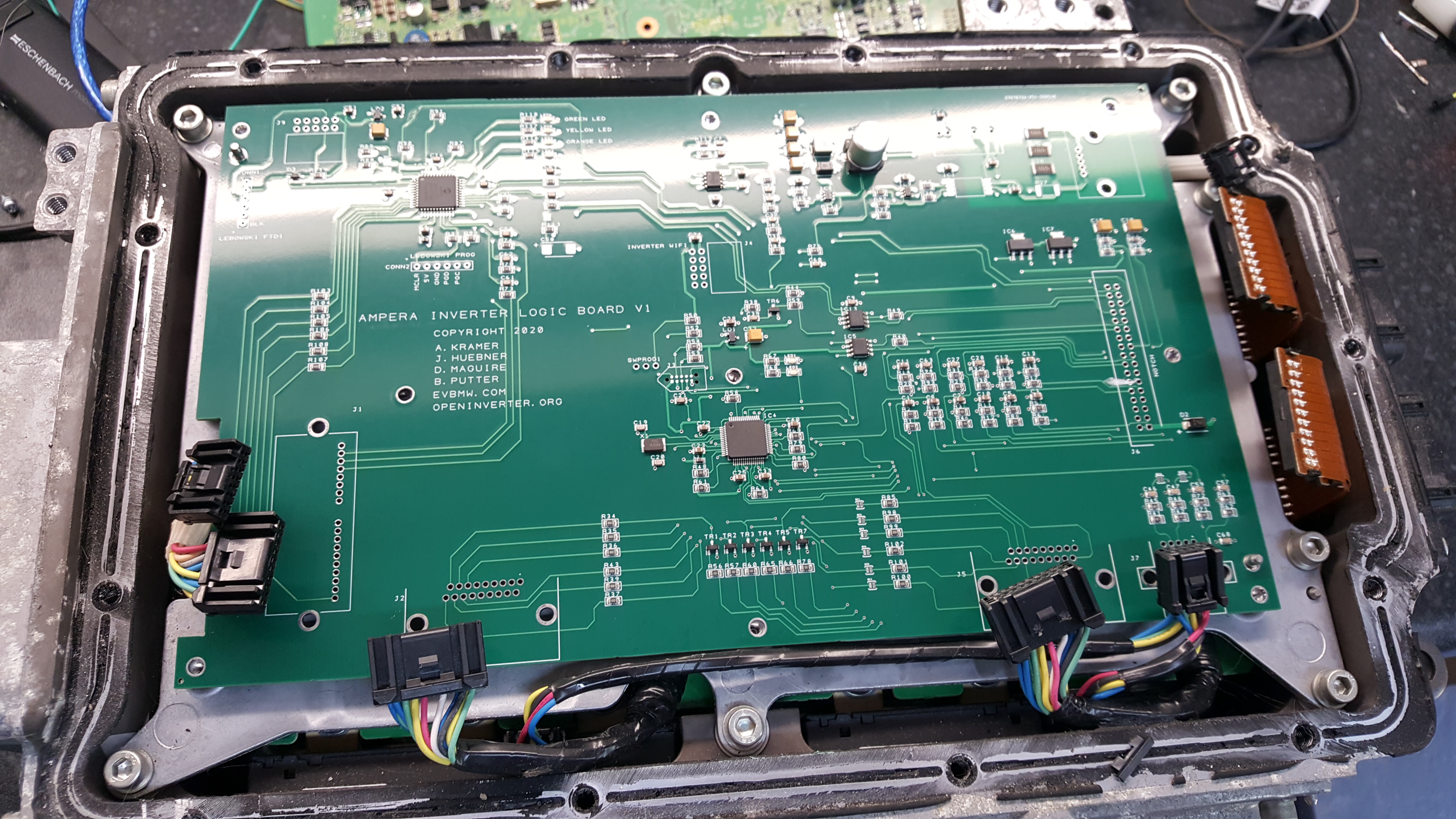

Just arrived:)

Re: VOLT/AMPERA inverter single controler dual IGBT drive
Woho! Really nice.
I see you use transistors to invert PWM signals. I thought to use SMD inverter chip myself.
Did you account for the encoder/resolver interface? I dont see it there?
Also i would advise to use bigger pins for the output signals. Well unless you intend to use the Ampseal header on separate board maybe?
We need to get Lebowski working with Wifi passthrough. That should be priority. Everything else should work as is...

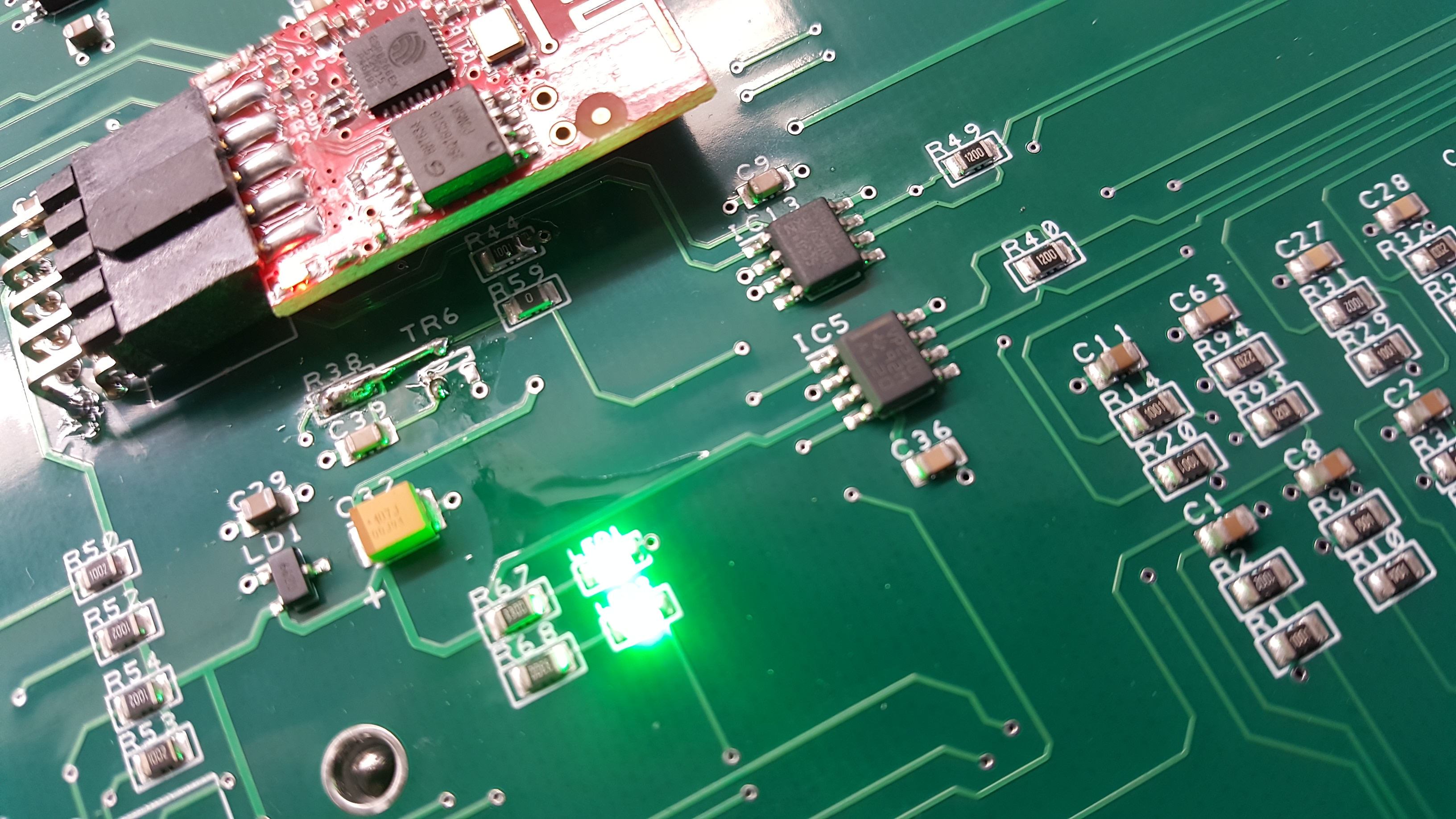

yeah I used the transistors to good effect with the prius design. It does indeed have resolver exciter and interface.
Board is a perfect fit and I managed to harvest the connectors from the oem card.

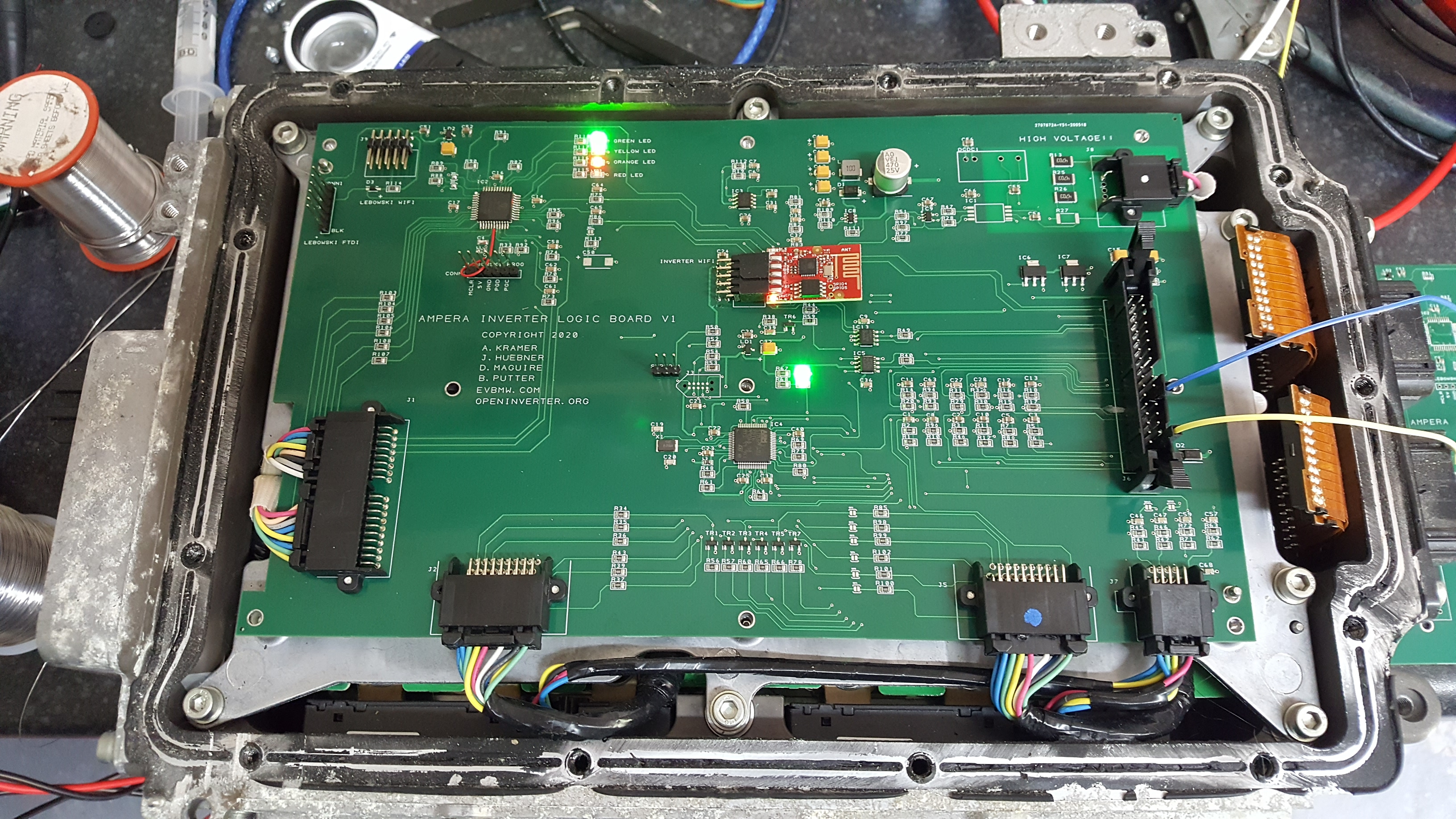

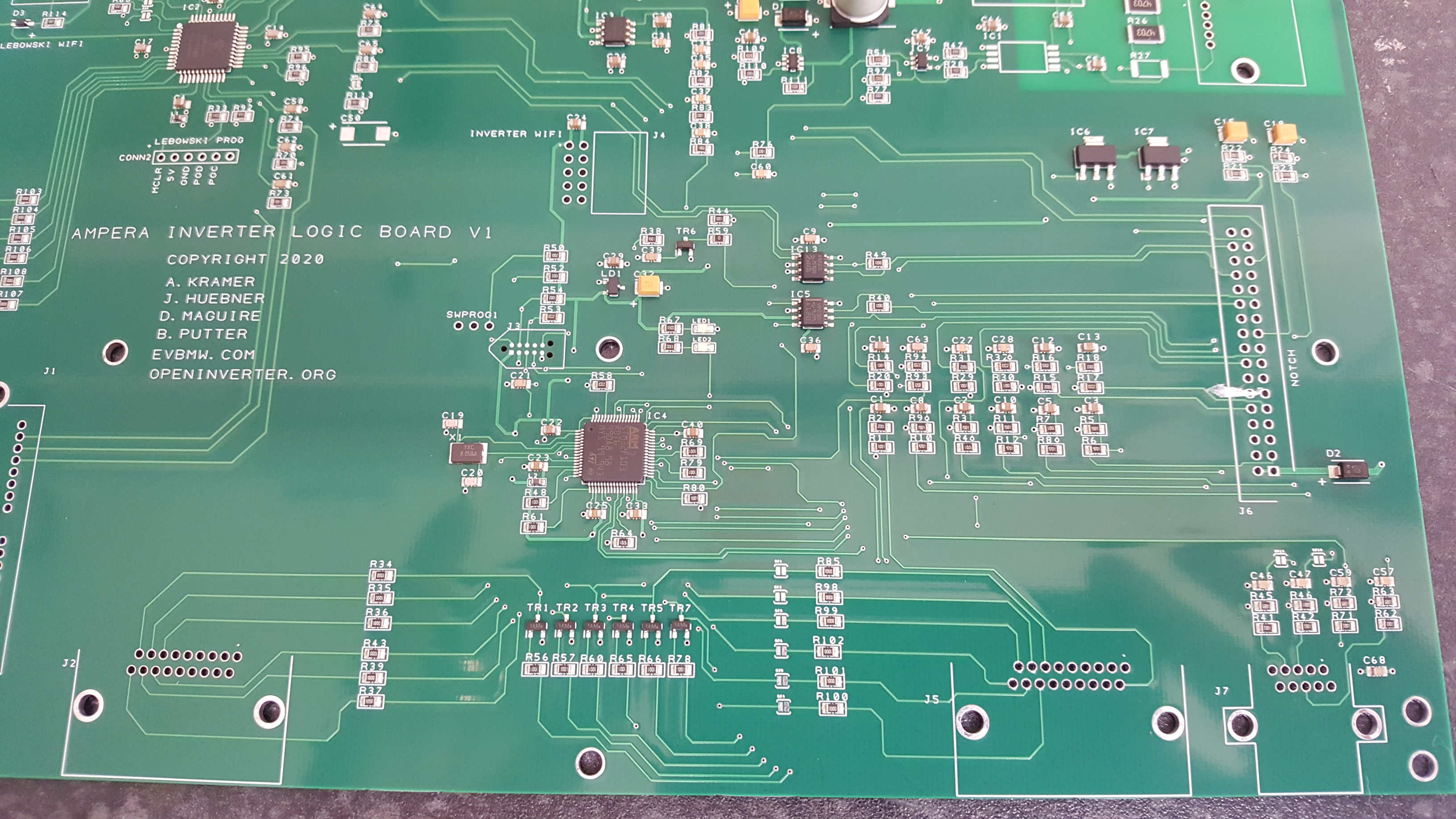

Good news is the Ampera V1 board seems to work. Bad news is there are a few Damien screwups.
1) Polarity is incorrect on analog Vdd and Vss pins on the Lebowski chip. Pin 16 should be +5v and pin 17 GND. See pictures. Modification required : Remove L1, Short out C4. Lift pin 17 leg and wire to +5v.
2)I assumed the fault lines to be active low on the main power stages. This is incorrect. They seem to be active high. Modification required :remove R38 and TR6. Short R38. Link R38 to TR6 collector as in picture.
with these mods done the Main power stages seem to work fine. Not tested Lebowski aux inverter as yet.
Arber you mentioned a serial pass through wifi? Where can I get this?
I'll pop the boards up on the webshop later nice and cheap due to the above. New rev will fix the problems once current stock is exhausted.

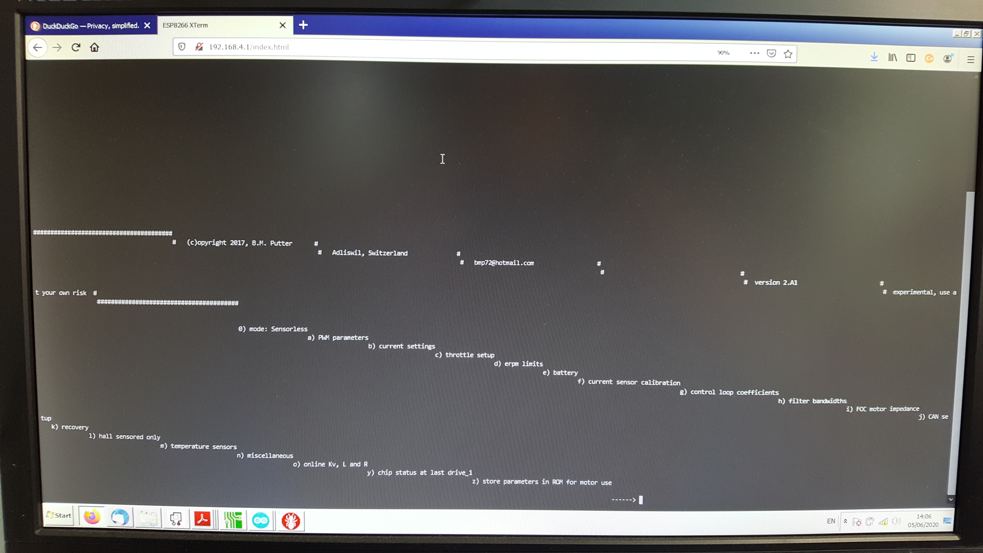

So installed the Dima interface on an olimex wifi module. Good news! it works. Bad news from my side I swapped the tx and rx on the pcb header of course and also looks like we have a formatting problem on teh interface side. Tested it on the Johannes brain and it works fine so must be something unique to the big L menu formatting....

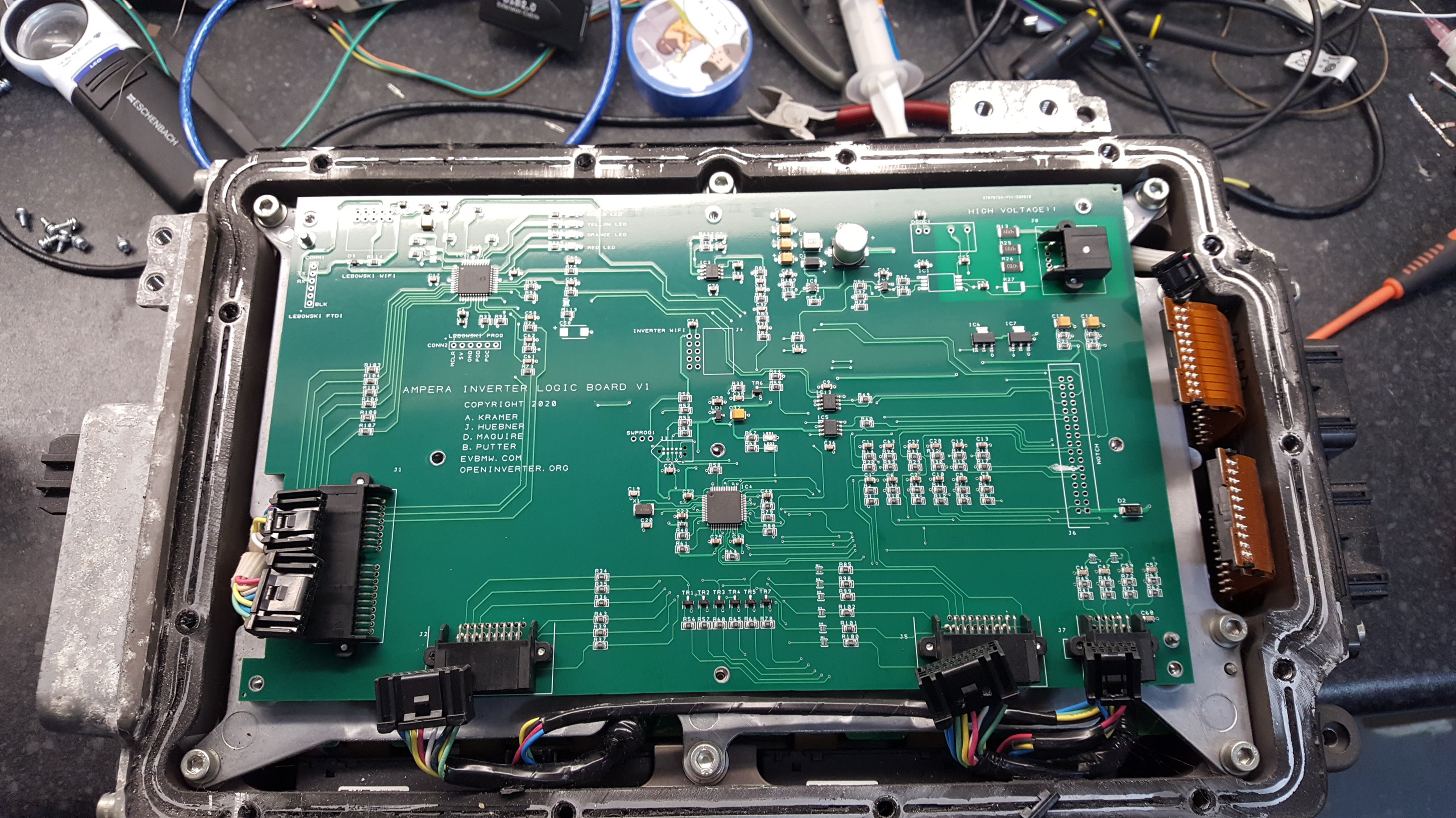

Thanks to Damien I got an Ampera board that I want to install in a chevy spark inverter.The inverter is except of the missing part for the second motor the same as the Ampera/Volt, and the board fits perfectly. They are also the right plugs wired for the connector.
As a precaution, I have some material removed from the aluminum carrier plate in the area of ​​conn2 so that the connections below have enough space.
I swapped pins 16 and 17 on the dsPIC to correct the polarity. After supplying the board with 12V, a green LED next to the STM32 and a red LED next to the dsPIC light up. Fine, no smoke, power supply OK.
To program the STM32, I use the STM32 ST-Link utility with an STM demo board (STM32L053) and the SWPROG01 port. As with the Prius Board, this was possible without problems.
After programming, one green LED next to the STM lights up and the second flashes.
I ordered a PicKit2 programmer for the dsPIC to program via the DSPIC PROG PORT. I use the PICkit2 programmer as software.
When read the dsPIC, the message "No device detected" appears, and the red LED flashes briefly once. OK, try to program, LED flashes twice, message "No device detected" nothing else. :(
After ordering a replacement dsPIC I search again all connections in the circuit diagram and also compared it with the version by BobC. When tracking the leads in the Schematic.PDF from Damien I came across SJ7 and SJ8.
Oops, the lines on the programming port hang in the air.
After bridging the jumper SJ7 and SJ8 the next attempt and what a surprise, it works. The dsPIC is found by software and after programming, all 4 LEDs next to the dsPIC also flash. :)
Now it is time to connect the further connections and testing.
Martin

I can communicate with both inverters on the board via the FTDI port / WIFI connector.
Unfortunately, the settings for the terminal program are slightly different.
For the communication I use PuTTY.
The settings for the COM port are the same: 115200,8,1, N, N
edit: Johannes says 115200,8,2,N,N for his board, it worked for me with 1 stopbit, but 2 stopbit are safer and do not interfere with Lebowski.
In the terminal setting for the Lebowski Inverter "CR for every LF" must be activated, for Johannes Inverter not.
Without a complete setup, two pairs of LEDs for the Lebowski flash alternately.
The Lebowski Inverter only responds on the COM port after a setup signal.
To do this, pin 38 must be set to low while reset or switch on and all LEDs are then dark.
There is still a jumper missing on the circuit board, I solderd a pin directly to R87. The setup manual says Pin 19, but this only applies to the DIL version of the ds30F4011.
If you then press enter in the terminal program, the setup menu appears.
RX and TX are interchanged on the WIFI connection of the Lebowski inverter, this has to be taken into account when using.
So far I have only tested the direct connection without WIFI.
