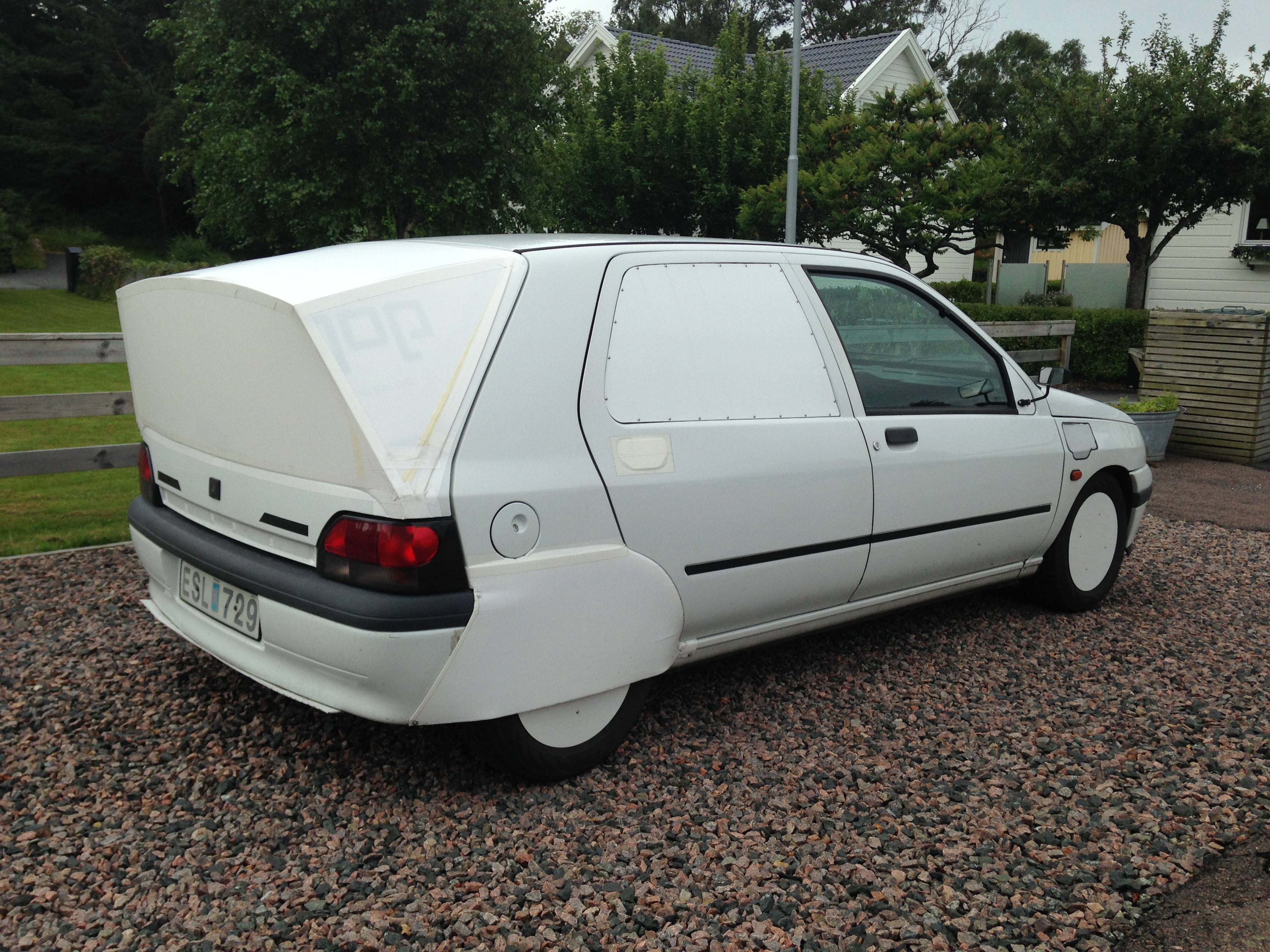

A short introduction to my project car.

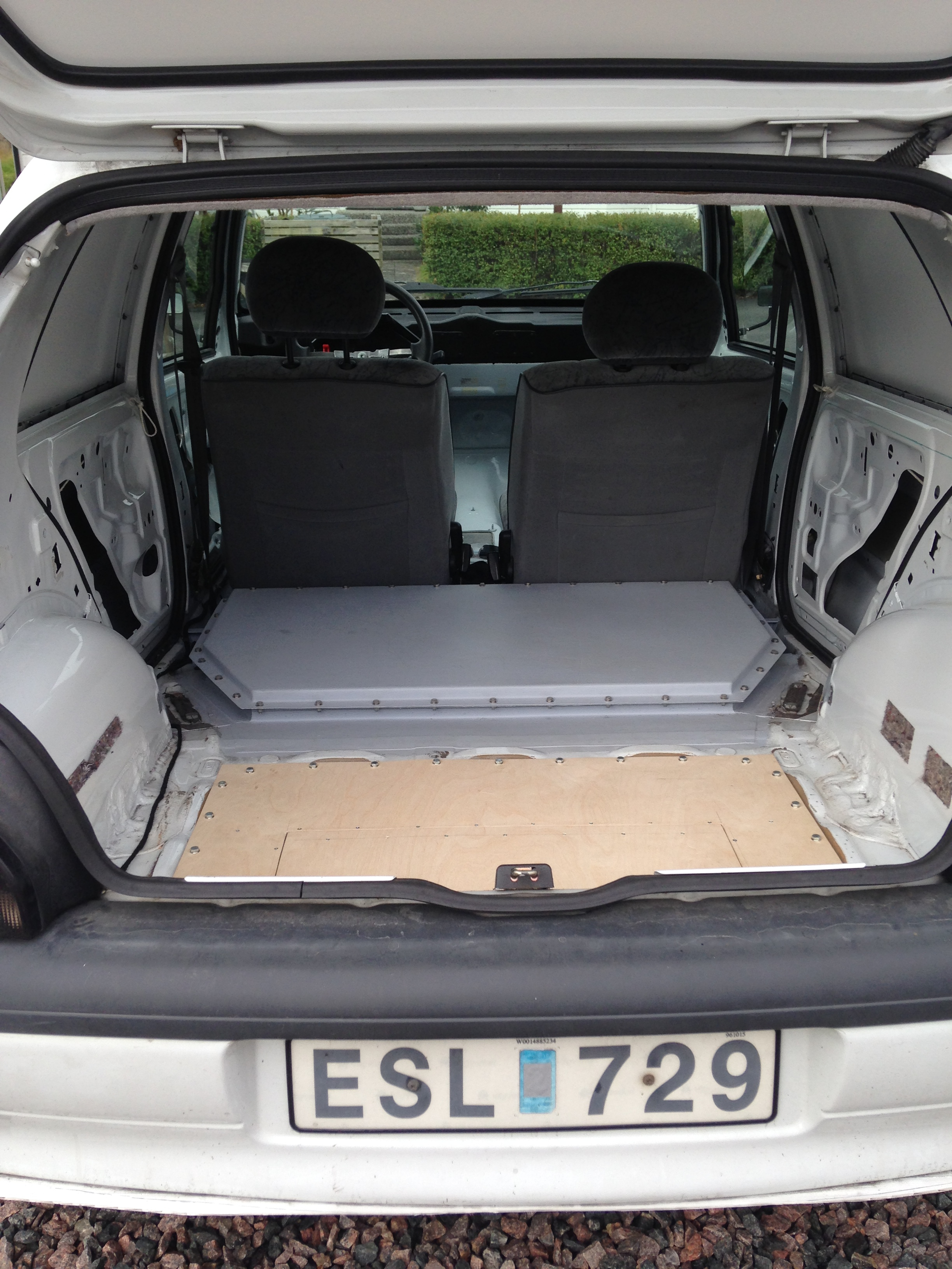

It started out as a stock Renault Clio Electrique from 1997. I bought the car in working condition but without the original NiCd batteries. First thing I did was to build a battery pack from used Headway 40152 LiFePO4 cells and fit them in the car. Ended up with a 42S5P pack with nominally 134V and 70Ah.
Then I built a BMS based on LTC6801 cell monitors and an Arduino Pro Mini.
Got the car past the anual car inspection in this condition.
Now the madness begun. Started removing some weight and also added some small aerodynamic improvements in hopes of improving the cars overall efficiency. One thing led to another and the attached pictures show what the car looks like today. Consuming less than 1kWh/10km @70km/h from the wall power outlet (including losses in the charger) and with a cerb weight of 810kg.
So why am I posting this here you might ask, this is not a conversion project.
Yes, well, the time has come to replace the stock motor and motor controller with something more efficient and more lightweight so my plan is to use a Lexus MGR and a Toyota Yaris Inverter.
The stock motor is a SepEx DC motor with a stated efficiency of 84% and a weight of 75kg. The stock motor controller weight is 15kg and the stock gearbox is estimated to 30kg.
I'm hopeing that the MGR will have an efficiency above 92% and with a total weight reduction of 60kg I think that the cars total overall efficiency will be increased by around 10%. Time will tell!
As of now I'm gathering the parts I need.
I appreciate any thoughts and ideas on how to further improve the cars efficiency!

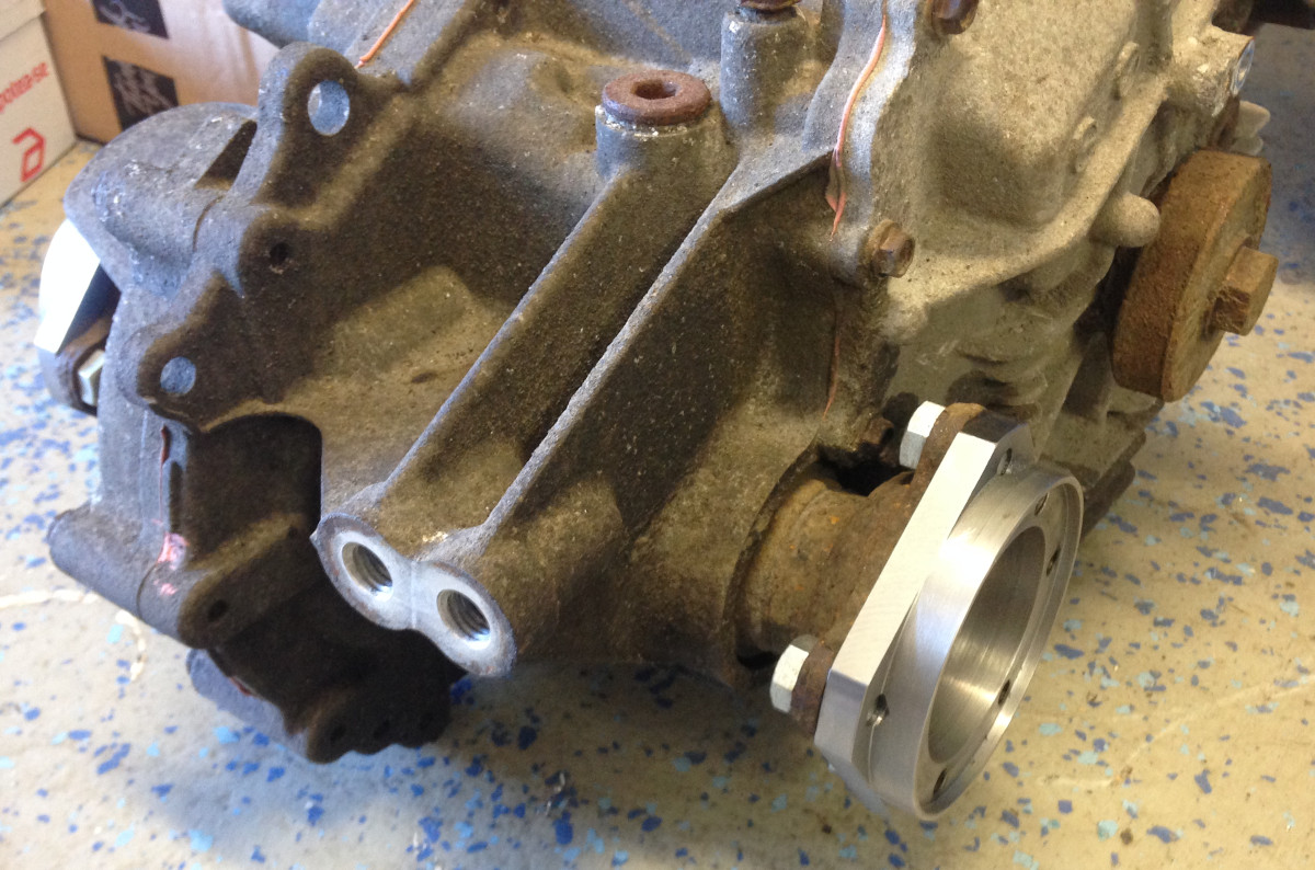

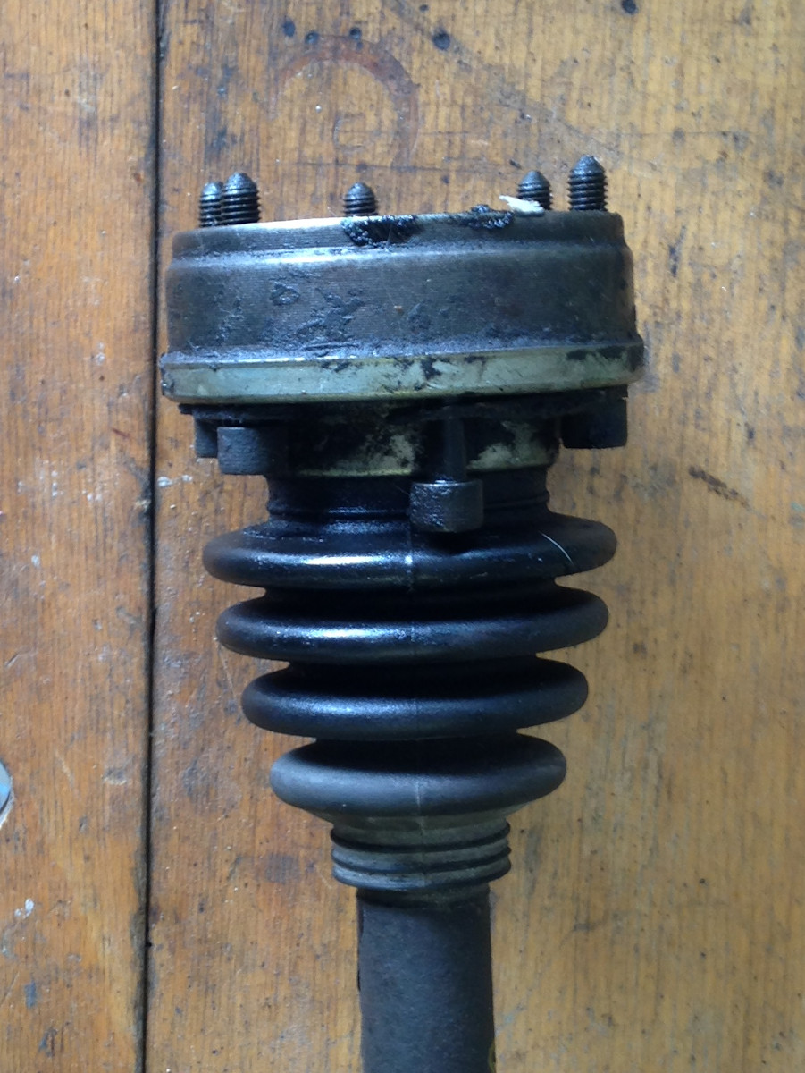

Have started the job of fitting the MGR to the car. First up is to adapt drive shafts / half axles.
My idea is to use VW drive shafts as these have bolted inner CV-joints and are available in many different lengths.
VW_drive_shaft_length.pdf

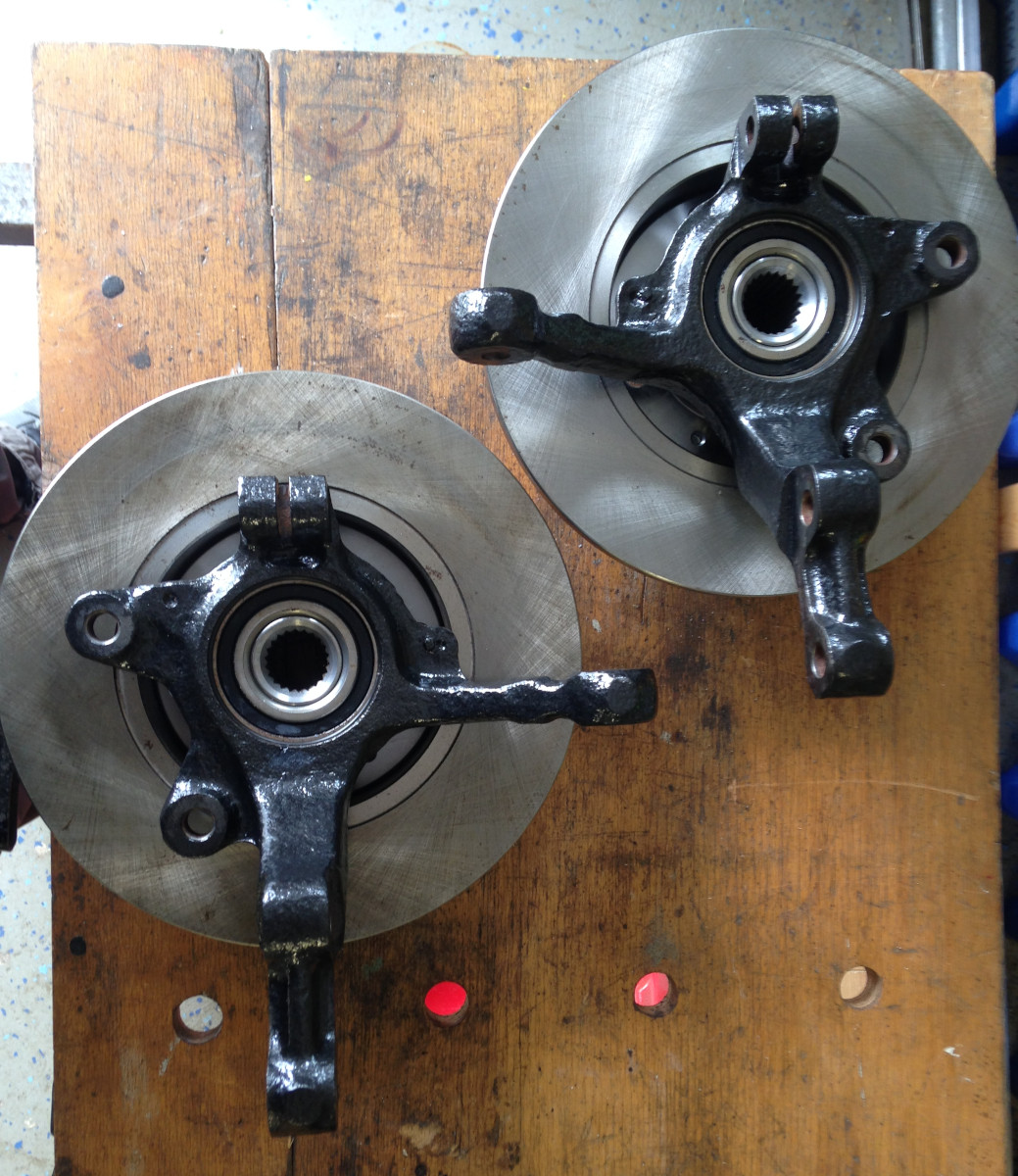

To fit VW shafts in the outer end I will use Clio uprights with Clio wheel bearing and VW Lupo hubs. The diameters fits but needed some adjustment in the lathe on the inside length to allow the splined axel of the CV to slide in 1mm further. Also fitted with VW Lupo brake disc.
Should now fit with Clio calipers. Job done!
Next job is to make an adapter to fit them on the MGR output flanges.

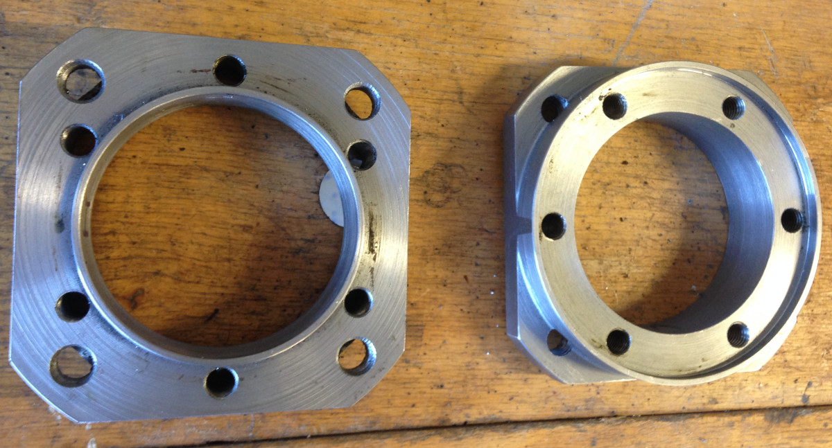

Adapters between MGR output flanges and VW driveshaft ends done!

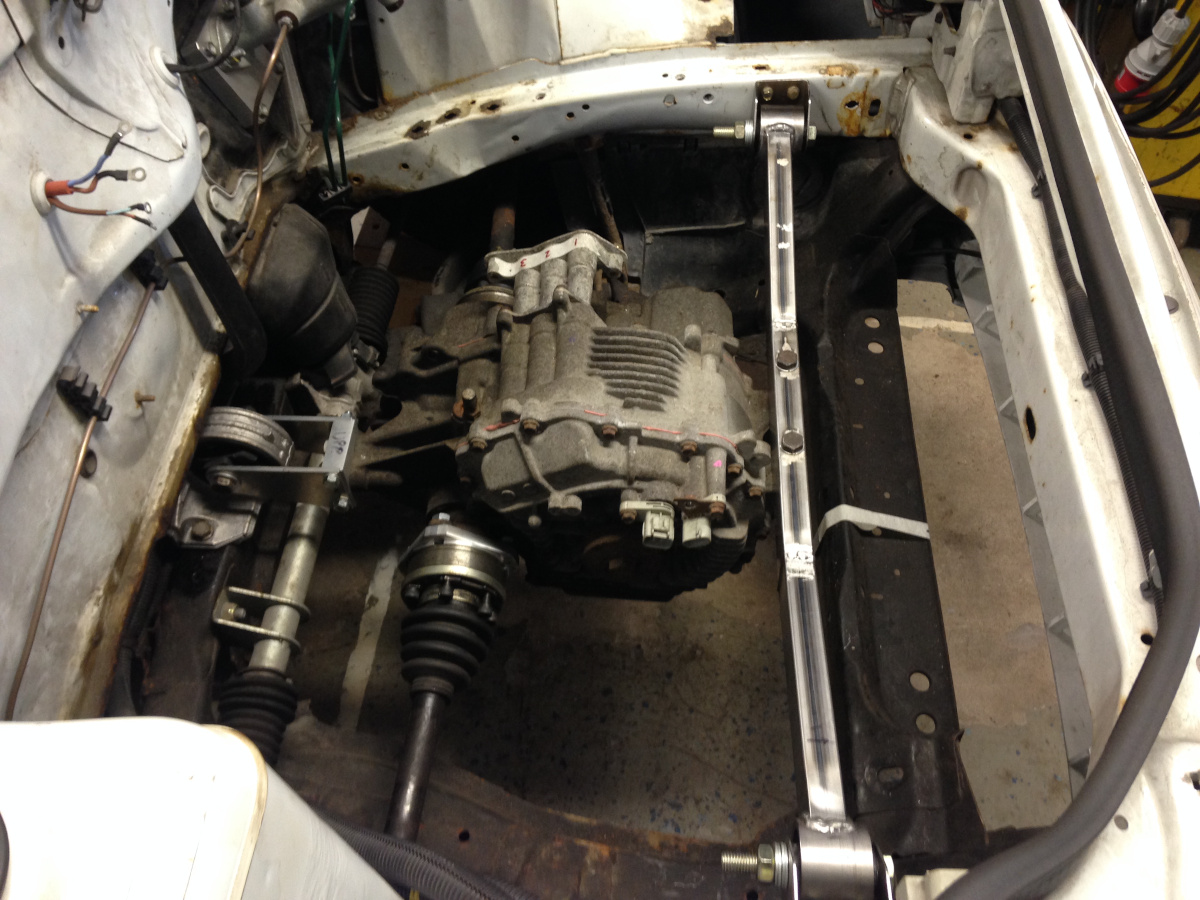

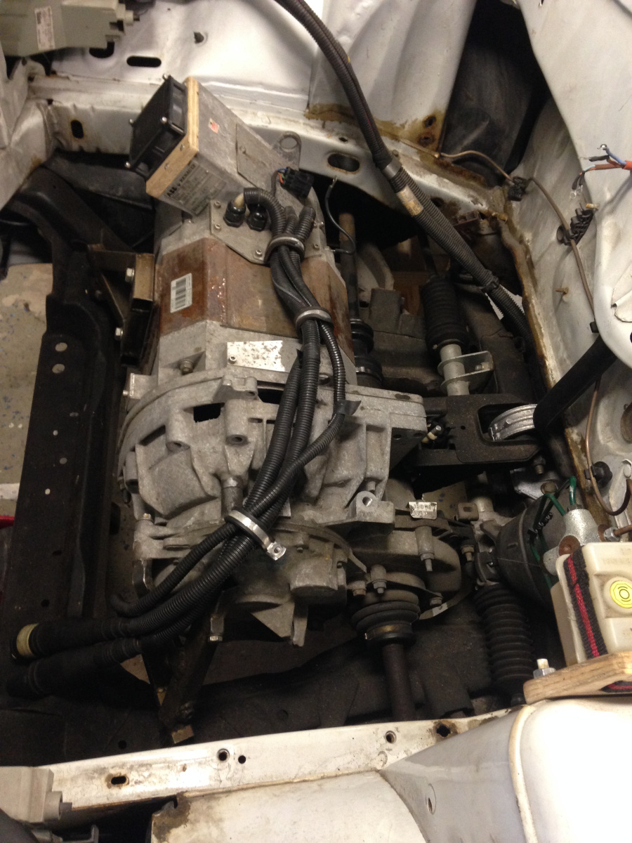

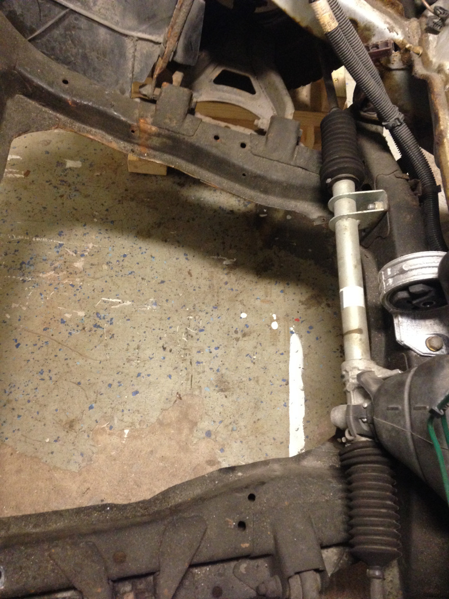

Have started to disassemble the car.
Out with the old...
I have also replaced the uprights to the ones with the VW hubs.
Next up is to start fitting the MGR.

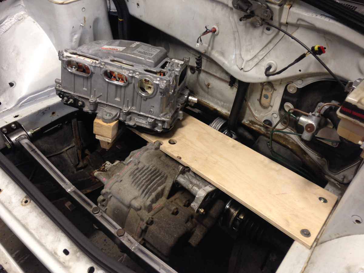

Re: Renault Clio Electrique -97

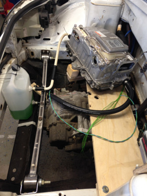

Post by bexander »
In with the new...
Next, fitting the inverter.

Post by bexander »
Some progress today. Yes, it temporary.

I have a dxf file for the flanges but I'm not able to add it as an attachment?
bexander
Posts: 867
Location: Gothenburg, Sweden
Has thanked: 71 times
Been thanked: 97 times
Post by bexander »
I made a pdf from the dfx in scale 1:1.
Drive_flange_adapter.pdf
I might need to add some measurements for this to make sense as a pdf...
bexander
Posts: 867
Post by bexander »
I adjusted the flanges thickness today down to 13mm (was 18,5mm) so I have updated the drawing accordingly and added some measurements.

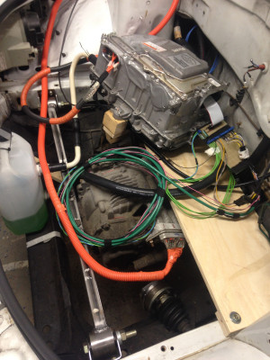

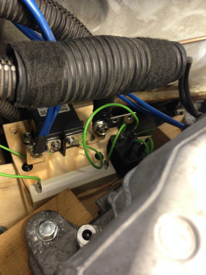

A basic cooling system and some wires.
And some HV contactor/precharge wiring.
bexander
Posts: 867
Post by bexander »
Temporary wiring in place.
Have tuned syncofs and adjusted some other parameters with full pack voltage.
Yaris_MGR_FW4_90FOC_2020_09_27.json
Next I need to regrease the half shafts and then it is time for a test drive.
