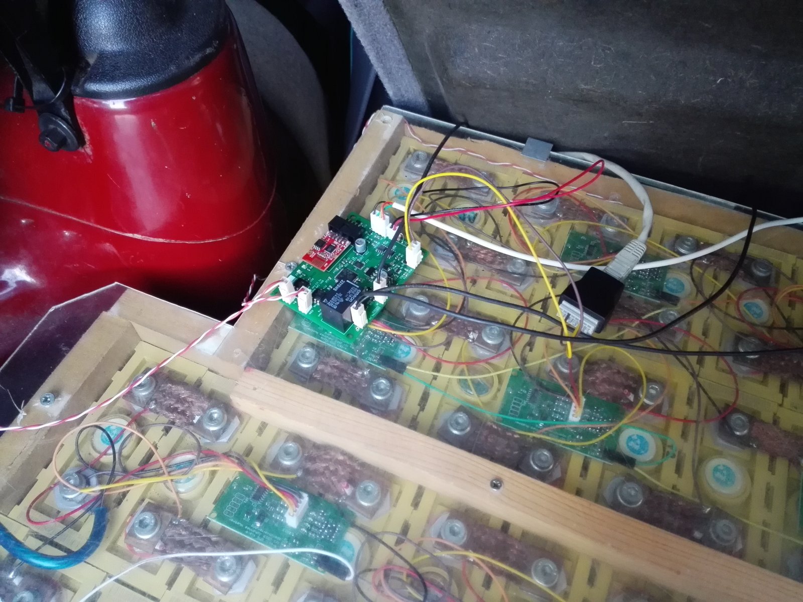

Re: 4-channel BMS with daisychain bus
Finally I got to work on the BMS again. I connected it to the 99 cells in the back and also connected fuel gauge, charger (inverter) and a current sensor. All works a treat.
I will build the system up fully with another master unit in the front that acts as a slave to the master unit in the back. Communication is via CAN. With that done I will extend the software to execute more BMS functions.
The BMS presents a challenge when it comes to selling it. The quantity of boards is higher and they are fully build, so not kits. That has a couple of legal implications. Therefor I'm currently working with a distribution partner who will ship out the hardware while I will just sell the master units software.
Slave boards will certainly cost less than 10€, so less than 2.50€ per cell.
Also there is demand for modules with more channels. Damien considers building a centralized unit that would basically unite a couple of slave boards and a master board on a single PCB.

Worked on the integration a bit more today. I botched the master board to be able to turn itself off by pulling the enable pin of the 5V regulator low. So now the BMS can do its thing like long term SoC estimation and balancing and then turn itself off after a couple of hours. Current draw should be in the uA range but I haven't measured.
Initially it is enabled by the ignition input and never turns off while that is high.
In Polo I use the front BMS unit to control the brake vacuum pump - there is an ADC input, there is a relay output, so why not, I thought :)
Since the questions keeps spawning: I am not ready for selling yet. The master software is still at an early stage but most of all I'm reluctant to sell non-kit electronics. Still working towards having the system sold by a distribution partner, but that also takes time to set up.
I will tune up the JLCPCB BOM a bit so that you will be able to just buy the boards yourself. Issue here is that the cell boards need quite a lot of calibration done as they won't measure accurately otherwise. So quite a lot of ground work to be done here. I have to ask for patience, still.
