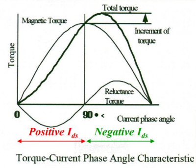

When you say fixed value do you mean x amps or do you mean x=-y%Iq?
To achive MTPA on an IPM motor Id = -x%Iq . In the case of say a gen2 toyota prius x turns out to be -30 % of Iq. x needs to be determined experimenally and is different for IPM motors of different designs primarily because in FOC speak the inductance on the d axis is determined by the physical structure of the rotor. So from that perspective Id must be dynamic for best performance. And we should only employ FW once we have approached the maximum rpm with the available line voltage.

Re: Testing FOC for synchronous motor
With normal FOC control, Iq's sign is direction of torque production.
Consider the 4-quadrant operation:
Motor direction = forward; Positive Iq = motoring torque.
Motor direction = forward; Negative Iq = regeneration torque.
Motor direction = reverse; Negative Iq = motoring torque.
Motor direction = reverse; Positive Iq = regeneration torque.
An IPM will always want negative Id:
