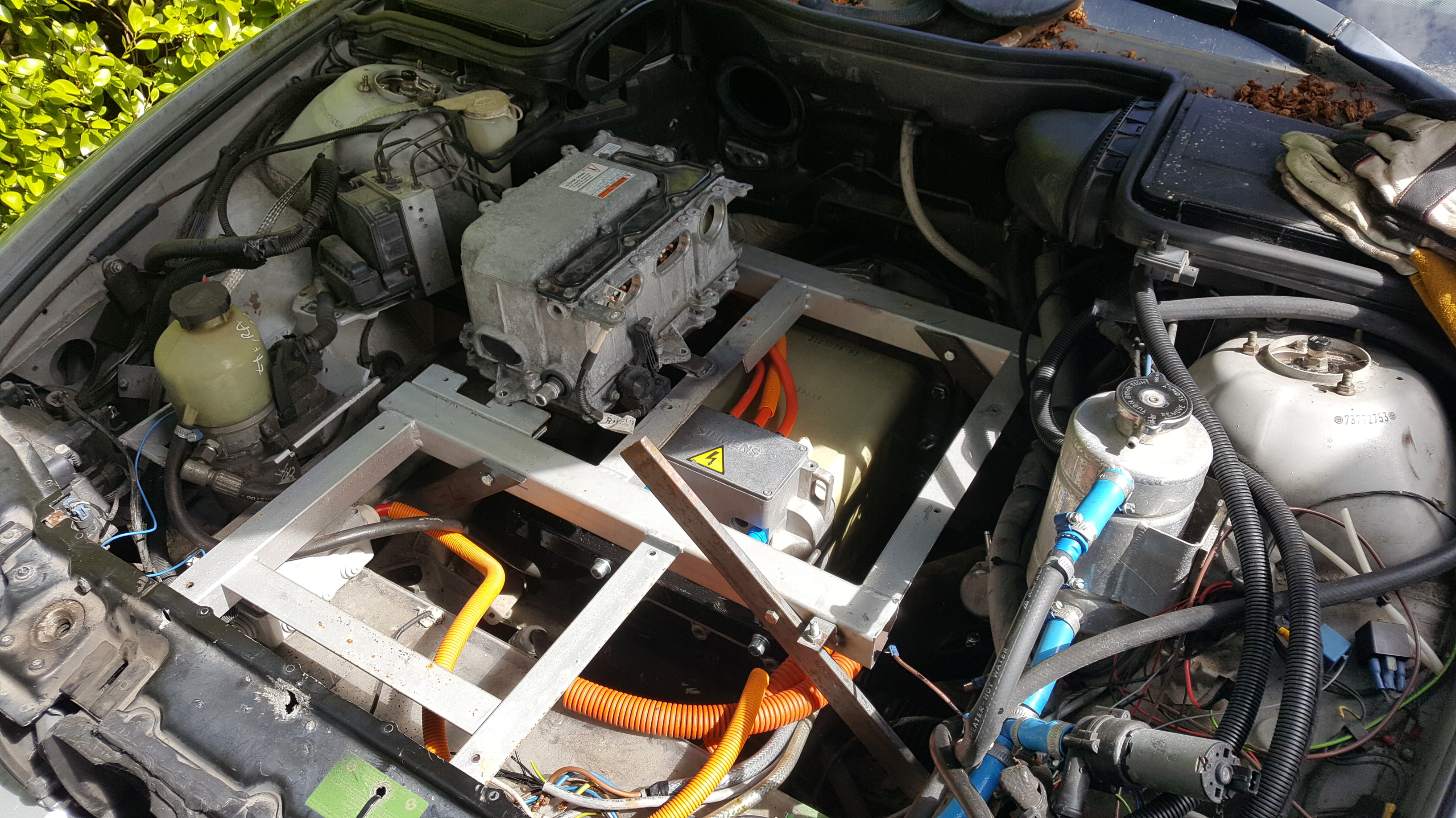

Making progress on the E39. Modified the mounting frame to take the Prius inverter. Trial fitting looks good so far.
