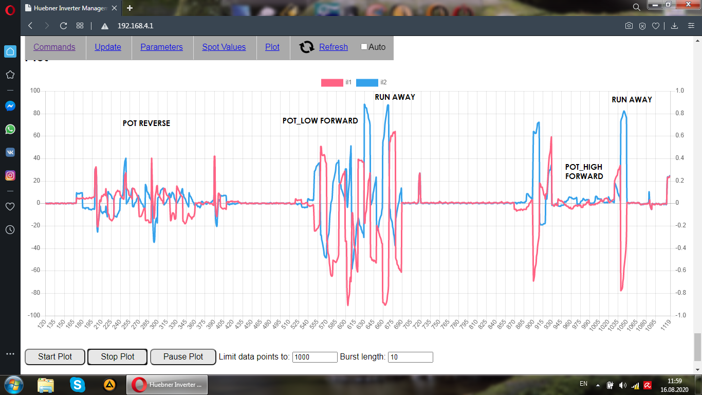

So, it runs smooth but only in reverse.Only in MGR reverse. If only schaft starts spin forward, and accelerator is released, motor starts to jump uncontrolled. It happens only if I release accelerator. What could it be?

I've used Damien's custom Prius GEN3 FOC software, and pwmswap was already set to "PWMoutput13"
When I reached syncofs from 0 to 22000 even manualid of 300 Amps couldn't move rotor, all it did only jitter a little, at 21850 it only did whining noise, and didn't move at all, from gas pedal however in forward it run away....
Here are parameters I read:
id and iq while running smooth from accelerator pedal in reverse: il1 and il2 while running smooth from accelerator pedal in reverse: il1 and il2 when running smooth in reverse, when running smooth forward at high speed and in run away when accelerator is released: No matter the direction, position caprure seems good in both directions: and video of process. Sorry for my English

So problem #1 is to find out correct value of respolepairs and polepairs... and max_motor_current

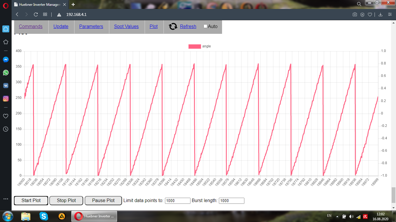

When I did the syncofs test my motor started spinning at manualid = 20, if it was offset (0 or 32768 was the ones for me). Using a 36V 44A power supply to power the inverter HV side.
In manual mode when I spin the driveshaft flanges in forward direction the angle plot rises, if that makes any sens?
Have you selected a direction when doing syncofs test?
Pictures of my phase order.

I will describe in text how I concluded that resolver poleparis is 2 and motor polepairs is 4 for the MGR. If I screwed up, please let me know.
Slowly spinning the motor using sine firmware in manual mode. Check the time it takes for a complete revolution on the flanges. Say it took 5s. One revolution on the motor then takes 5s/6,86 = 0,73s.
Using a signal generator generating a sinewave at 4kHz and an opamp supplying it to the resolver excitation and then measure with the oscilloscope on one of the two resolver windings. For a time of 730ms I got 4 peaks, which I interpret as two "electrical revolutions" on the resolver, hence two pole pairs.
(Absolute value of sine will have two maxima for one revolution (0-360 degrees).)
To check motor pole pairs I now disconnect the motor phases and measure with the osilloscope between any two motor phases. Now spinning the motor by hand I got 4 full cycles of sinewave while having 4 resolver peaks. My conclusion is that for one motor revolution I got four "electrica revolutions" on the motor, hence 4 pole pairs.
Now I will, also tomorrow, try to check the actual flange/motor rpm agains the software reported rpm. If they match the resolver is at least correct.
