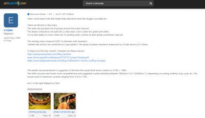

Max_motor_current for the MGR is ~110A according to this:
Also according to this and my pure knowledge about motor polepairs, if there are 8 coils, there is actually 4 pole pairs. :?
And in that thread it was a guess that resolver also has 4 pole pairs.
Will check it right now, with max manualid of 55A

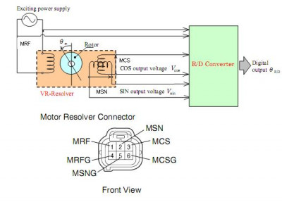

I'm officially state that I'm now achieved confusion of the highest order: revolutions count changes whenever polepairs or respolepairs is changed.
Jack Bauer wrote:What changes in terms of signals when we reverse motor direction?
Does direction depends on iq being positive or negative? Motor runs smooth both directions if I enter negative or positive manualiq, while manualid is 0.1 :?:
From now I'm not writing anything about this case. I'm reading now. :oops:
Posts: 3667
Has thanked: 12 times
Been thanked: 353 times
In order for the inverter to calculate the angle of the rotor it needs sine and cosine inputs. Each of these has two wires. Therefore there are 4 possible connections for the sine and cosine signals.
Johannes uses an arctan function of these two signals to calculate rotor angle.
https://www.rapidtables.com/math/trigon ... rctan.html
So, suppose you had one of those signals backwards. Guess what happens? :)

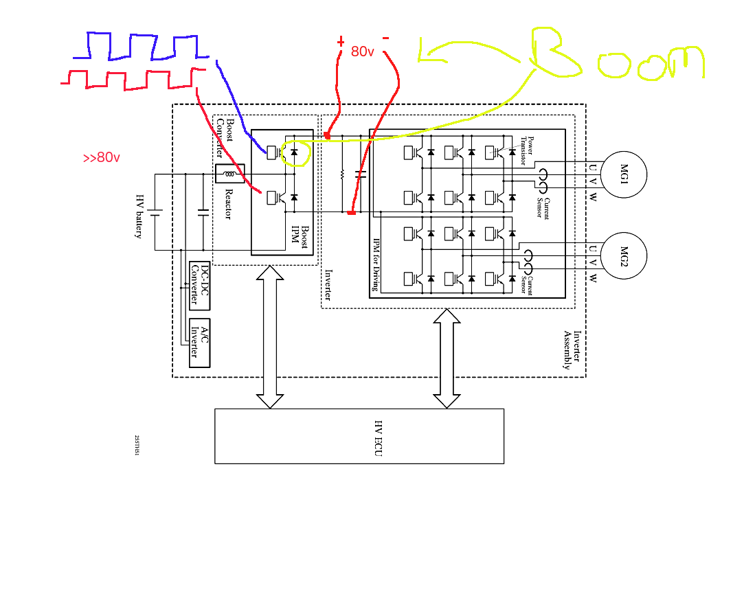

I'm having issues with the buck/boost.
Setup:
I've got 83v connected to the right most side (DC Bus 2) and a volt meter on the left (DC Bus 1)
If I PWM pin 10 I get 83v on DC Bus 1, regardless of PWM value.
If I PWM pin 9 I get 0v on DC Bus 1, regardless of PWM value.
I've attached a scope on the correct pins of the connector on the Toyota board on the other side, so I'm assuming the 50 pin connector is not the issue.
BOOST_FAULT is held at 5v, I'm assuming it is pulled low for a fault.
I've got to be doing something stupid somewhere.

I just verified the MGR resolver polepair to 2. Set the motor to spin at ~1670rpm according to SW and then measured driveshaft flange speed with a optical tachometer to 244rpm. Result, 1670 / 244 = 6,84. Gear ratio is 6,86 so I call that a match!
konstantin8818
Posts: 290
Location: Minsk, Belarus
Been thanked: 10 times
Post by konstantin8818 »
bexander wrote: Tue Aug 18, 2020 4:28 pm I just verified the MGR resolver polepair to 2. Set the motor to spin at ~1670rpm according to SW and then measured driveshaft flange speed with a optical tachometer to 244rpm. Result, 1670 / 244 = 6,84. Gear ratio is 6,86 so I call that a match!
Yup, already came to this conclusion as well :) "angle" parameter is calculated not only by "respolepairs", it also depends on "polepairs" as I've found out. I believe, Johu can tell exactly how it is calculated...
Anyway, for some reason, I had to swap sinus phases of resolver, for it to operate correctly. I really don't know why they were swapped in first place. Either toyota engineers can make it work correctly with software and they don't care what is the polarity, or someone already played with them before me.
Apologies for being thick, but if I understand correctly, Resolver pin #5 is now MSN and #2 is MSNG? If so, that is very odd indeed.
MGR Resolver
MGR Resolver
konstantin8818
Posts: 290
ZooKeeper wrote: Tue Aug 18, 2020 5:59 pm Apologies for being thick, but if I understand correctly, Resolver pin #5 is now MSN and #2 is MSNG? If so, that is very odd indeed.
Before swap sine, I've swapped cosine, it didn't helped. So I've switched it back. Red wire was connected to 5 and now it is connected to 2.

I've blown up my power supply, this is my theory after looking at a diagram.
I've fed in to pin 9 and pin 10 complimentary PWM with a deadtime, verified this on oh-silly-scope using a Arduino UNO, all good. Signals as expected.
int val = 80 ;
int dead = 20 ;
void setup() {
  Serial.begin(115200);//
  TCCR1B = TCCR1B & B11111000 | B00000010;    // set timer 1 divisor to  8 for PWM frequency of  3921.16 Hz
  TCCR1A = (TCCR1A & 0x0F) | 0xB0 ; // set pin 10 inverted
  analogWrite (9, val-dead) ;
  analogWrite (10, val+dead) ;
Run this on the board in the inverter and my power supply released all the magic. I noticed the diode on the high side on the diagram. My theory is I very briefly boosted the voltage above 80v and the diode lets it pass through to DC bus 2 and caused the boom?
With the upshot being that it cannot boost from DC Bus 2 to DC Bus 1 and therefore cannot be used as a charger on single phase for packs above 340VDC?

Did you precharge main capacitor before connecting power supply?
Posts: 1783
Has thanked: 83 times
Been thanked: 430 times
I did, turns out I've blown an internal fuse on the power supply, My other thought was I boosted enough to enable the DC DC that then put a big load on the power supply.
Can it buck and boost is both directions?
I'm thinking maybe not because of the diode on the high side IGBT, but I'm far from an expert in these things, and trying to learn along the way.
Posts: 3667
It can only boost from the battery input to the hv bus and buck from the hv bus back to the battery input.

Thanks for clearing that up. I guess that means if you want to use single phase to charge the higher voltage pack you could use an external rectifier and boost from the battery input?
celeron55
Posts: 804
Has thanked: 38 times
Been thanked: 136 times
Post by celeron55 »
That's one option. The other option is to use an external voltage doubling rectifier to feed the HV bus.

Just a bit of info on the boost inductor: It is 258.5uH inductance at 10kHz, and 0.267 ohms resistance.
johnspark
Posts: 264
Has thanked: 59 times
Been thanked: 48 times
Post by johnspark »
just did a few calcs on the inductance and resistance. The resistance looks too high. Measured inductor wire, it is approx 1mm by 5mm or 5mm2. This equates to something more like 0.048 ohms.
