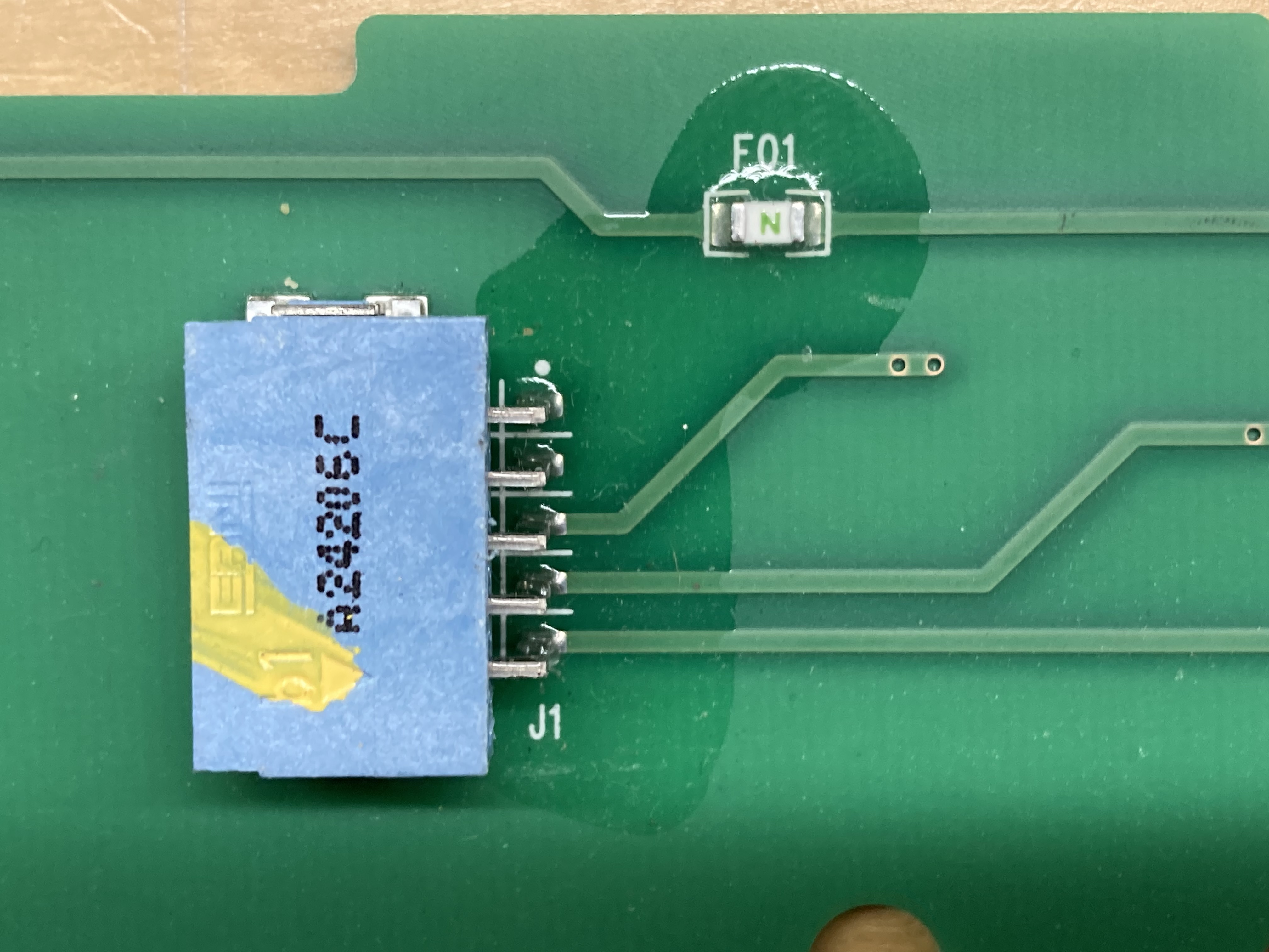

Hi folks.
I came across some kia 64kW modules. They have neat cell wires comming from the module sides. There is a circuit on the sides and i am wondering if those wires are fused? I would like to use this modules with my active BMS and it balances at 1A. Too much?

No i meant if someone can tell if those connections are fused. No matter because i tested that myself and at 0.2A the fuse popped!
Its official, those contacts are limited to 200mA.
As a friend intends to use 1A active BMS we will add our own wires to contacts.

The cell terminals are protected by SMD fuses with the letter "N". In principle, this means 2.0A. I tried it for your pleasure with 2.2A, it didn't melt in 10 seconds. So 2.0A is correct.arber333 wrote: ↑Sat Nov 19, 2022 5:28 pm Hi folks.
