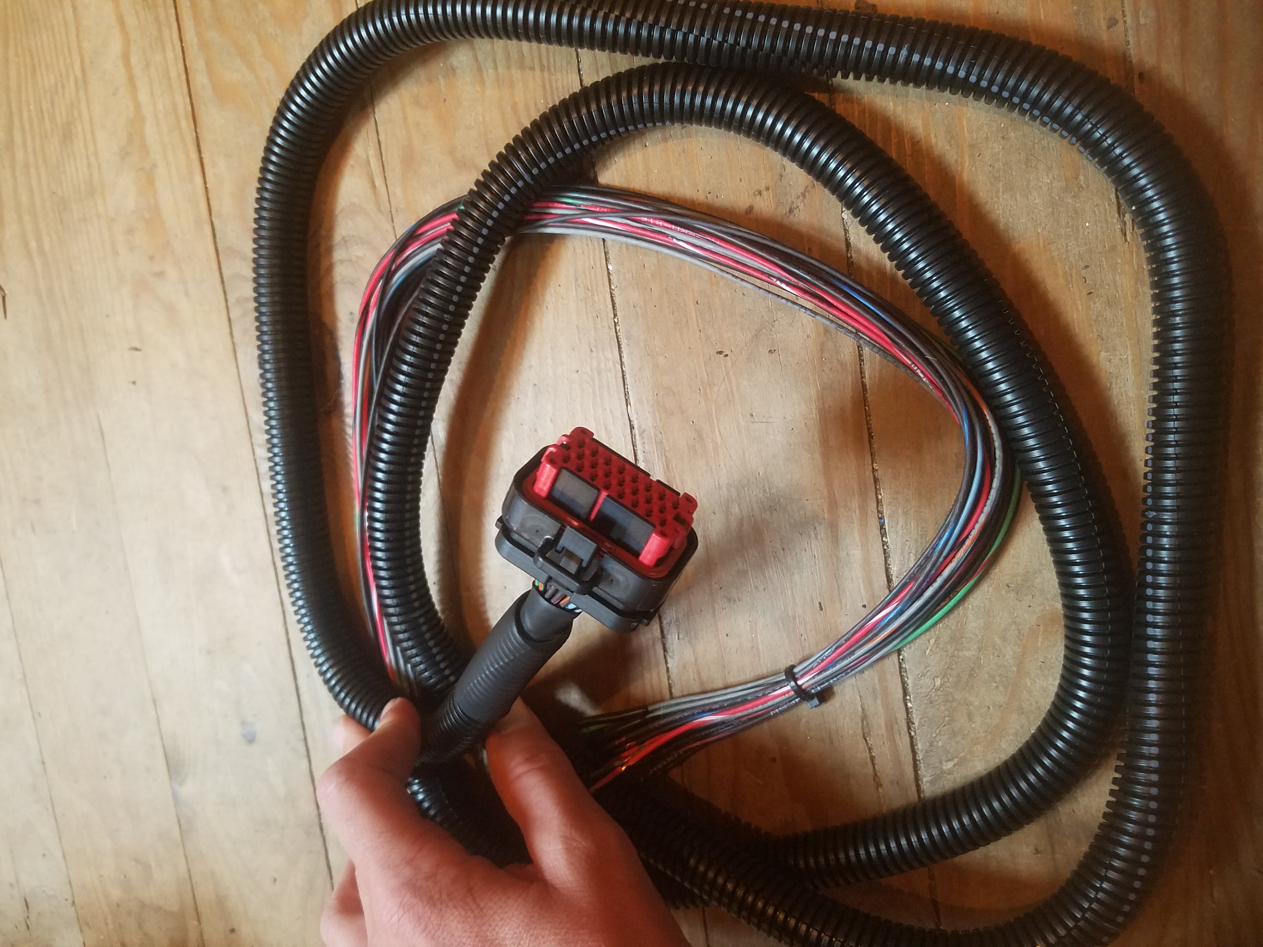

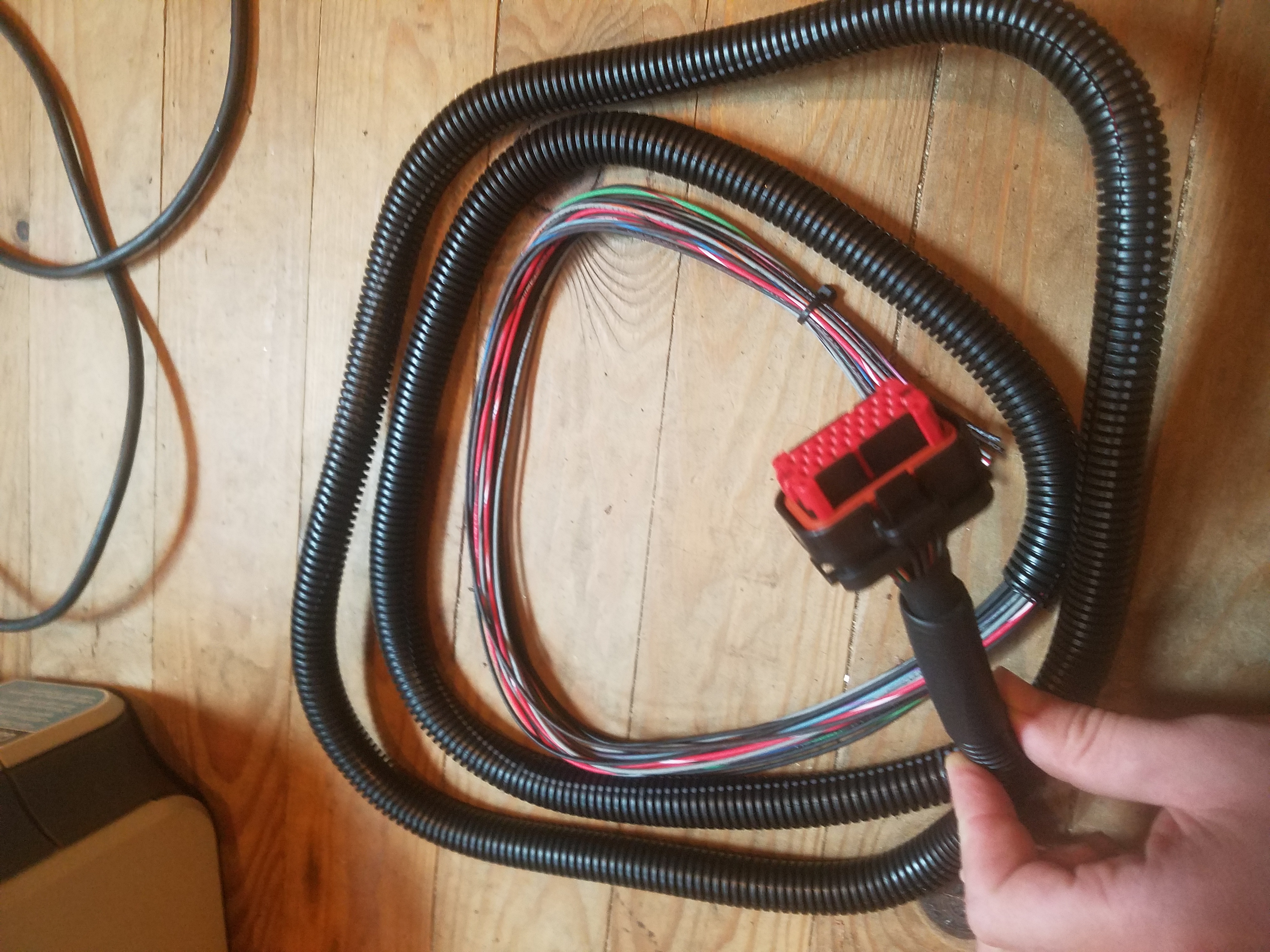

Re: Mercedes-Benz B Electric - motor support
Yes I have the connector and wiring loom. Here is a photo. Now I need the other side and pins.
Ok got the parts that Isaac recommended and it looks like I need to find the opposite side of the connector. The part that this plugs into. All the help on this forum has been really cool, thanks guys!

Is the harness from zero ev the opposite connector that I am looking for? Just curious because I can not tell from the photo.
- Posts: 656
These connectors are "Ampseal" brand name -- usually with the name it isn't too hard to find what you need
https://www.mouser.com/ProductDetail/TE ... WvWw%3D%3D
This is the other side of the red connectors.
It''s got pins built in so you just solder straight to those -- a breakout might be a good idea so you don't bend pins.
What harness do you mean? Is it this one? https://zero-ev.co.uk/product/tesla-lar ... ment-loom/
Get the one that is a 90 degree header, you ware going to need as much space as possible, due to the clocking of the Mercedes casing compared to the Tesla one the connector is positioned even tighter then normal.
You still aint getting it are you, you require the internal connection from the logic board to the 90 degree header. Plus then you need to generate a pinout, from the logic board to the 90 degree header.leman2112 wrote: ↑Sun Aug 23, 2020 1:26 pm Ok think I ordered the right female connector with the 90 degree header just like Isaac and Tom have recommended. The picture on the website looks like it makes the 90 degree bend! I am so stoked! Thank you electric friends!
Once you get the 90degree header and modify the casing for it to fit, check the casing still fits on the inverter without the header smashing into something.
