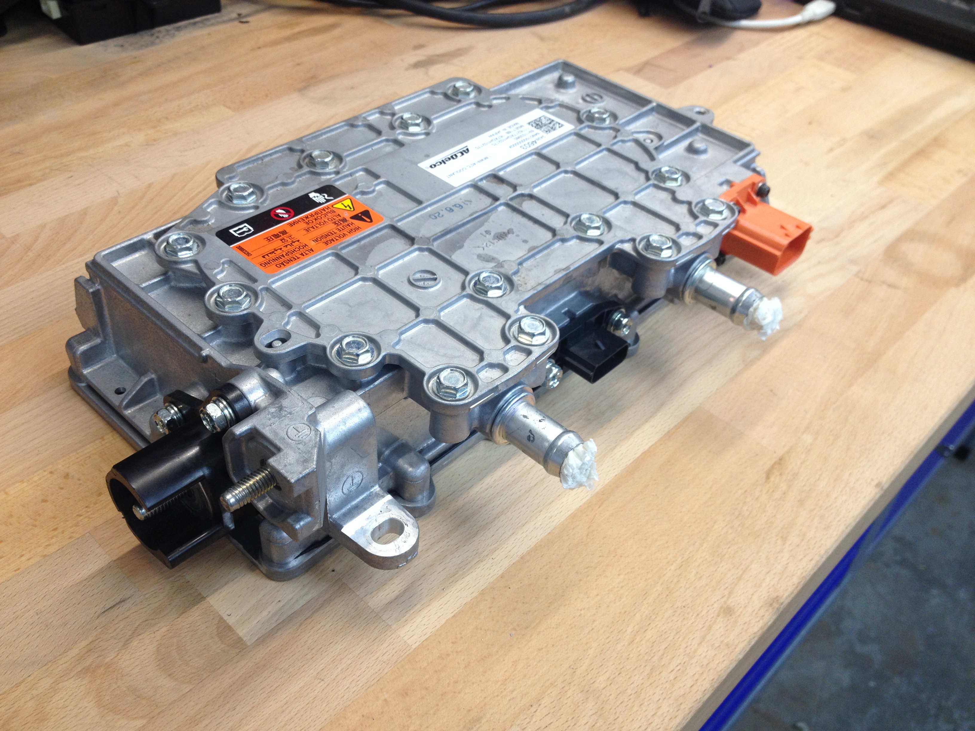

Searching for a compact watercooled DC-DC converter I came across the GM Volt Gen2 DC-DC converter.
Bought one at Ebay and just figured some things out:
HV-connector: DELPHI / APTIV 33107347
Signal connector: JST ATSSPB-C0802Y-1AK
Signal connector pinout:
Pin1 = Voltage setpoint -> PWM 10...90%. >10% starts converter, default 13,80V. 70-90% gives 13,80V...15,00V
Pin2 = NC
Pin3 = Converter status -> 10% = In operation. 70% = HV present, no voltage setpoint
Pin4 = NC
Pin5 = +5V supply, limited at 30mA. Not used by GM
Pin6 = +5V input, internally pulled high. Not used by GM
Pin7 = NC
Pin8 = NC
Found the current limits below:
- HV limit: 343V / 7,0A = 2400W
- Output limit: 12.2V / 168A = 2050W (inaccurate measurement, converter limiting)
So it seems to be specced at around 2400W / 14V 150A

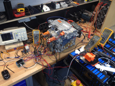

Tested the Volt gen2 charger as well (check the picture of the workbench, below the DC-DC). Nice compact unit, charges at max. 3,6kW (230V 16A). Outputs ACvoltage & HVdc voltages as a 100Hz PWM signal, and limits the AC current according to a PWM signal setpoint. I don’t know if scaling of the setpoint is already known, if not I will post it here.
Drawback of the Volt Gen2 charger is that you will need an additional controller for the EVSE communication, pilot signal cannot be wired directly to the charger.
Some other chargers do have this onboard (e.g. Mitsu Outlander, can also see it on my workbench). Still looking around for an affordable BMW KLE charger to test, this is as compact as the Volt charger, and has pilot communication onboard according to the BMW wiring diagrams.

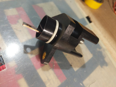

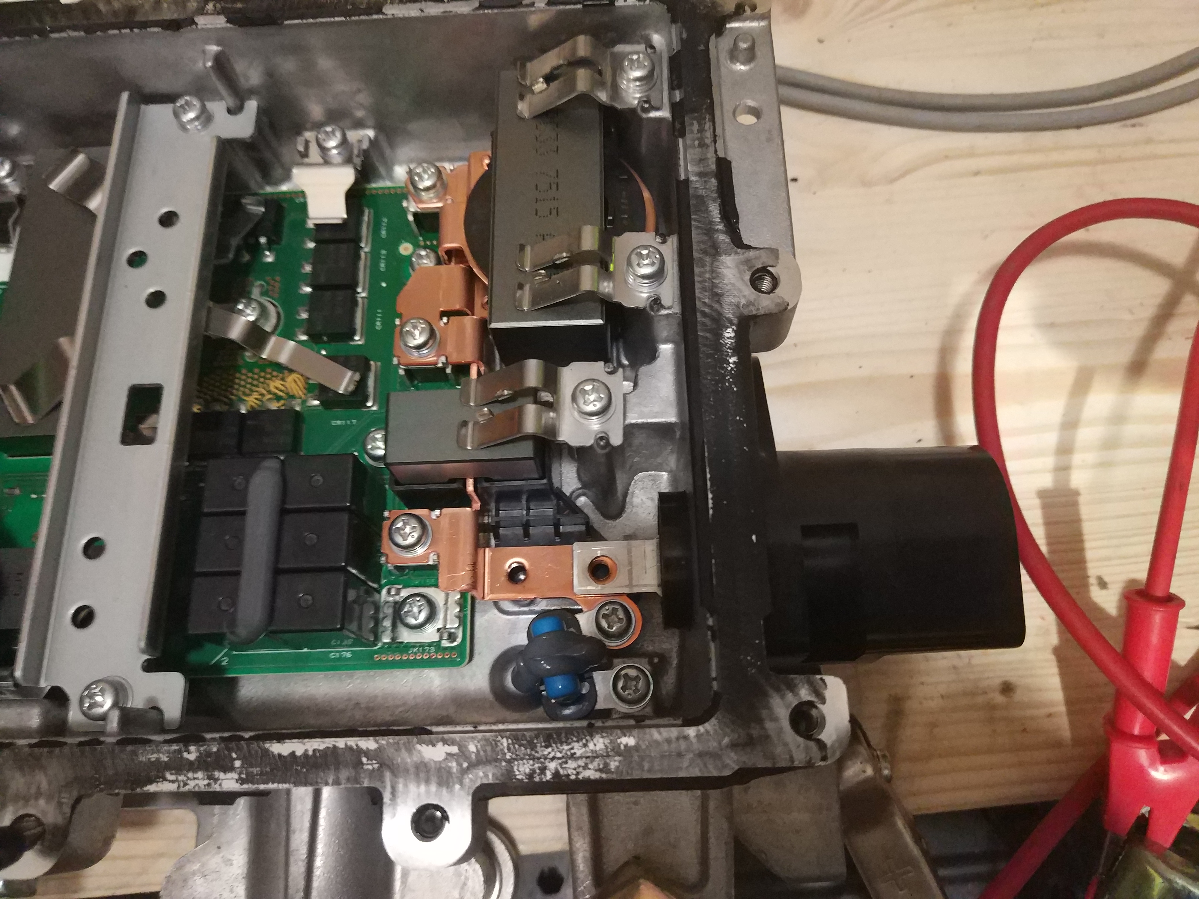

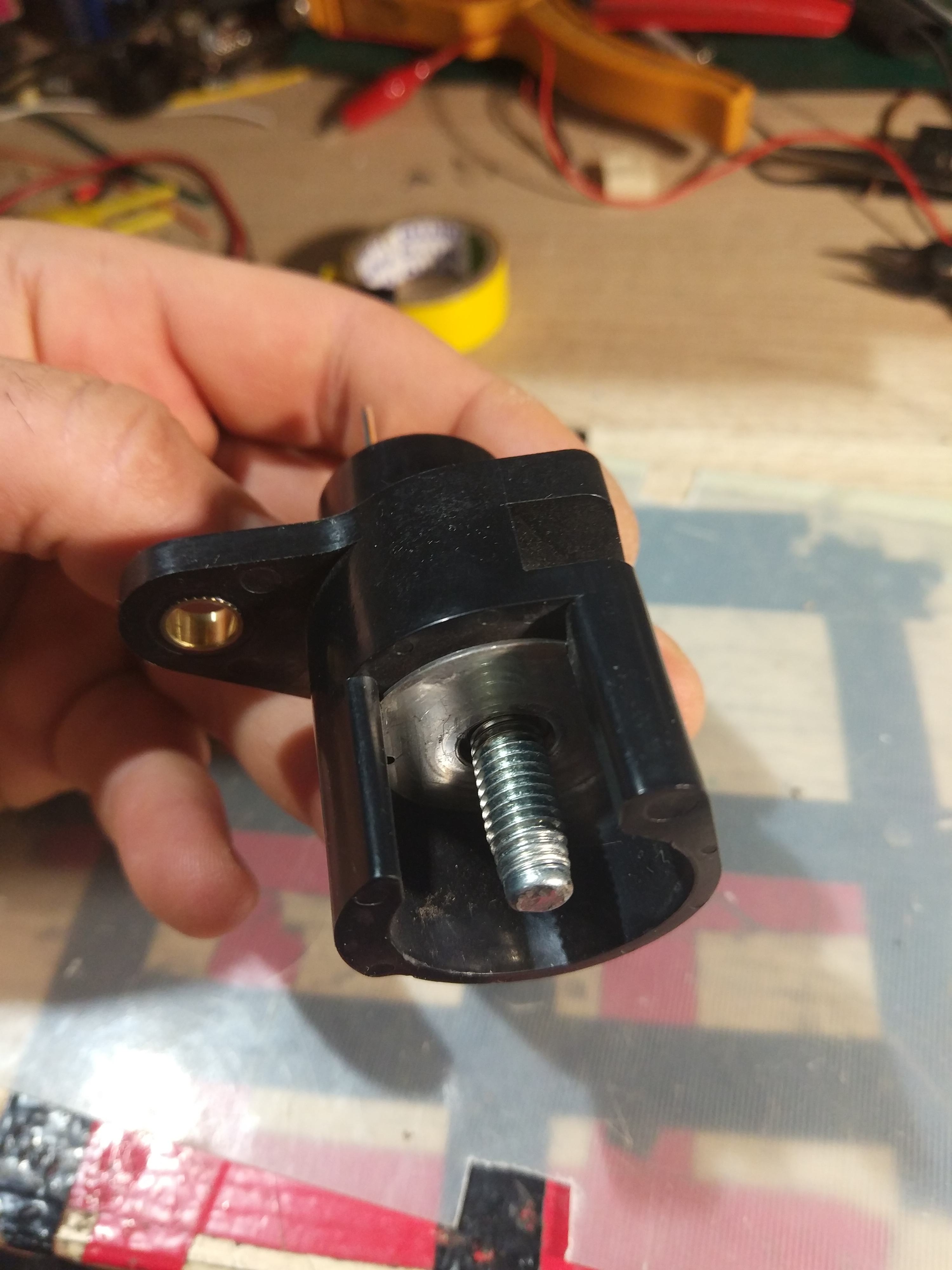

Next i went and took apart DCDC. I found a small control board and connector where PWM signal enters the board. If i trace PWM along i eventually come to a transistor. There signal goes into its base/gate and it seems nothing of value is transmitted out of transistor.
Would it be possible for you to send me a photo of your PWM signal and signal generator setup?
Also do you think you could take the cover plate off and measure what kind of signal comes out of that transistor?
EDIT: Schratch that! I went by the 12V power route and immediately i found out that directly behind the main power stud there was no 13V and it was immediately behind the plastic separator. And i thought it was separator. Probably it is a fused link and in my case it burned out!
Now that i went on and connected 12V battery directly to output link behind the casing and feed 110Hz 120Hz 50% duty PWM DCDC came alive. I got 13.6Vdc. It works from 110Hz 120Hz to 140Hz.
Also i noticed that if i would remove the signal at that point DCDC would keep providing power regardless the signal.
Then i tried to provide various PWM duty at 110Hz 120Hz. Those values are under light load with 12V battery attached.

63% ........13.8V
I will try to provide more load when i solve the problem with the fuse...
EDIT: I just couldnt resist and i quickly connected my 1kW load of 9 H4 light bulbs directly to the output. I could measure 14V at 74A = 1kW!
EDIT2: Well ill be...!! :twisted: That plug has base plate that is connected to internal contact but M8 stud itself is NOT! Since i did not connect this directly to the plate my contact was weak or no contact at all. Of course DCDC sensed there was no 12V battery connected and it wouldnt work.
EDIT3: I can now confirm DCDC can actually work with 5V PWM signal...
I also found out signal works down to 45% duty where DCDC actually stops. It will be interesting to setup my DUE for 70% PWM output on ENABLE signal and 30% PWM when signal is not present to keep DCDC off.
I can now assume everything is good and my DCDC works as it should.
