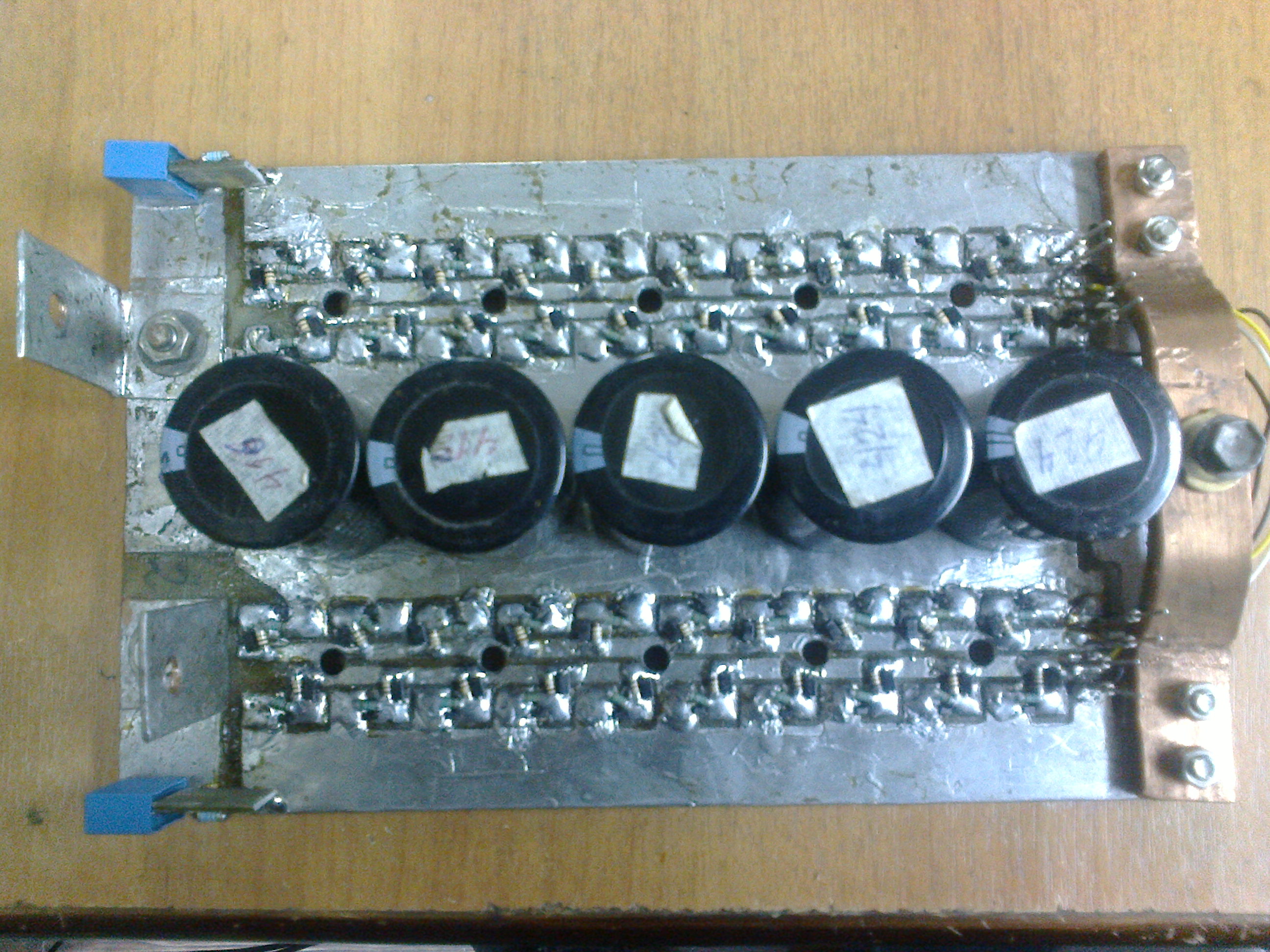

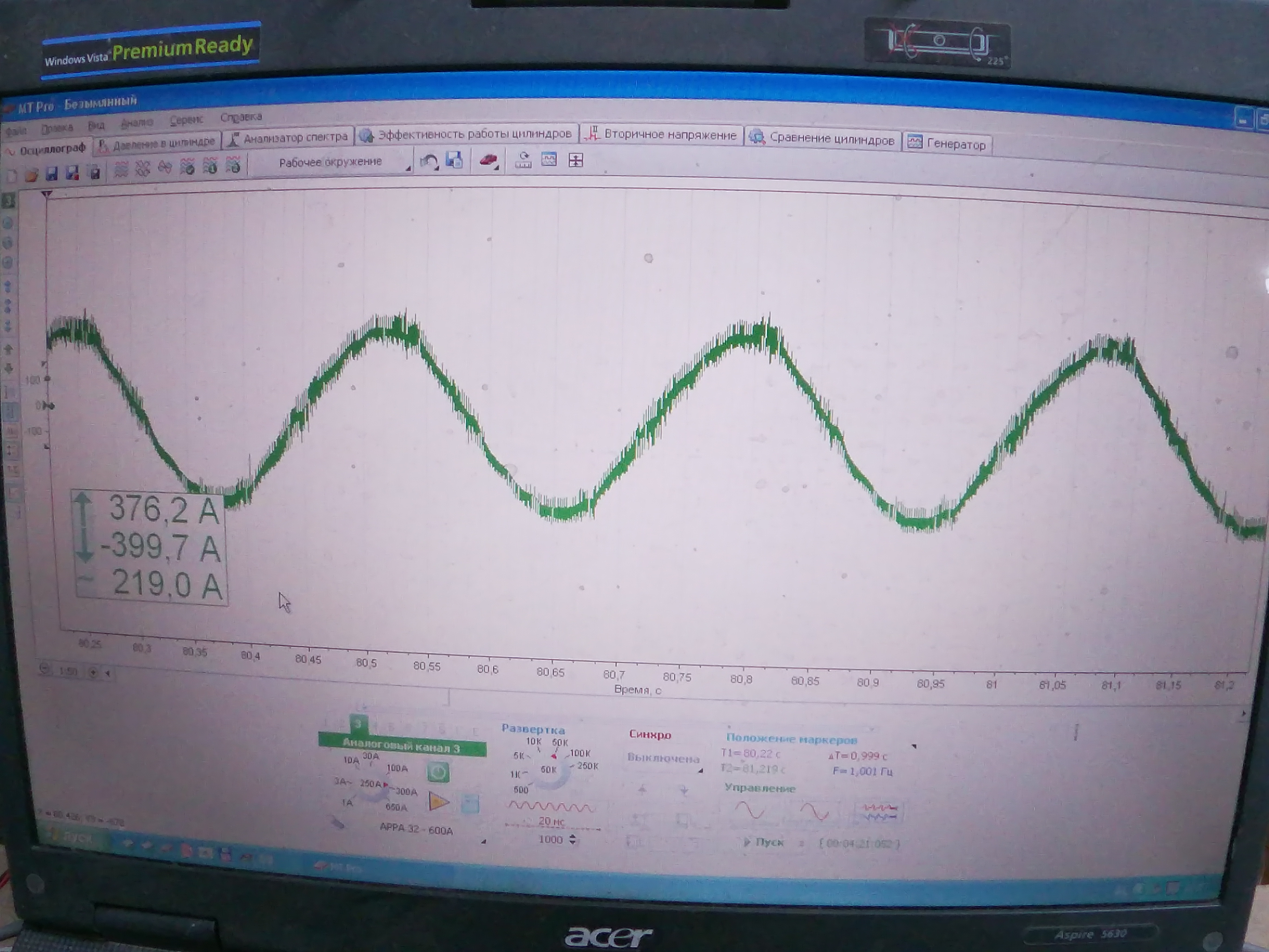

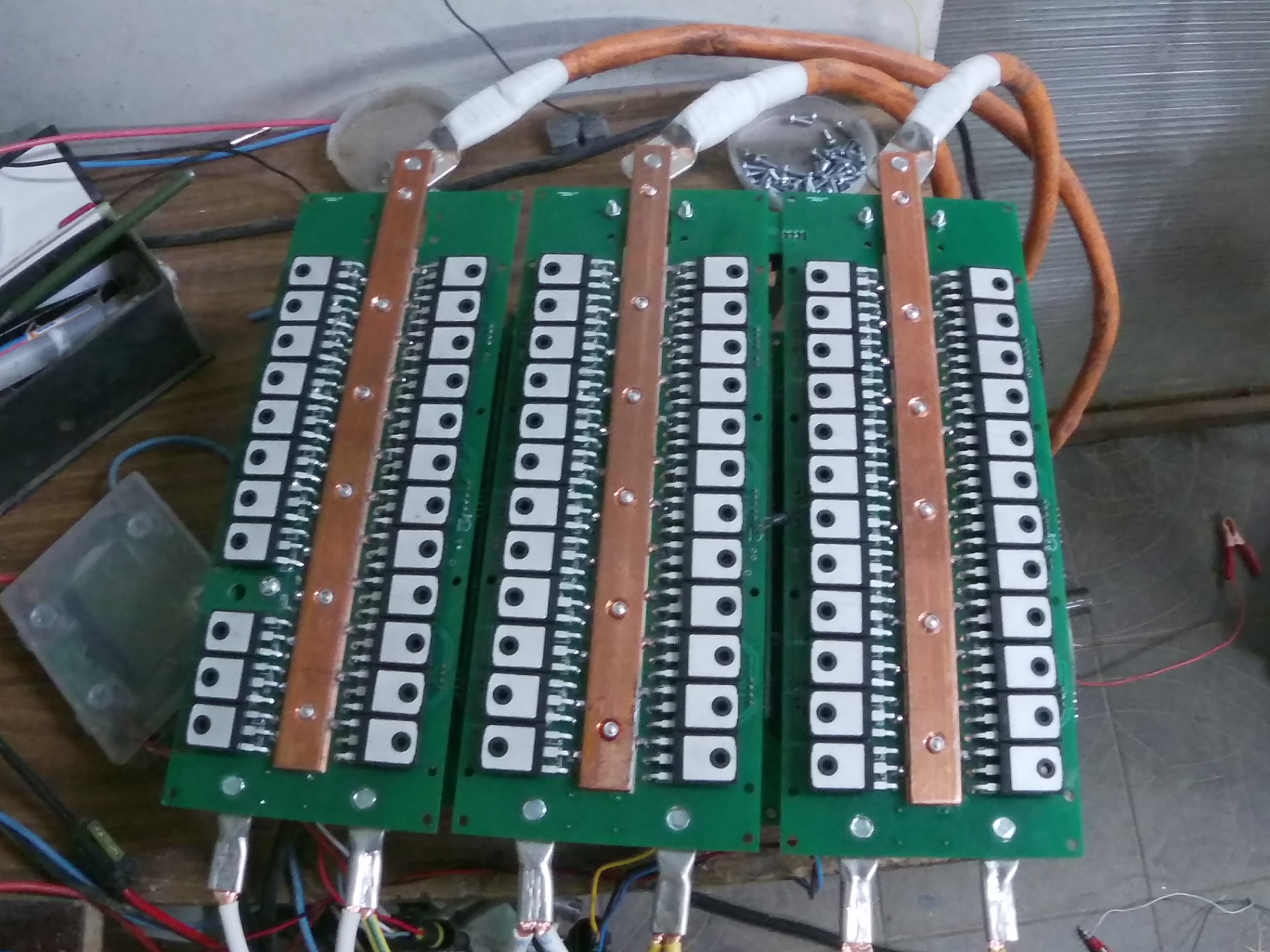

Hi all, I collected an inverter, but have difficulties, asking for help from the forum, can someone tell me, when working on the phases of the motor is very dirty sine, I suppose this is due to improper PCB layout and sub-zero tires, how to connect the drivers to the gates of a large number of field-effect transistors?

Can you post a picture of the waveform you see? Also check out this paper on oscillation between paralleled MOSFETS.

I took the signal with an oscilloscope, maybe even this is normal? But when I gave more current, it led to overheating of the transistors, one transistor in the bridge broke through due to overheating, those that are closer to the power supply are heated more than those transistors that are closer to the output terminals. I also took an oscillogram on the gates transistor, at first glance everything seems to be fine.

Here is the waveform itself, and the view of the inverter itself unscrewed from the radiator
