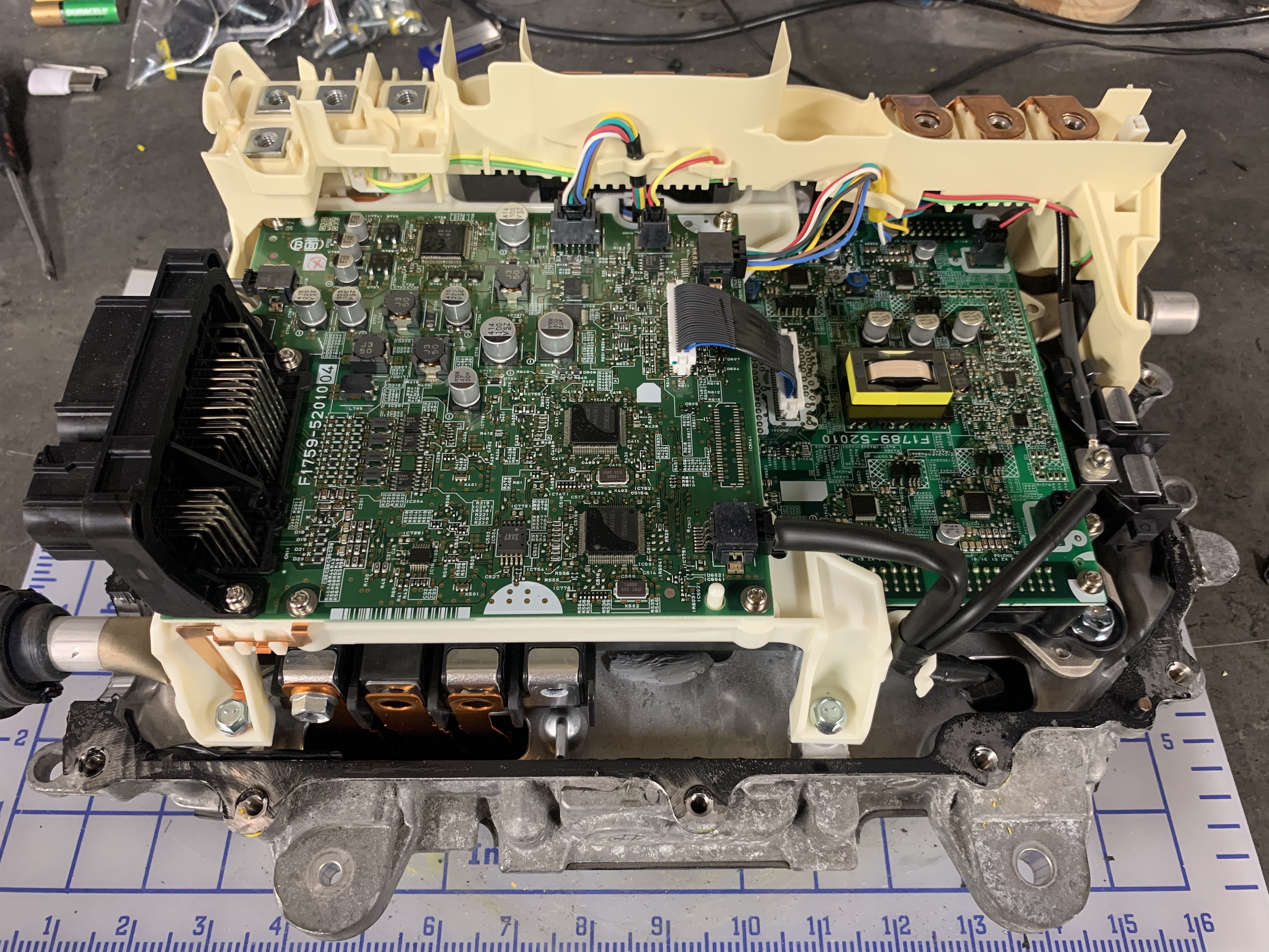

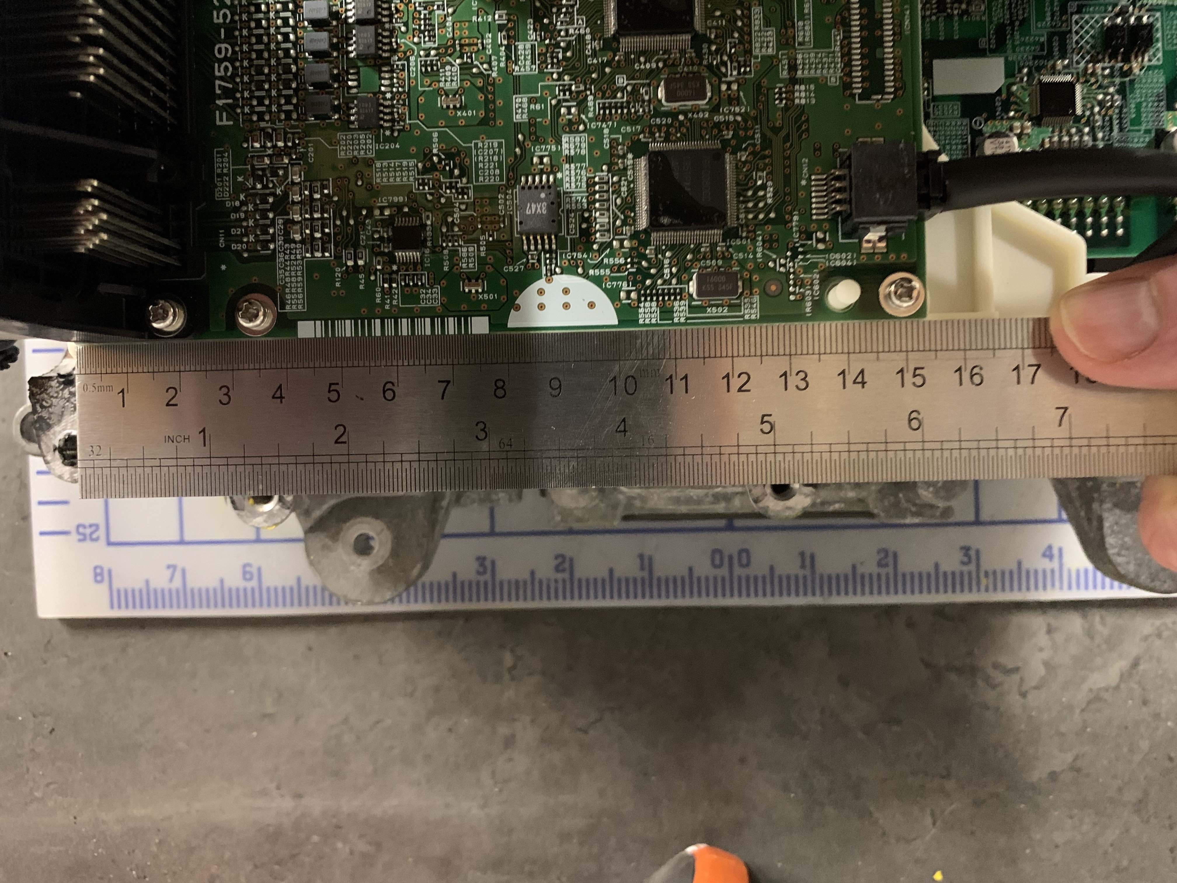

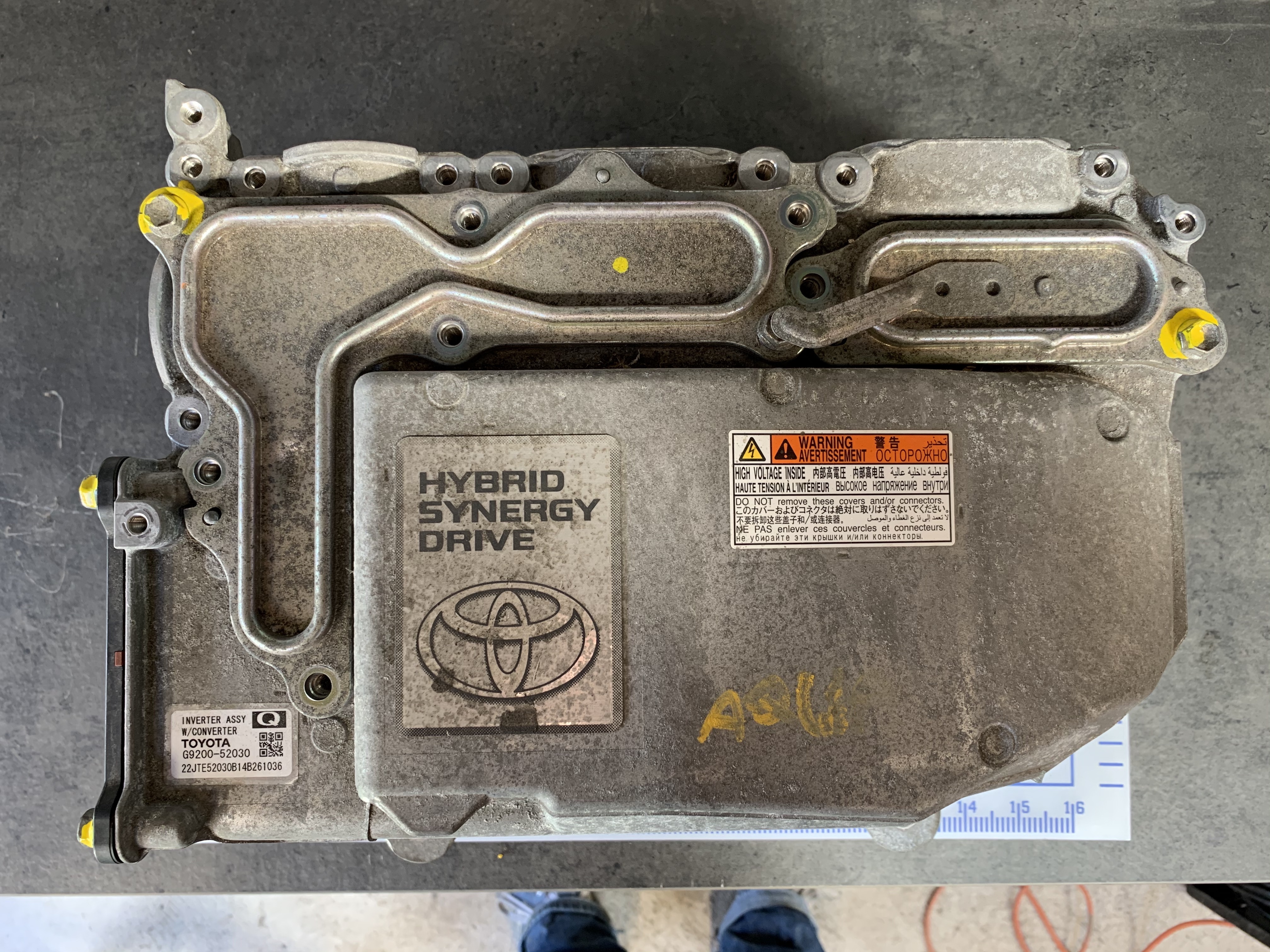

I got my hands on an inverter last week and finally got it open this evening. I wasn't paying very close attention and only realised that it was from a Prius Aqua (or Prius C). But, now, having cracked it open, and consulted the wiki it looks to have the same board numbers as the Yaris.
Top badge : G9200-52030
Side badge : G9201-52011
Small/top board : F1759-52010 04 (154mm long)
Big/bottom board : F1789-52010
Posts: 3665
Has thanked: 11 times
Been thanked: 347 times
Re: 1965 Ford Mustang
Yep thats a yaris/auris variant.

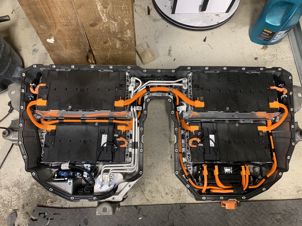

I'm now in possession of one of the BMW saddle-bag packs. ~9kWh capacity.

Also started breaking down the BMW battery pack.
