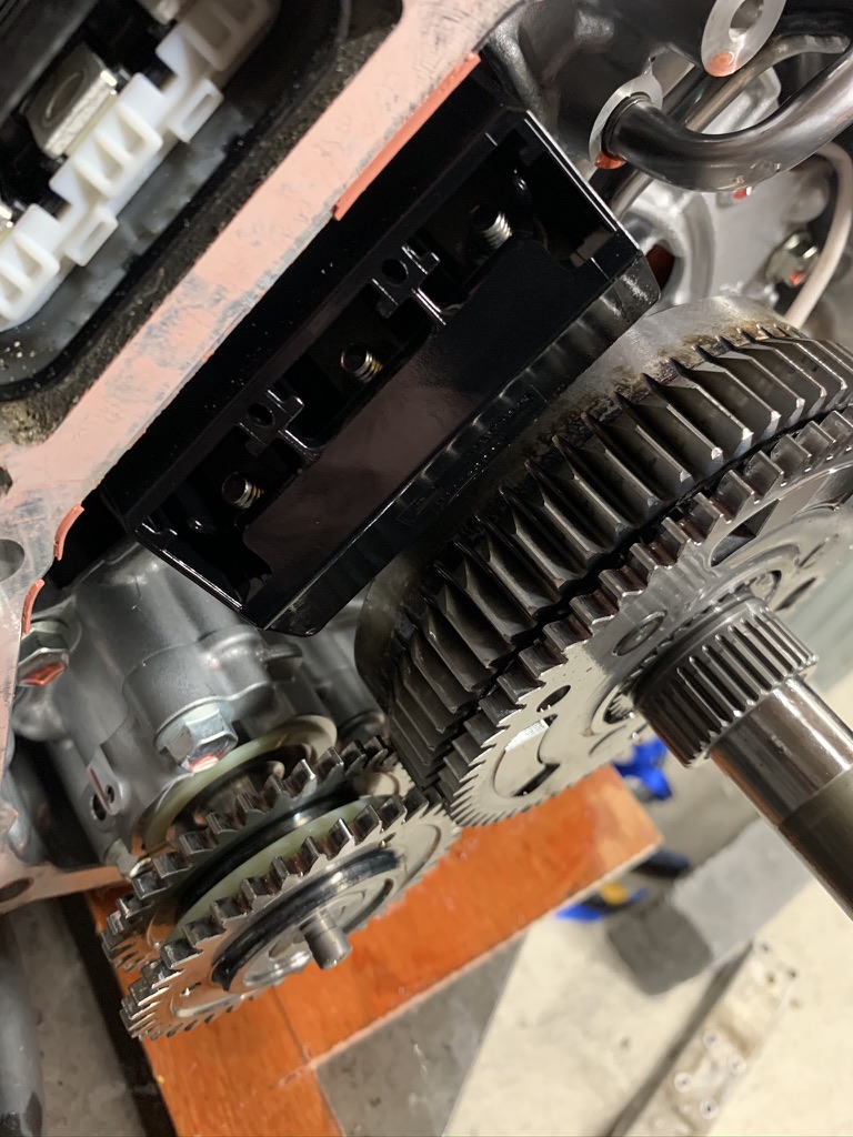

A little earlier I took the MG1 end (bell housing) off of my L210. It was actually very straightforward. The only tricky (messy) part was that you have to take the oil pan off to access three of the bolts.
Everything is the same as the GS450h CVT as far as I can tell from looking at the pics in the OSTI doc, except, that the ring gear has teeth on the outside and there is a second gear attached to the oil pump which is driven by the ring gear.

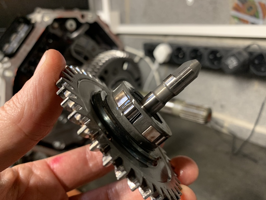

So, it looks like MG1 or the ICE can drive the oil pump. Those little gears on the oil pump have some sort of one-way mechanism. They only catch going forwards (counter-clockwise in that pic).
I took a quick little video to demonstrate as well.
So, I want to check (and re-check) everything, but, it looks like you could use this CVT in the same way as the GS540h one. Lock the input shaft. MG1 and MG2 will both drive the oil pump. Or, if you want to just use MG2, that will work as well.
Anyone see anything wrong with this?

MG1 will spin backwards if you lock the input shaft. When you do this does the one way clutch spin the oil pump? Check the output shaft to make sure you are spinning the correct direction.

slow67 wrote: Thu Oct 01, 2020 12:19 am MG1 will spin backwards if you lock the input shaft. When you do this does the one way clutch spin the oil pump? Check the output shaft to make sure you are spinning the correct direction.
Yep, if I spin MG2 (by turning the output shaft) clockwise (looking at it from the input shaft end) and hold the input shaft still, MG1 spins counter-clockwise. And yes, the oil pump still turns, because the MG2 oil pump gear is still turning in the correct direction. Note the little red mark I put on the MG1 gear.
Here's some detail on the clutches on the oil gears so you can see how they work.
So, I've been puzzling through this a little more today to make sure I'm not being dense. When the ICE turns the input shaft (clockwise), then the MG1 gear also turns clockwise (at a higher speed).
When the ICE is turning MG1 clockwise it's acting as a generator. So I guess clockwise is backwards for MG1.
Then I asked myself, if I want MG1 to contribute to traction, which way do I need to spin it? So, I pulled the ring gear out a bit to make it easier to turn. Then turned the MG1 gear. The test here is backwards as I want the ring gear to turn clockwise, but you get the idea. This confirms that counter-clockwise is forward for MG1 and I want to spin MG1 counter-clockwise to have it contribute to traction.
So, the only remaining concern is the speed that MG1 will end up spinning - as others have noted - when the input shaft is locked. I'll try and get a rough measure of the ratio between MG1 and MG2 when the input shaft is locked tomorrow.
The alternative is to not lock the input shaft and do the Prius transaxle weld job on the planet carrier. Then MG1 and MG2 would be locked together and spin at the same speed. But I think I would do some bench testing before doing that. Plus, you'd have to spin MG1 backwards if you do the weld job.
