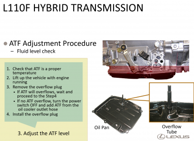

arturk wrote: Tue Jun 16, 2020 6:42 am Very little info online. I am sharing what I found. Any suggestions?
Because it doesn't have a torque converter like a normal auto box, the level is probably less critical to get right.
Usually you drain as much out as you can, making a note of how much came out, then put that much back in of fresh fluid.
Be aware that the fluid volume changes based on temperature. So once filled you should operate the car (back wheels on stands if possible) until the box is up to temperature then check the level again. But make sure the car is off the stands and level again first. Or put it on stands front and back in the first place.

Setting the fluid level is easy. On the sump there are two plugs. One is a drain plug the other is the level plug. Remove the level plug and fill until fluid comes out the level plug. Then run the pump. Rinse and repeat. Your done.

As Damian says above ^^. However I found that if you have external transmission coolers, and these are mounted higher than the fill port, you need to move them to below the level of the fill port while filling. Otherwise the pump sucks the oil pan dry when you start it (the fluid is moved into the coolers under pressure).
For this reason, my transmission is horribly overfilled while at rest, when the pump powers up, it returns to a normal level.

xp677 wrote: Tue Jun 16, 2020 8:51 pm As Damian says above ^^. However I found that if you have external transmission coolers, and these are mounted higher than the fill port, you need to move them to below the level of the fill port while filling. Otherwise the pump sucks the oil pan dry when you start it (the fluid is moved into the coolers under pressure).
Or you could fill it while the oil pump is running. The OEM lines appear to drop down below the fill level, so it shouldn't terribly overfill it. Most OEM automatics are designed to be checked "running".
arturk
Posts: 148
Location: United States, MD
Has thanked: 5 times
Re: GS450H Discussion
Post by arturk »
Thanks for all suggestions on checking ATF level. Turns out I was 3 quarts low. I guess scrap yard drained most of the ATF before shipping it.
I also came across those nice pictures. I noticed a lot of people are asking about some of those details. Those are GS600H but same procedure applies to GS450H.
Best to use Toyota Genuine ATF WS.
Specified amount of fluid is 5.0 liters (5.3 US qts, 4.4 Imp. qts).
xp677
Posts: 439
Location: UK
Been thanked: 15 times
Post by xp677 »
slow67 wrote: Wed Jun 17, 2020 12:55 am Or you could fill it while the oil pump is running. The OEM lines appear to drop down below the fill level, so it shouldn't terribly overfill it. Most OEM automatics are designed to be checked "running".
You can't fill it through the fill port while running, as the fill port is also one of the transmission cooler lines.
You could probably fill it through the check port if you had the correct hose (long, thin, and hook shaped).
