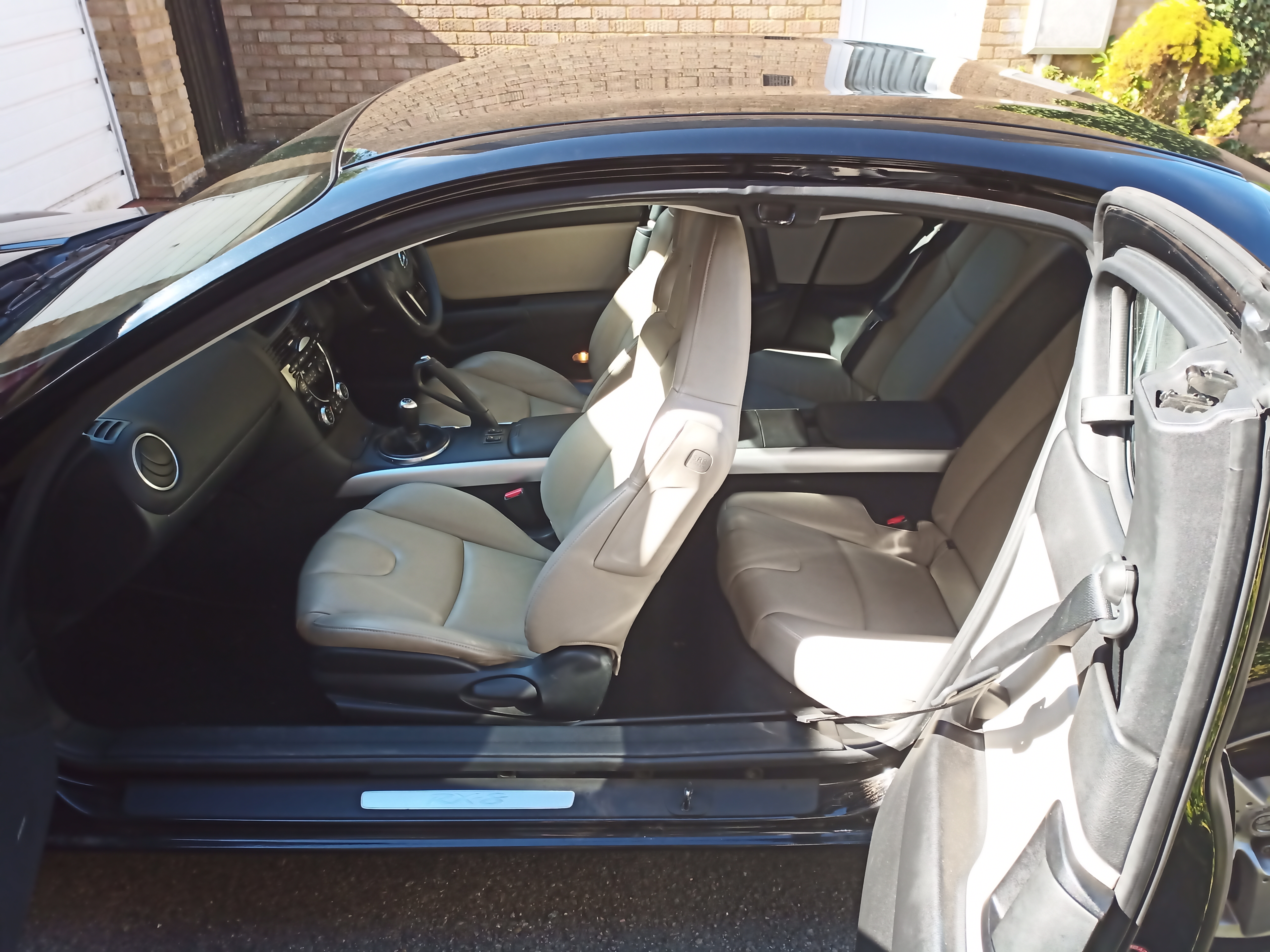

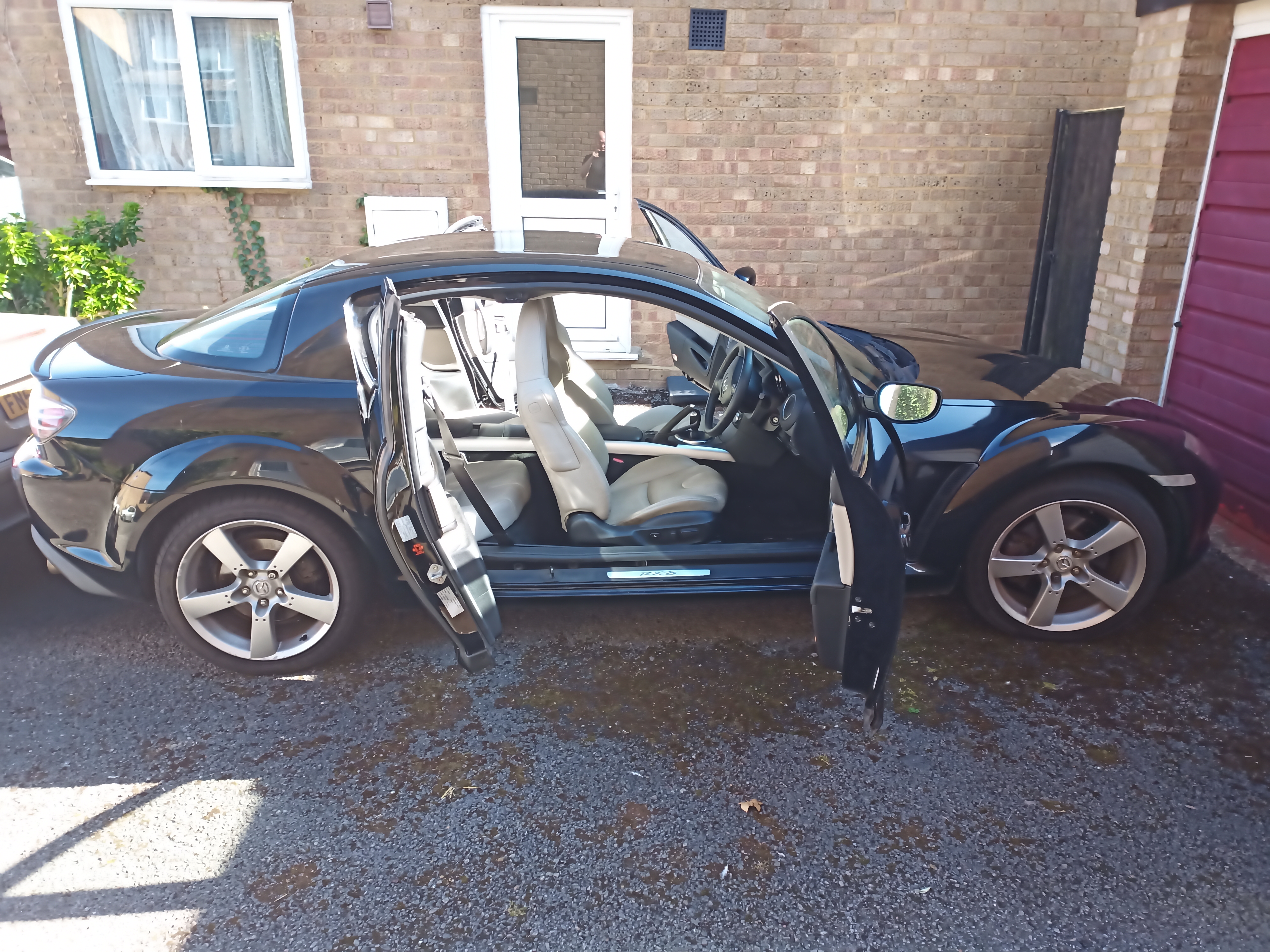

Yes they are really nice cars, 4 usable seats, great handling. Severely let down by the durability of the engine, hence cheap and pretty readily available. Just need to watch out for rust, the one I've got appears to be solid with no sign of rust where they usually go.

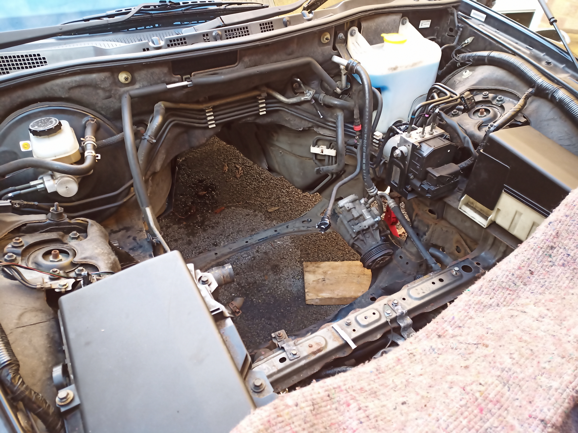

Thought I'd just give a quick update.
I've been slowly but surely stripping out all the oily bits, I was hoping it was going to be a bit quicker than this, but whoever worked on various bits of the car before doesn't seem to have believed in torque wrenches and everything appears to have been done up to the 'as tight as humanly possible' setting. I snapped a T-Bar undoing one of the wheel nuts! On the plus side I've only sheared one (small, unimportant) bolt. Engine and box should be finally coming out this weekend

Well I finally have a big hole to fill. Rotary is seriously heavy for it's size.
Still need to remove the fuel tank and diff, but I can move it into my garage now.- jnsaff

Fuel tank is finally out and it's not looking good for my plan to mount the leaf motor in it's place. I don't think I'm going to have the space
. I'm also going to see if the motor will fit where the gearbox was although on first inspection that's not looking too good either. I'll take some more measurements tomorrow and refine my (cardboard) model of the motor.

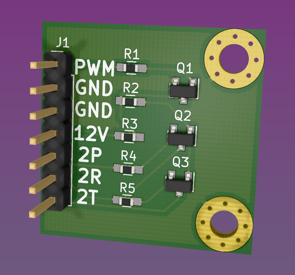

On a more positive note I can drive the fuel gauge from PWM now (thanks to someone on another forum giving me the idea). Boards arrived today from JLCPCB and I built one to test, looks like the original sensor resistors were logarithmic so I need to do some maths, but after increasing the arduino's PWM frequency I can set the fuel level with a pot
The board is very simple, transistor, 2 mosfets and some resistors. If I'd thought to add the capability to use a low pass filter I probably wouldn't have needed to change the PWM frequency, but no real loss. Once I'm satisfied it's working properly I'll put the hardware design and a simple arduino driver for it up on github. I've also printed a forward/neutral/reverse gear selector based on a sim racing design from thingiverse so I can keep the original gear knob for that original look. I had to change the design a little as the knob is so heavy and I don't want it slipping out under acceleration. It's pretty firm to select now, so hopefully it'll be OK, if not I know how to modify it further.
