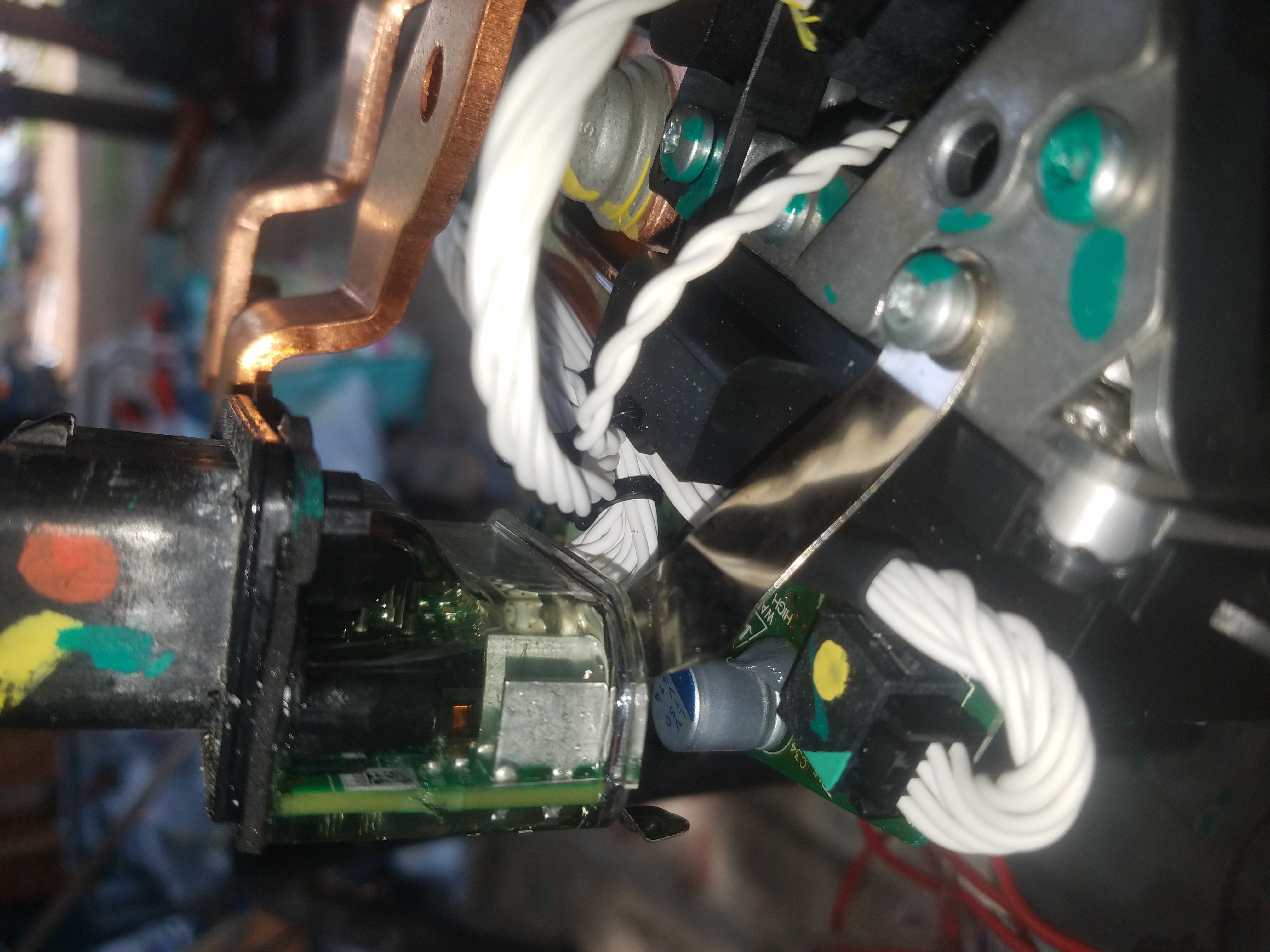

Re: Mercedes-Benz B Electric - motor support
Ok opened up the case again to get a better Idea of what I am dealing with.
leman2112
- Posts: 173
- Joined: Sat Dec 21, 2019 10:30 am
- Location: United States
- Has thanked: 29 times
The wiring loom all passes through some type of mercedes connector board. Should I just cut the wires off one by one, extend them to be twice as long and then solder them to the pins of my new ampseal connector that fits my harness?
You are missing wires on the control board side. As I mentioned before in this thread. You need to source the crimps to add more wires into the board connector.
Now I am starting to understand. This connector needs more wires and female pins added so that I can have all the wires I need. Anyone have an idea what size I am looking for? I know the wire gauge is 20. Maybe someone knows who makes this connector or where there is a part number on the connector?
You cannot swap the "Tesla" version of connector in there, it will hit the internals as I said before.
Connector for the logic boards is: JST 24CPT-B-2A
Pins are: scpt-a021gf-0.5
As I said before, this board DOES NOT fit in the Mercedes Tesla drive units, the casing is clocked wrong. The board will hit the internal construction of the phases.leman2112 wrote: ↑Thu Oct 15, 2020 8:27 am Ok new plan. Buy this loom so I don't have to worry about the pinout. Extend this loom one cable at a time so that it is twice as long.
This is awesome! So I do not need a special board like the tesla and mercedes inverter both have? I can just add the few cables I am missing to the jst connector and make sure they are all the same length as the mercedes harness and solder them all straight to my female ampseal female connector? No special connector board needed? I really kinda thought that the connector board might of had some type of purpose but obviously I am definitely a super noob right now. I got a feeling it's gonna work soon enough! Thanks again friends!
