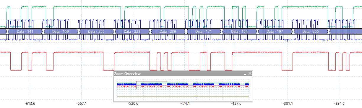

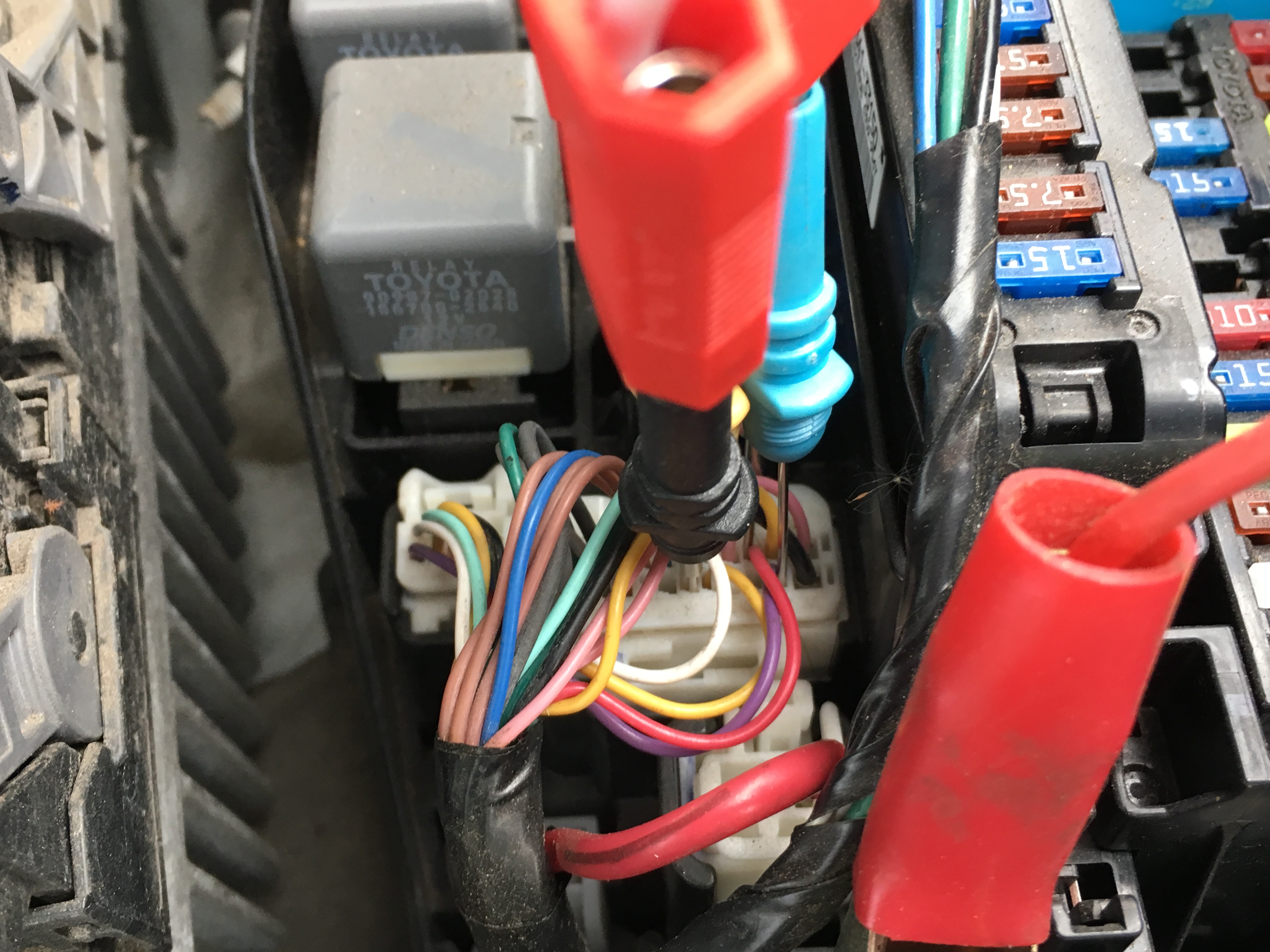

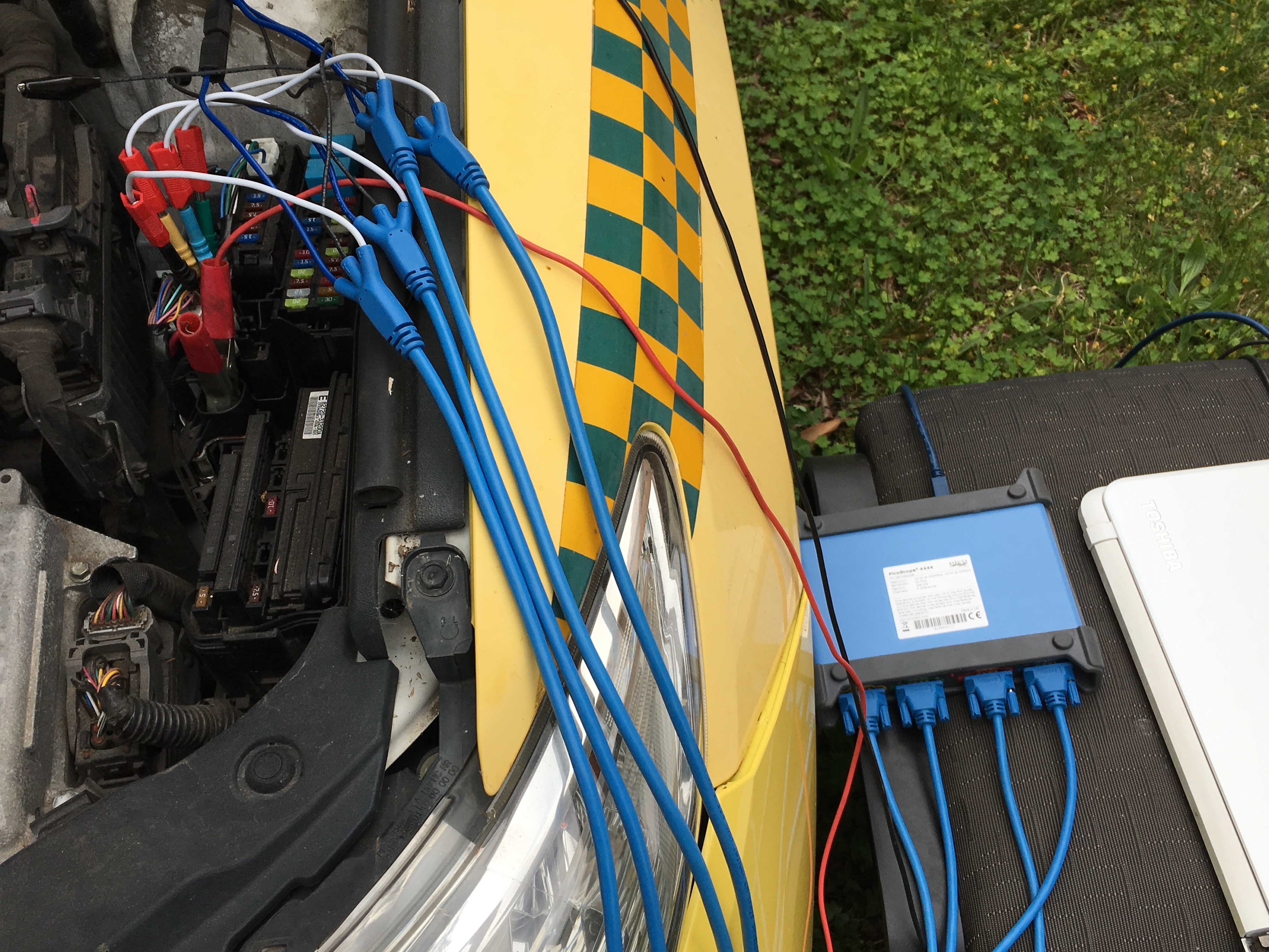

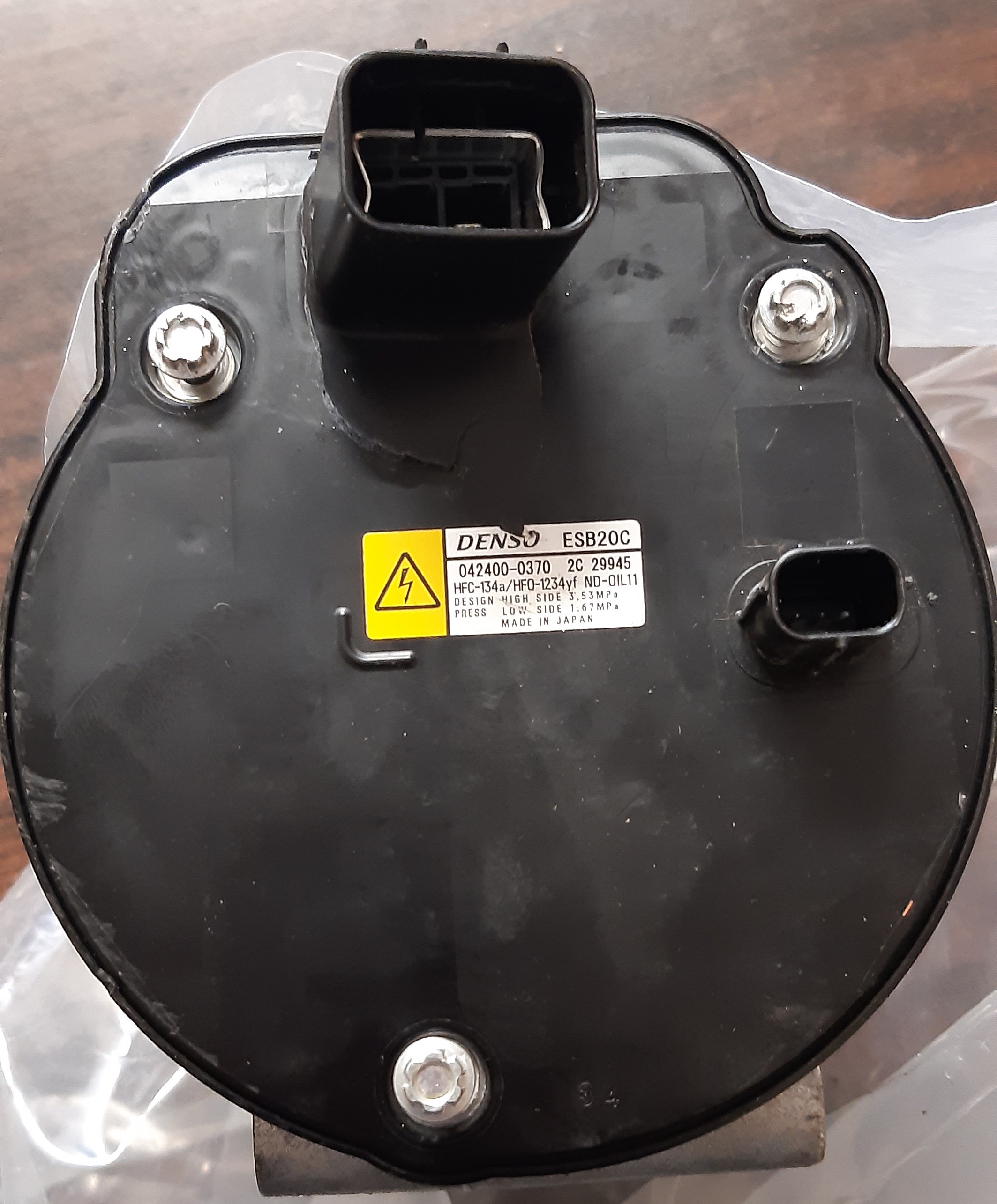

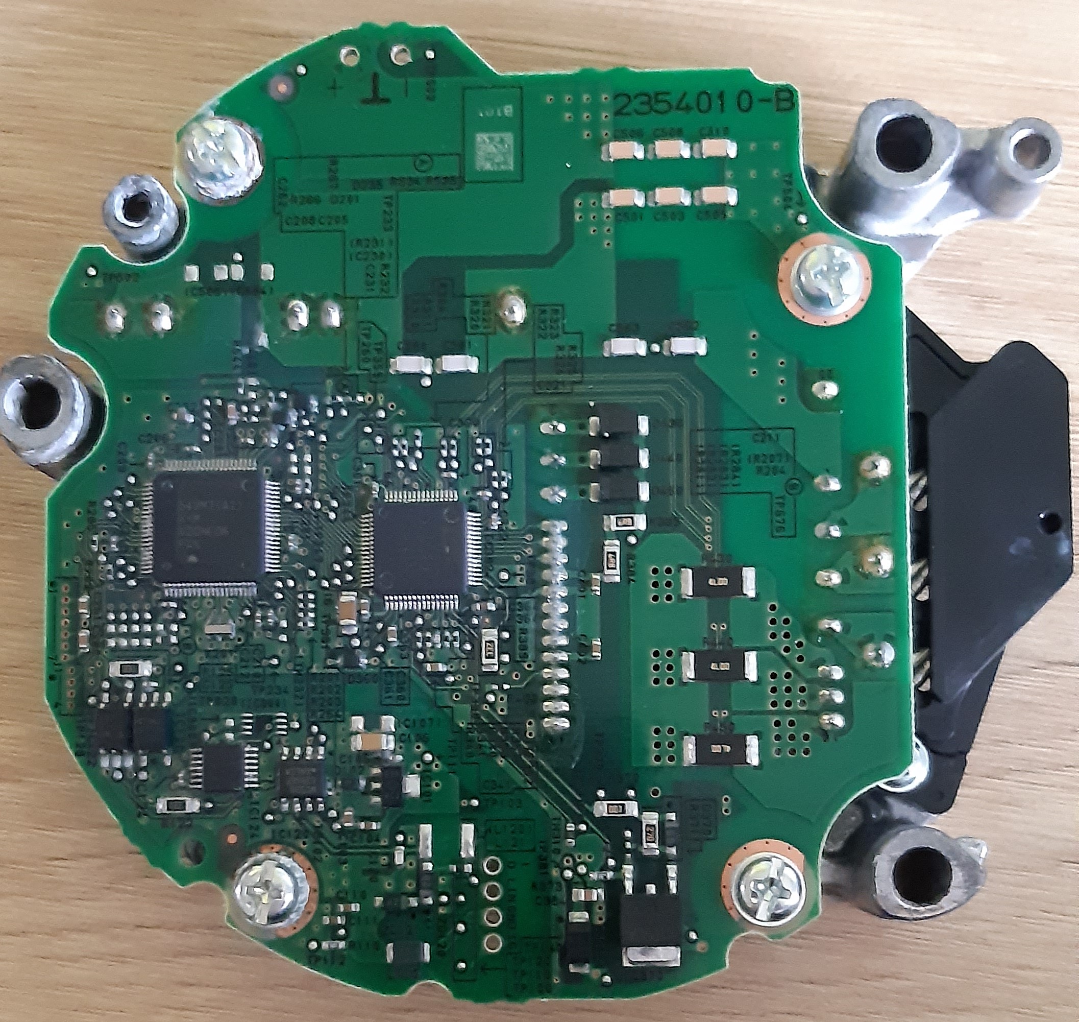

Well you won't believe it, but i finally got to get picosignals out of this thing for a AVV50R Toyota Camry Hybrid taxi.
I have tried to add the picoscope files but so far have not been able.
This scope can use multiple serial decoding patterns as well, so i can try that later on if you like. Today, whilst i was doing this, the laptop decided to shut down. So these are the only traces i got today. So will try again another day.
kind regards,
sorry it has taken so long to get data, but lots of other stuff has been going on.
Oscillographs of AC for AVV50R yellow taxi.docx
Sample of wave-forms gathered at different sampling rates.
(870.29 KiB) Downloaded 933 times

These oscillograms are what I got out of a Denso AC compressor for an AVV50 today. Its backward of what has already been posted, but it is what I understand. PS: I have not got a signal on the CLK post so far. These signals were obtained with a Picoscope 4444. You can analyse the Picoscope signals directly using Picosoftware that is free.
https://www.picotech.com/downloads Look for PicoScope 6.1.4.68.
I will post more later today.

Re: Denso ES27C AC Compressor control (Toyota/Lexus)
Post by johnspark »

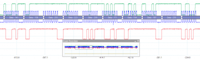

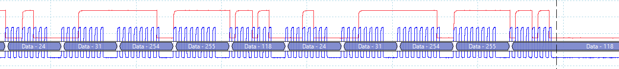

So, found out I was getting all the signals...
So, Clk is the 10 sets of 8 pulses (in blue)
STB has a high going long pulse when energizing the DOUT of the compressor, and a high going short pulse when de-energising the DOUT of the compressor (in mustard yellow).
Also, a DIN of the compressor message occurs over 2 sets of 10 sets of 8 pulses.
AVV50R Air conditioner motor DINDOUT signal Message Pattern.pdf
(67.09 KiB) Downloaded 843 times

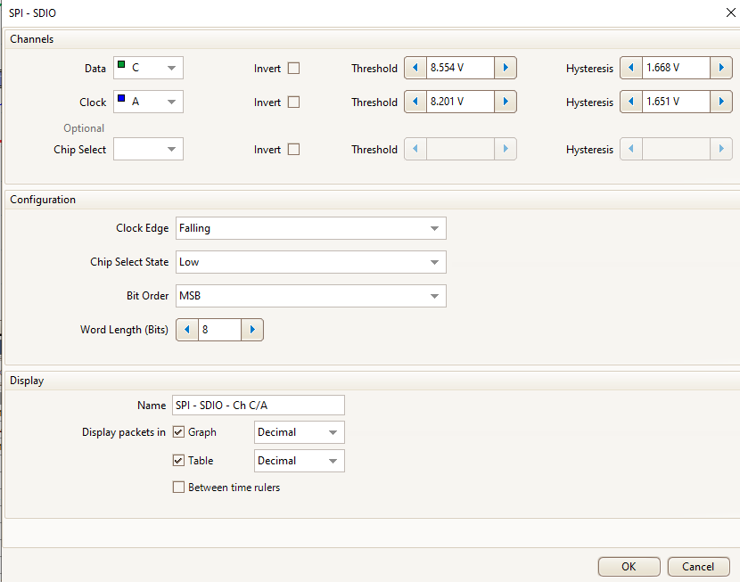

I have just been able to ready via the PicoScope 4444 the DIN data line using: No inverting DATA, No inverting Clock, Clock Edge falling, (Chip State Low), Bit Order MSB, word length 8 bits, serial reading via SPI - SDIO. Am displaying graphic with decimal, and also tabulating with decimal.
I now get these numbers in a csv file:
Will look at the DOUT data later with the spi serial feature, to see if that is the same...

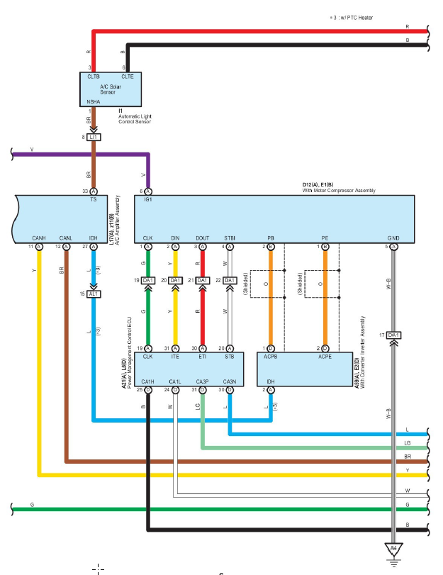

I've attached a schematic of the circuit I used. Note the pain numbers have changed - I've freed up the SPI pins so I can add a CAN controller in the future. I'll get this board fabricated when I next place an order.
I'm currently facing two issues:
1. The AC compressor pinout. I believe it is:
1 - CLK
2 - ETI (data from HV ECU to compressor)
3 - ITE (feedback from compressor to HV ECU)
4 - STBI
5 - GND
6 - 12V
However, the service manual contradicts itself over which pin is ITE and which is ETI. From metering the two, pin 2 has the same specs as CLK, while pin 3 is pulled up when pin 6 is connected to 12v via a 1M resistor. I am going with the assumption that my list above is correct.
To activate this unit, the STBI line needs to be connected to ground. Doing so causes the unit to pull 14mA from the 12v line. This isn't enough to power the unit, I believe that the unit is disabled until it sees voltage on the HV DC connector. I opened the unit, there is a sensing circuit connected to these lines. Likely the inverter is shutdown until it receives adequate HV voltage. I tried 12v. Nothing happened.
So, I'm about 10 hours in and have made plenty of progress already. I'll likely put this project on hold until I have access to a 288V DC source to try this again. I've posted this now in case anyone else wants to use my work so far to attempt to control a compressor of their own. These are widely available AC compressors, and if they can be controlled, it would provide a cheap source of AC for electric car conversions.

I have also added a DC ammeter measurement, but so far not seen any correlation to any of the bytes...

I have measured the current to be between 0.804 and 3.864 amps DC for the AVV50 Denso compressor.

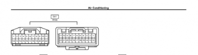

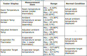

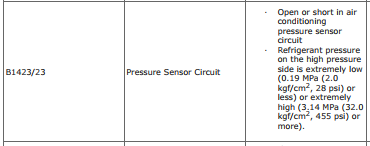

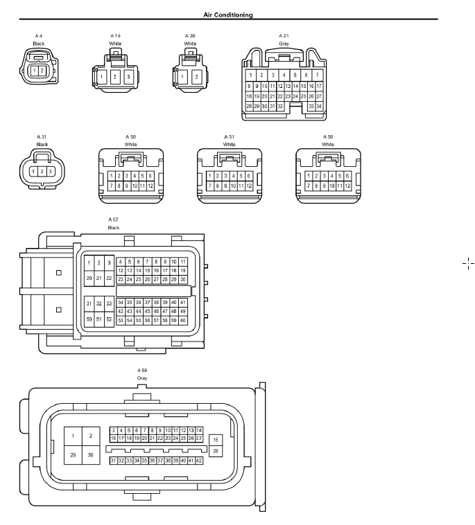

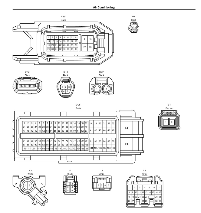

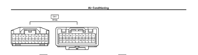

Here is some diagnostic info from Toyota:
johnspark
Posts: 264
Has thanked: 59 times
Been thanked: 48 times

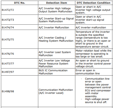

Post by johnspark »
More:
johnspark
Posts: 264

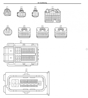

Post by johnspark »
last one:

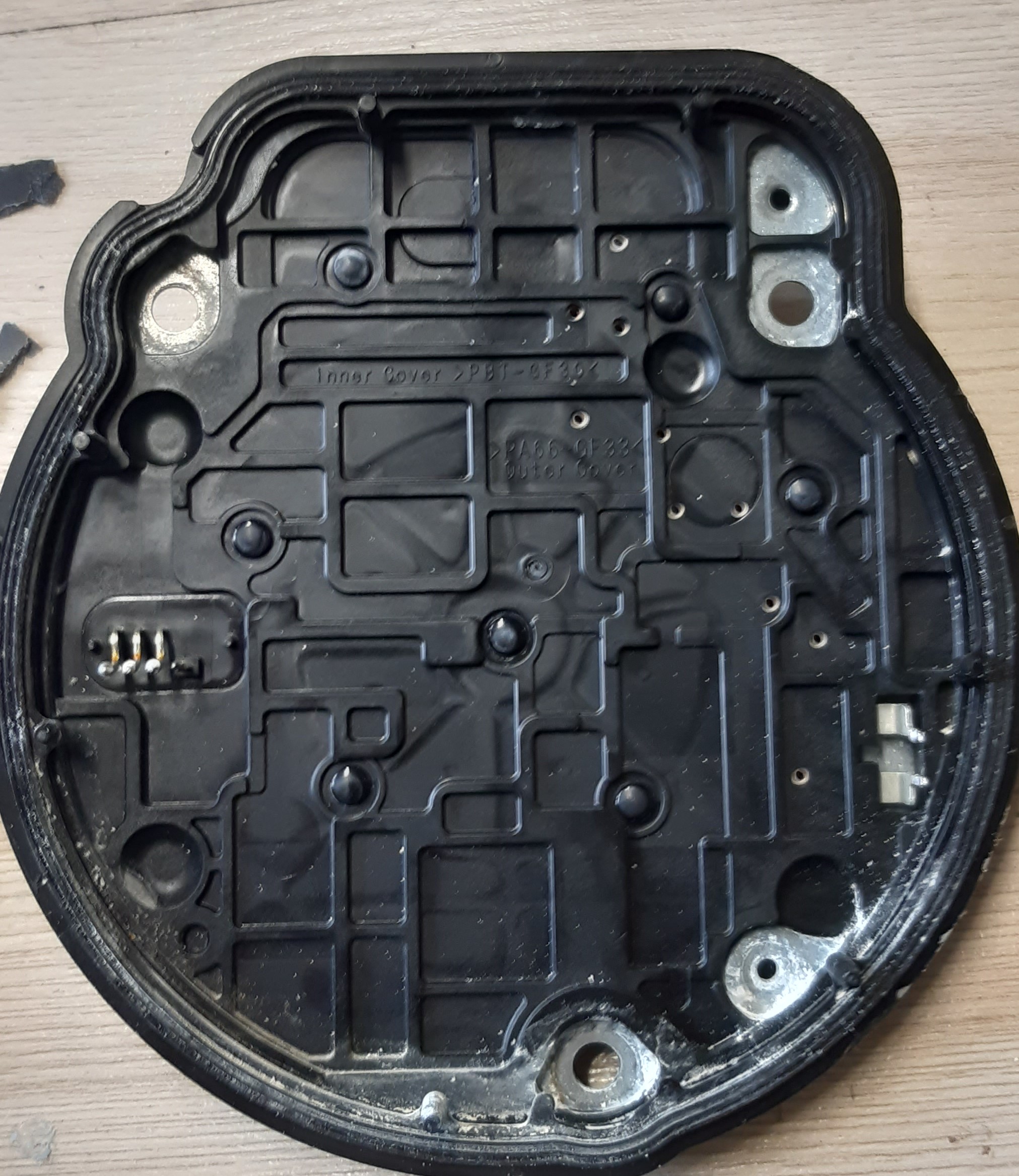

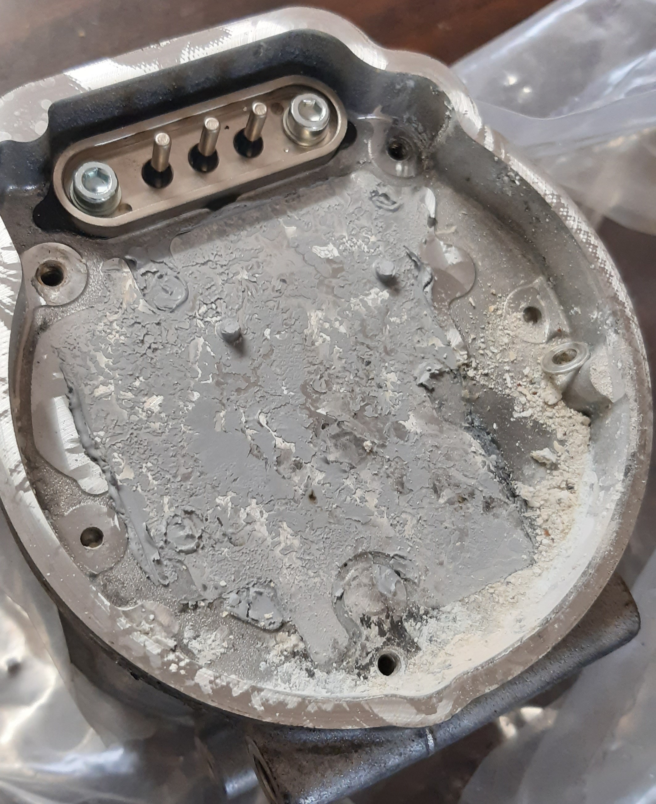

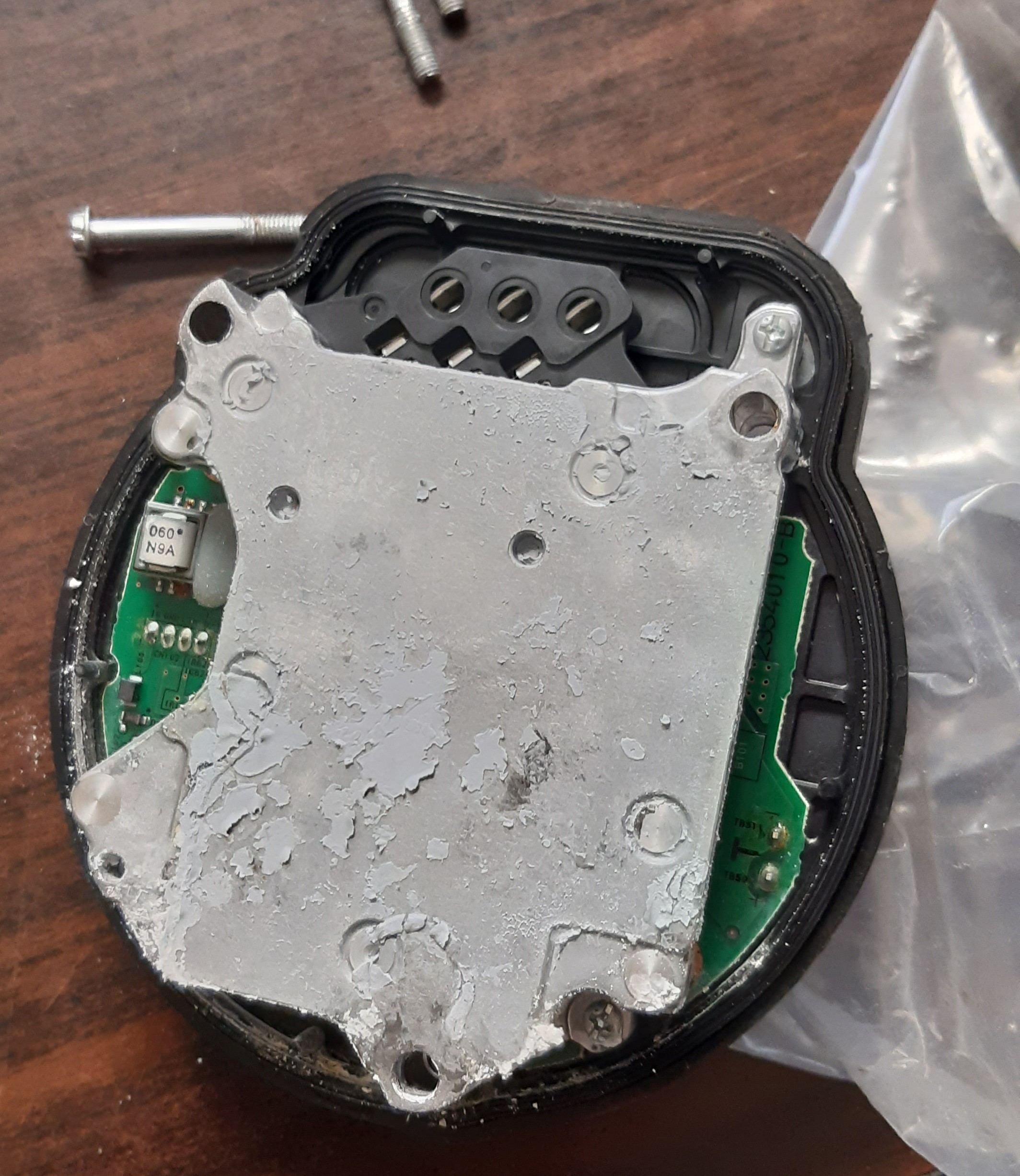

Hello, All
As I have read this thread, and some others, and found that used in ES series compressors proprietary interface / protocol is not very usable ...
I did some research and :
DENSO ESB20C ( cheap successor of es series compressor ) .... I believe this all is valid for ESB27C as well. ( bigger one also easily available )
As i didn't find any internal pictures to confirm my suspicions .. I bought one .. not sure if working one ( this got some punch in crush probably, but besides power connector it looks good. - This is what I can handle. )
These new compressors have now "standarized" LIN interface ( I believe they meet the standards ) - check the pictures - they even clearly stated LIN interface.
My goal is to run one and test it in controlled environment.
These compressors has 3 pin control terminal where is GND in the middle, LIN on the left, and ignition 12VCC on the right side.
Inside HV and LV sides are isolated = on the LV side there is LIN transceiver that outputs serial interface via two optocouplers to main processor and drive processor. Drive part is some IPM ( Integrated Power Module ) I did not check details for now.
The left terminal HV is +, right is - (internal solid capacitors are rated 450V)
As I have currently no access to any car with such equipment is there any good soul that may have such access and can perform some protocol sniffing :?:
I will try to do so by my self, but it may take time as I have no access to such car at the moment.
DENSO ESB20C PCB board
DENSO ESB20C cover internal
DENSO ESB20C controller radiator
DENSO ESB20C motor connector
DENSO ESB20C connectors

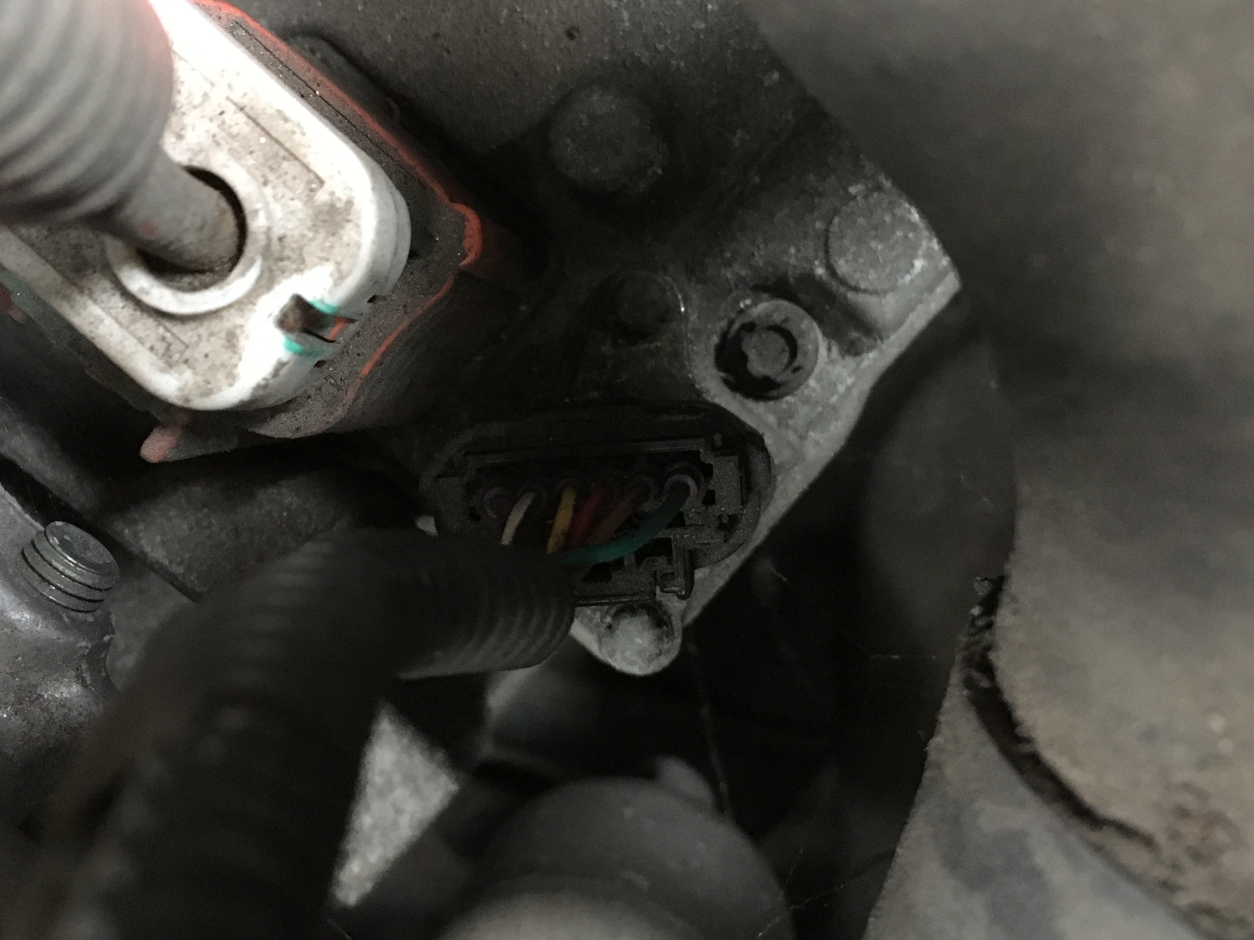

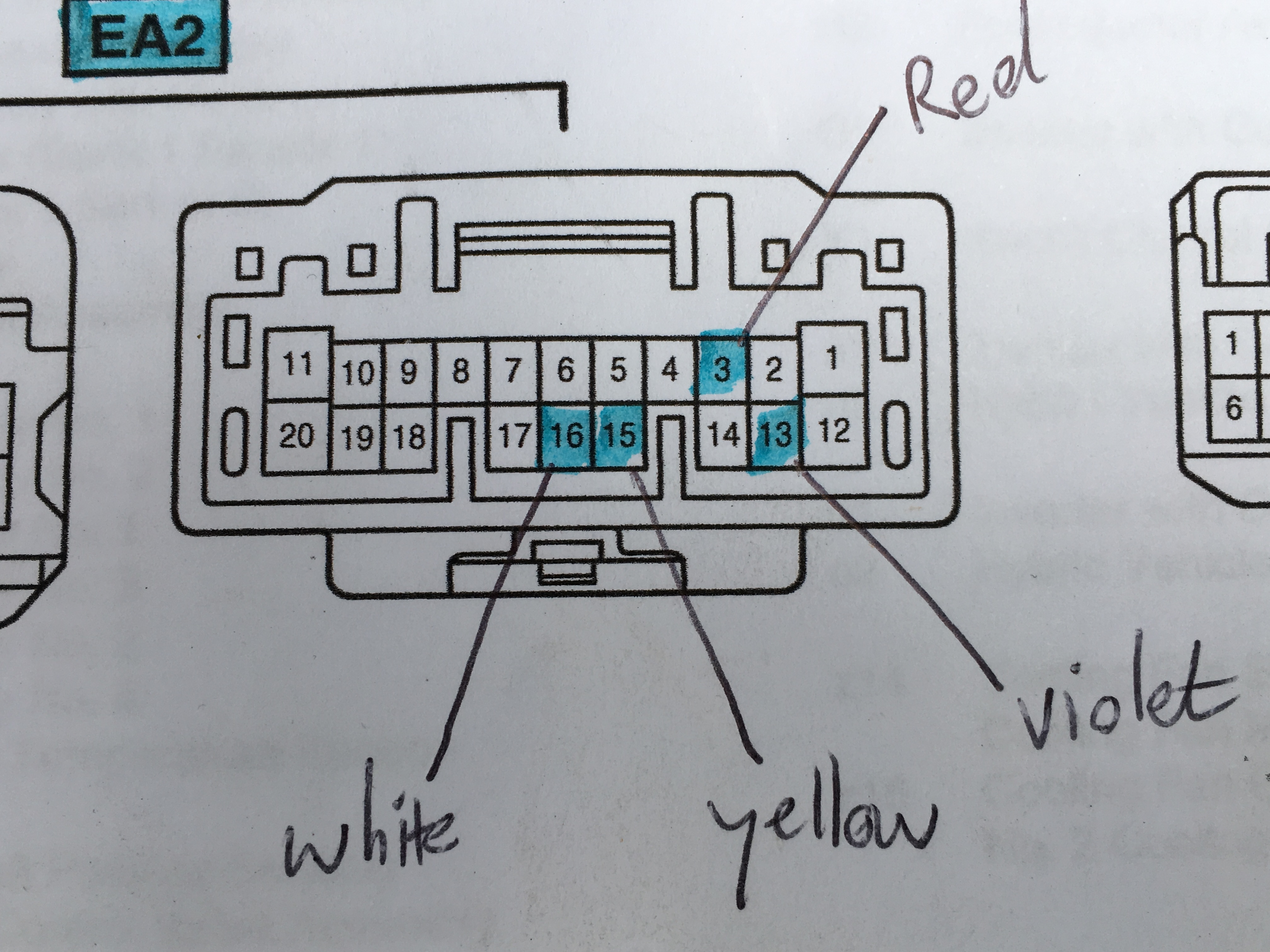

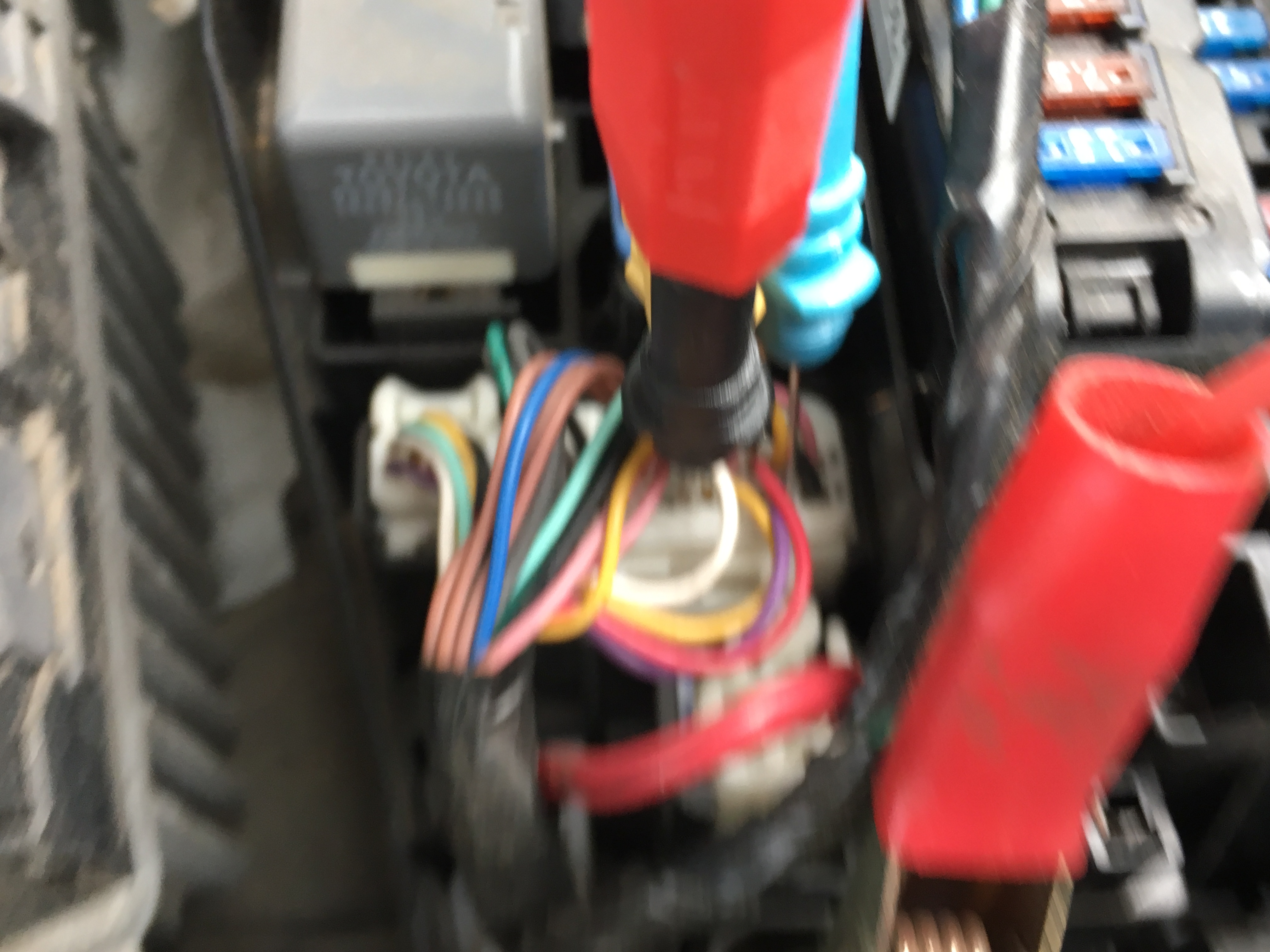

Post by johnspark »
I still have my Hybrid Camry AVV50 of which I can test the Denso compressor. I have uploaded signals before, but I could redo assuming my compressor uses Lin bus too perhaps?
