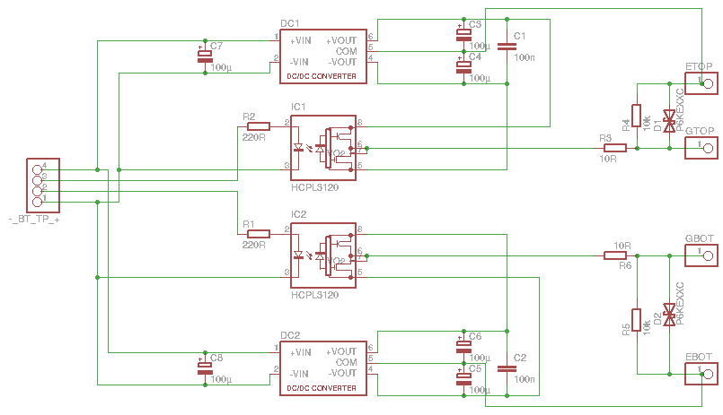

Gate Driver Board
Post by aravinth »
I'm working on a simple H bridge module, may I know what is the DC/DC converter used in the Gate Driver board ?
Posts: 6739
Has thanked: 380 times
Been thanked: 1562 times
Re: Gate Driver Board
Oh yes the part numbers are somewhat outdated/missing. Isolators are Si8261BCC these days and DC/DC MGJ2D051509SC
