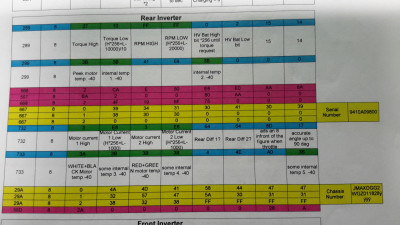

I have done a little messing with the rear inverter here's some of the output messages I have figured and found on other places on the Web and semi comfirmed.
Rear inverter canbus
(I gave up typing in and just took a photo sorry for being lazy)

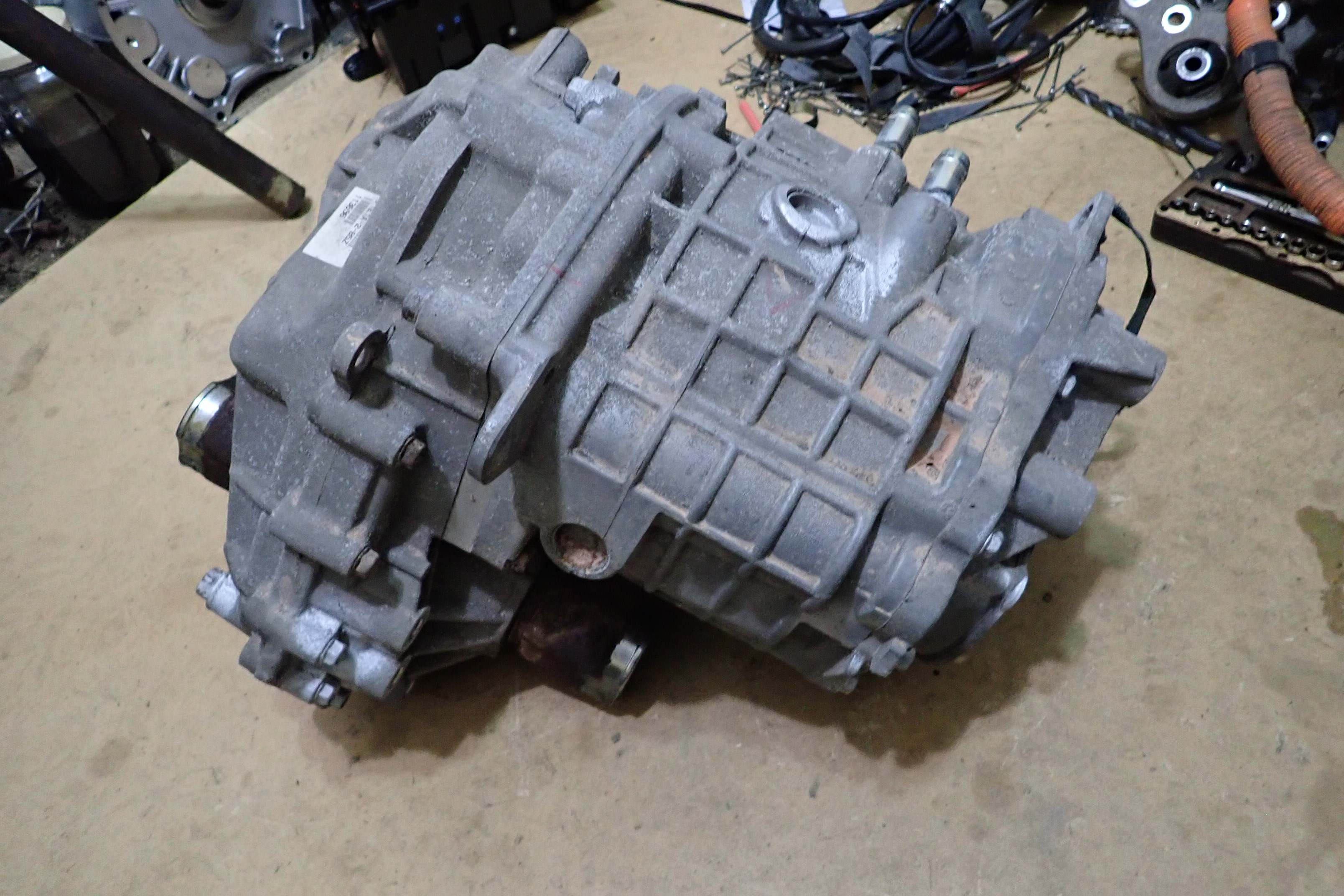

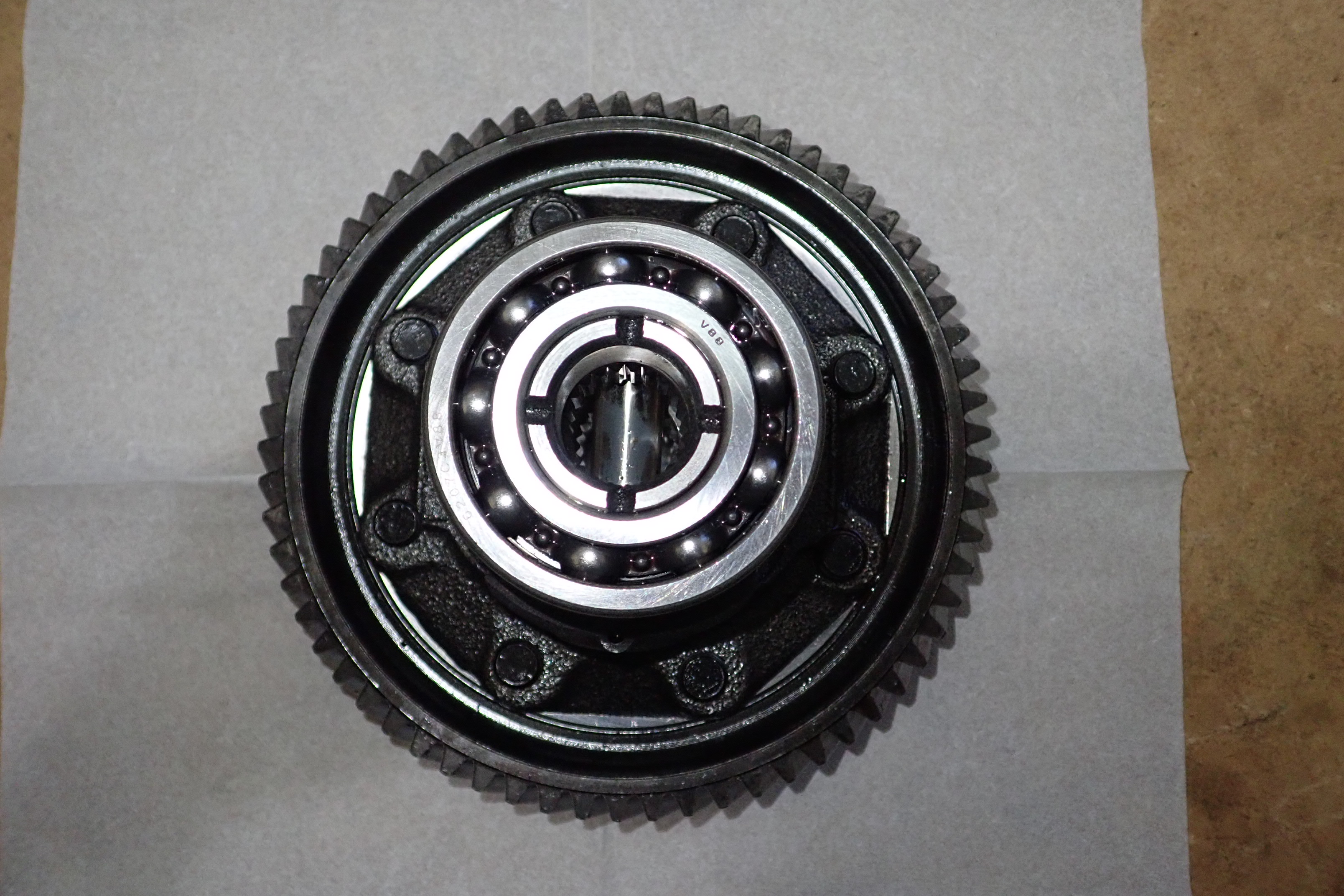

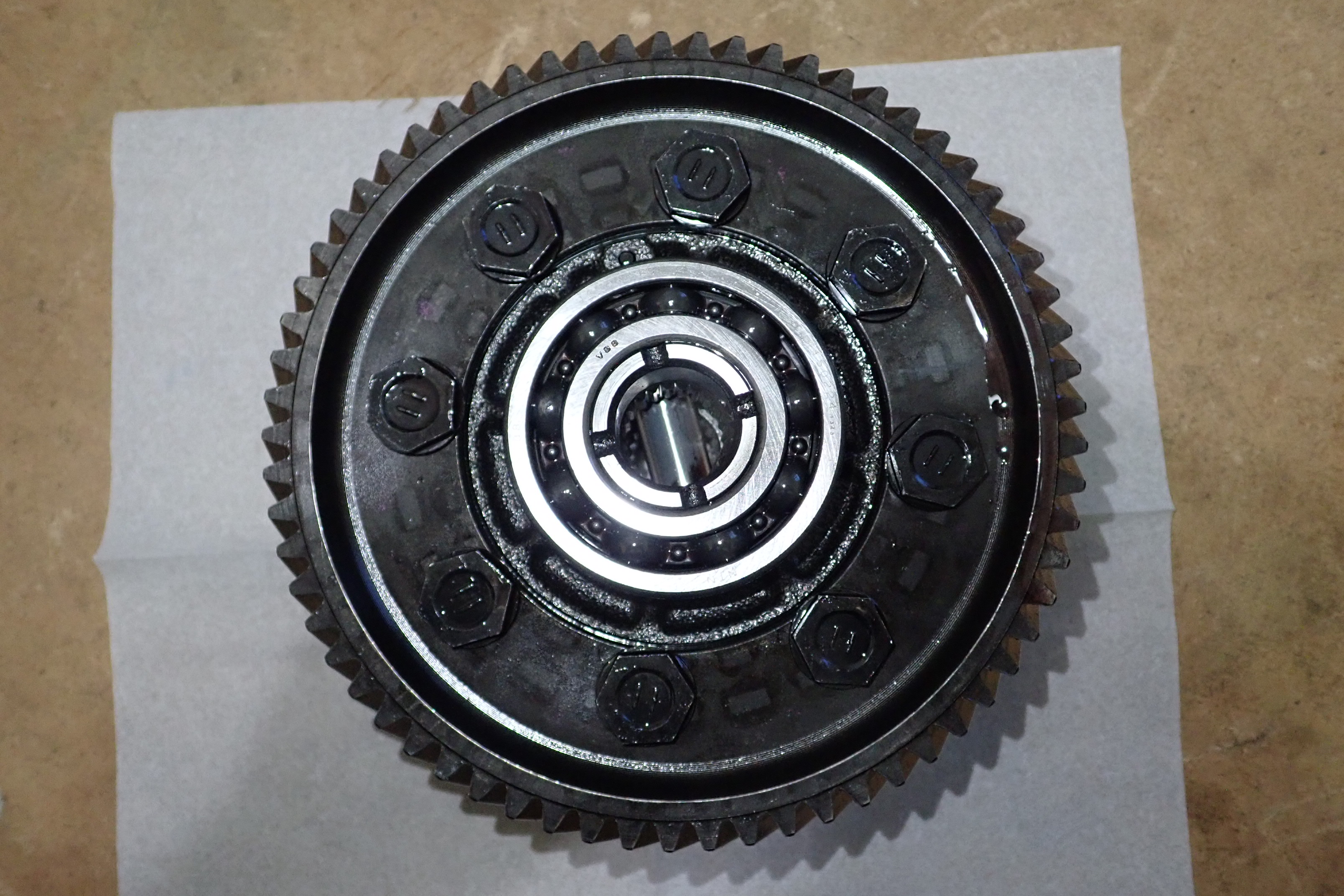

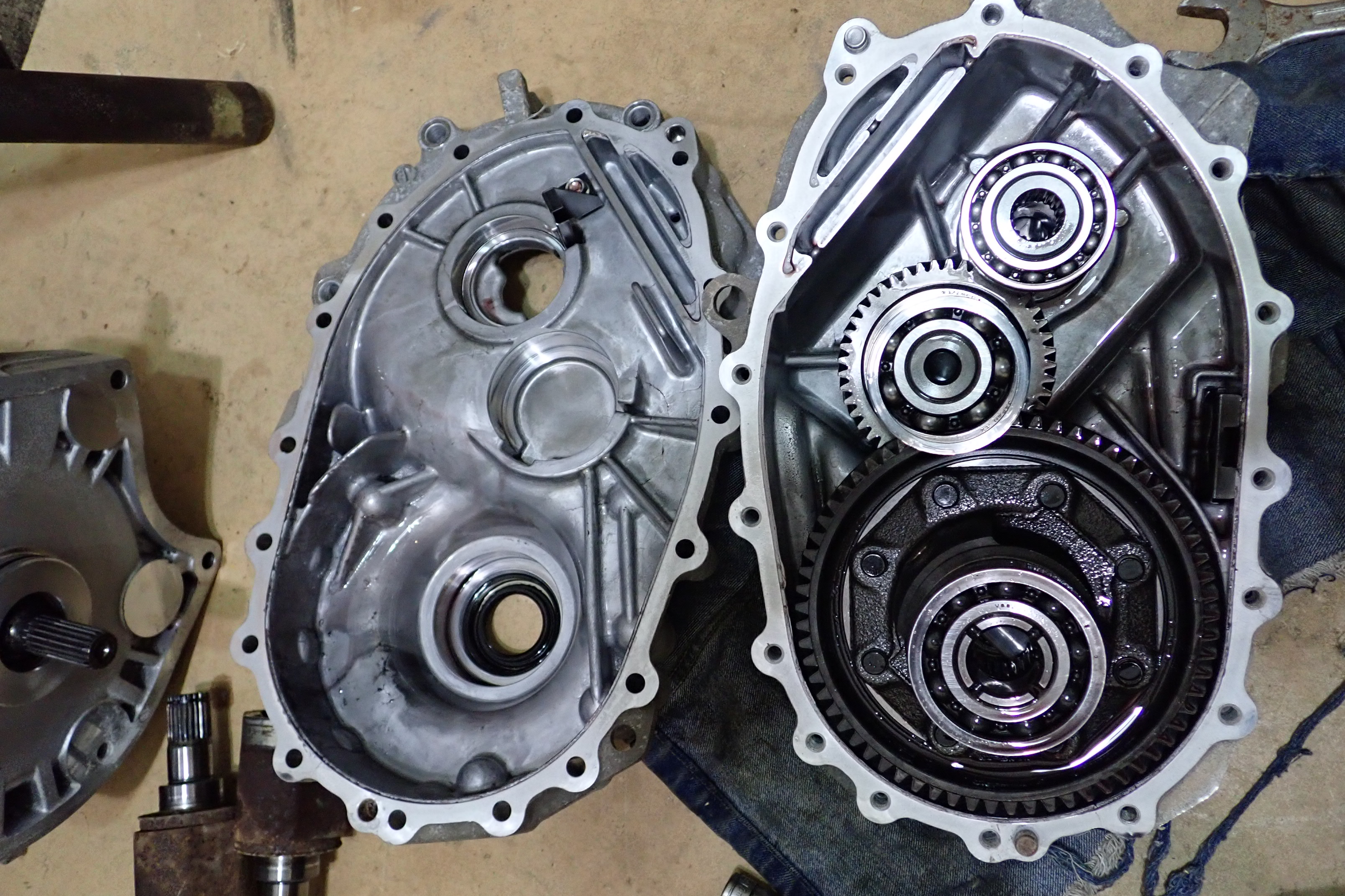

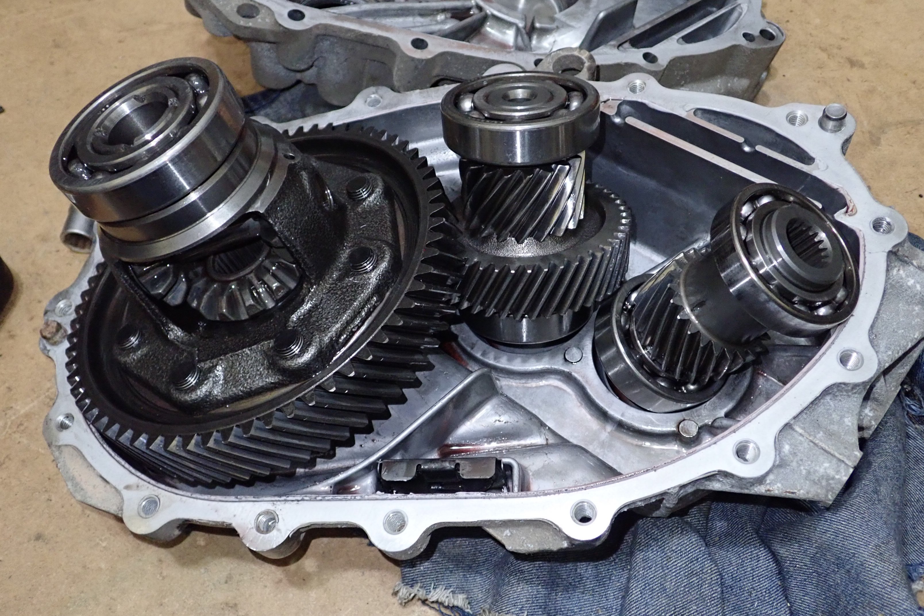

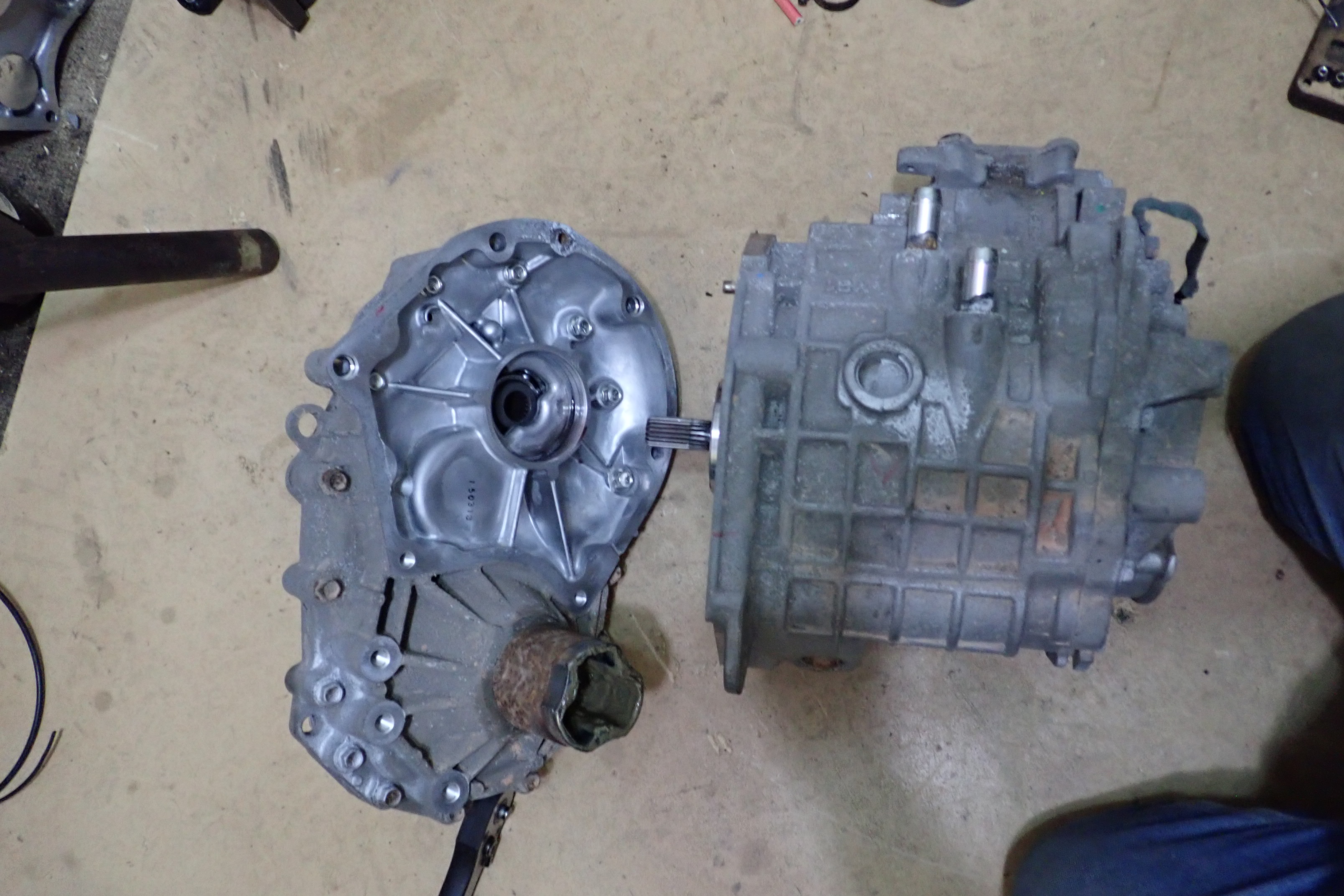

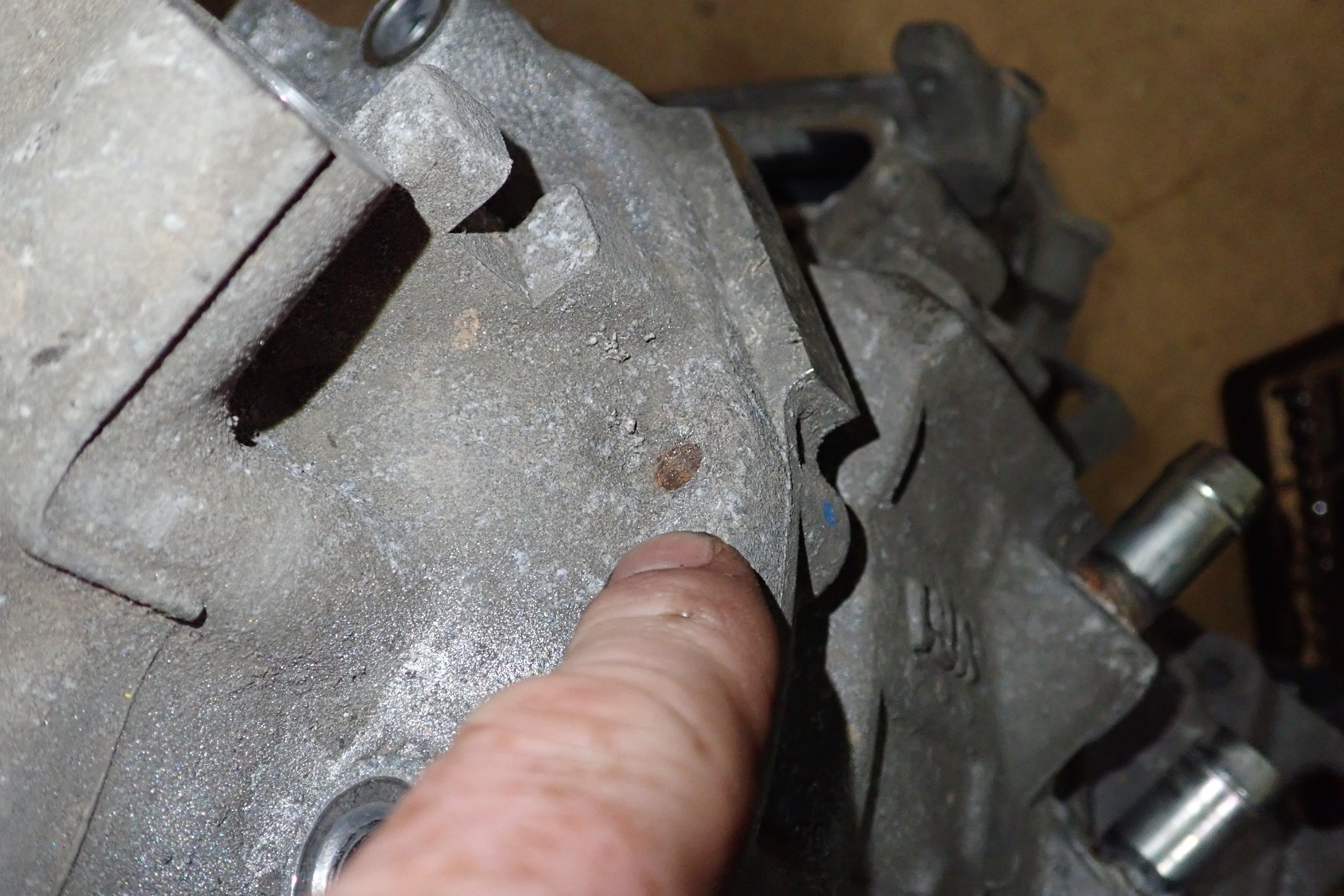

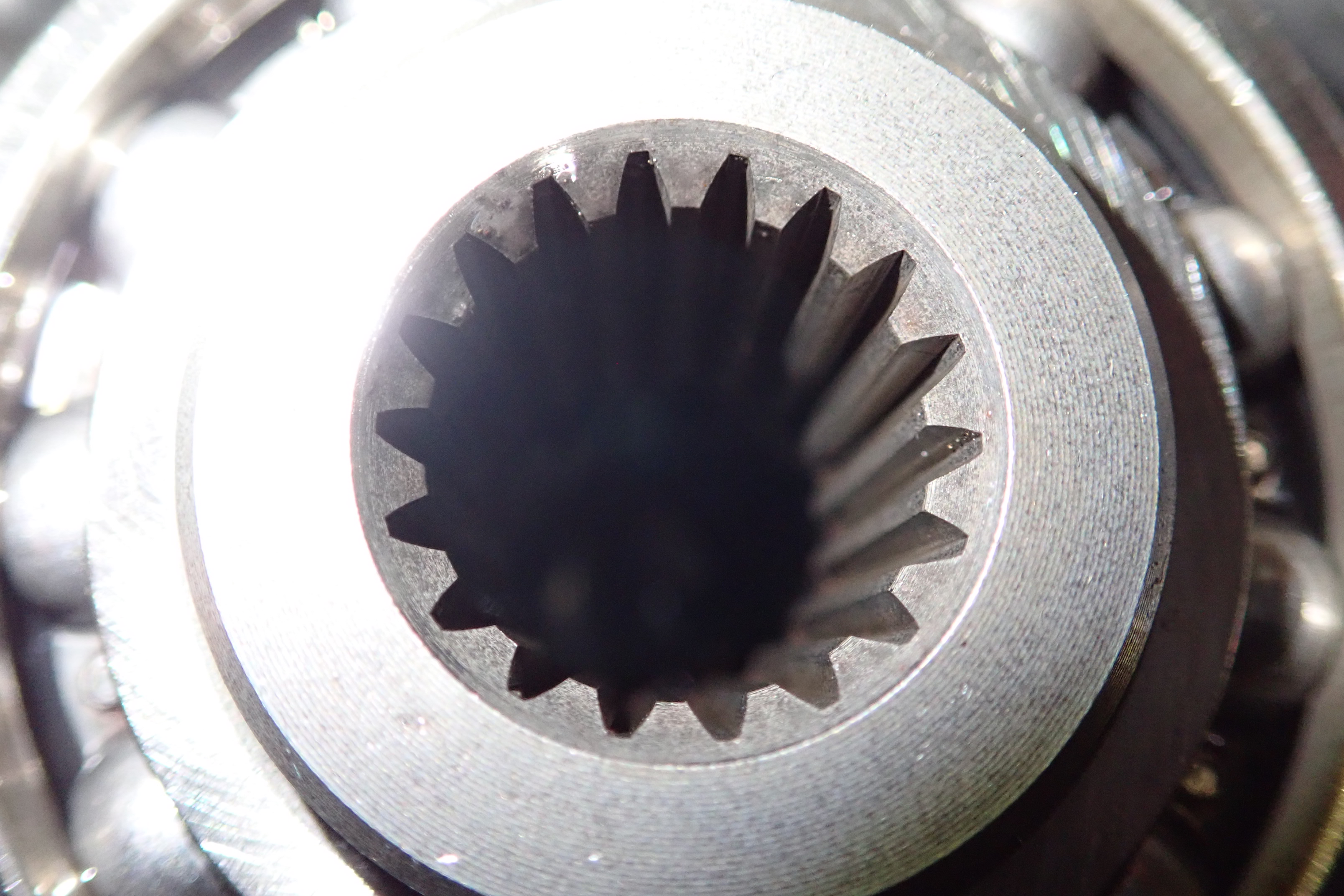

Obtained my own complete motor + gearbox to take apart so I can investigate the layshaft ratio and construction.
Gears are,
Primary
23:45 = 1.9565
Secondary
18:65 = 3.6111
TOTAL = 7.0652

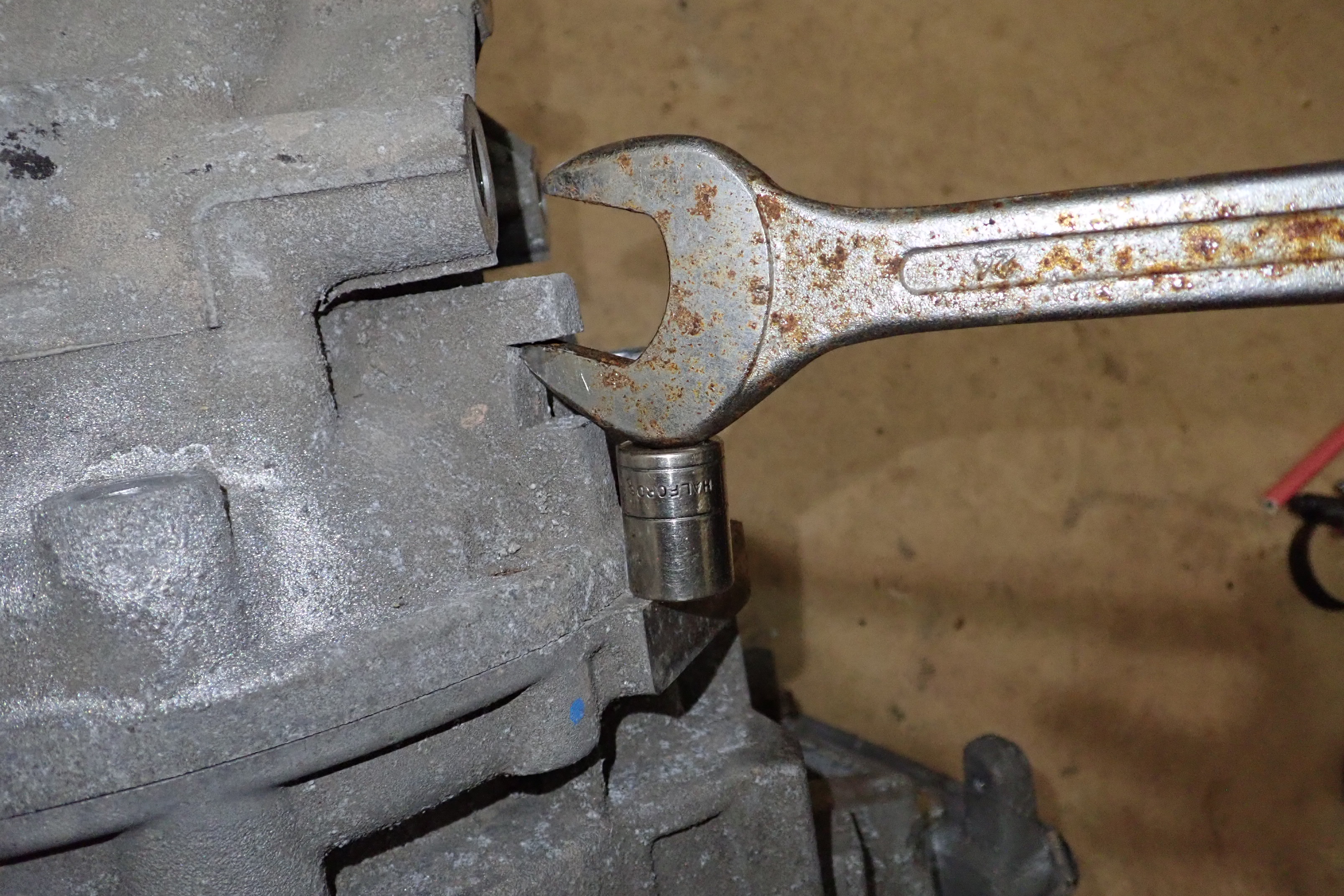

Motor + Gearbox
Locating pin rusted in place.
Innovative pry-bar improvisation. I did something similar for getting the Toyota Gen 3 inverter case apart.
Gearbox off motor.
Gearbox split apart.
Gears
Close up of spline

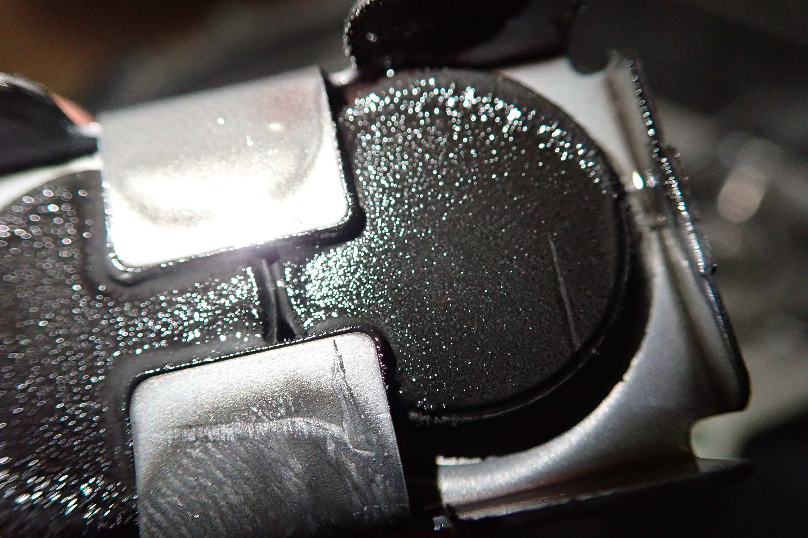

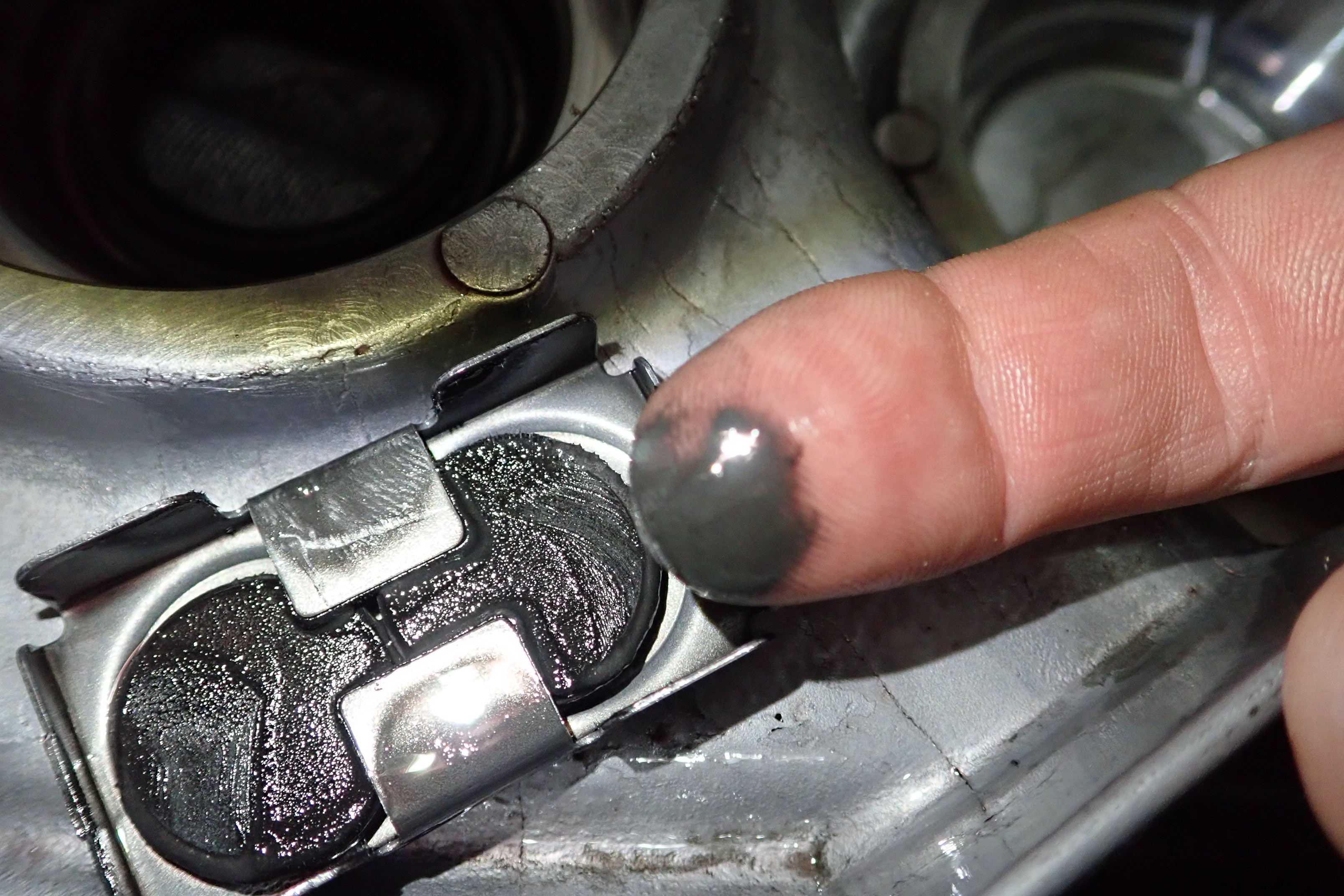

Magnets
Magnet Gooo. Nothing I wouldn't expect to see on a used gearbox.

Nice pictures of the transmission,
The diff certainly doesn't look like conventional Mitsubishi diff.
Does it have a part number or any kinda of details on it?
Mouse
Posts: 138
Location: Wales
Been thanked: 7 times
Re: Mitsubishi Outlander rear axle
Post by Mouse »
seanyt wrote: Fri Sep 18, 2020 6:09 am Nice pictures of the transmission,
Thanks.
seanyt wrote: Fri Sep 18, 2020 6:09 am The diff certainly doesn't look like conventional Mitsubishi diff.
I guess it's designed by the motor manufacturer and bought in by Mitsubishi as a single transaxle unit, but that's only a guess.

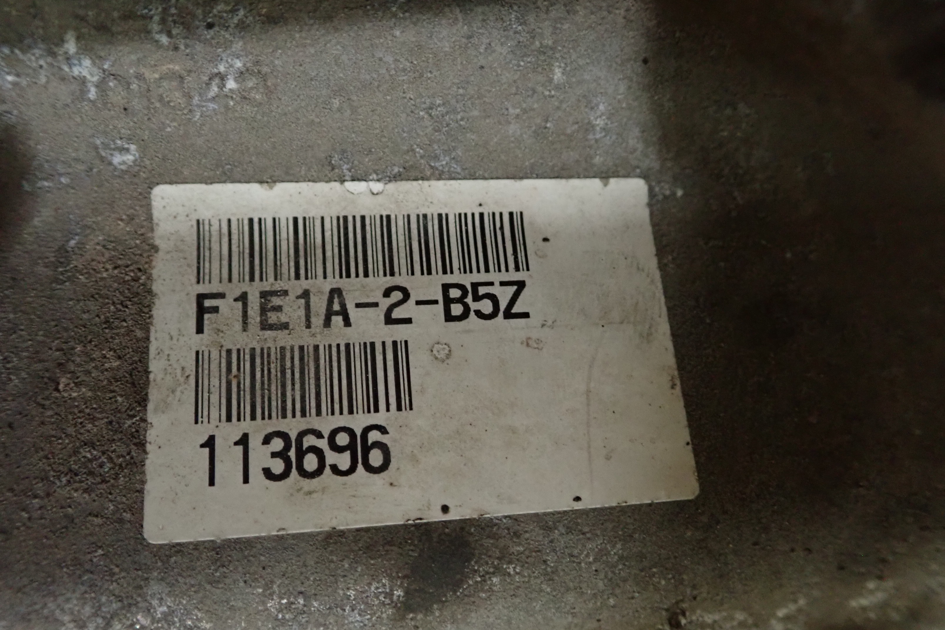

seanyt wrote: Fri Sep 18, 2020 6:09 am Does it have a part number or any kinda of details on it?
Sadly not, no markings at all. Here's a couple of close up photos of it. There were also no identifiable markings on the gearbox castings other than a sticker containing two bar codes.
