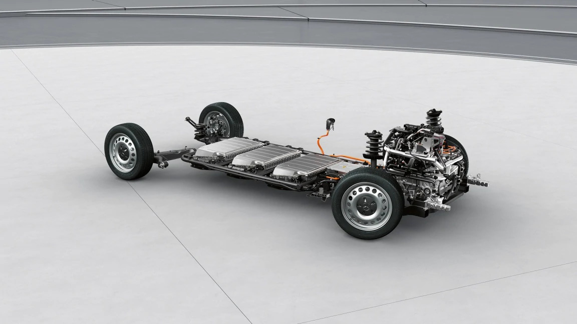

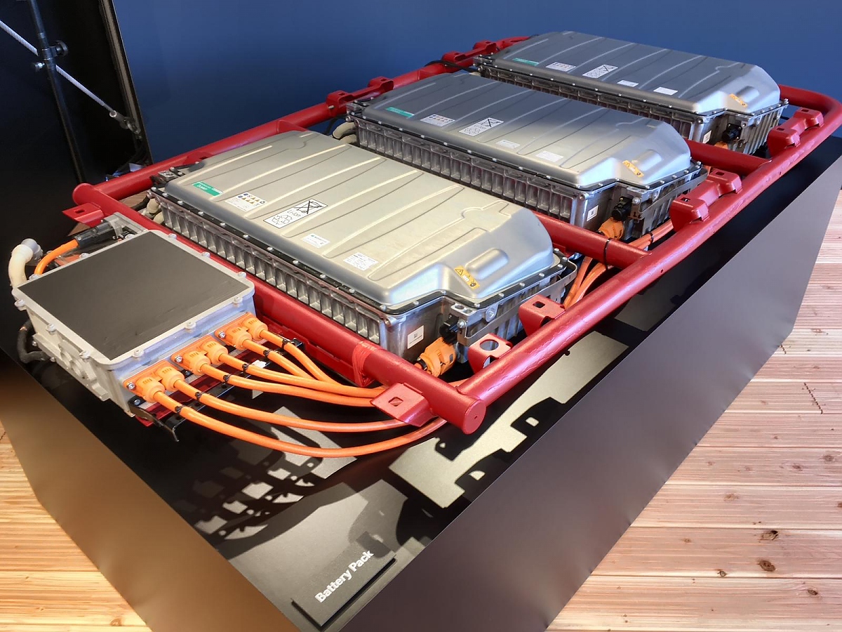

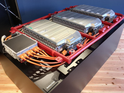

Am I crazy or is the eVito battery literally just 3 PHEV batteries connected in parallel?
Looks very DIY. :mrgreen:
It's also much more expensive than the Vivaro-e which has a more serious battery. Anyway, these will be handy for conversions in the future.

WoW, it looks like it is 3xphev packs :) maybe theythink it will be easier to change a pack if they start failing 1by1?
