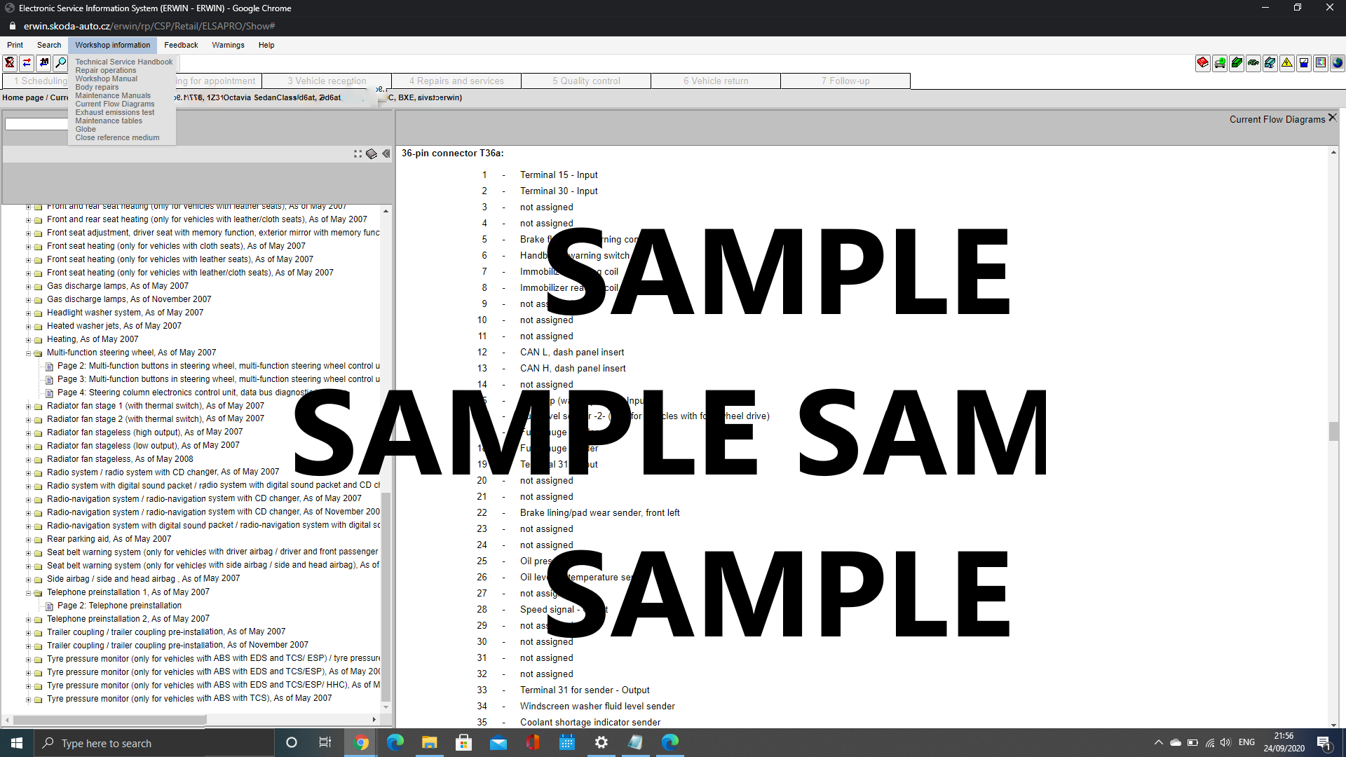

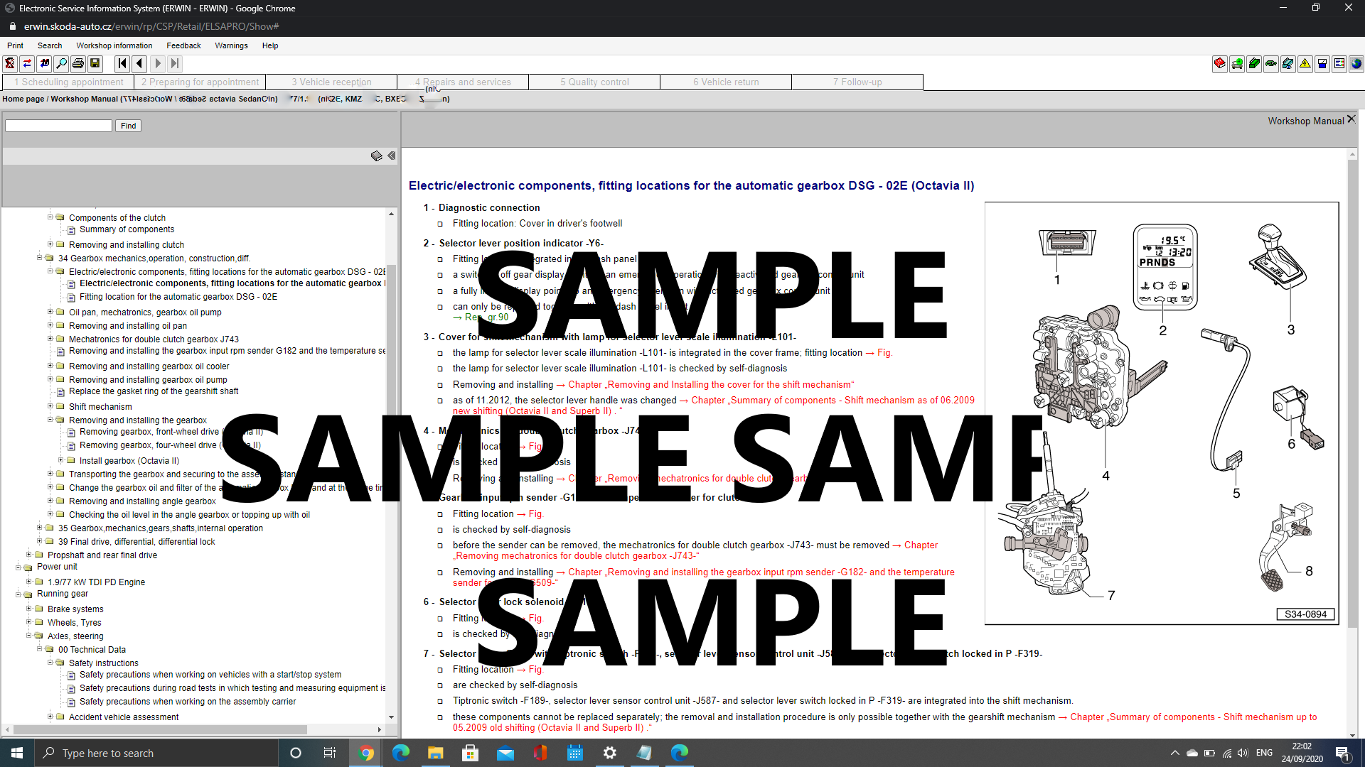

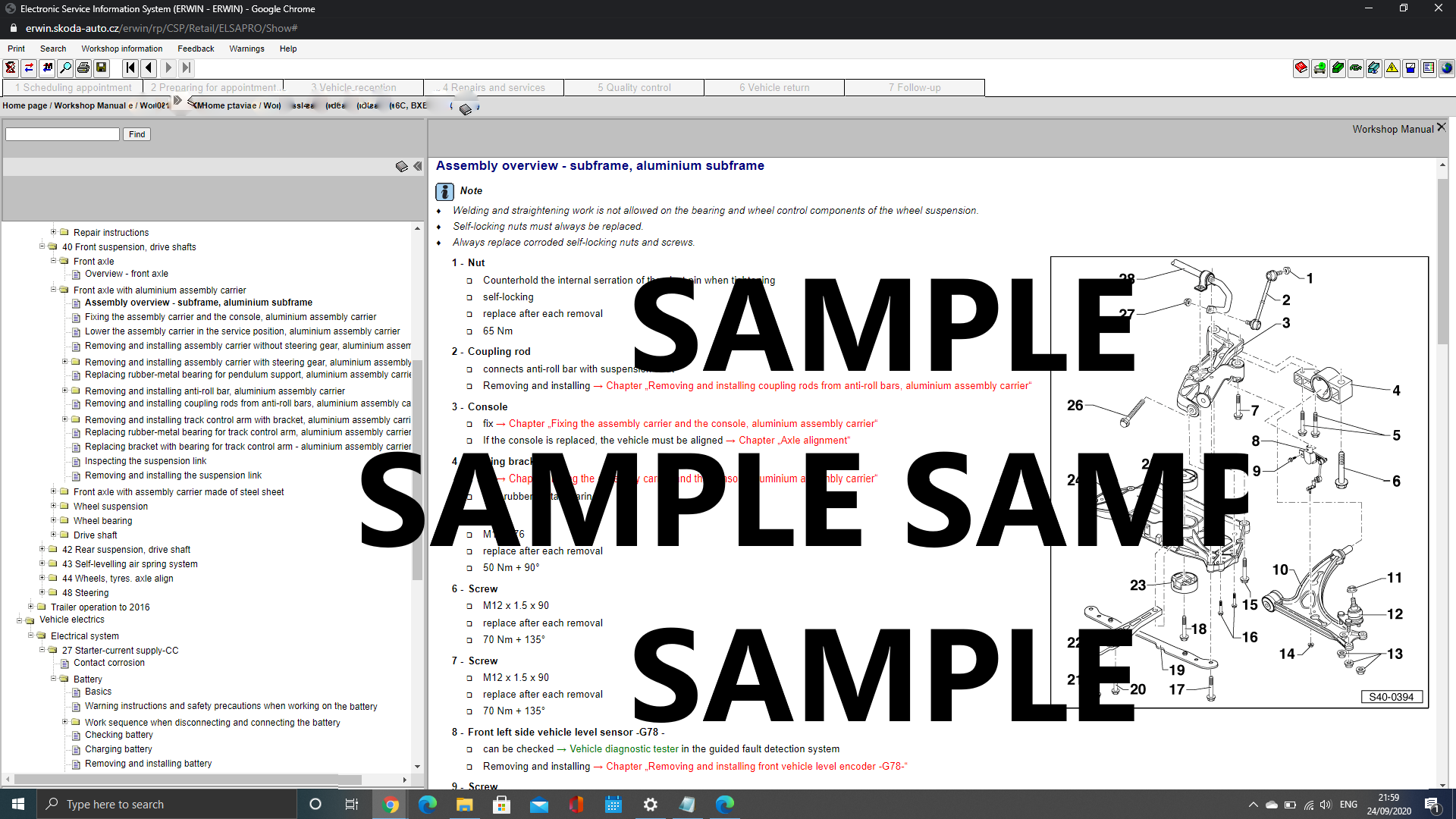

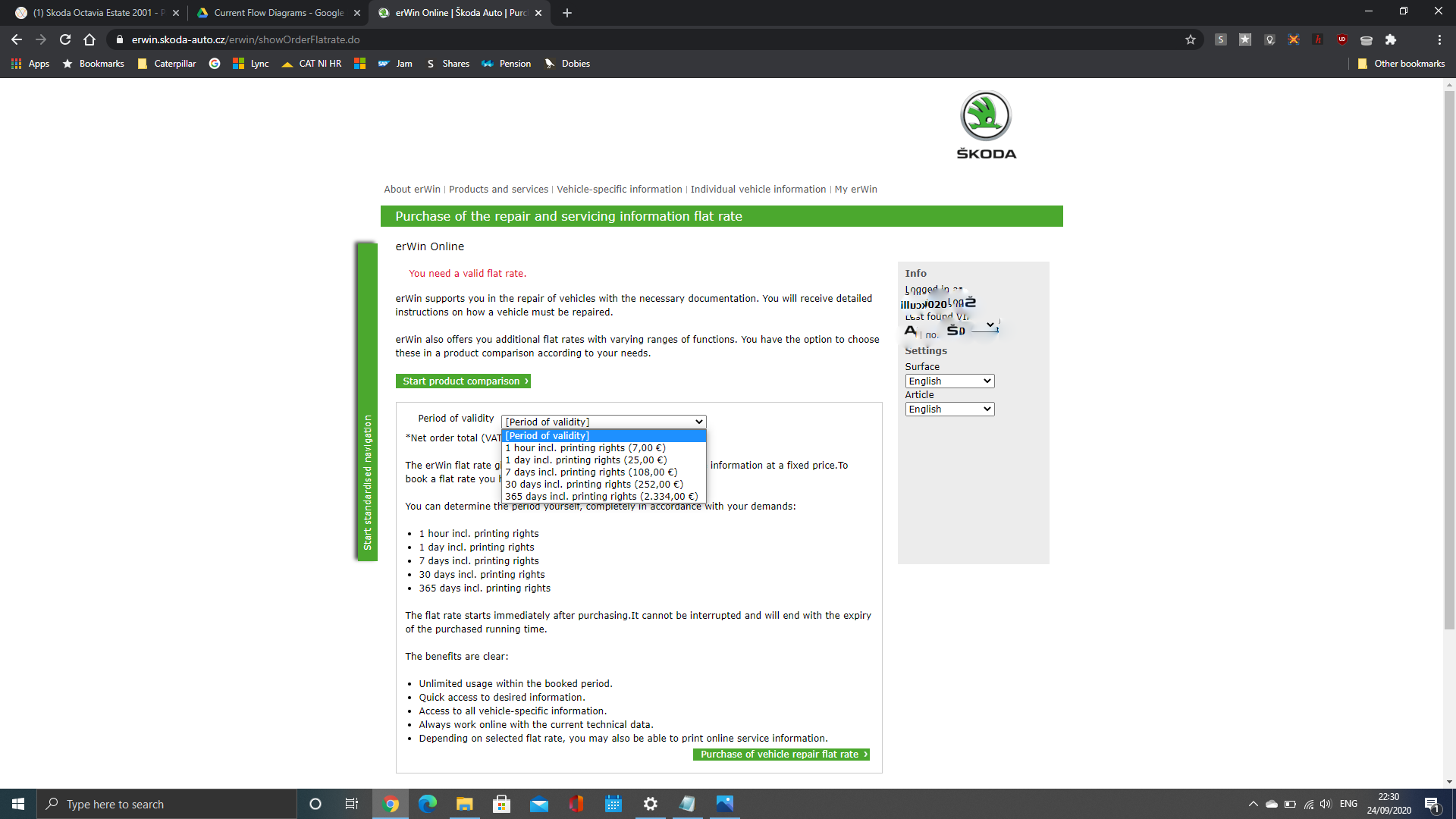

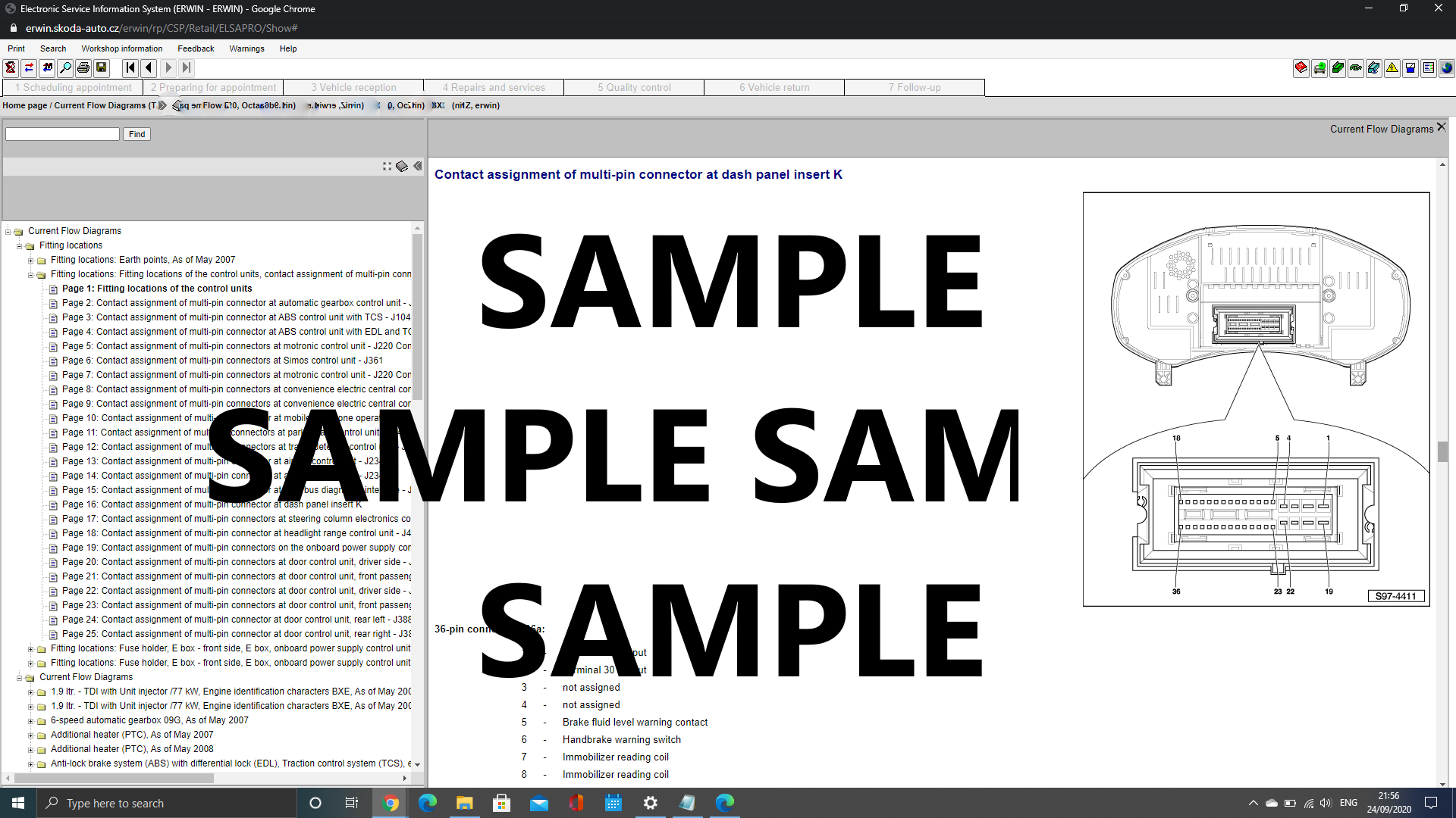

Just a quick FYI; if you need to know pin-out information on harness connectors, or want to see wiring diagrams to understand system logic, then I recommend spending €7.00 + VAT over at https://erwin.skoda-auto.cz/erwin/showOrderFlatrate.do
I have attached some random images to give you an idea of what type of info they are willing (forced by the EU?) to share with us. Personally, I prefer this over website of doubtful honesty or legality, offering similar information.
What I have found so far:
:( No parts books, a third party offers this
:D €7.00 + VAT for 60 minutes access (might be all you need)
:D You can print to PDF until your fingers go numb
:D Up-to-date manufacturer information about your Skoda
Regards, Patrick.

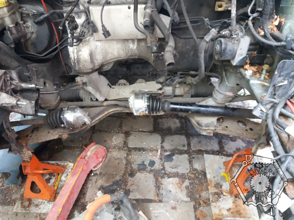

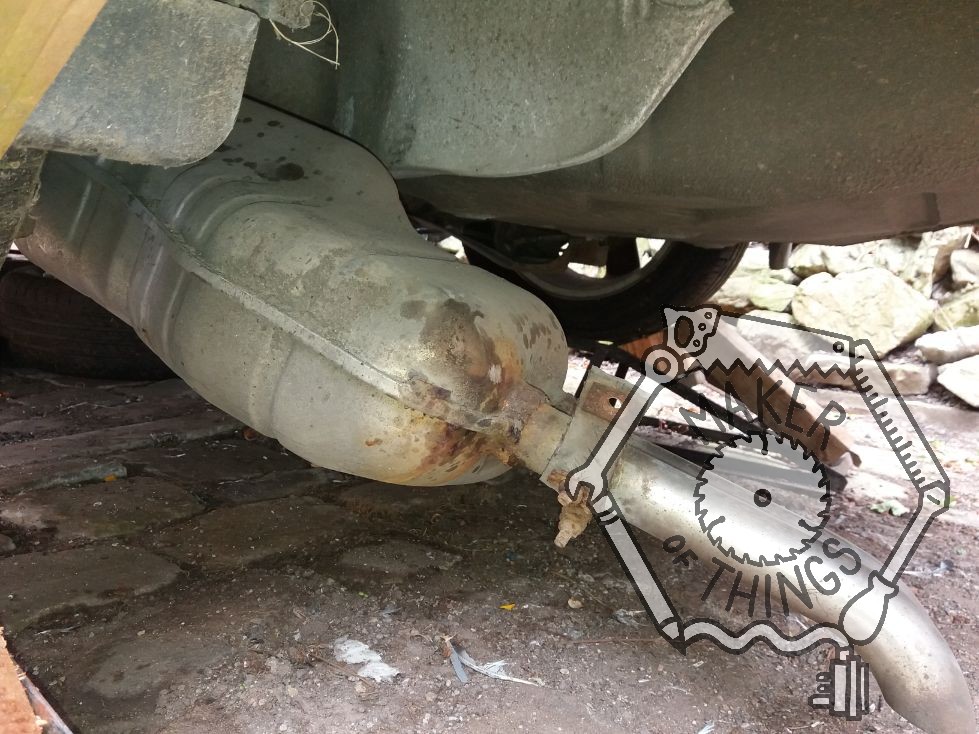

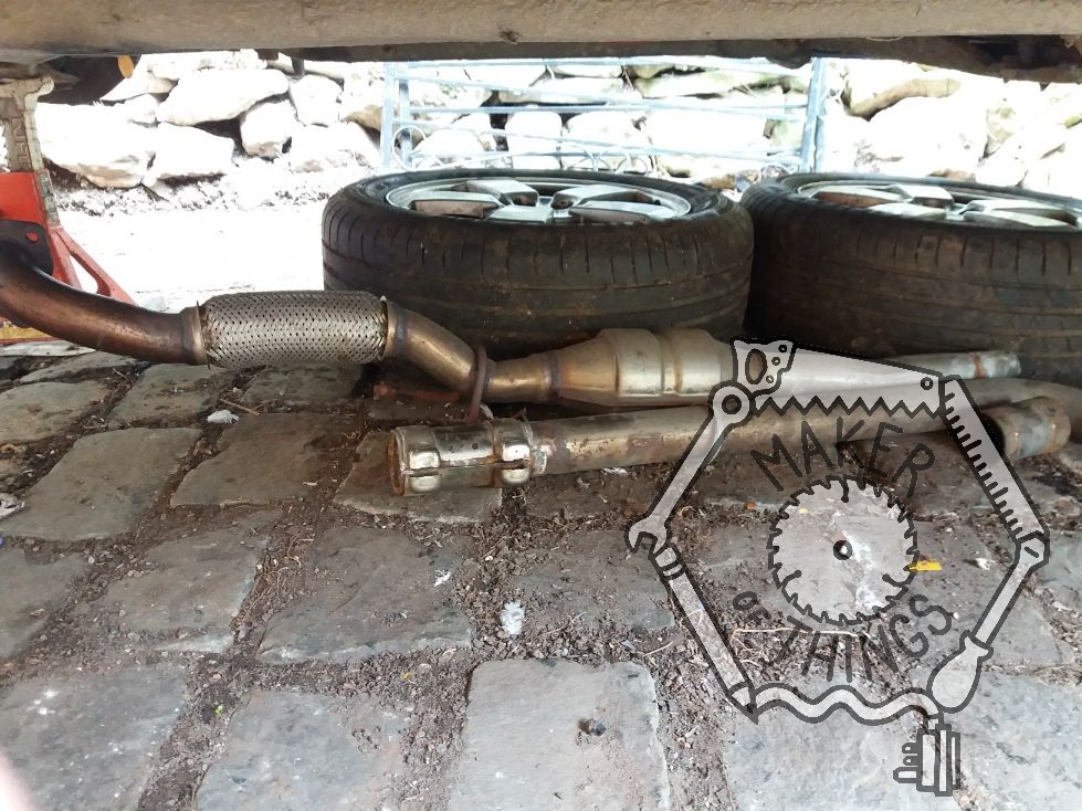

Not been working on the car for a few days, work and installing low voltage solar pv to use some panels donated to me a few years ago. I can now charge 12V batteries with the morning sun!

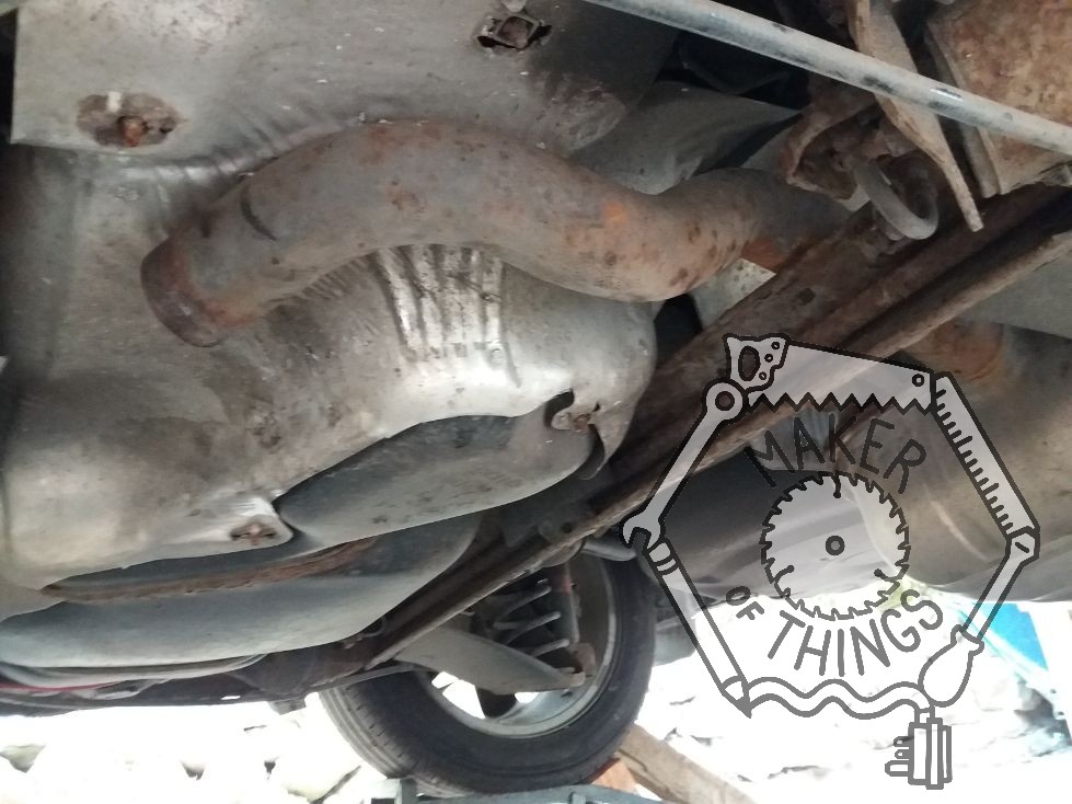

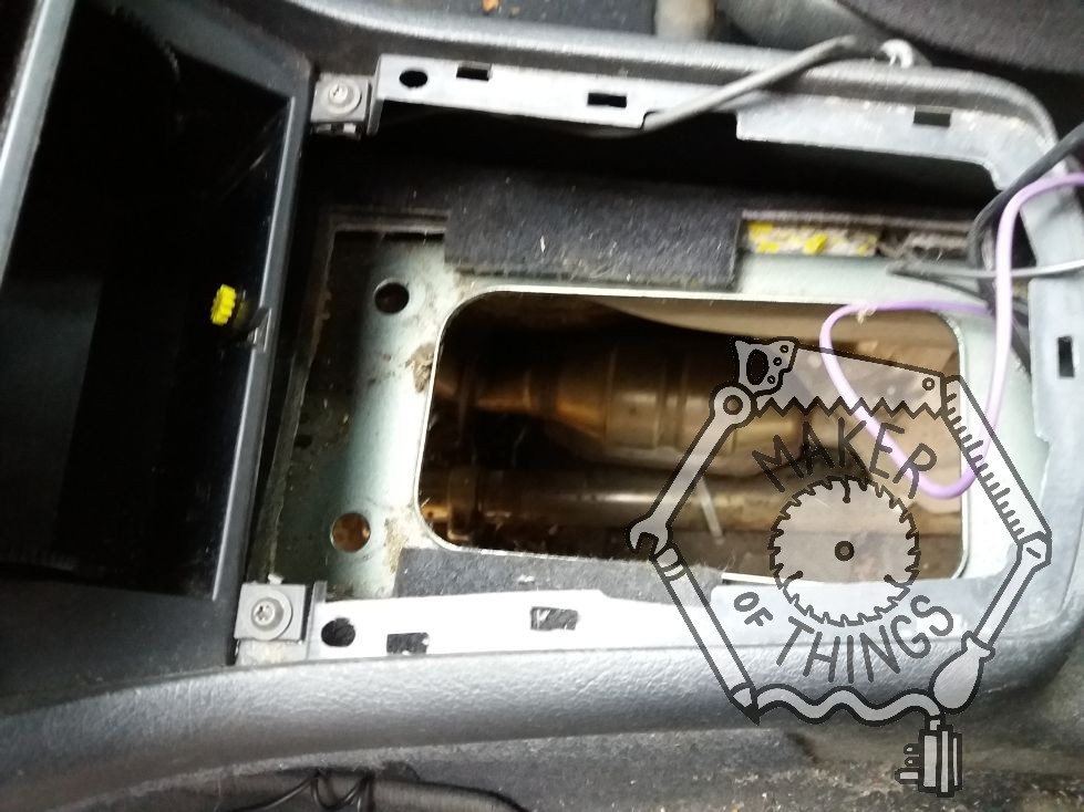

Anyway, I decided to remove the exhaust pipe today. It is mostly removed, the rear section won't come out.
The original design meant the exhaust pipe went in before the axle, so replacement means cutting it out and also cutting the new pipe to allow it to fit, and then re-joining it.
As a result the rear box won't come out!
I will leave it there until I have to unbolt the rear axle to get the fuel tank out.
Is there actual scrap value in the catalyst?
Stuck!
That bend won't wiggle round!

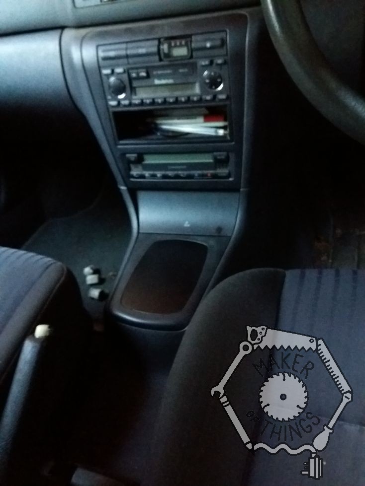

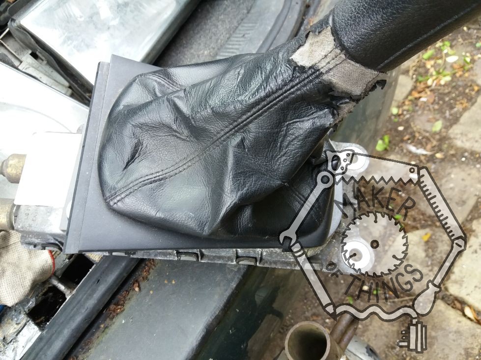

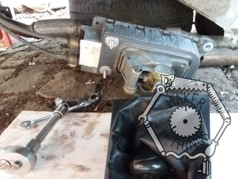

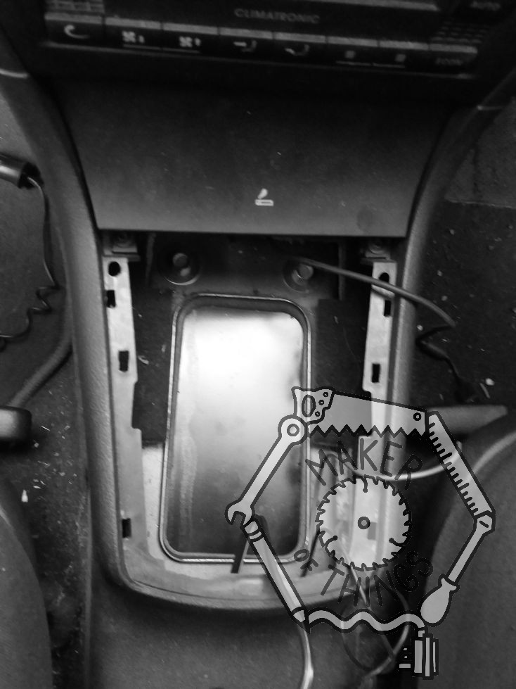

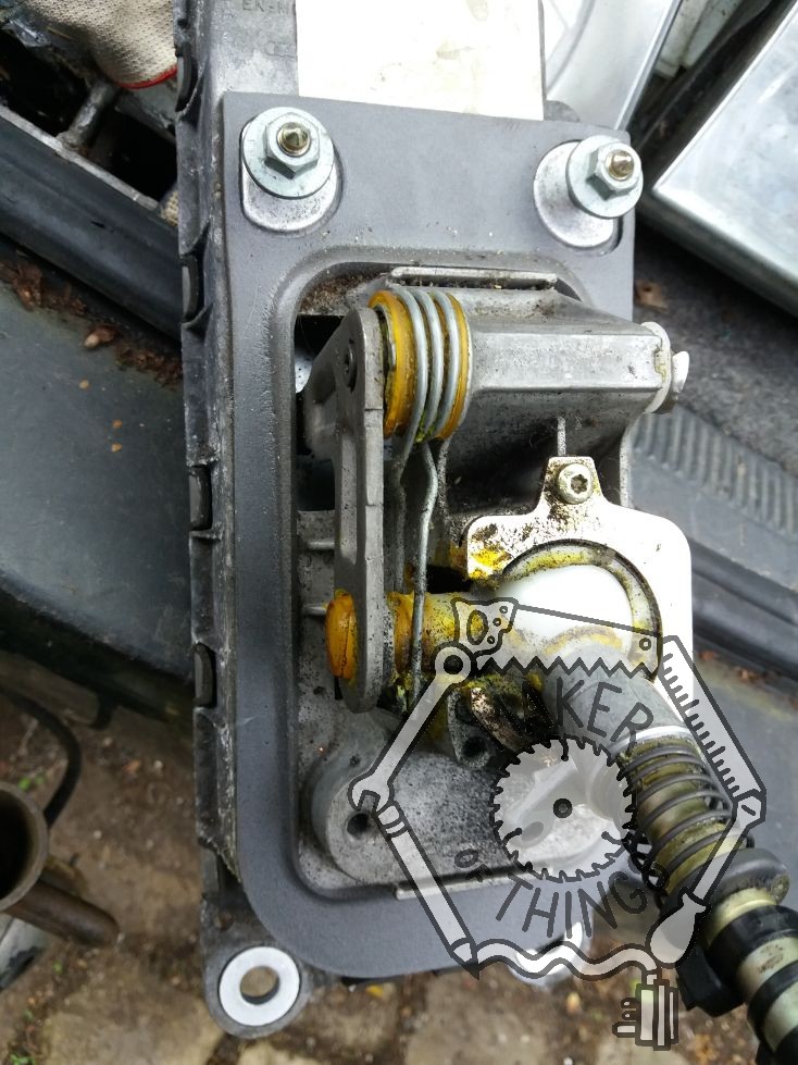

I also removed the gear stick mechanism while I was about it.
An easy job, the heat shields came out, held only by little discs of rust.
Then inside, with the gear stick boot unclipped and the ashtray removed, there was access to two 13mm AF nuts at the top.
Underneath the car again remove two 13mm AF bolts.
The mechanism then just falls off and the gearstick boot and be fed through the hole in the floor.
I will make a cover for the hole, and then the boot surround plastic can be used to make the switch panel for the forward/neutral/reverse switch.
I reckon that was the easiest part of the whole conversion so far!

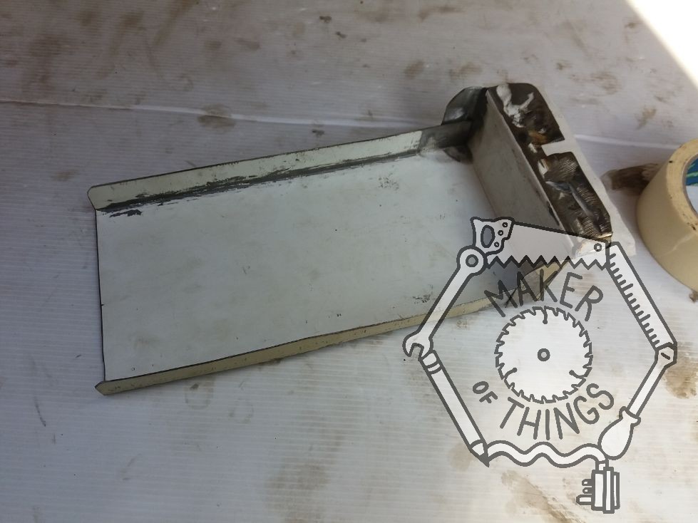

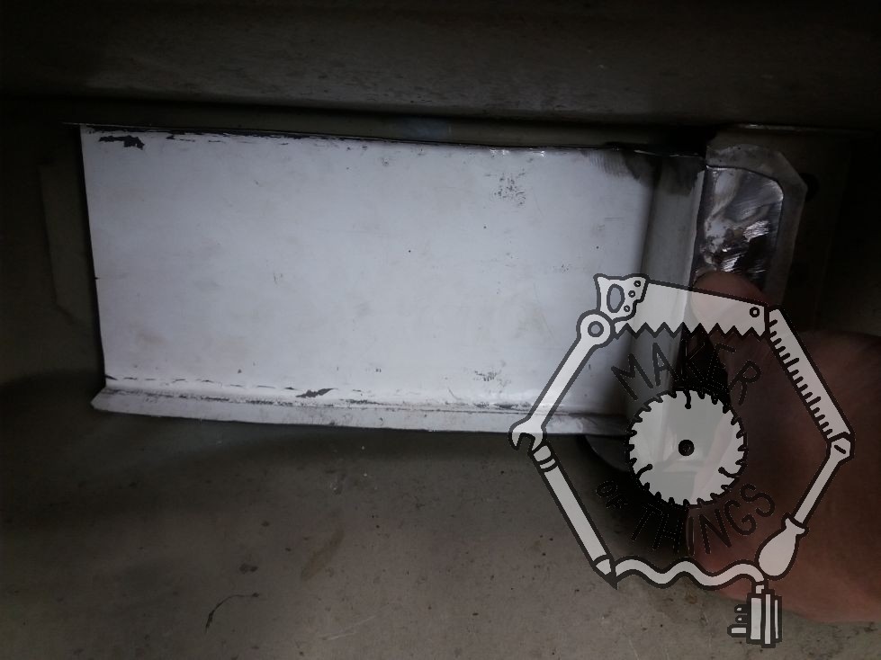

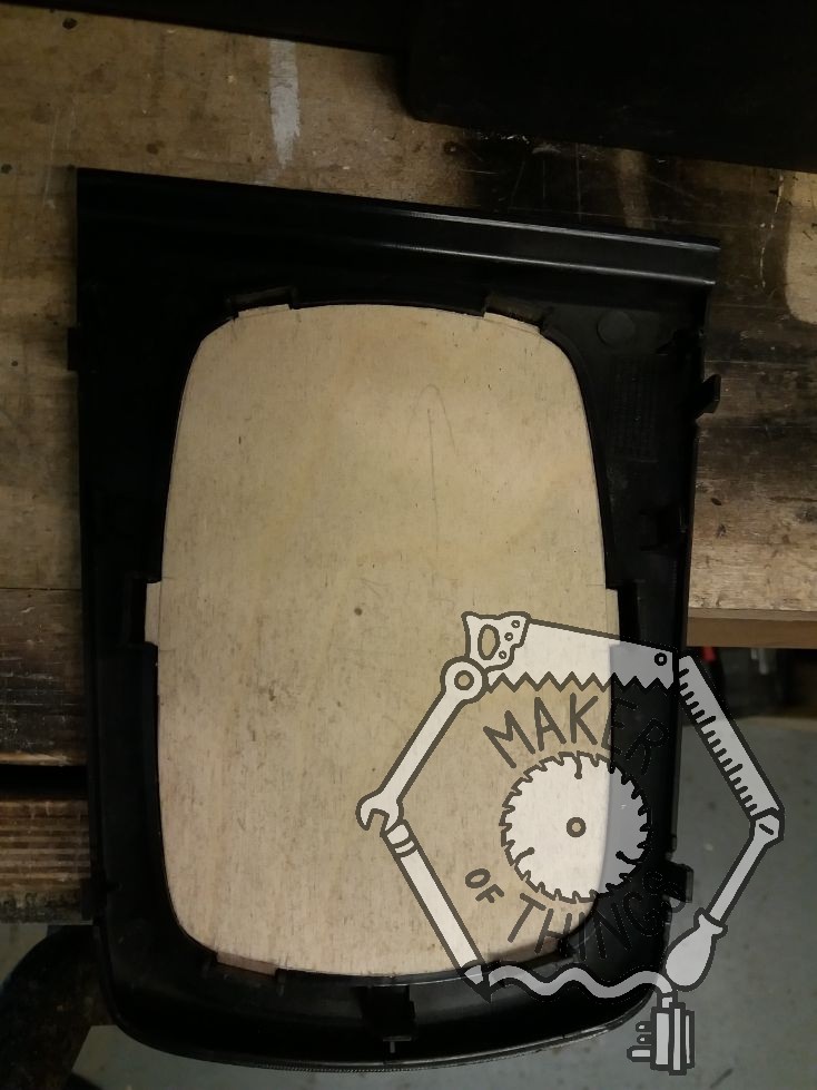

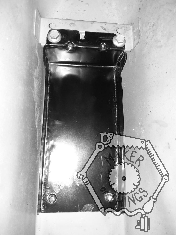

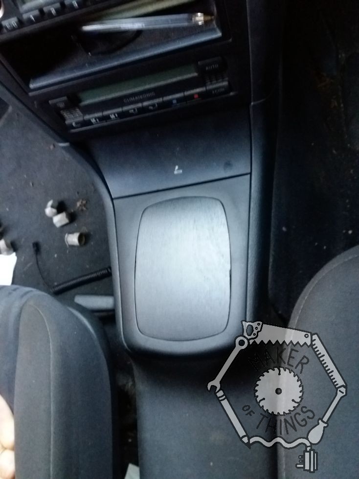

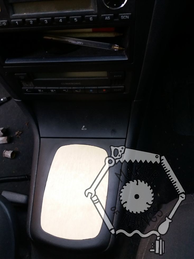

Today I did a bit of metal work to patch the hole left by the gearshift mechanism.
As I am one of those people who hoard everything that might become useful later on I was able to source the steel from an old washing machine I dismantled many years ago.
I measured and made up the patch, folded the sides for rigidity, and TIG welded the corners.
After a successful test fit I drilled the holes for the bolts from underneath, and rivnuts for the bolts from above.
The patch was then sprayed with cold galv paint and then stain black.
At this point my phone thought black and white images would give a more atmospheric effect!
I was able to reuse the foam gasket from the old shifter body, so it is now nicely sealed.
I then removed the plastic trim from the gearstick boot and used it to make a 6mm birch plywood infill piece. I included the tabs in cutting out the plywood so that it would clip in place and be flush to the surface.
I can use this to mount the forward/reverse switch, and any other useful stuff.
I am spraying the plywood black as it was never going to be a wood trim kinda car, even though I do have some burr cherry veneers in stock!
This is what it looks like in black, a bit more shiny and blacker then the plastics but it'll do.

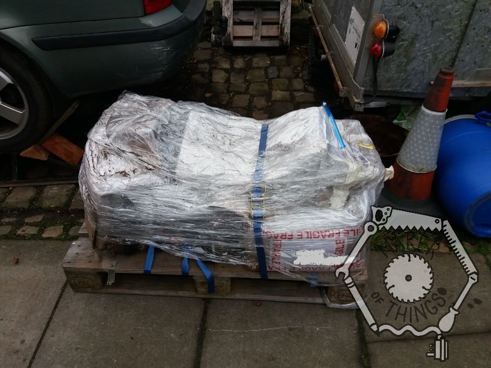

Today was the day that the pallet from Damien was supposed to arrive!
Having waited in all day, with a pallet truck at the ready there was nothing. The tracking said it arrived at the depot at 07:38 this morning and would be delivered by today. It wasn't logged as out for delivery though.
That never changed all day.
At 17:00 I phoned the company and found that the pallet arrived at their central depot this morning, and just hadn't been sent out to their Manchester depot for local delivery! :x
They offered tomorrow morning, so I agreed to postpone my work to wait in. But of course they will only deliver it in the morning IF someone brings it up from their central depot to their Manchester depot. So I might still have a wasted morning/day.
I have told them to phone me and tell me if it is in Manchester in the morning, and if it is worth me waiting in or working.
Not holding my breath, but can't wait!

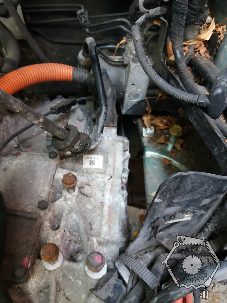

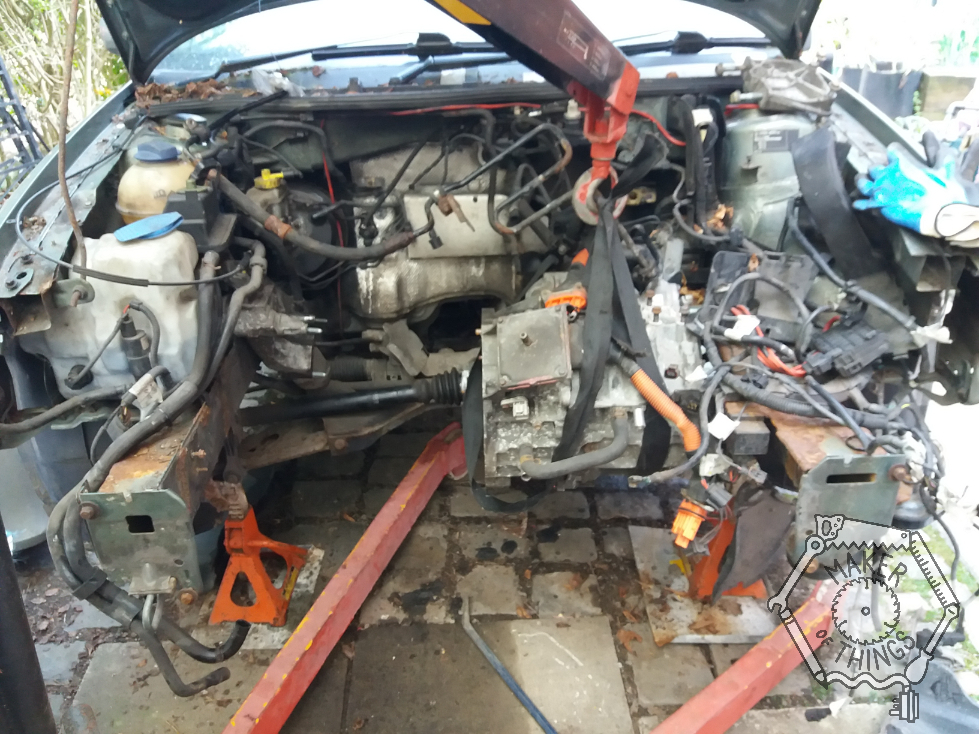

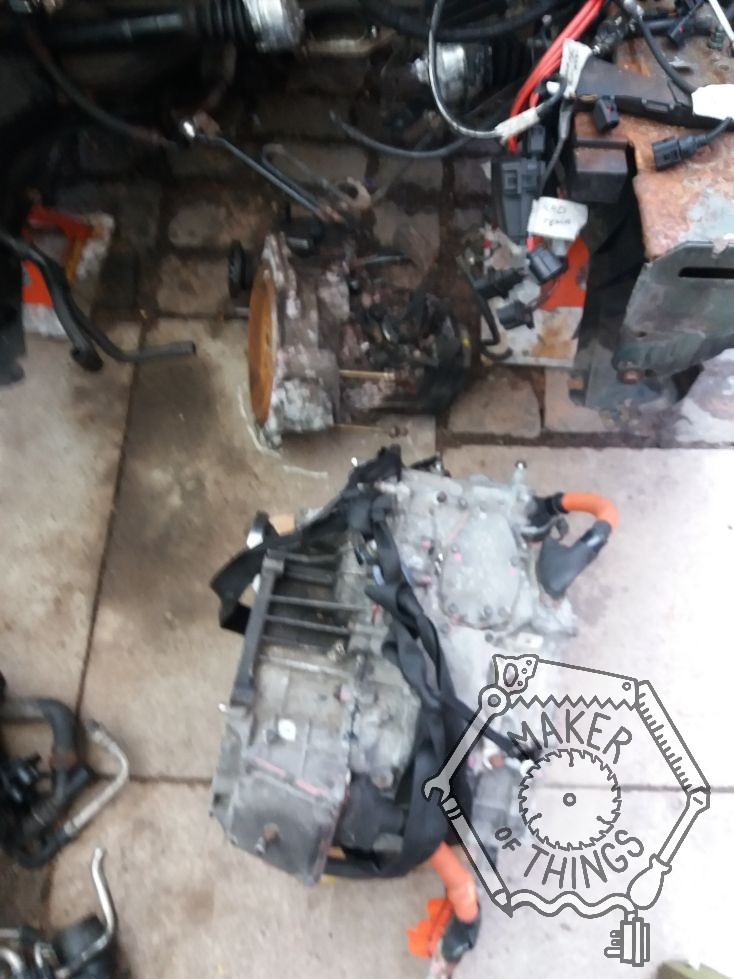

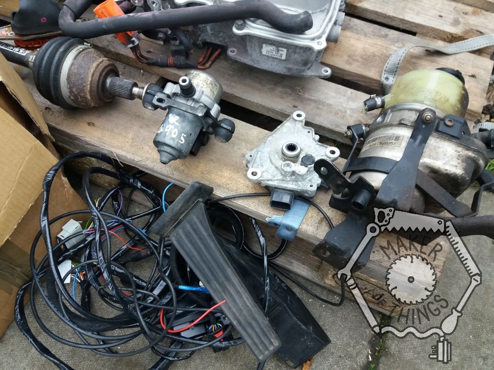

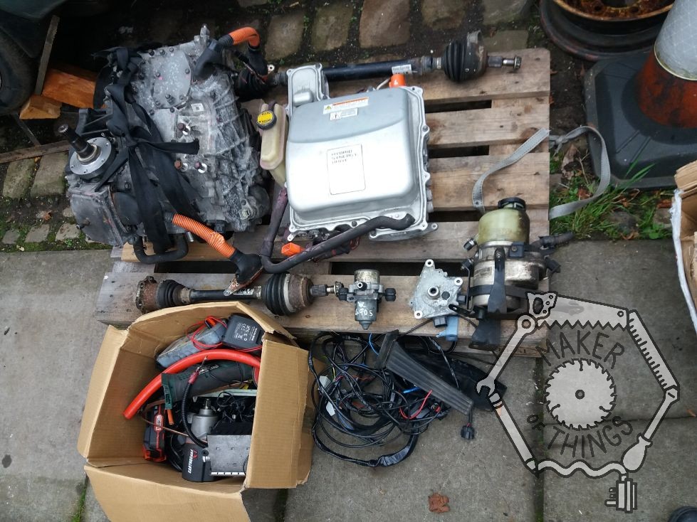

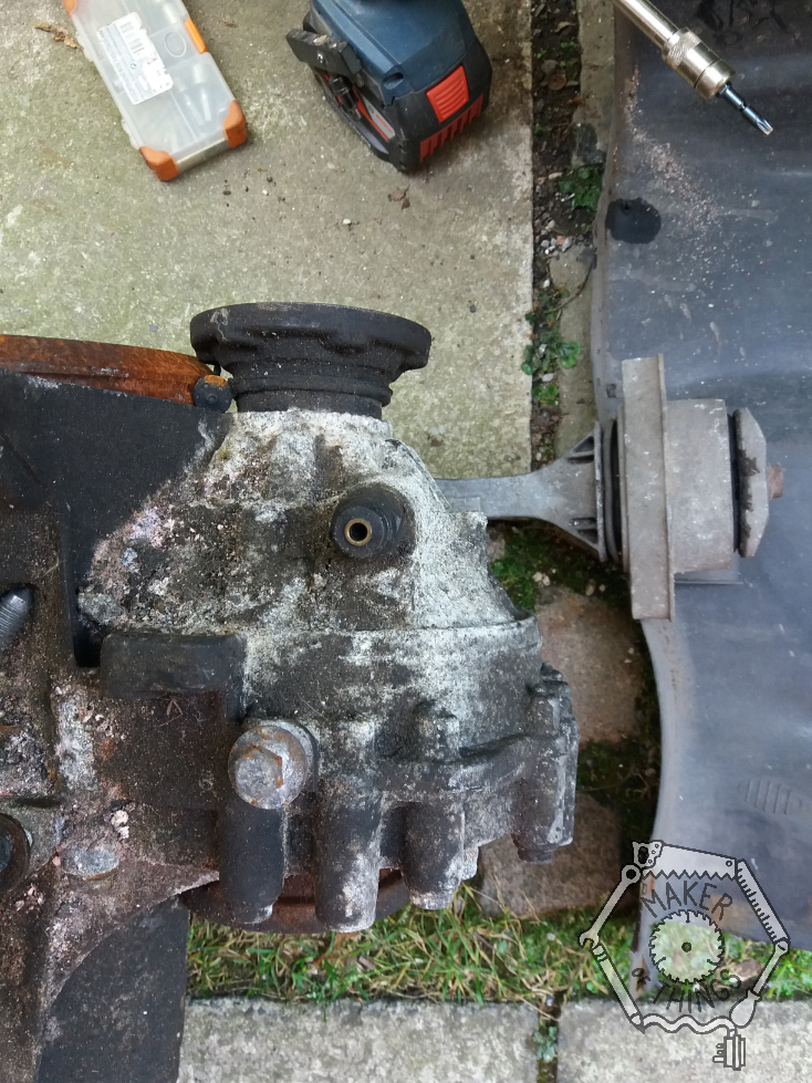

Pallet unpacking time! :D
This is what Damien kindly sent to me, the Prius transaxle, Controller, driveshafts, and other useful stuff, and including a #SurpriseMakersParcel.
Not sure what the thing between the vacuum pump and the power steering pump is.
Here is the Prius transaxle and the Skoda transaxle exchanging tenancy contracts.
And the contents of the #SurpriseMakersParcel.
For folks who don't know, in the Twitter #Maker community I often send out a 2kg #SurpriseMakersParcel on request, to fellow makers, full of random stuff to make with. It could be anything from my Dad's stocks of old electrical, electronic, mechanical kit, tools, novelty items etc. from his electrical wholesale, and repair shop in London before he retired and put it all in my basement!
I guess this is what it is like being the recipient of one. :D
I hope everything Damien included has made it safely and nothing is missing in transit.
Thank you so much!

Nice paying it forward lesson from JB.
The thing between power steering pump and vacuum pump is the Park mechanism for transaxle

RetroZero wrote: Fri Oct 02, 2020 11:55 am Nice paying it forward lesson from JB.
Ahh, thank you for that.
I can't wait to start playing with it all and seeing how it fits in the car.

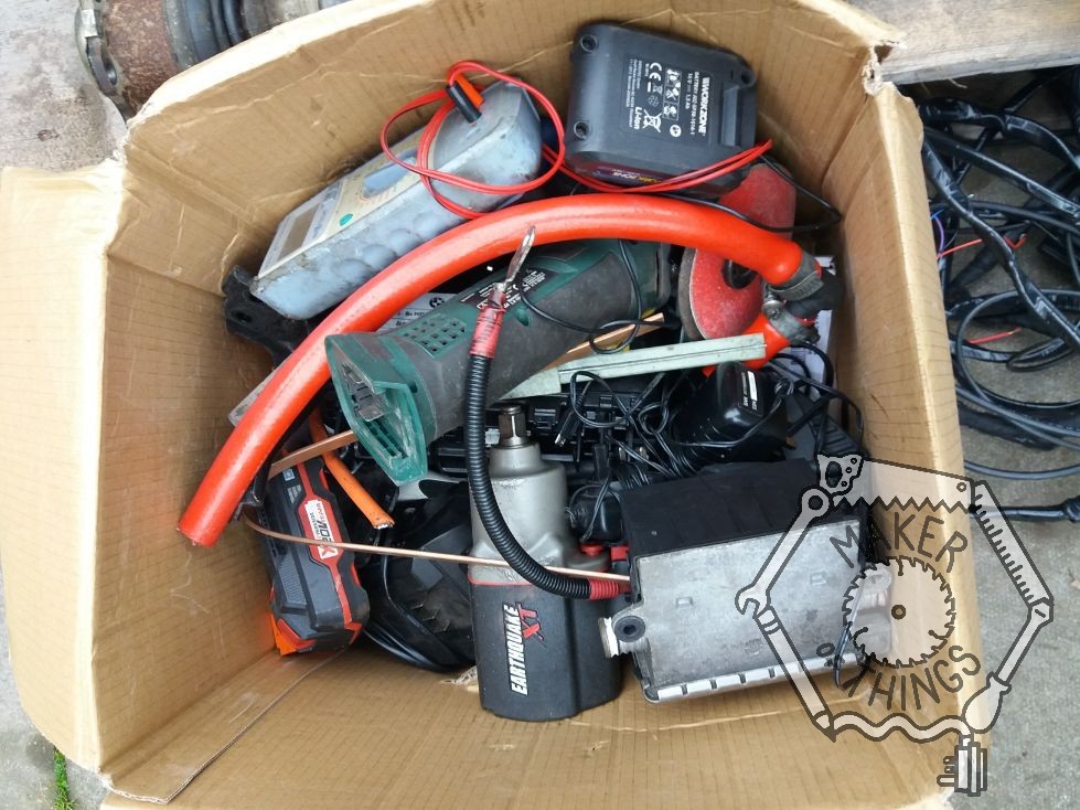

Looks like it all made it:) Hope the random stuff is some use. Seemed a shame to dump. You will need to torque down the bolts in the transaxle case before use. The vcu and loom should be plug and go. There is also a powerwatcher kit in there :
https://powerwatcher.net/
and a bmw contactor box.

Jack Bauer wrote: Fri Oct 02, 2020 12:52 pm Looks like it all made it:) Hope the random stuff is some use. Seemed a shame to dump. You will need to torque down the bolts in the transaxle case before use. The vcu and loom should be plug and go. There is also a powerwatcher kit in there :

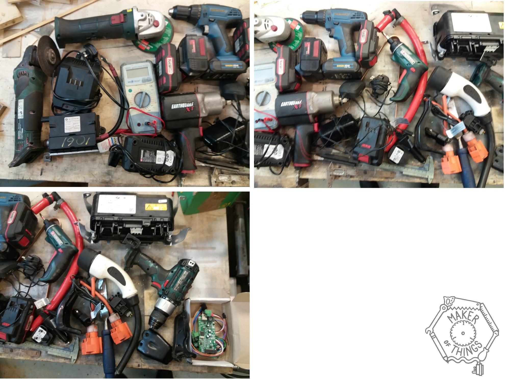

Brilliant! And thank you so much!
I was wondering what the box of PCBs was. I will be asking a lot of questions as I go.
The Prius inverter: that's a Gen 2, isn't it.
I bought a Gen 3, I think, to modify for my other car later on when I have learnt how all this goes together.
I have had a play with the random stuff too. I should be able to put them to use. The tool batteries seem ok, but the chargers don't seem to recognise them for charging. If I can't repair them I can make battery converters to run them from Bosch or DeWalt batteries as needed. I have just gone from a 6 x 115mm angle grinder house to an 8 x 115mm angle grinder house! :D
If I can't use the drills here I can fix them up for one of the Working in Wood project or the Women's Shed.
Thank you.

After a ten month pause, I have finally started to tackle the conversion again and decided to attempt a trial fit of the transaxle.
The pause has been partly poor mental health, winter weather, parents using my working space to store their mobility scooters, and needing to earn money with a few more regular part time jobs taking up most of the day times.
However, I know that I can't let this project lapse and also that there is help if I ask for it on the forum.
The first stage of this next part is to do a trial install of the Prius transaxle and see where it needs to fit. I can then work out temporary, and then permanent, mounting points for it.
The first stage was to check where the original transmission mounted and work out where the drive flanges would be.
I refitted the transmission mount torque bar underneath the diff. This has a known position to bolt onto in the engine bay near the drive shaft flanges. So notes made of fore/aft and vertical positions of the flanges.
It was a complete waste of time though!
I craned the Prius transaxle into position and...
Well, I need more space. Here the transaxle is about 25mm from the inner wing, but touching the ABS pump! It still needed to move another 40-50mm to the nearside to line up with the driveshaft flange. That puts it inside the inner wing metal work! Oh poo!
But then I had an idea! There is no petrol engine being attached tot he Prius transaxle so it doesn't need to be on the nearside of the engine bay.
I swapped the driveshafts over, and the transaxle can go more or less central!
I did a test and it will go in there but I need to swap to the drive shafts that Damien sent in the package. The CV joints are different and the shafts are quite a bit shorter to allow for a wider diff flange spacing.
No photo of that bit as I had to put everything away again and go to work!
