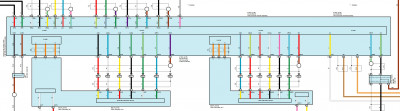

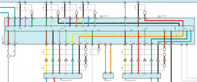

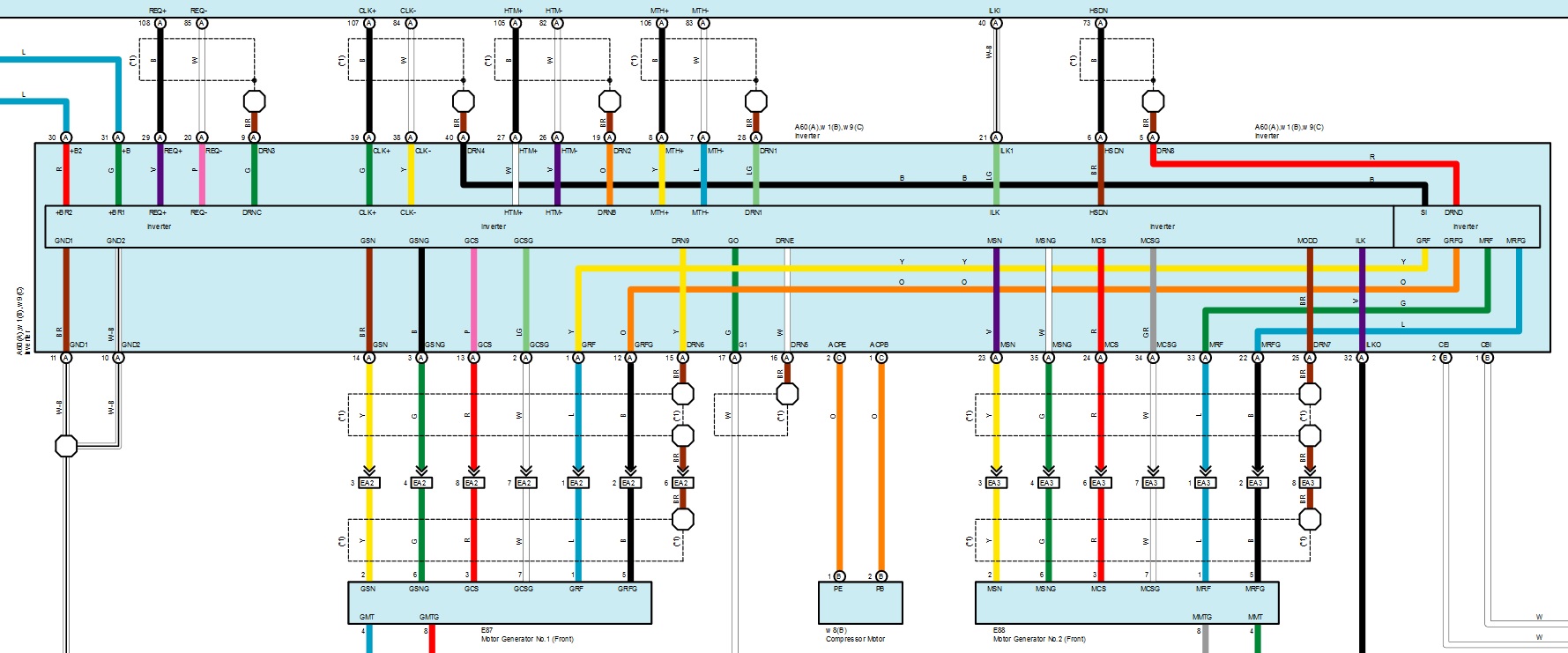

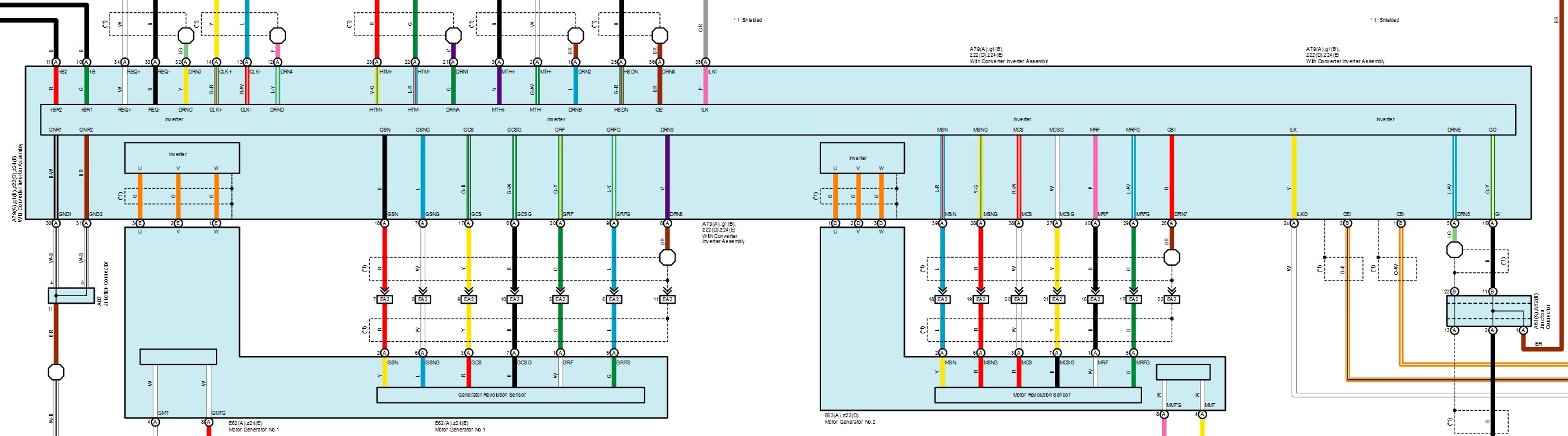

Inverter wiring diagram (LHD):
Seems practically identical to the gs450h system, indeed. If the control protocols are indeed the same... :)
Gearboxes should be the same, other than the LF1A transfer case attachment at the end.
